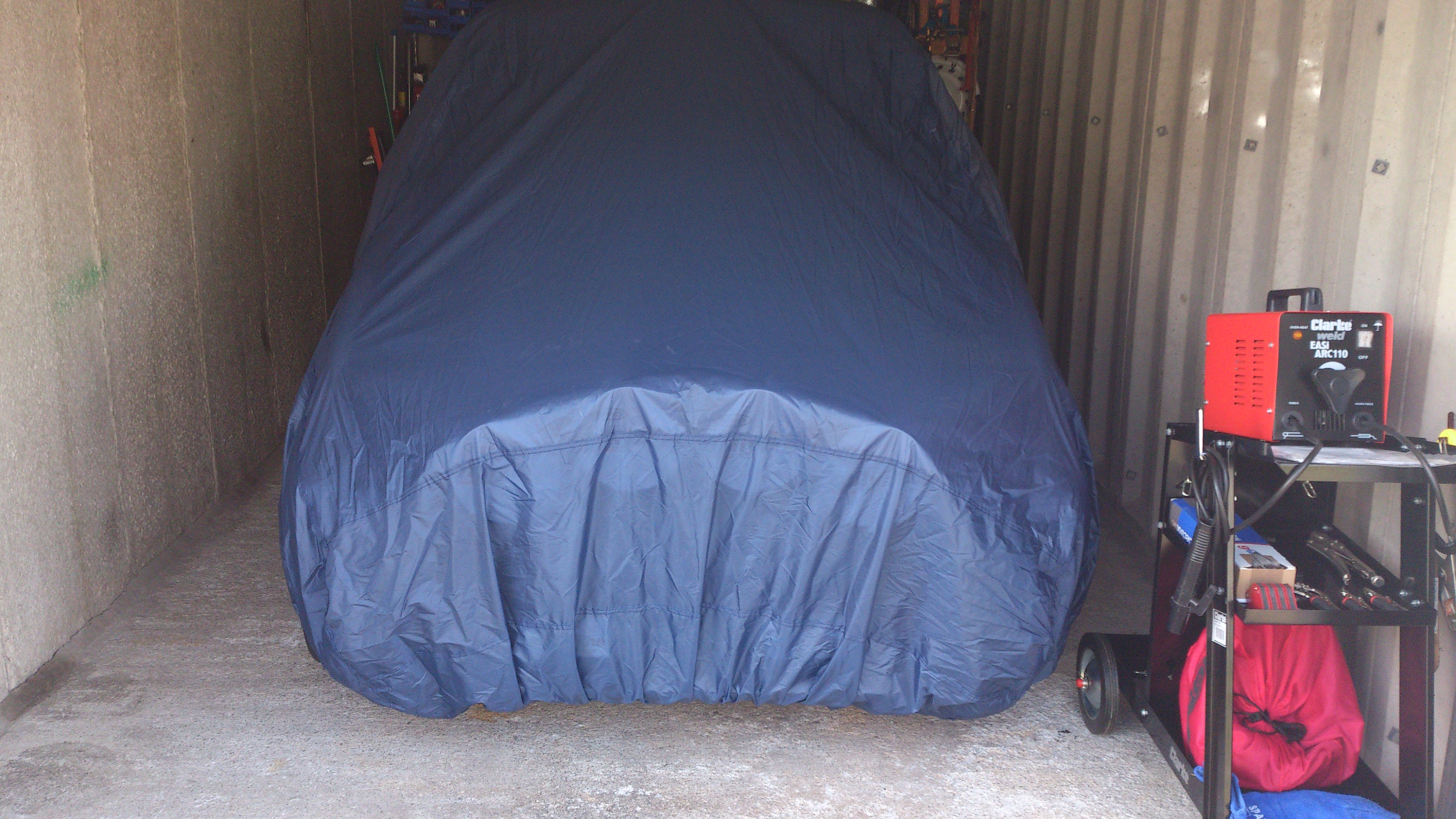

Alwite folks,
It really is that time of year again:(,car is now well and truly locked up till next Spring!,
Below is a quick video of the car idling before i removed the battery and covered it over for the winter,
Nighty Night:)
