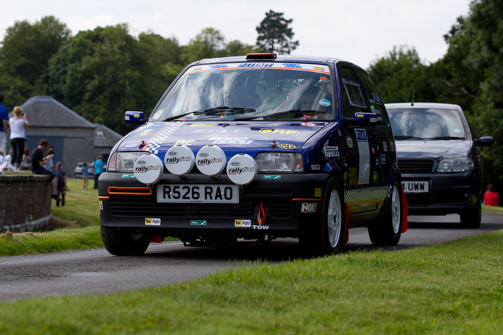

Well i had the car out at yesterday at the Scottish Italian Car & Bike Show at Hopetoun House,which iam pleased to say was a good day,the winning car was Ferrari Daytona:cool: and the bike was MV Agusta F4:cool:,
Well its that time of the year again for the Cento to be garaged:(,it still has 4 Months tax on it but that can be surrendered,now there is a track night this Friday with the AROC at Knockhill but iam not sure i can make it yet...Argh,ive not had this car out on the track this year yet....Oops, so it would be good to get out on the track for a blast eh!,we'll see what the Boss says later today:D,
So its now time to get the little car back up on its axle stands and start getting some more jobs done:).... between now and next Spring,
Whats next i here you ask?......that would be telling....lmfao,
I'll post up some pic's of yesterdays show later today all going well, when iam back on my laptop, and i get them uploaded to my gallery,
All the best Scuderia
Hi,
Here are a few new images of the little beasty thats were took at the Scottish Car and Bike Show at Hopetoun House on Sunday........and a direct link to all the images took that day, if your interested:),

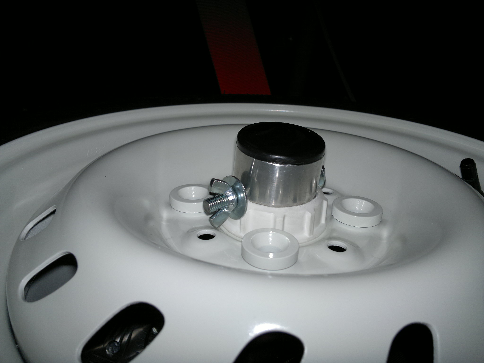

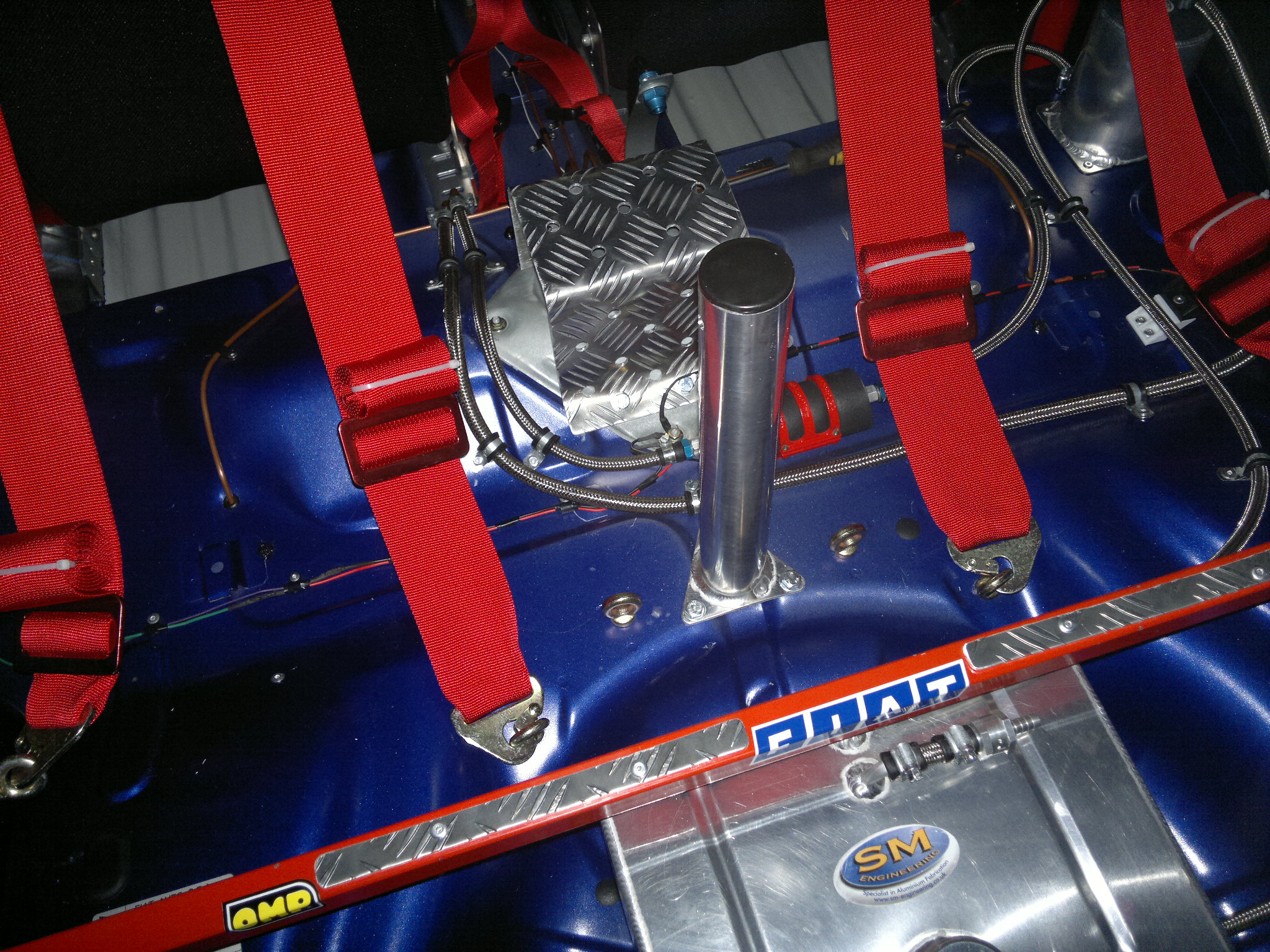

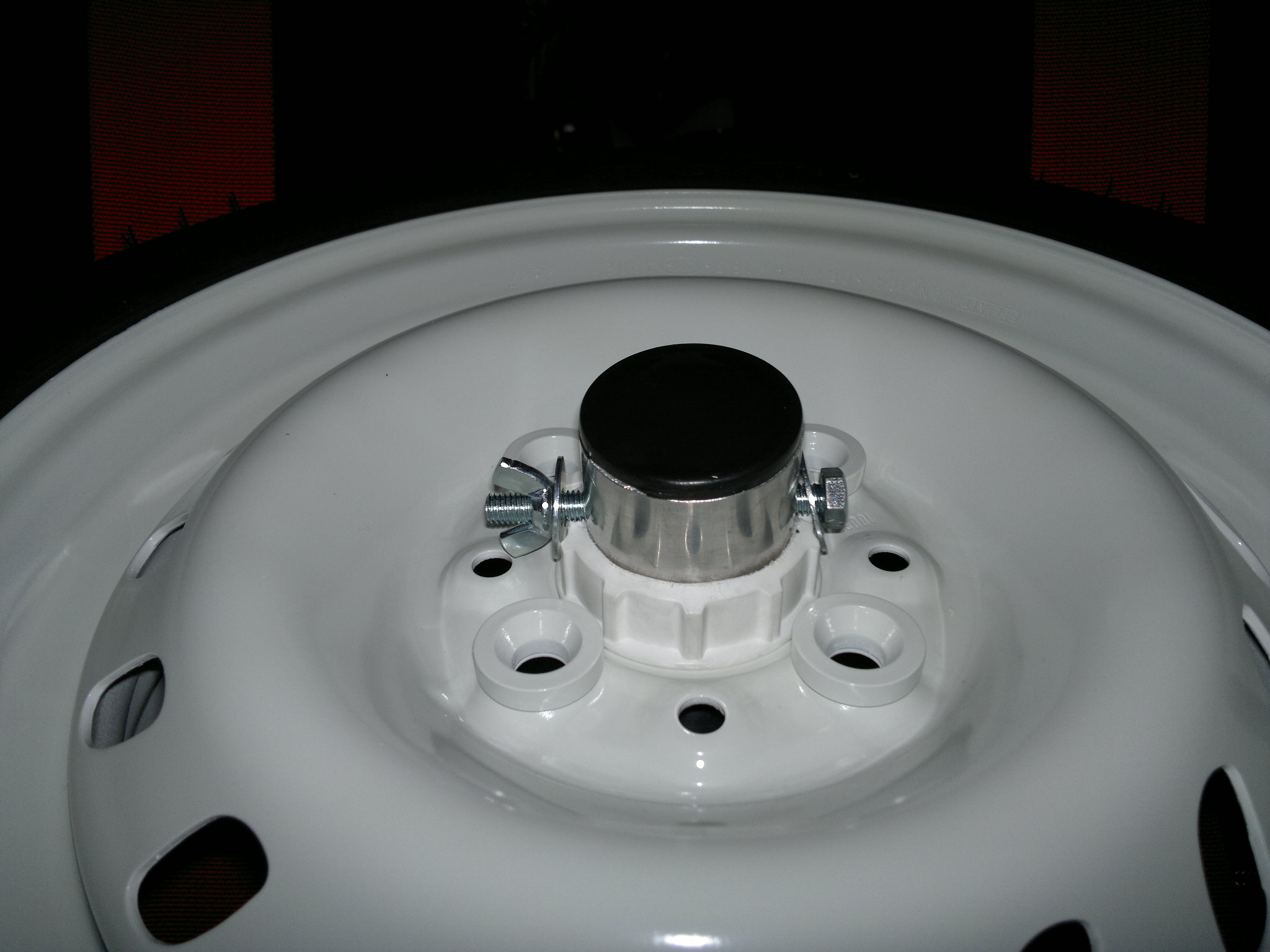

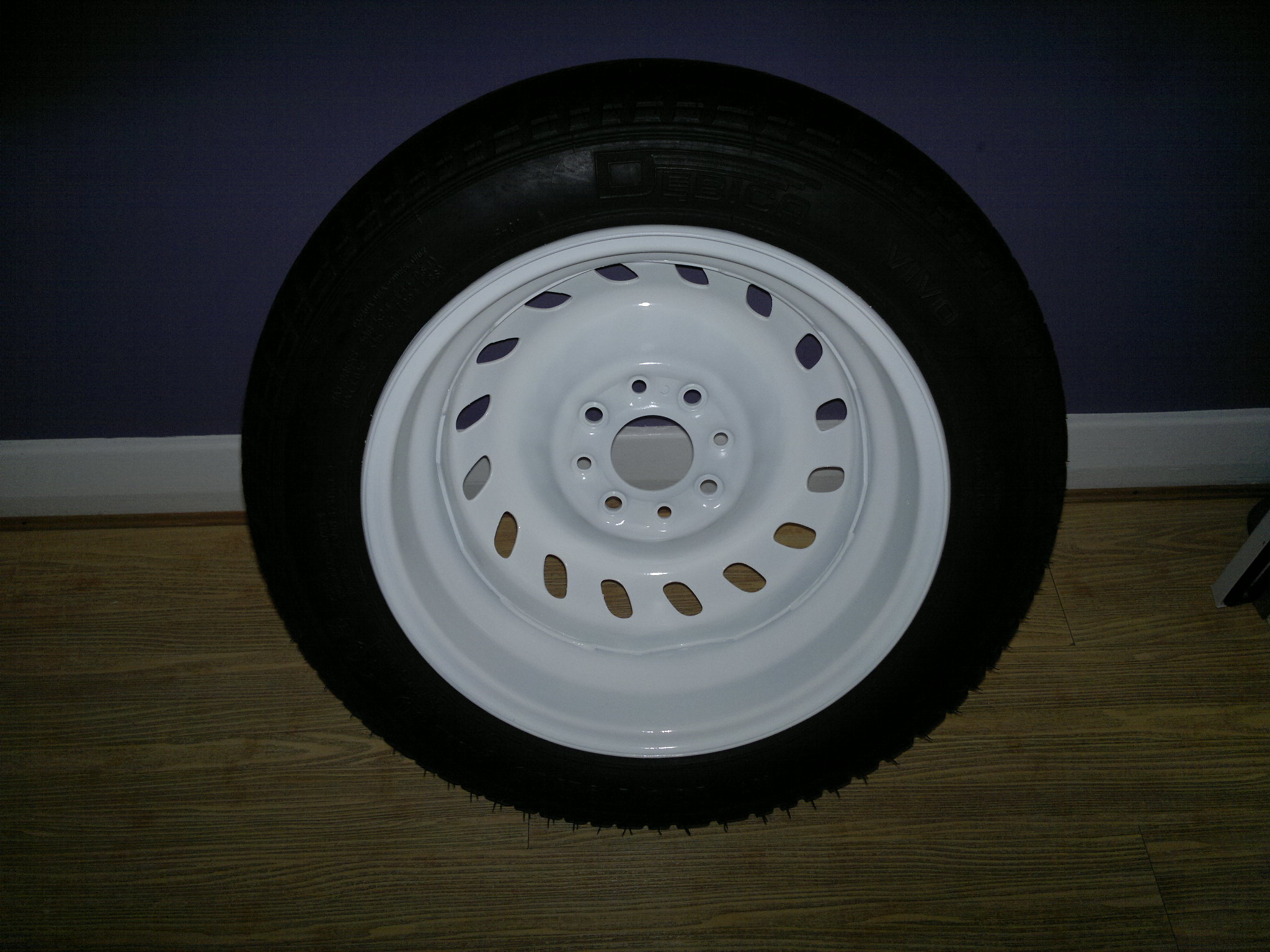

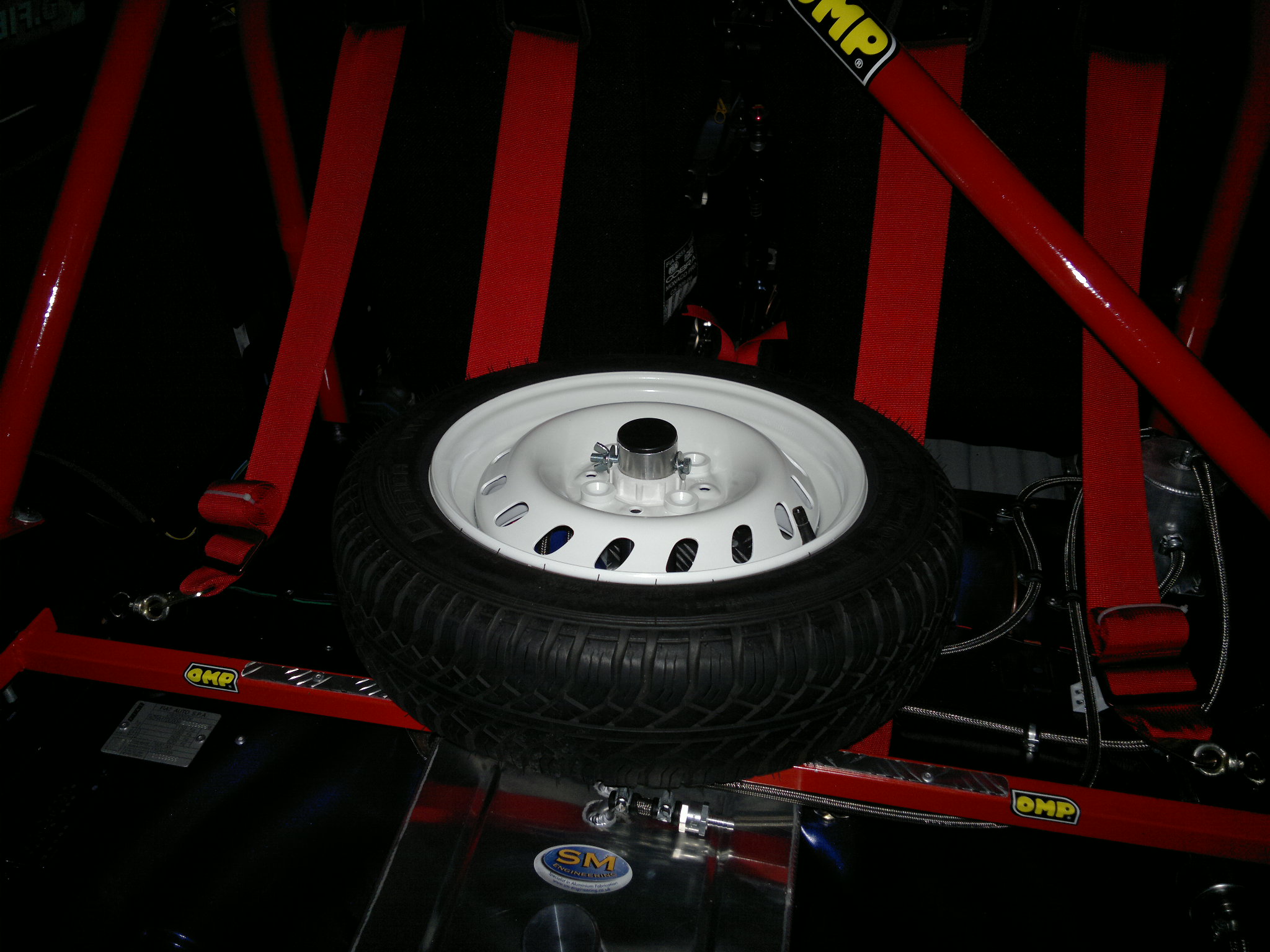

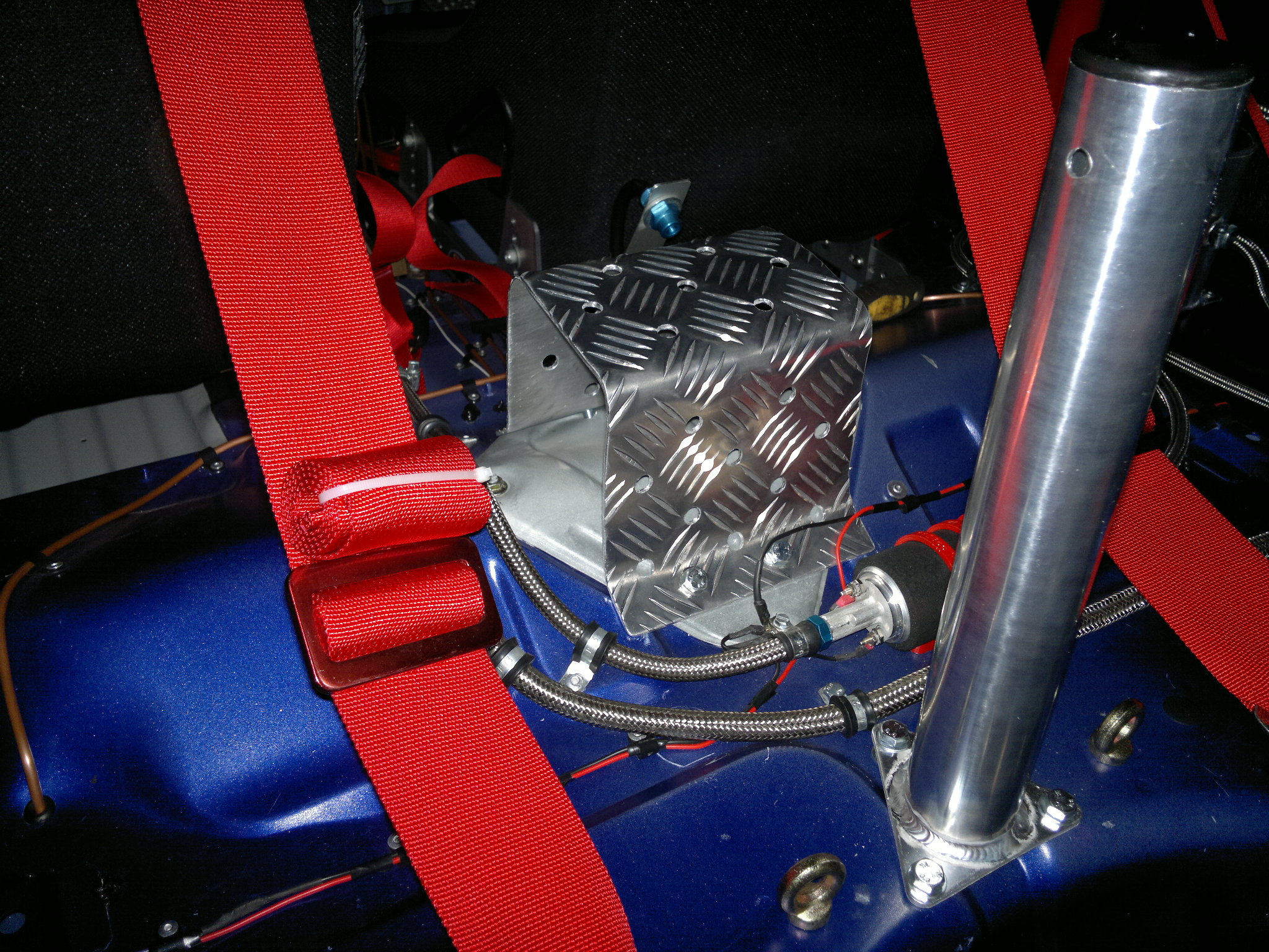

Like i said, nothing special, but something that ive been keen to do for some time,keeping up with the rally look,taking the inspiration from other rally cars i thought it was about time i got the spare wheel back in the car, if i ever did have a puncture i would be in trouble without one eh:(,not that it will be kept in the car when out on the track, but its there for me if i need it traveling to events or meets, just in case,
So what ive done is use the space saver that came with the car,after preping it i gave it a freshen up using some primer & white paint to match the other stock alloys that are already powder coated white,

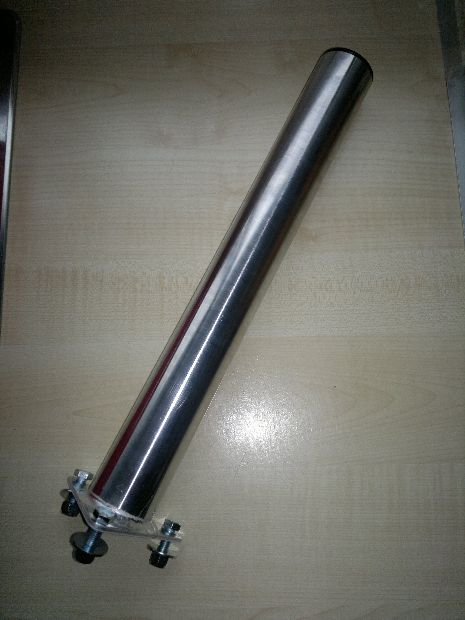

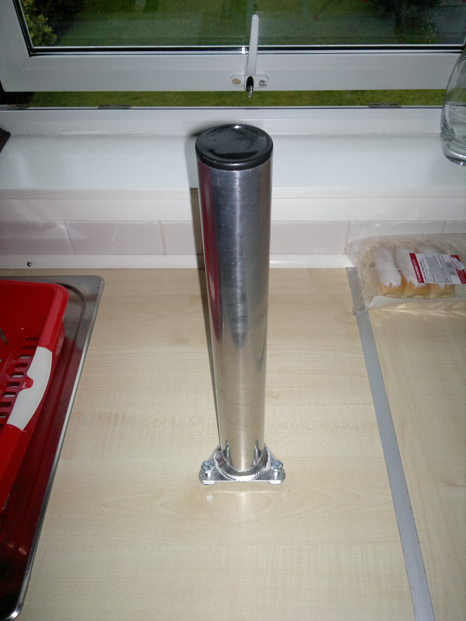

Now with me having the foam filled fuel tank in the spare wheel bay, i opted to buy an alloy rally spare wheel post from my local rally supplier to mount it and keep help keep the spare wheel in place,
So i had to find a place where i could mount it:(?,so i opted to place it below,to be honest there wasn't anywhere else lol,what its not doing is fouling any of the fuel lines or brake lines even the fuel pumps tank or swirl pot, but i have had to make an alloy mounting bracket to help raise it a little so it didn't foul the seat harnesses,
Below you will see the mounting plate i have to bent into shape using some 3mm checkered plate so it left enough room so the wheel didn't foul the seat harnesses,you will also see below where i had to mount the post itself and also pop rivit some checkered alloy plate to the red brace where the wheel will be seated,

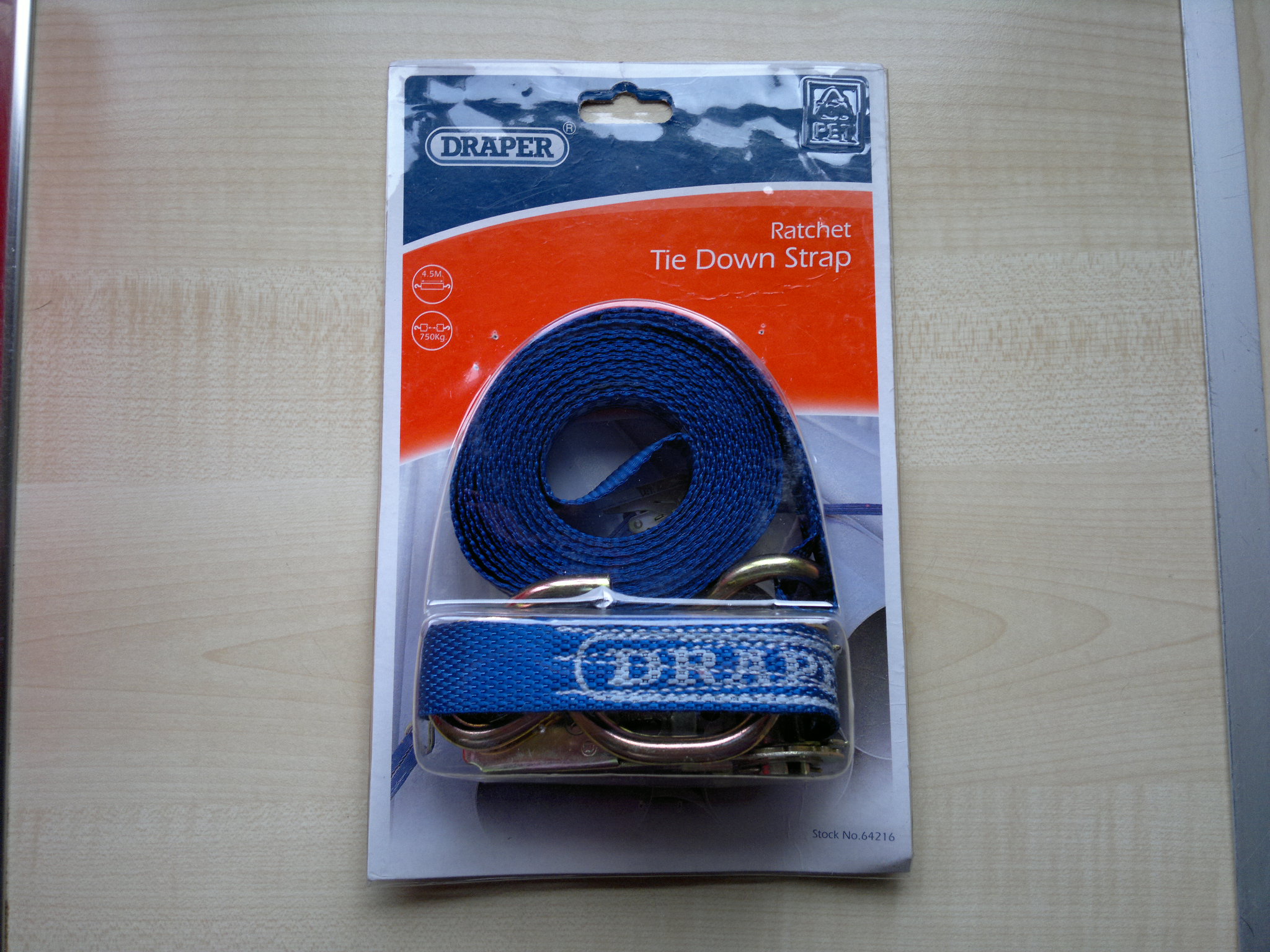

I have also bolted 2 more harness lugs to either side of the post to use in conjuction with the below strap to help keep the wheel in place,
You will also see that the wheel is bolted in place like below,

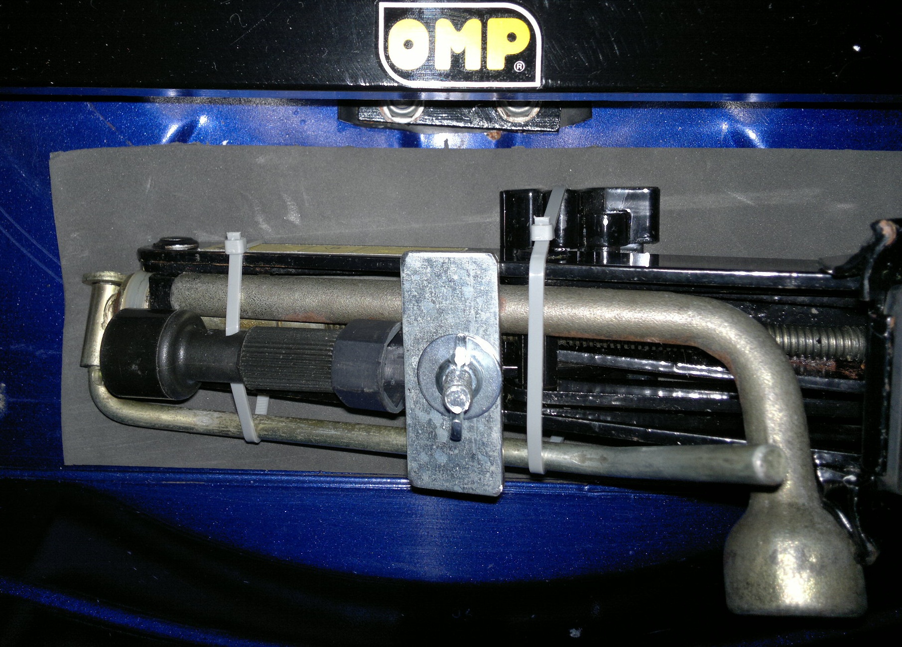

The spare wheel is no good without a jack eh,so its now bolted in the place between the fuel tank and the rear hatch,
Finished

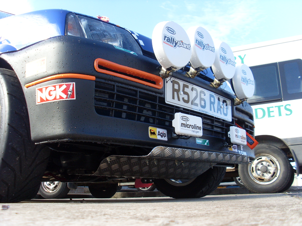

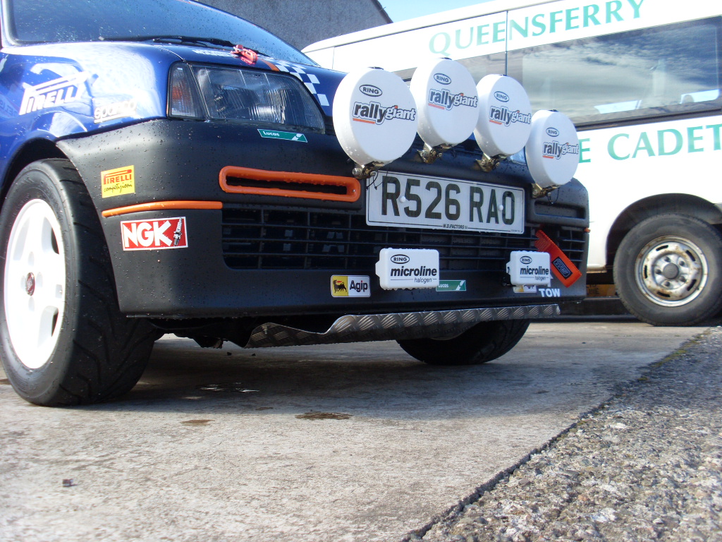

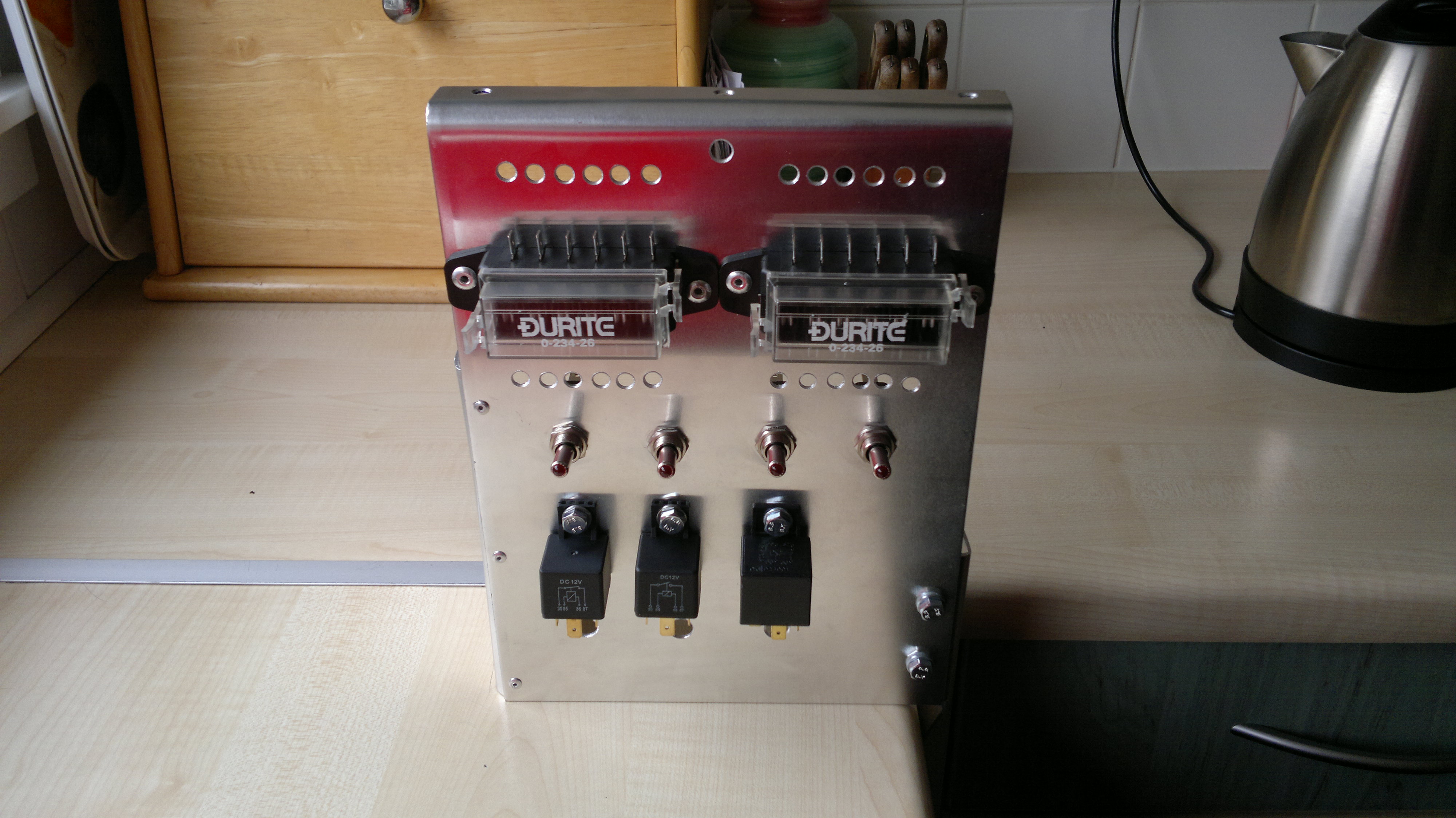

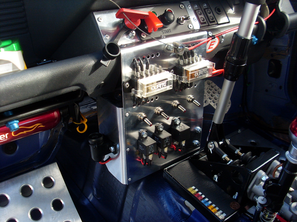

So i bought myself a set of Ring fog lights:D,yeah yeah i now light overdose!, they where reduced at my local Halfords so i thought I'll have them:cool:,and i thought they would work well with my Ring Rally Giants spot lights that are already fitted,

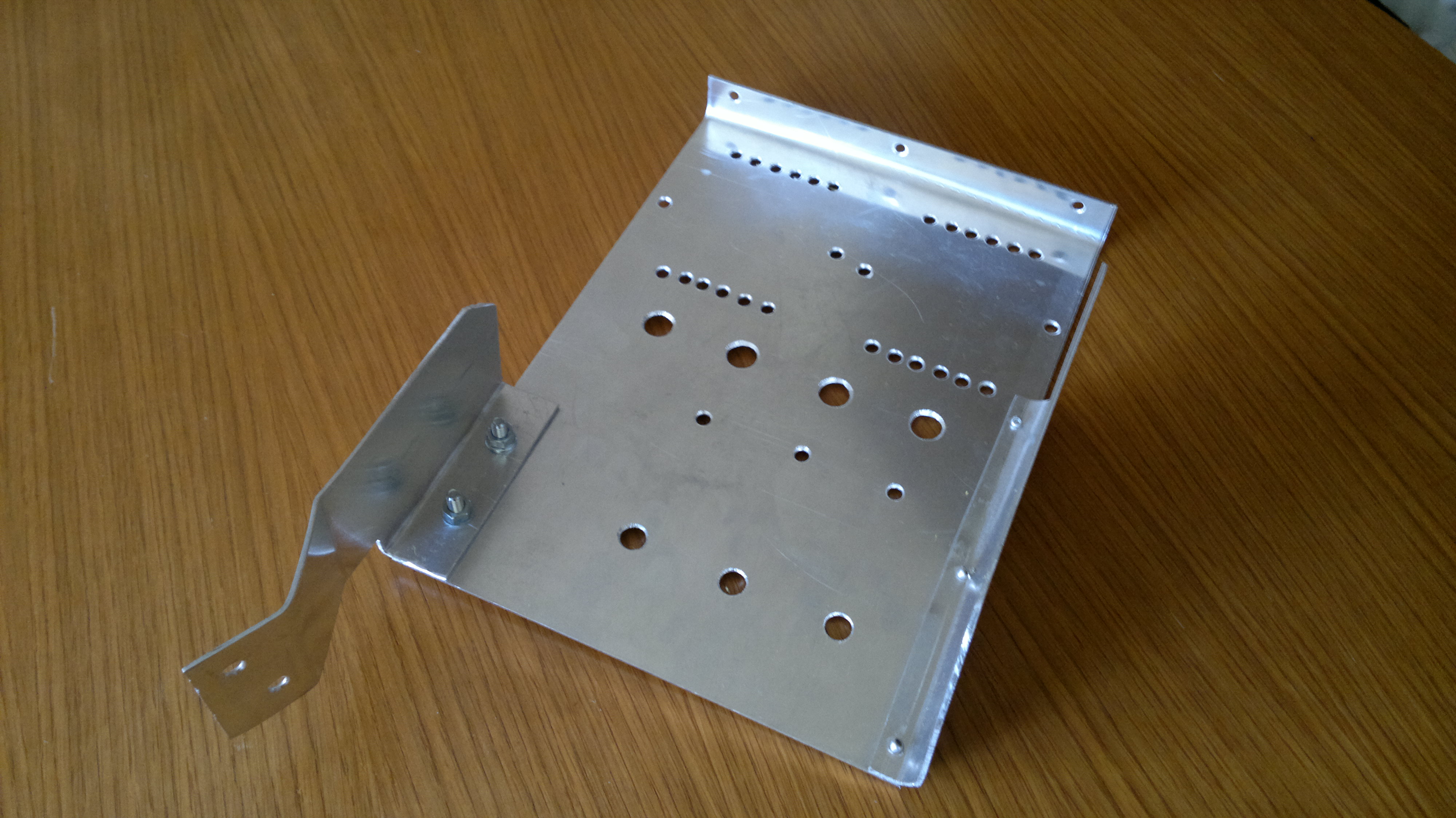

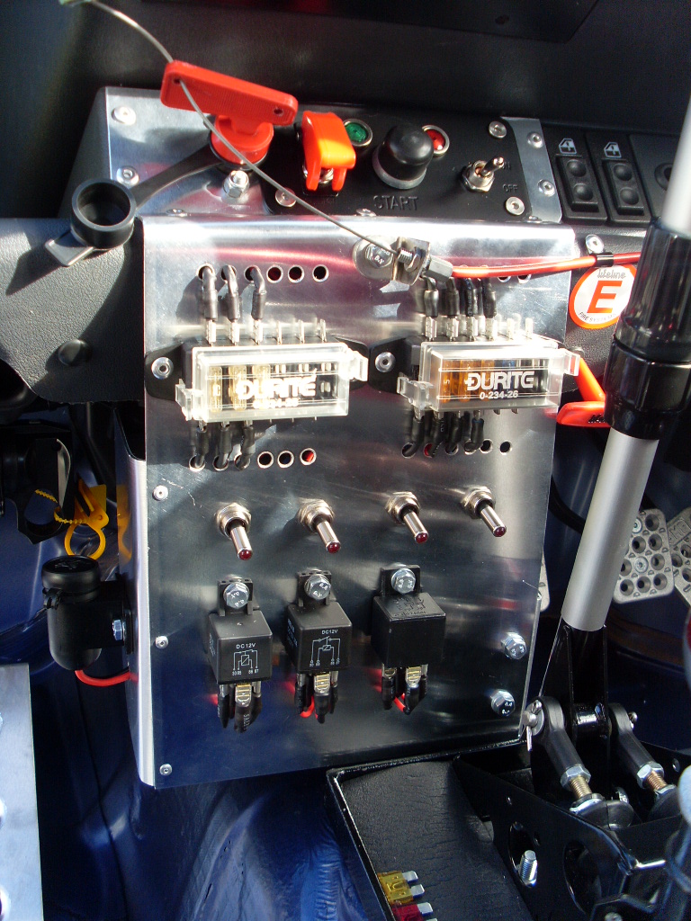

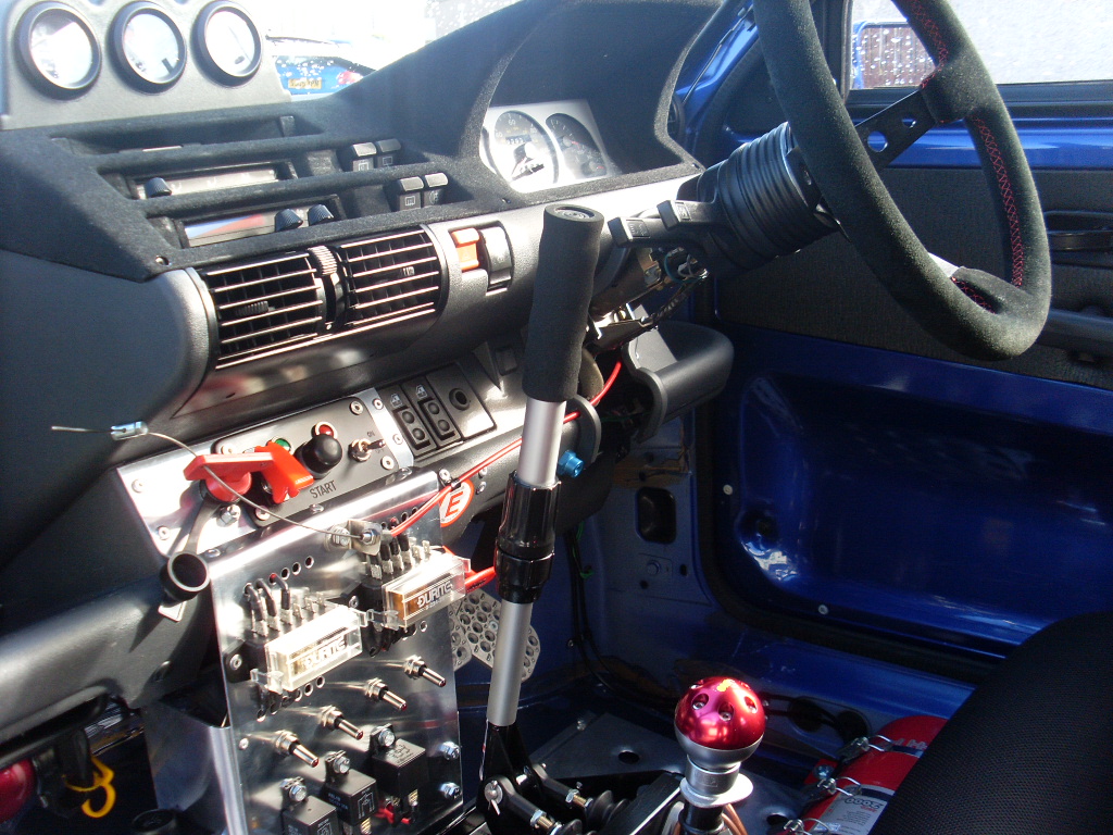

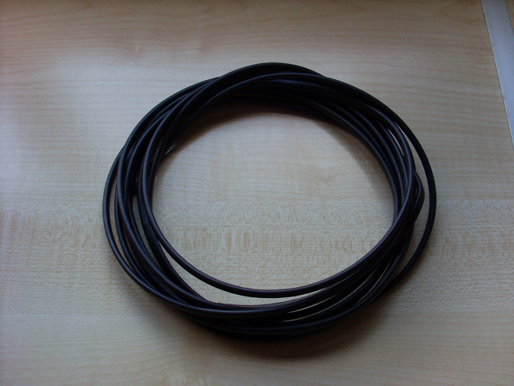

So as much as i had my other Rally Giant spot lights fitted i thought it was good idea to bring all the relays & fuses even switches all together in the one place, so i bought some bits and pieces to get the job done,

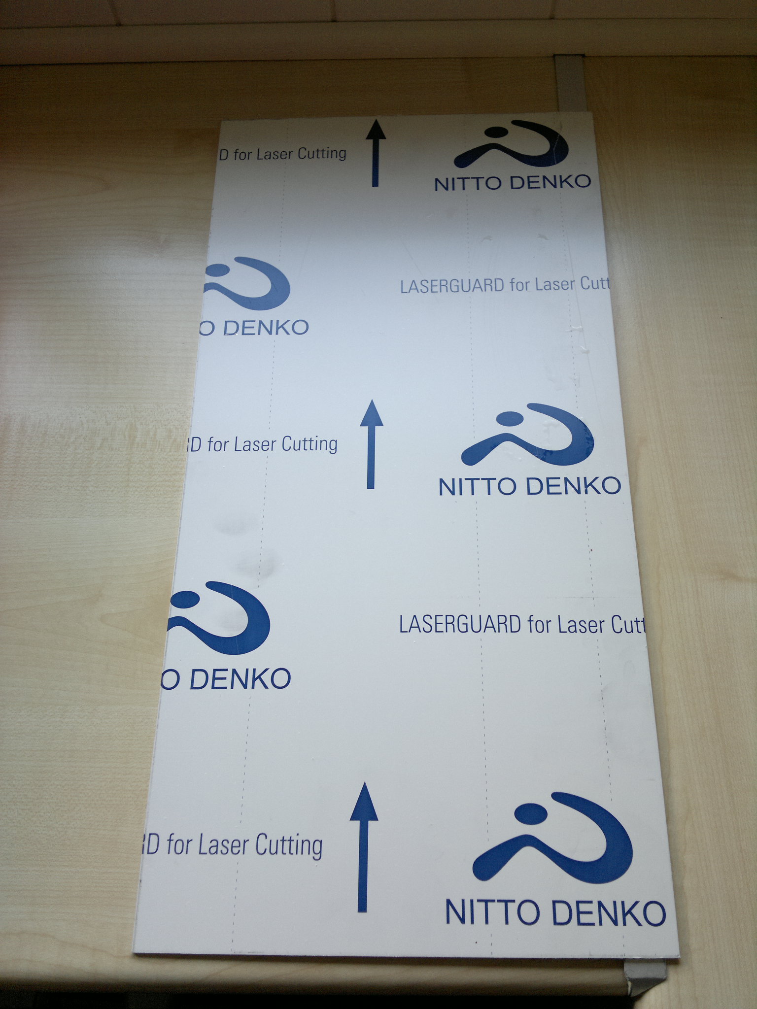

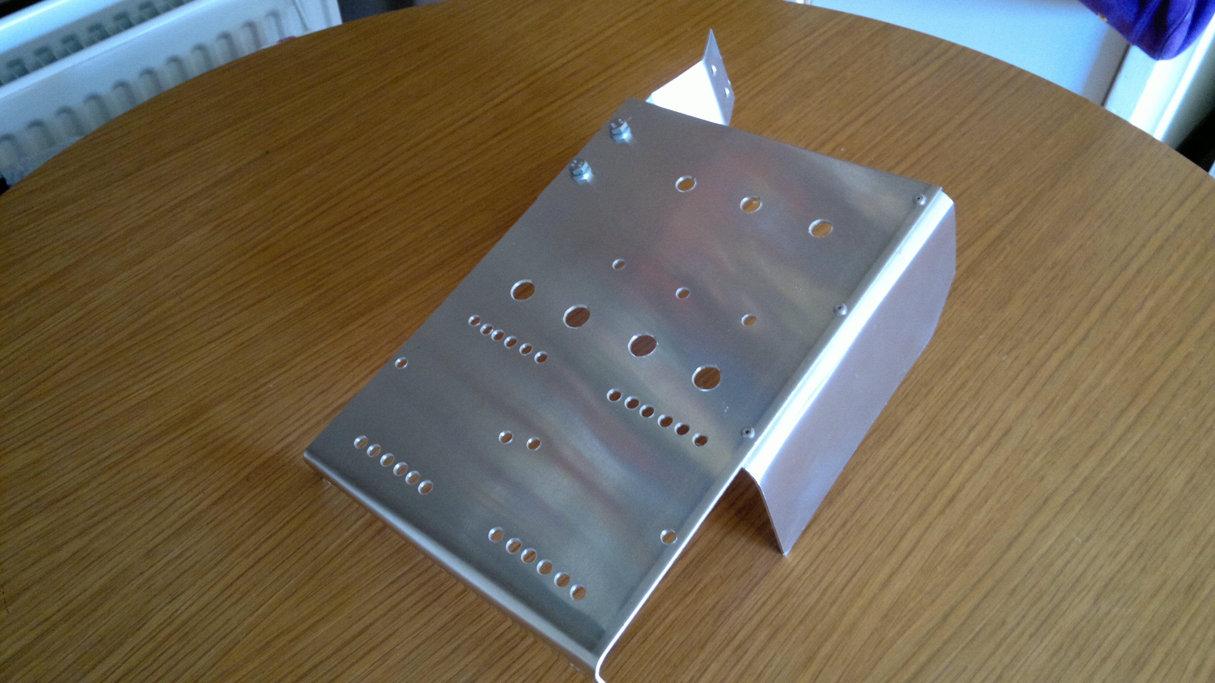

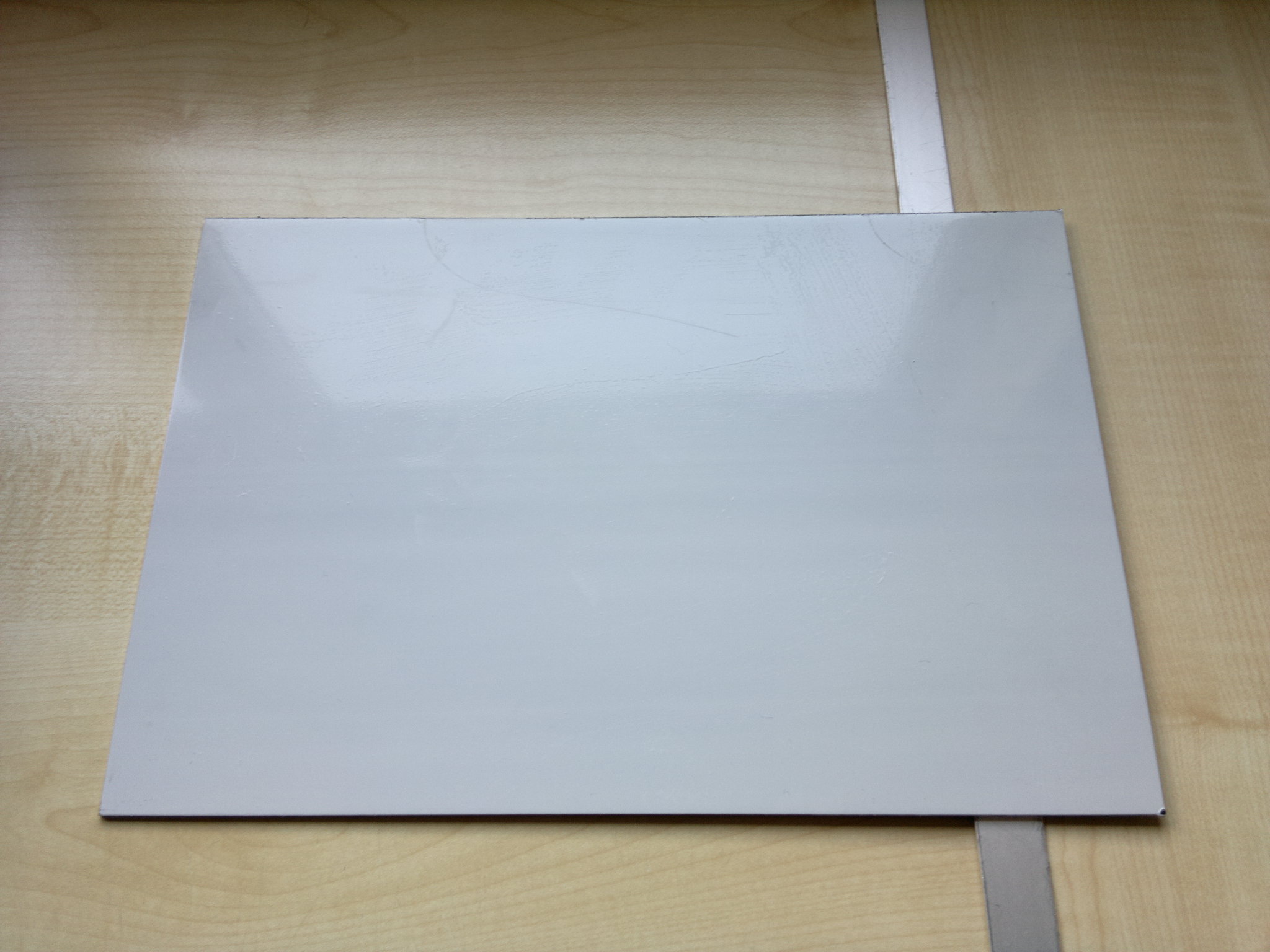

So after fitting the new fog lights and running the 25amp wires throw the bulkhead to the dashboard, i made a start to an alloy panel to mount it all on,
2mm Alloy
Durite Fuse Holders For The Light Switches & Lights
15Metres 25amp Euro Twin Core Wire

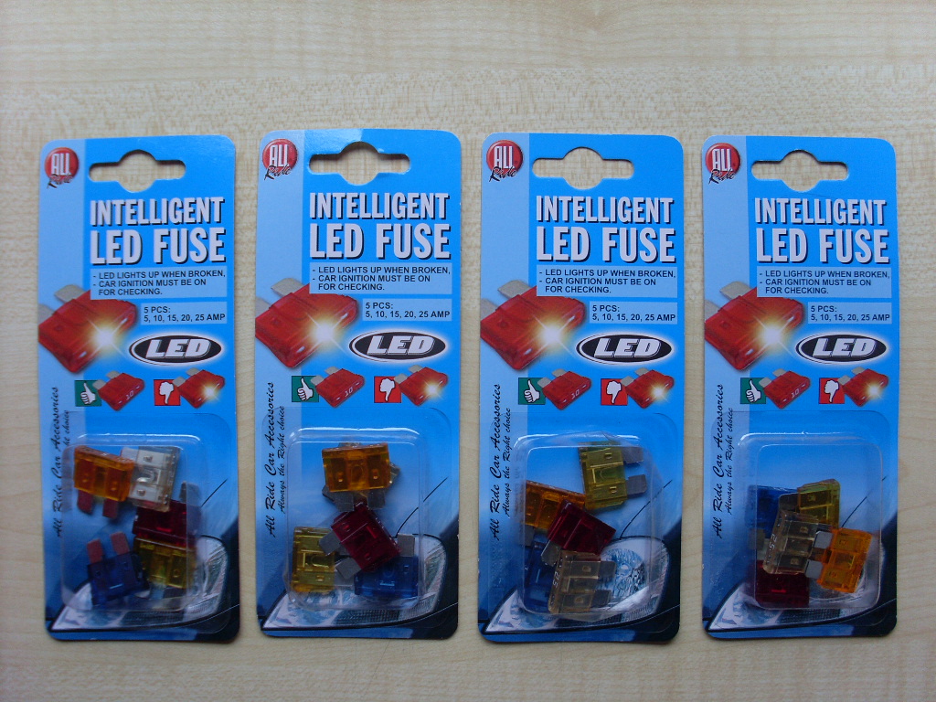

LED Light Up Fuses.......When Blown!,
Since buying those above fuses i have since bought more:),so every fuse in the car is now LED Light Up,
4 x 25amp LED On/Off Toggle Switches
P/Clips For Securing Twin Core Wire
Switch Panel Fabrication

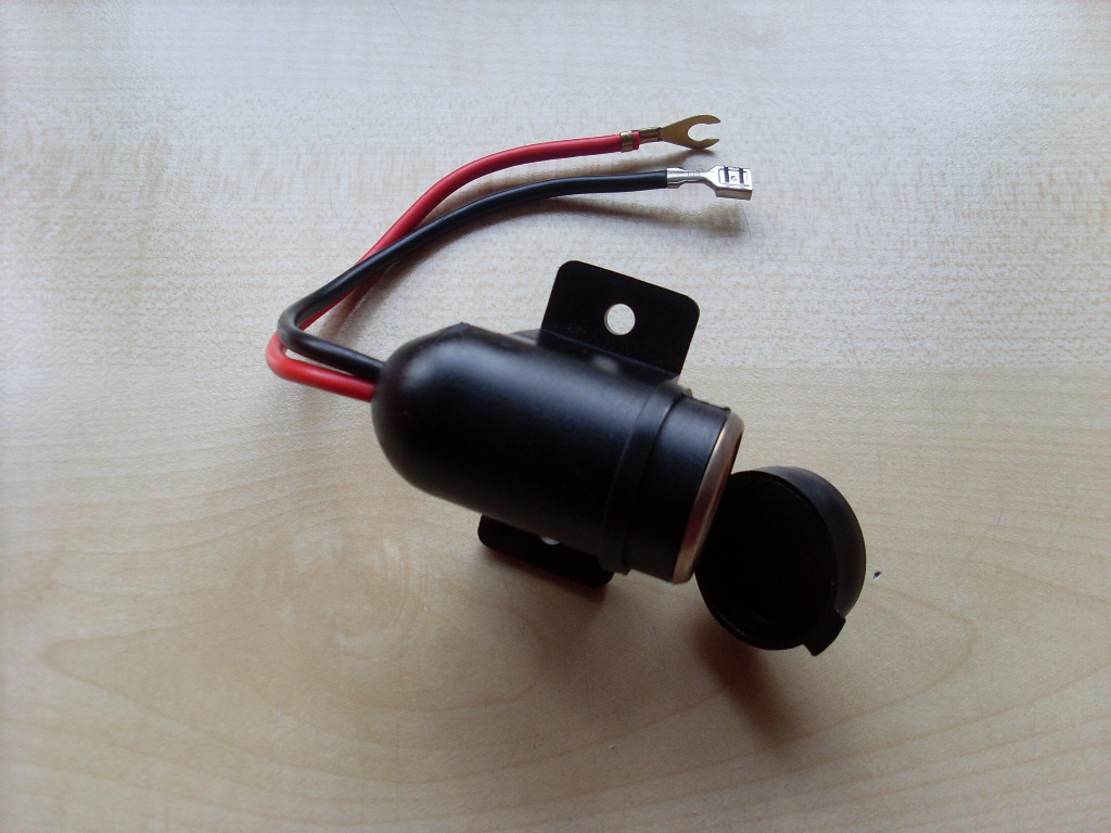

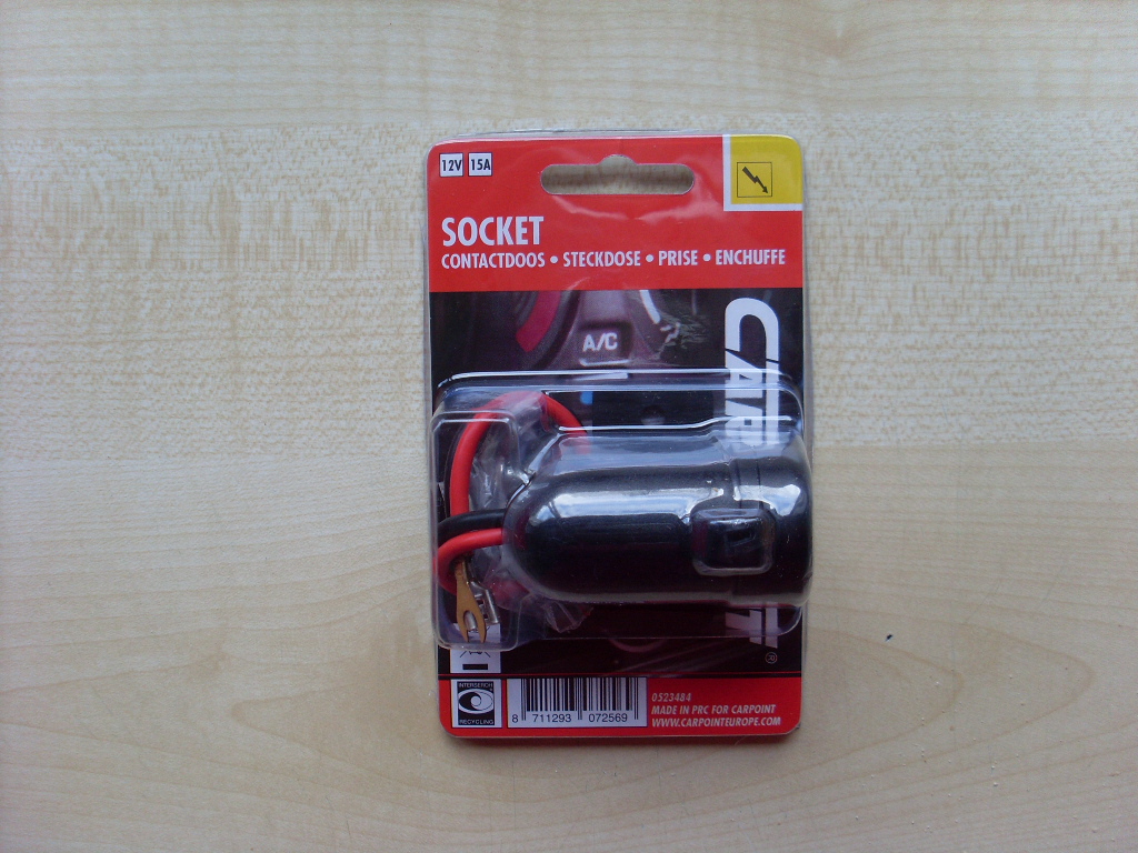

12v Socket

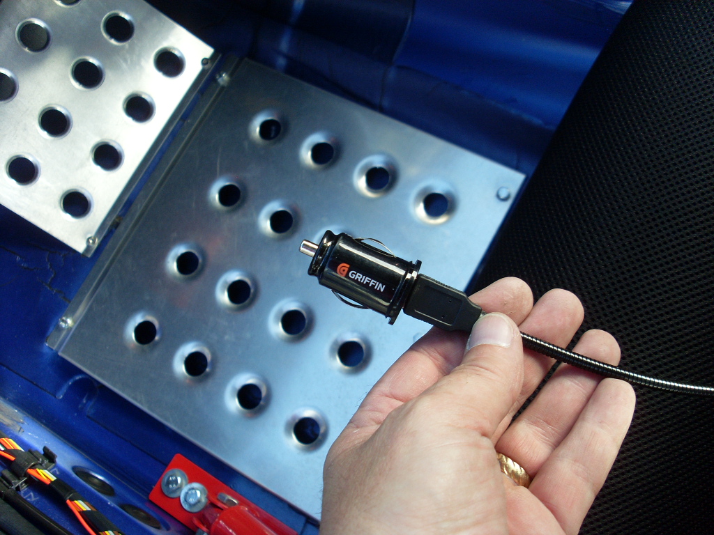

Twin 12v USB Socket

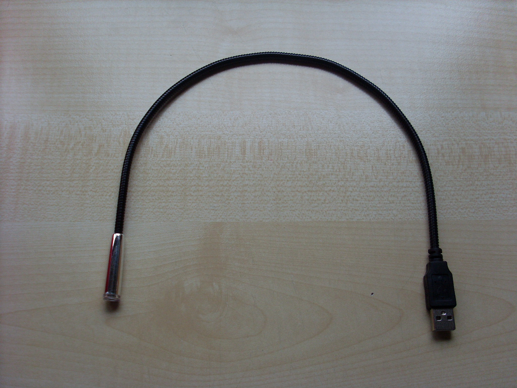

USB Map Light
You will see that each pair of lights now have there own 30amp relay and are protected by a 25amp LED fuse,and each switch is also LED fuse protected,
Panel Fitted & Wired
Light Switch Test
LED Toggle Light Switches
Ring Fog Lamps Fitted
BRIGHT LIGHT!

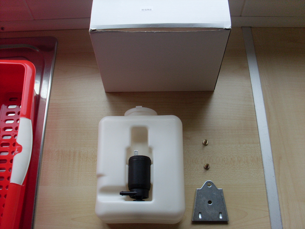

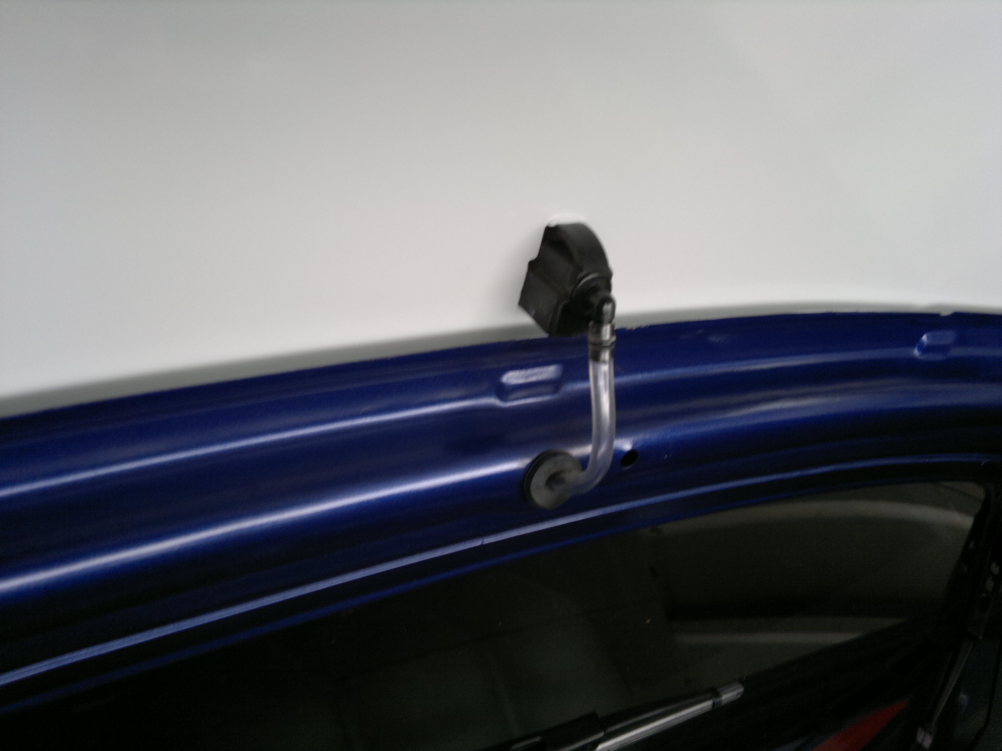

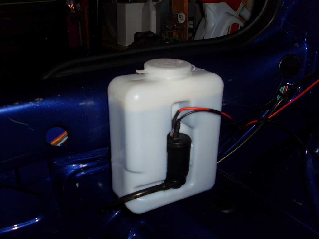

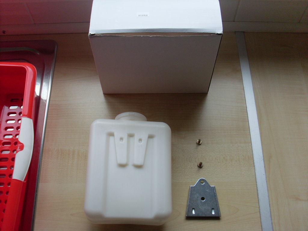

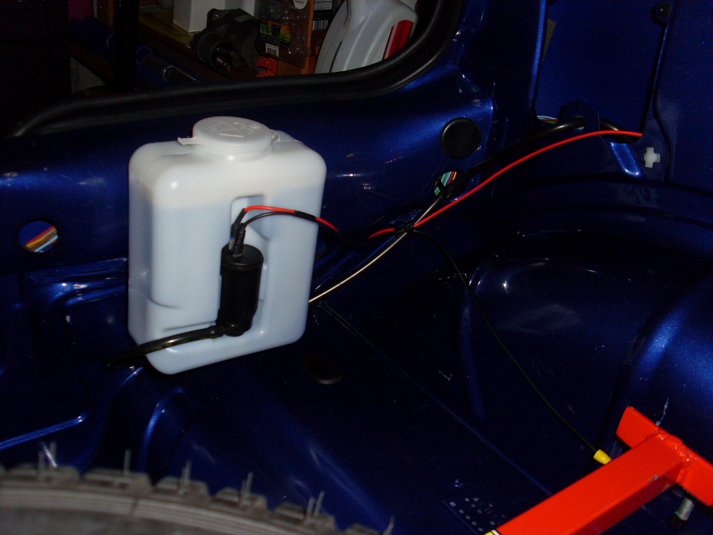

I have since done away with my rear wiper and motor along with the wiper washer bottle as both motors were goosed,
So i bought a new universal 1.2l wiper bottle and pump kit and have since wired it all up and fitted some new hose pipe,the switch is now on the lighting panel as the 4th switch,
The old system is now removed and new kit fitted to inside the rear of the car away from the elements, so it might now last a little longer?,

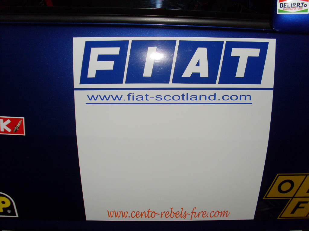

New Look FiatScotland Stickers..........not yet fitted:D,that's not like me......lol,
But i did fit the another set i bought at Hopetoun House, until i have time to fit the others:D.......or find some space:rolleyes:,

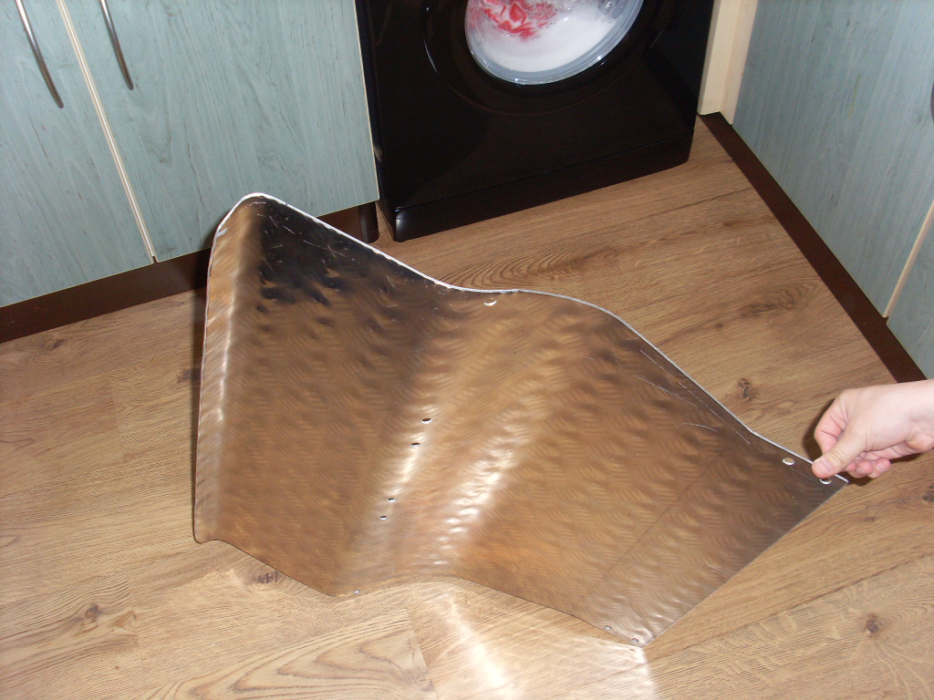

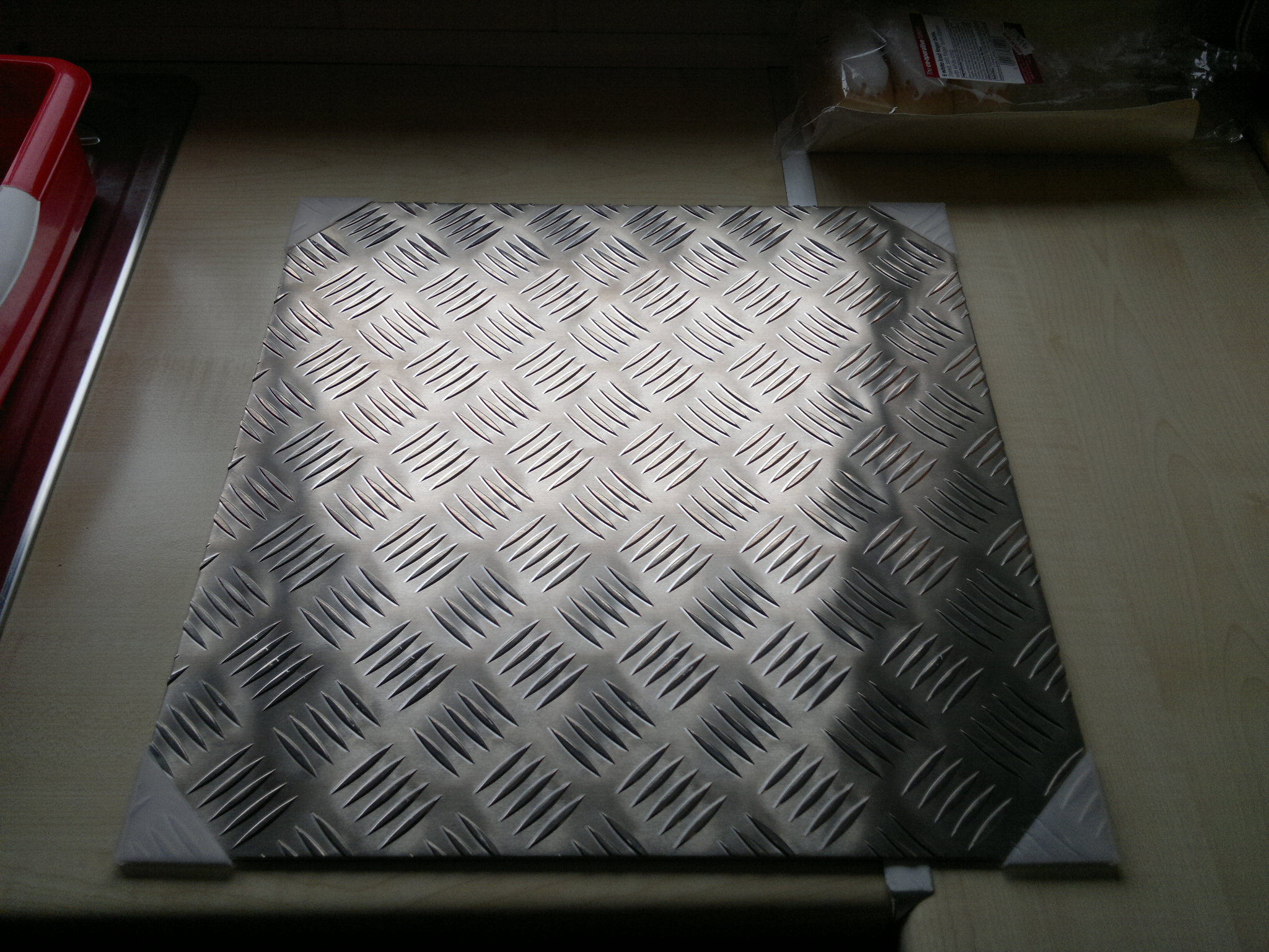

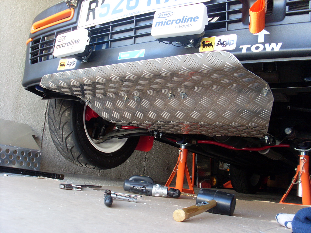

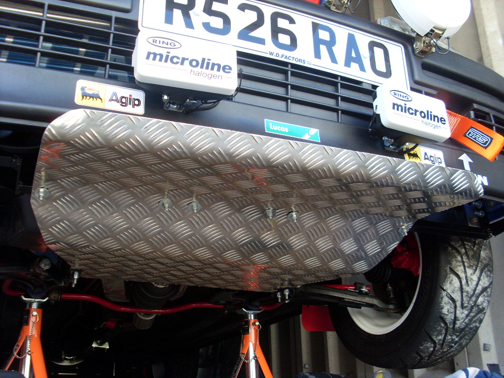

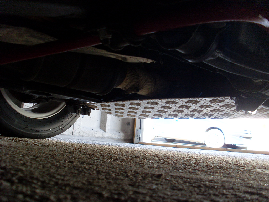

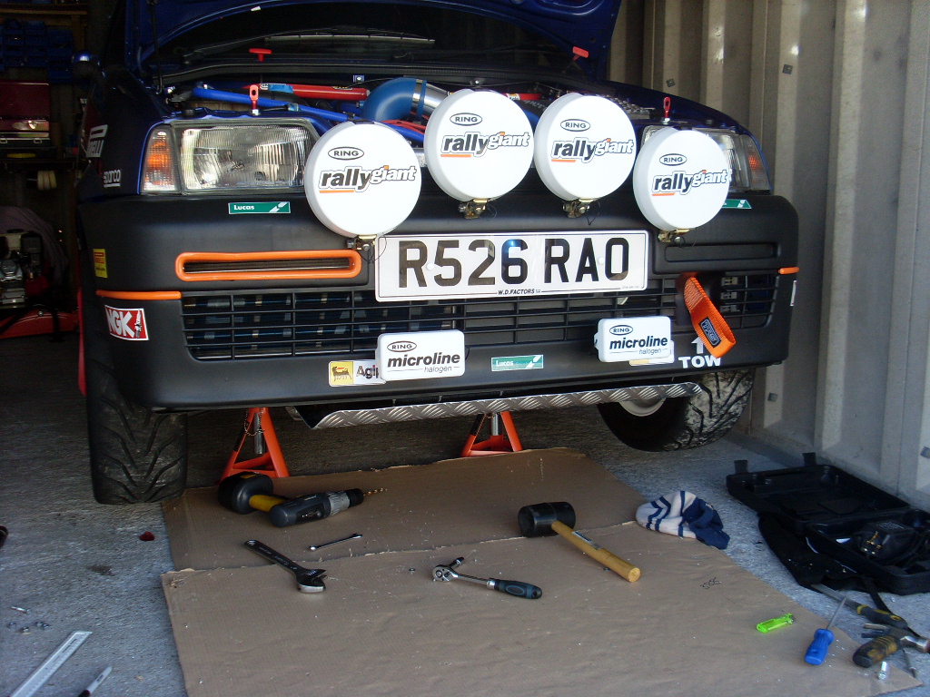

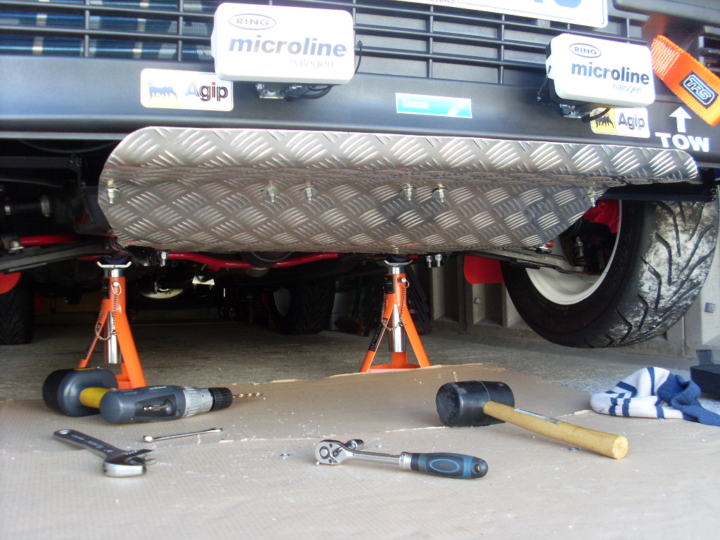

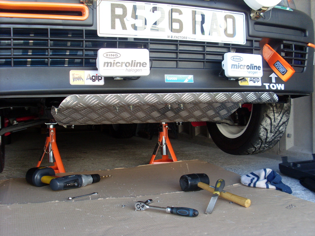

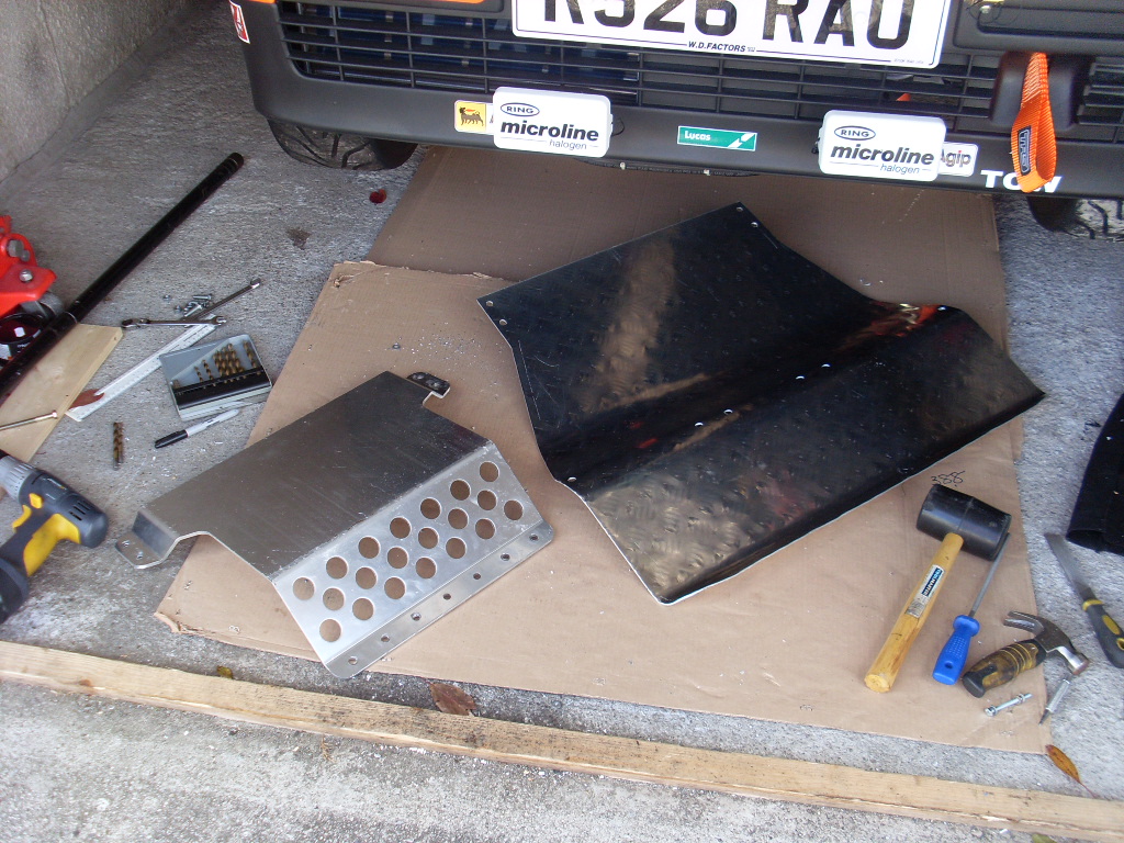

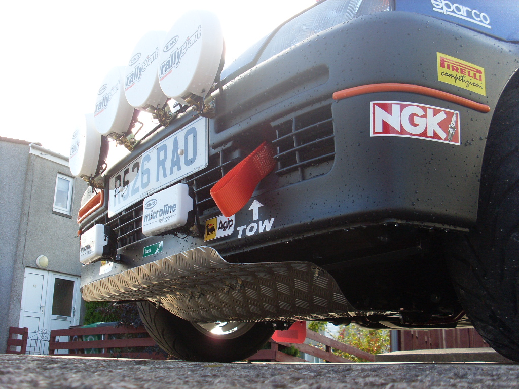

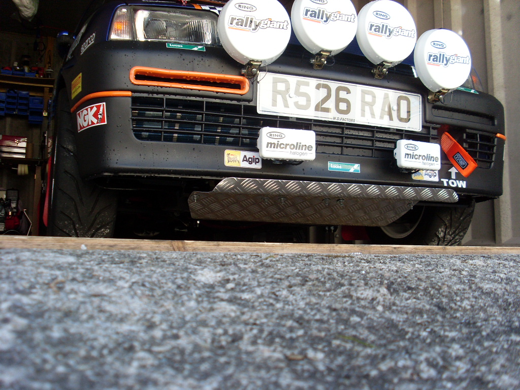

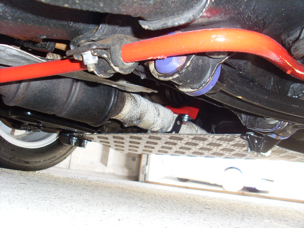

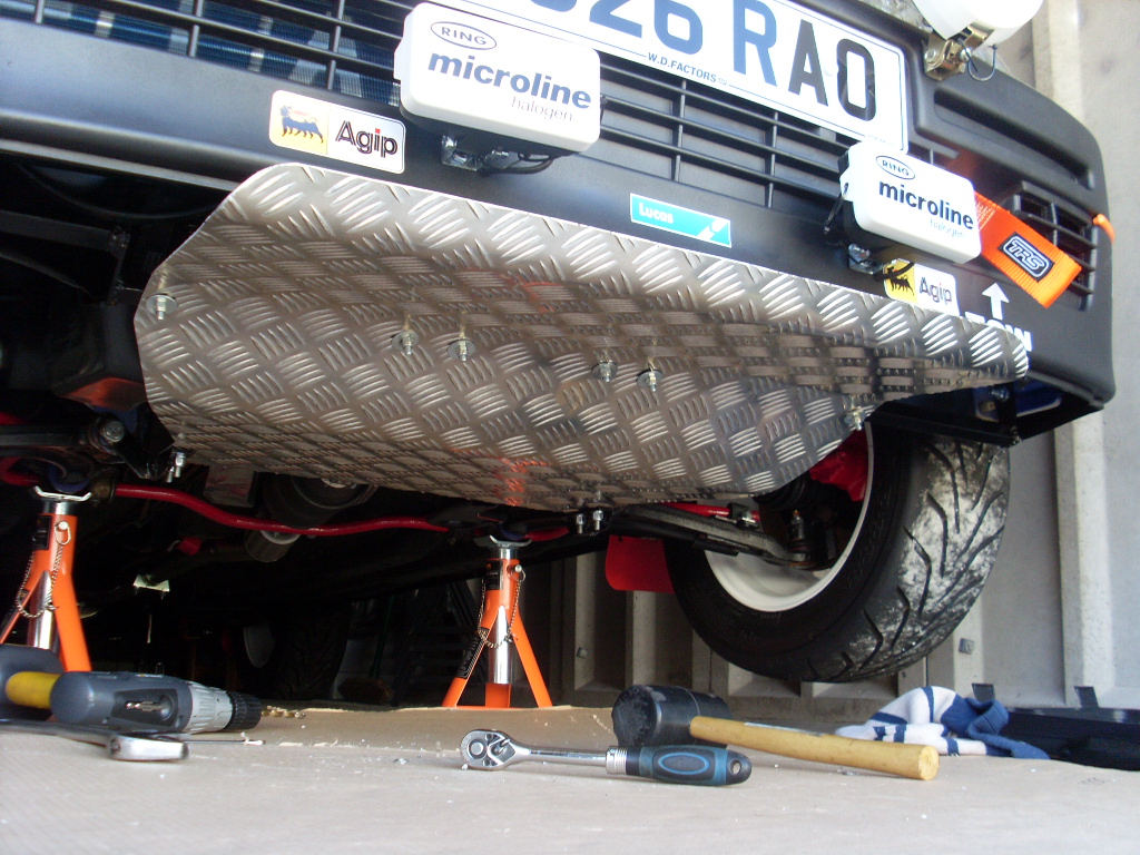

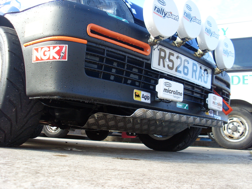

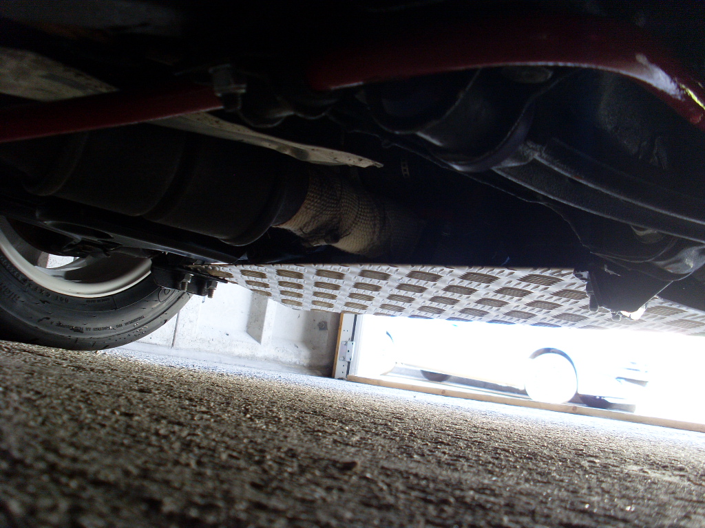

I also bought some 3mm alloy tread plate on the cheap....don't ask:D, to replace the alloy Mini Cooper sump guard i fitted a while ago,i had to change it as it was sitting far to low!,i have since gave it away to young lad building a Mini auto test car,
What i have been able to do is use all the brackets i made up when fitting the old sump guard to work with the new guard(y),which is now sitting much much higher that the old guard,
New adjustable long alloy hydraulic handbrake lever....much easier now to pull on:cool:,
