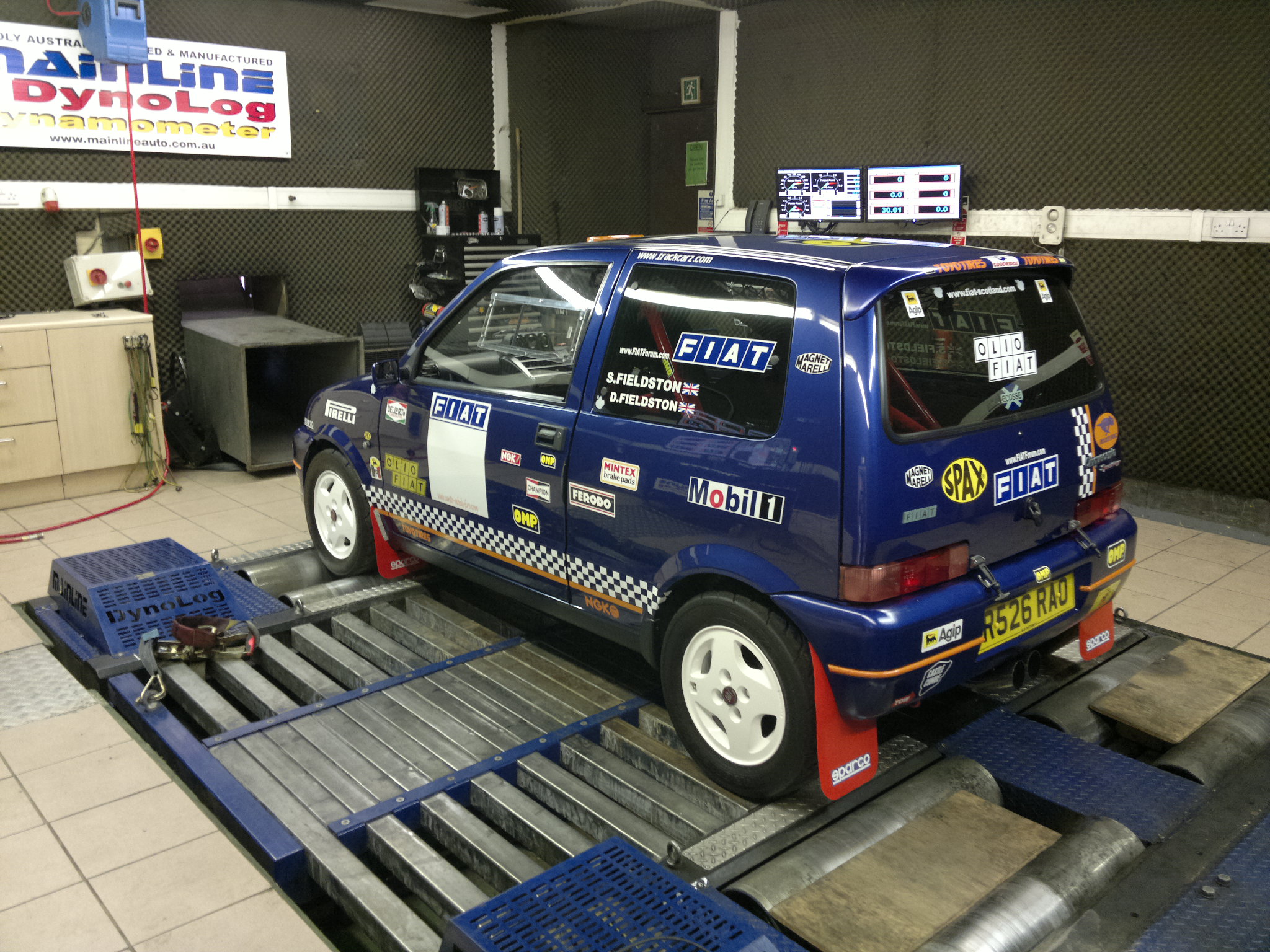

Well the little Fiat was on the dyno this morning at HQ Performance Services in my home town for a few runs and to get the vernier pulley set?,
Iam pleased to say most of it turned out positive:), which iam Happy about:cool:,

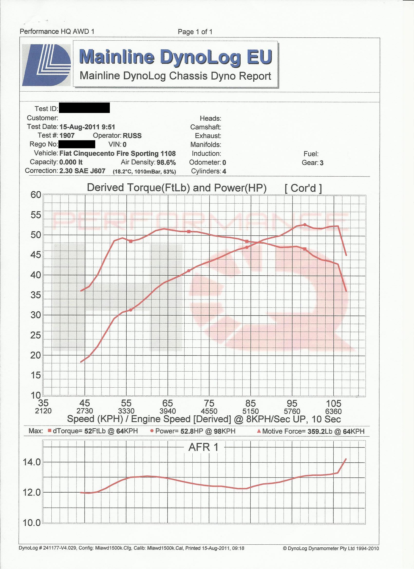

There was no need to set the vernier as it turned out when i rebuild the engine and fitted the vernier pulley its now pretty much in a good position?, yes it could have been adjusted giving me more at the top end or bottom end but the figures and HQ themselves suggested i keep it as it is, the car is now more or less set to my liking and taking there advice i have opted not to adjust it as its running well,
Unfortunately there is a down side iam afraid but its not all doom and gloom unless its all about poweeeer? which its not for me but don't get me wrong there is nothing wrong with more horses:devil:,
The problem is iam down on BHP and Torque from the last time i was on the dyno at Dastek..... but not by much!,
The delivery of the bhp is better and the torque has improved immensely across the whole rev range where as before it peaked then dropped off,
What also happened today was the last time i was on the Dyno at HQ Performance Services when they where known as Dastek they were running on a different dyno system and software and they have since changed it all, what they did say to me today is there would be a difference in the readings from there old system and its software to the new system:(,so i can't really compare my last print out to today's runs:(,they also can't give me a BHP reading at the flywheel:crazy:,as there new software works at the wheels only:crazy:,but they do hope to correct that very soon,
The last time i was on the dyno my cars readings were 73.5 BHP @ 6.633 rpm / 68.9 lbft @ 3.572 rpm at the flywheel,
Ive now got a better delivery of power at the bottom end and a torque line pretty much where you would want it through the rev range,
They also confirmed that iam neither running rich or lean!, which iam well chuffed about,
If you also look at my afr readings from before and today there has also been a vast improvement which iam also pleased about,
You will find below my old and new figures below as well as the old and new charts,
Last Dyno Run 2009
Engine: 73.5 bhp @ 6.633 rpm / 68.9 lbft @ 3.572 rpm
Wheels: 56.2 bhp @ 6.640 rpm
Today's Dyno Run 2011
Engine: At the minute they can now only estimate my Engine bhp at the flywheel as 73-78bhp because of there new system software is not set up to read the bhp at the flywheel?Crazy!,which to be honest iam not fussed about,
Wheels: 52.8 bhp @ 98 kph / 52lbft @ 64 kph
So iam down 03.40.... not even 1 bhp,
Todays Dyno Run Graph
2009 Dyno Run Graphs

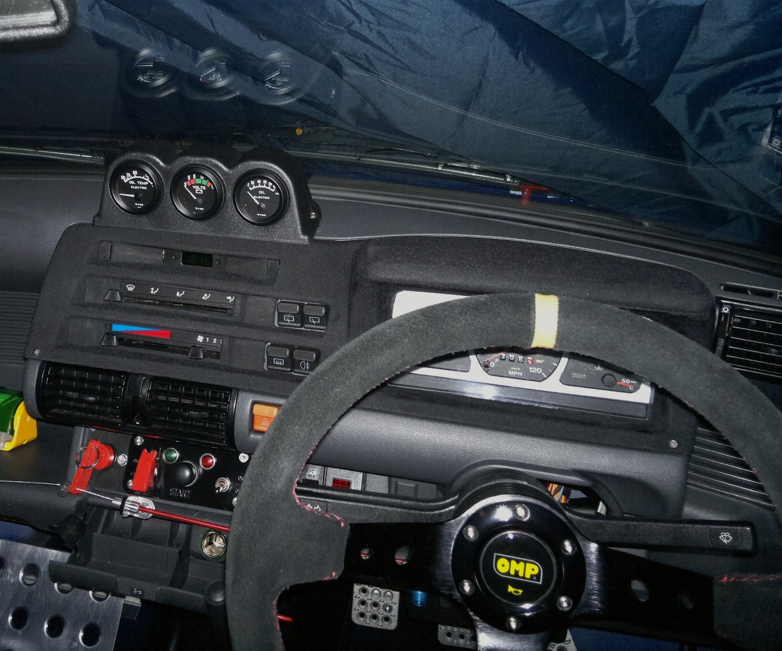

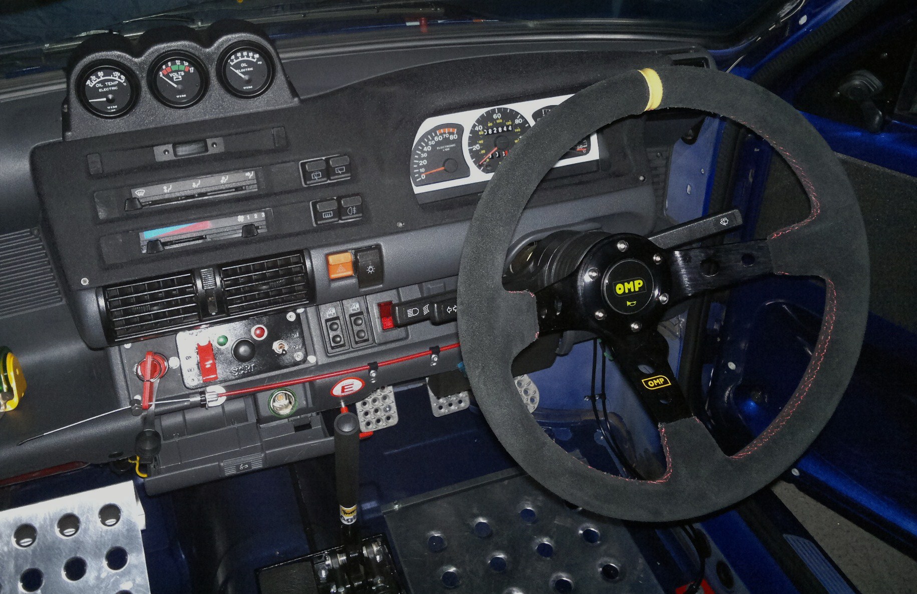

Well if anyone follows the wrc or irc rally?, you will noticed that there dashboards are flocked or even better still covered on black suede?,it was more popular in the 90's than today but its still used and seeing as iam a fan of its looks i thought i would like to have than done to my dashboard,
But i decided it would be to much if the whole dash was flocked or even covered in suede so i opted to just do my speedo surround apart from that i couldn't be bothered removing the dashboard again just to flock it,
Now its not a job you can do in situ as its way to complicated and messy,now because i only opted to do my speedo surround i thought i would do it myself using a black diy flocking kit from Frost Restorers Equipment,now its not easy to do and very messy and it took me more than one application to good results but Ive managed to pull it off to a pretty good finish to match my suede omp deep dish steering wheel,well pleased.
If anyone is interested is doing it?, and doing anything larger than Ive just done i would think about using these guys but the down side apart from the price is you do need to remove the part your looking done to send sown to them so it can be costly,
http://www.getflocked.co.uk/
Cheers Scuderia

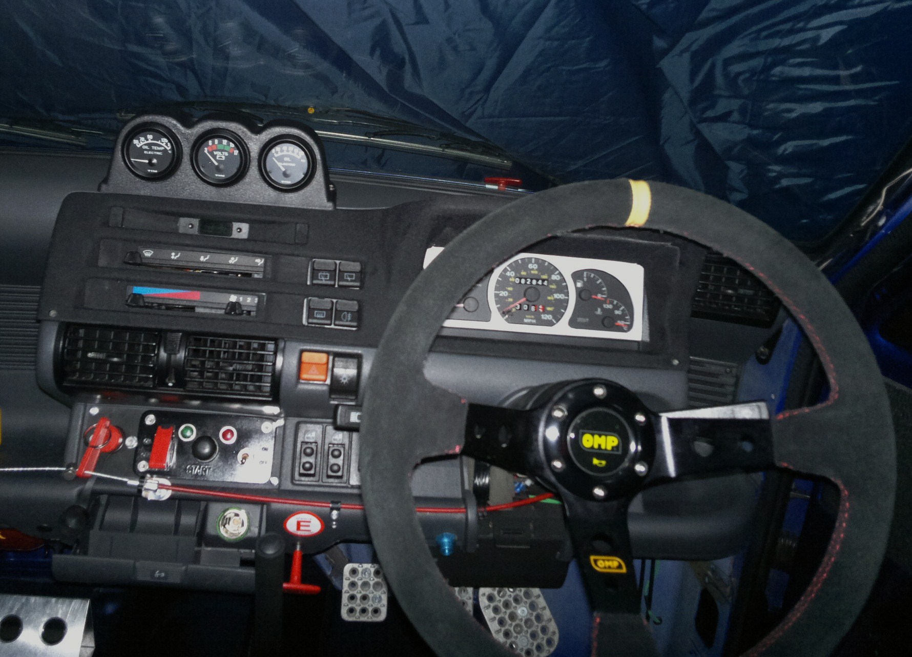

Hi All,
Well i had 5mins today to get the speedo surround bolted back on after it being flocked so here we are,
Ive managed to get a pretty good match between the omp deep dish steering wheel and surround so iam pretty pleased,that said i wish i had also done the gauge pod......ive still got some flock left over so i will do it down the line when ive got the time,
Cheers Scuderia
