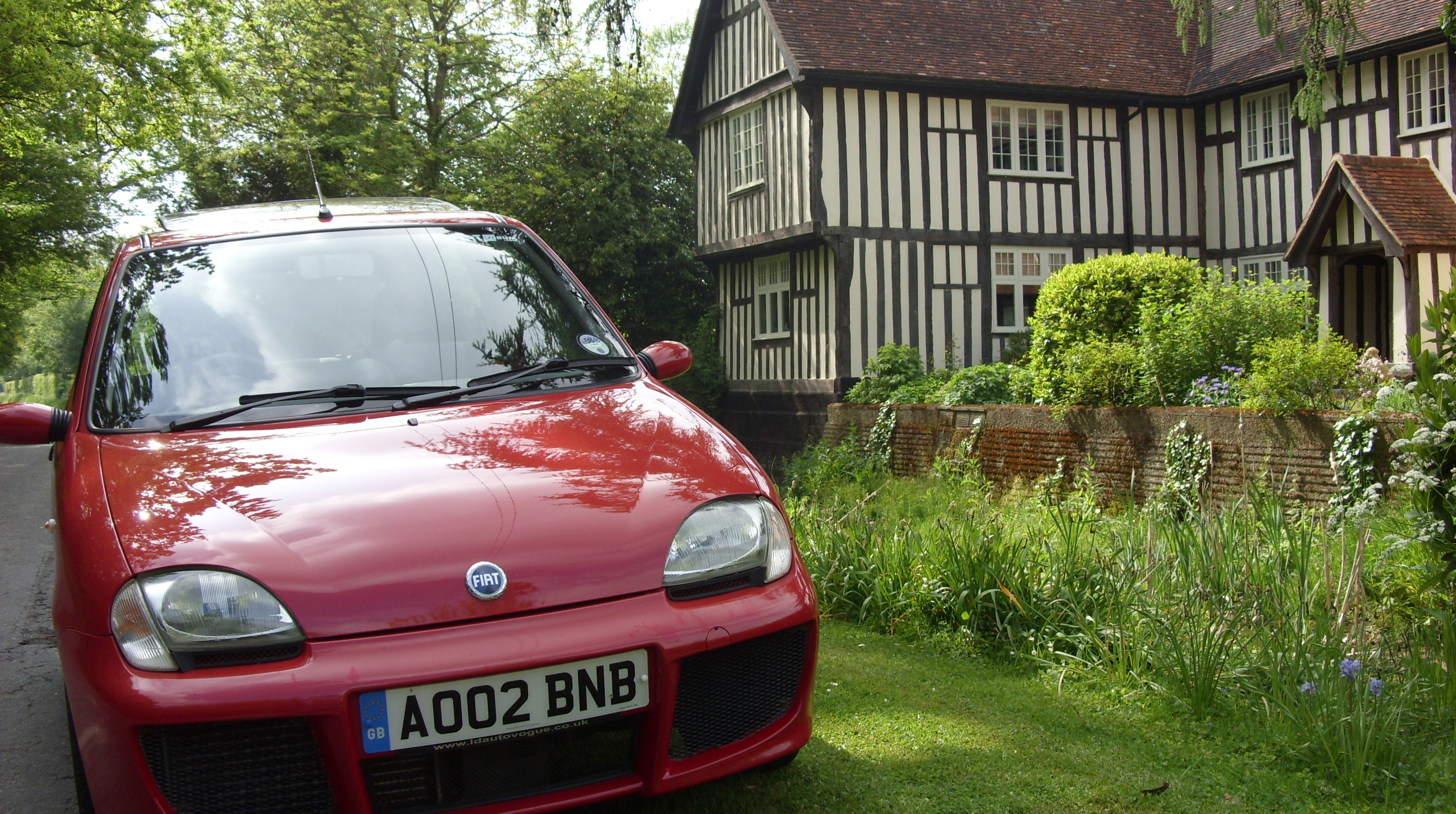

Well this is my pretty much standard Red(ish) Seicento...
I've had it since September last year, was at 71,000 miles and we're now up to 78,000 and now going stronger than ever :)
I haven't done much yet, mainly due to my insurance being so high since I'm 18.
Had an oil change & an ITG Foam Filter. Also got a new clutch and rear wheel bearings along with a new handbrake cable.
And of course I had to fit Abarth centre caps and black/red floor mats ;)
I've got some drilled discs and new OMP Sport pads to go on sometime soon.
(Sorry about the picture quality, I used my phone)

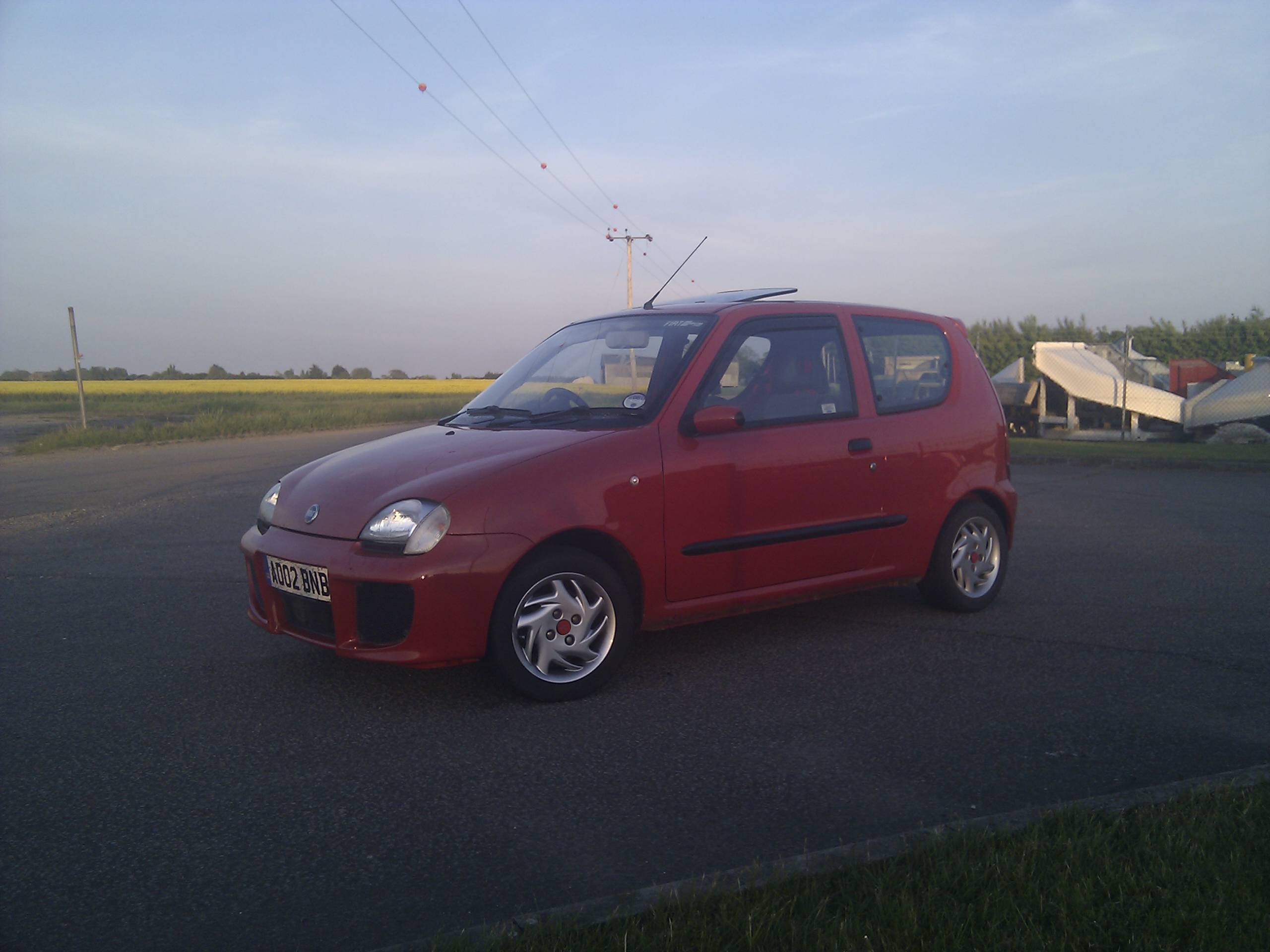

I've made it back in one piece! I have to say the handling is now superb!! :D
It really corners nicely now, there's so much less understeer and the turn in is now fantastic. There's much less roll and more steering feedback, feels much more like a go-kart It's pretty bouncy now too lol plus it looks pretty cool with the subtle lowering :cool: I found myself giggling like a little girl on the way home :eek: and a little bit of cheeky tire squeal on roundabouts turned some heads :devil:
I will be looking into getting the tracking sorted asap since it was already way out before the springs went on, the tires are being destroyed :bang:

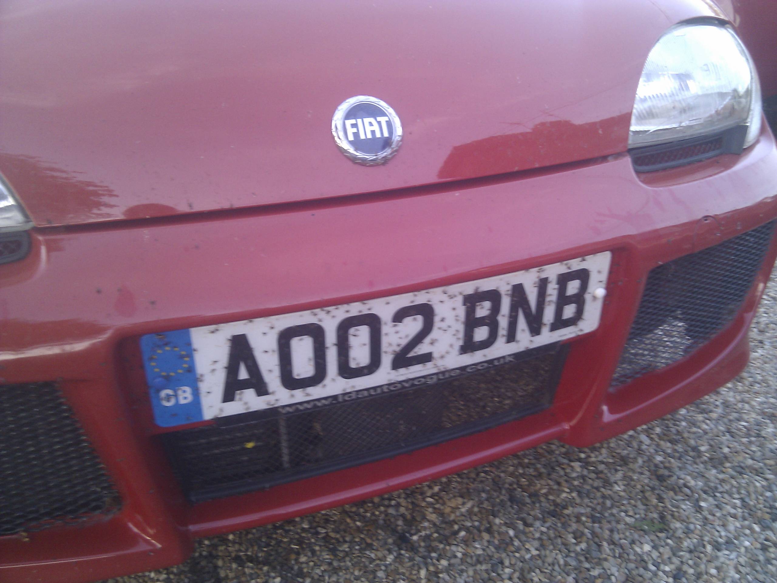

And to top it all off, suffolk seems to be the insect capital of the world, at one point I had to get out and clean the windscreen because I could see anything and the wipers are s**t.

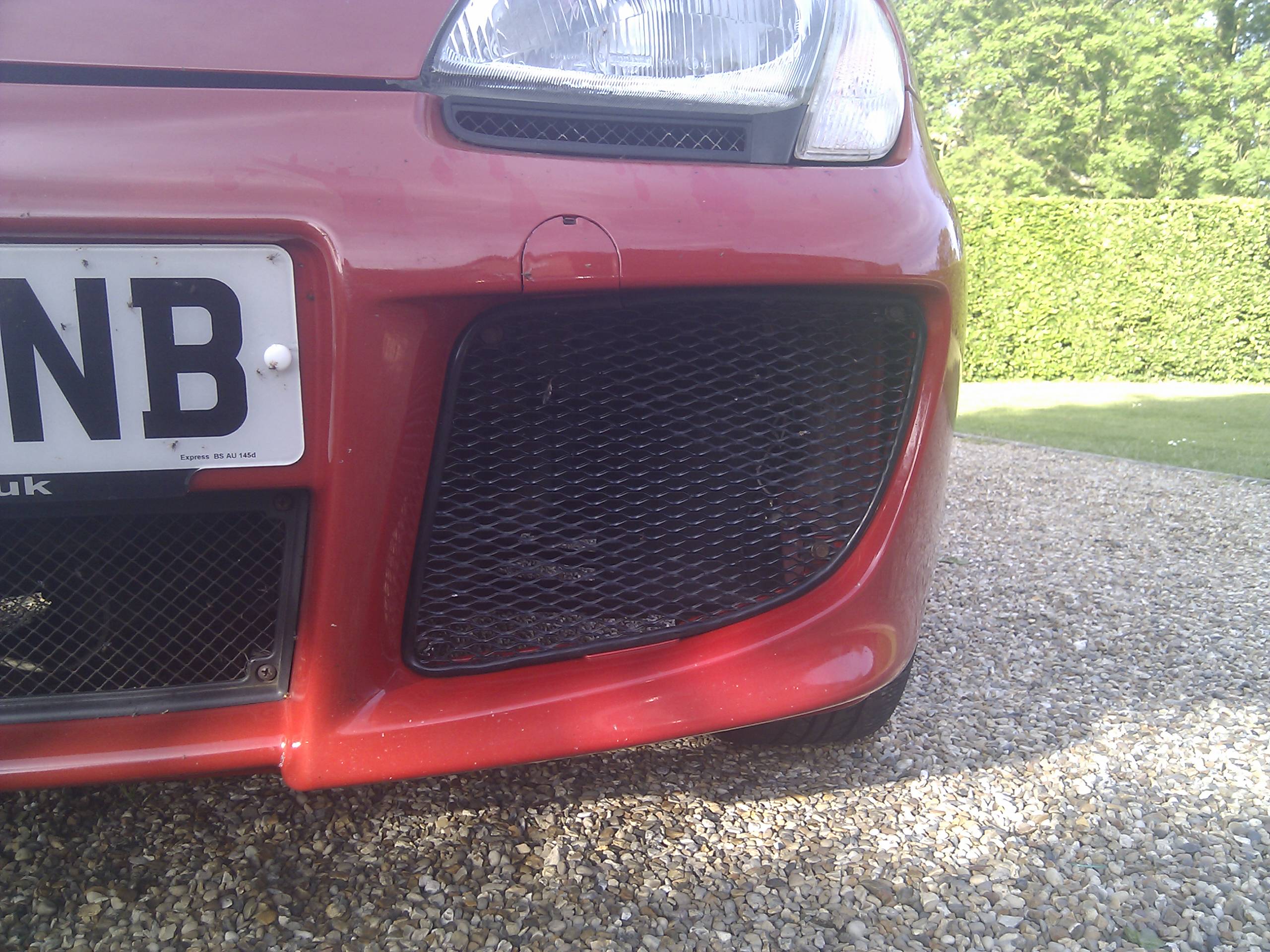

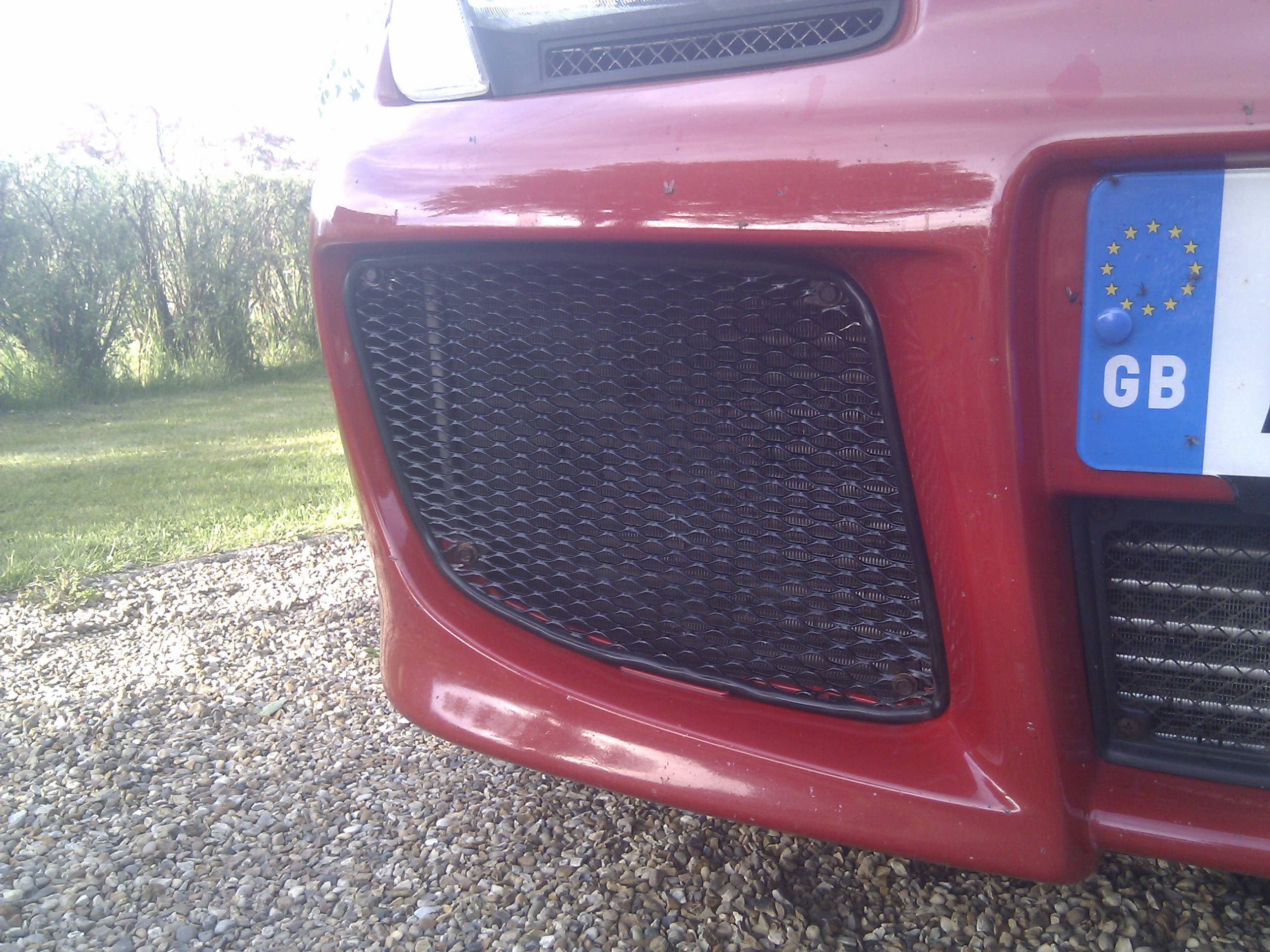

I took Lecook's suggestion, got myself 2 meters of black tubing off ebay and wrapped the sharp, DIY looking edges to my mesh grills, it looks alot better :)
Although it took me about 15 painstaking minutes cutting the tube from one end to the other, the stuff I bought happened to be pretty tough :rolleyes:
