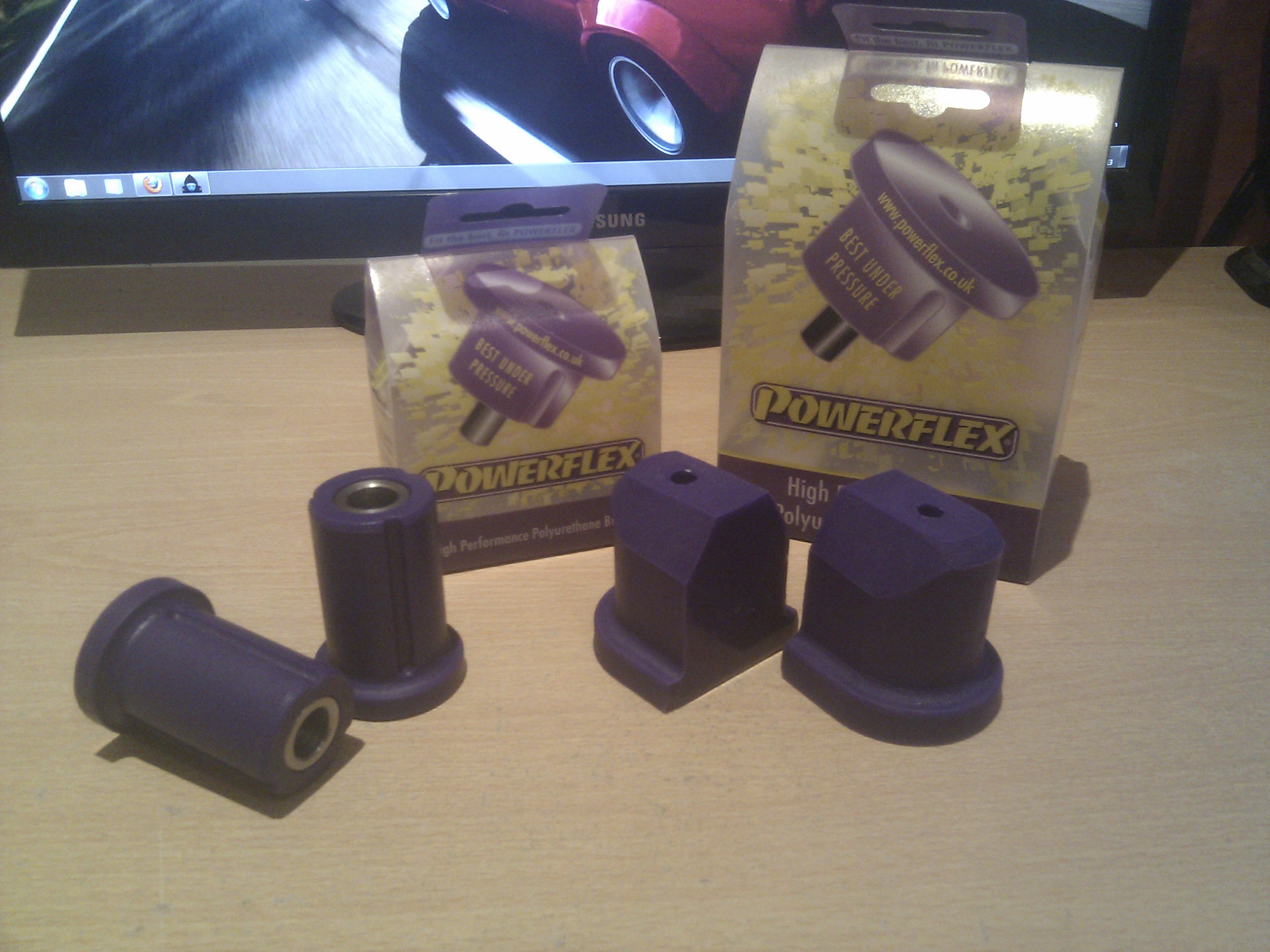

Well after a little delay due to one of the arb brackets snapping I've got my car back after the MOT. Only the front rear bushes went on as the wishbones came with new bushes on as the wishbones came with new bushes. Other than that a new alternator belt and some track rod ends it passed without a single advisory :D
I have to say just those bits have made a huge difference, no more clonking over bumps, the steering is more responsive and it can corner even faster now :slayer:
