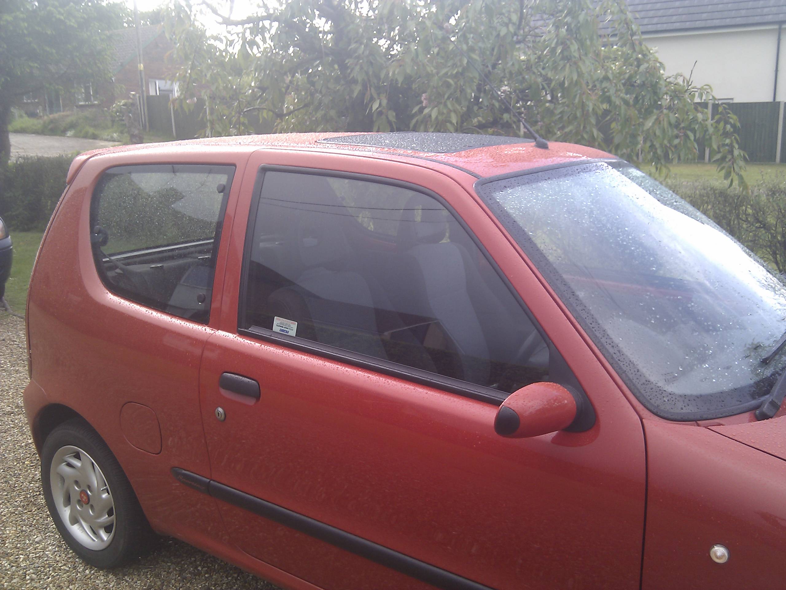

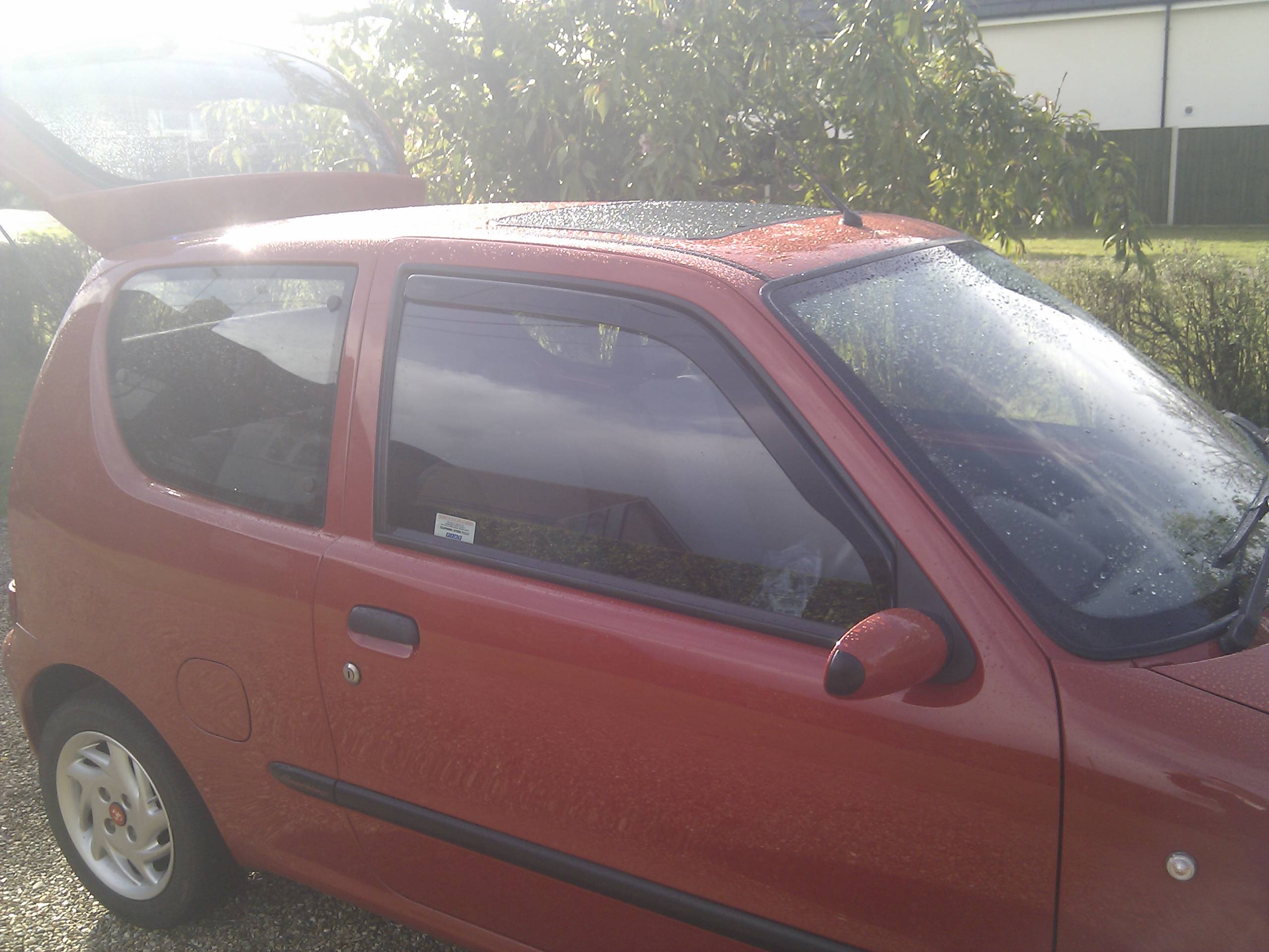

Well this is my pretty much standard Red(ish) Seicento...
I've had it since September last year, was at 71,000 miles and we're now up to 78,000 and now going stronger than ever :)
I haven't done much yet, mainly due to my insurance being so high since I'm 18.
Had an oil change & an ITG Foam Filter. Also got a new clutch and rear wheel bearings along with a new handbrake cable.
And of course I had to fit Abarth centre caps and black/red floor mats ;)
I've got some drilled discs and new OMP Sport pads to go on sometime soon.
(Sorry about the picture quality, I used my phone)

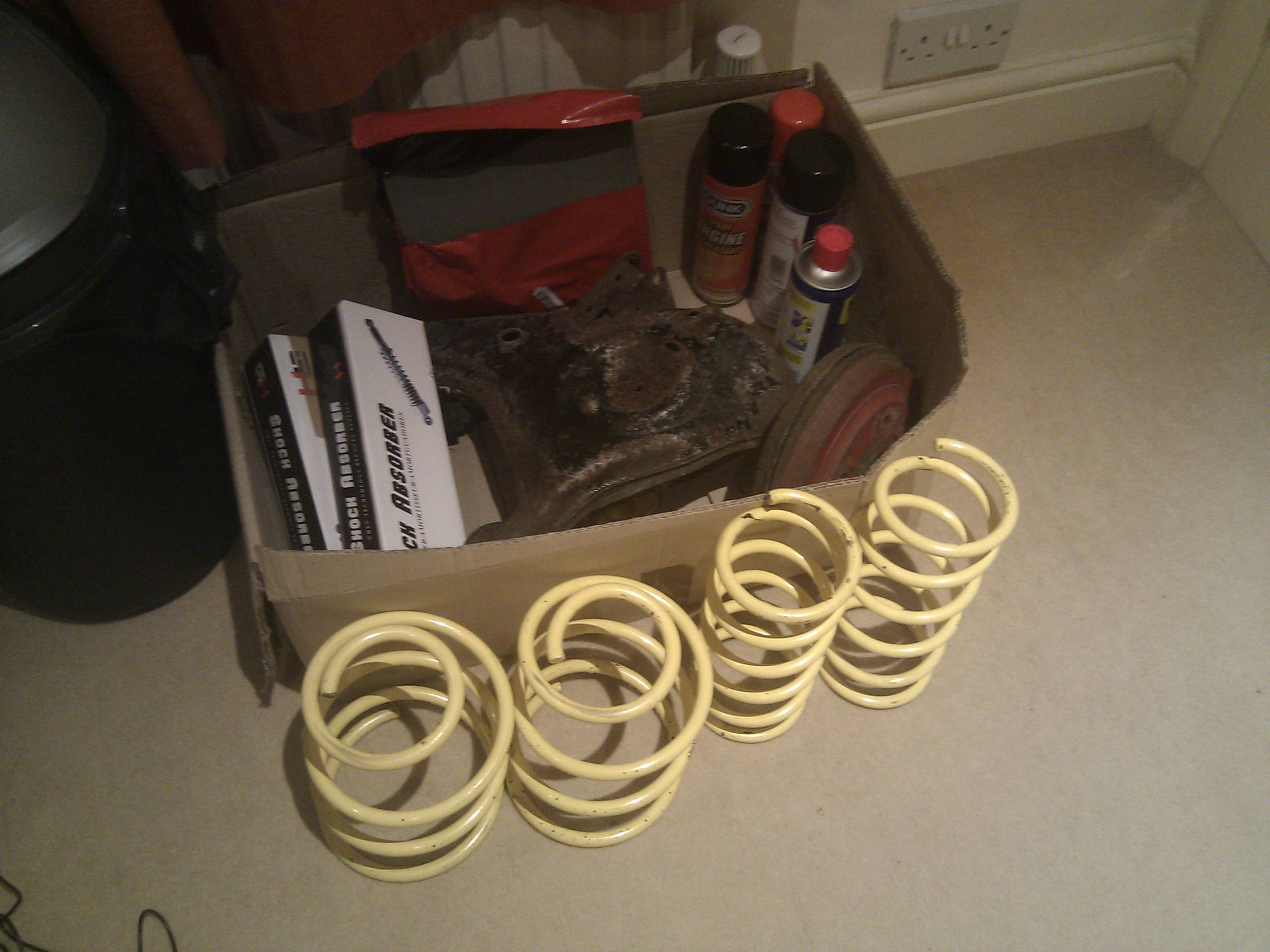

With some great help from @Lecook today :worship: it looks like I need some new rear shocks as the current ones are well on their way out and it appears the vibration is coming from a bent rear stub axle on the drivers side. My main concern is that wheel may be buggered aswell...
The garage found nothing wrong with the car in a whole day nor during the mot and gave the impression they thought I didn't know what I was talking about yet Lee spotted these things in just a few minutes :worship:
As long as I can find a rear trailing arm I hope to get this sorted soon, then maybe I can start looking at some upgrades :devil:

Finally it looks like the problems are on the way to being sorted! :D
With some great help from @Lecook today :worship: it looks like I need some new rear shocks as the current ones are well on their way out and it appears the vibration is coming from a bent rear sub axle on the drivers side. My main concern is that wheel may be buggered aswell...

change garage
think about attending an auto maintenance course
breakers yard for replacement arm they are expensive new
ask ins company before pimping
Get those skirts on and the springs will make it all come together ;).... actually ...... this is going to be one busy weekend :p got your sei to do my sei to sort out, my missus punto to sort for mot and maybe even get some bits done on the cinq, jeeeez im glad its a bank holiday lol
Edit: remember to give those rear shock bolts a good coating with that wd40 over the next couple of days ;)
