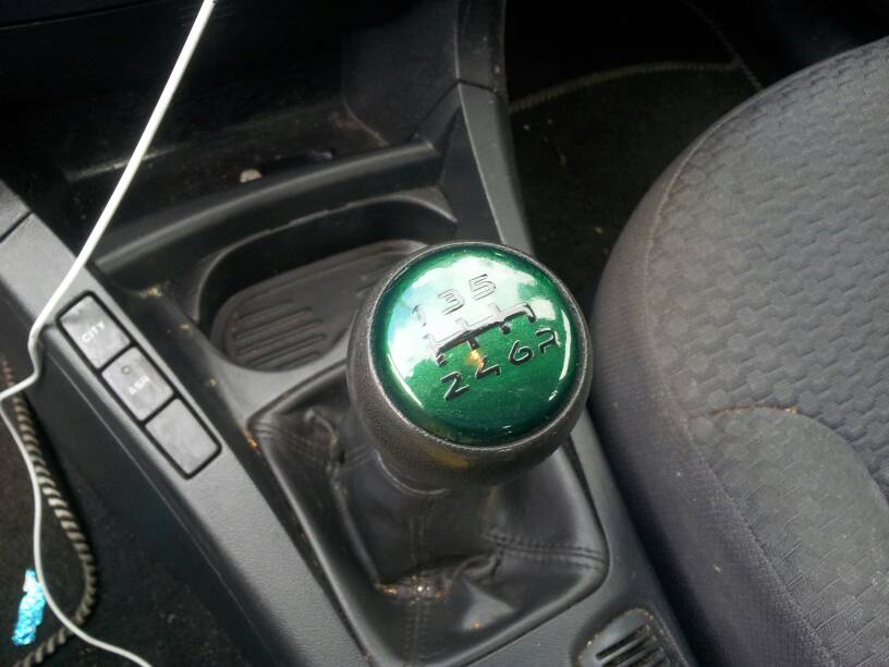

So small update really few more things done my gearknob insert was really worn so changed it heres how it now looks

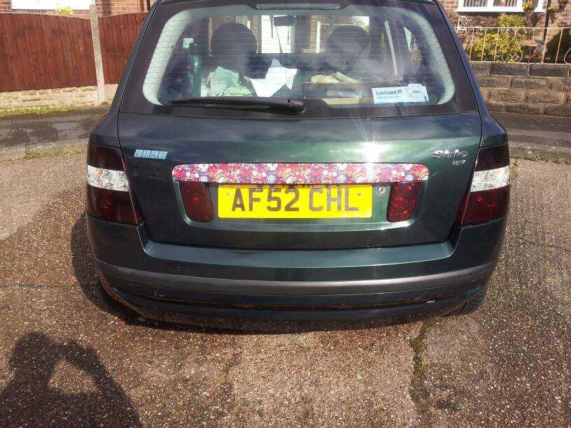

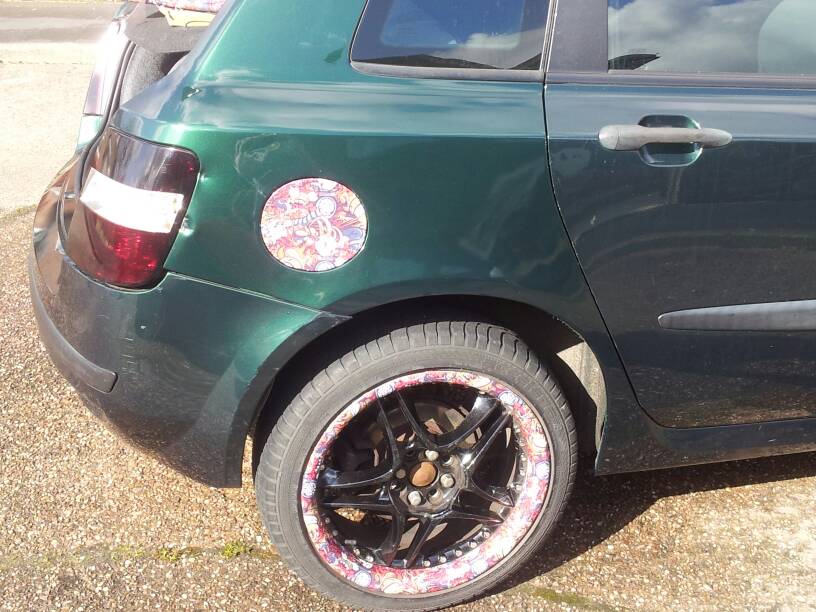

Fly eyed the fogs to match the rear lights sticker bombed the boot grab plate and sticker bombed the petrol cap cover more will be done :)

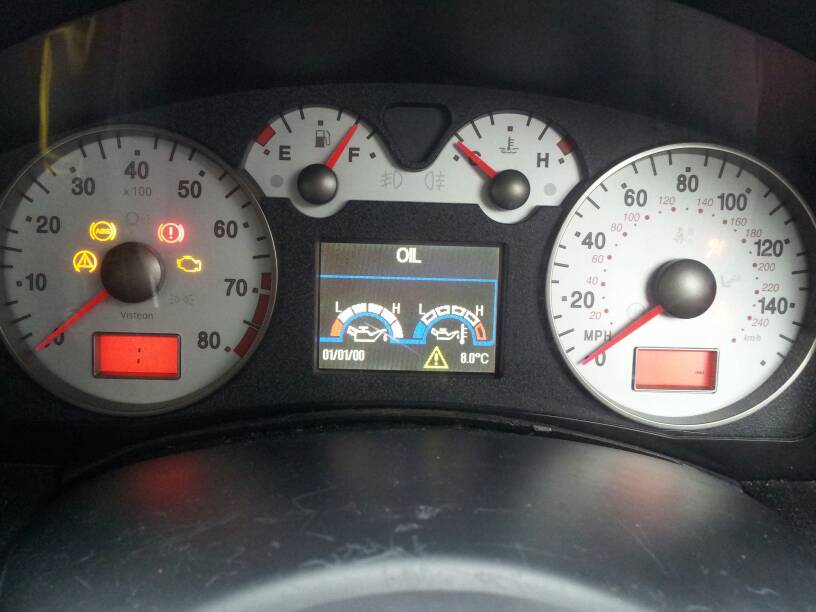

So not updated for a little but more is to come firstly when swapping hubs i noticed the cv bolt was perished so now swapped but damaged the abs sensor so ordered a new one and will be fitted wen it arrives also got a lovely set of arbarth clocks which are fitted but does anyone know how to change date abd time as tried the same as originals but no joy lol any help appriciated :) more will be added as they come

Not sure, but you may need to carry out the proxy alignment procedure to be able to adjust the date and time.
Out of interest, are the oil pressure and temperature gauges working? or do they just remain at zero? I think only the 2.4 engine has oil pressure and temperature senders.
Cheers for the help davren not sure with the oil pressure/temp yet as not driven anyehere :lol: but will post up the answer when i do today. How do ya do the proxy alignment procedure on the stilo
Either at a Fiat dealer on their Examiner machine, or you can do it yourself with MultiEcuScan. Assuming you don't have MES, if you add your location to your profile, someone close to you who does, may offer to help.
Not sure that it will cure your problem though. I think the display would show 00:00 if the time only needed adjusting. Perhaps the display is faulty.
Ye will add my location mate cheers for the help and the time is working aswell as the mileometer and no the oil pressure/temp isnt a working feature on mine whuch is a shane as would look cool with it giving readings
Does the oil pressure light work on yours? It didn't work on my JTD, so I modified the panel to use the spare 120km/h warning light, and ran another wire from the engine management ECU connector to that warning light.
wonder if its possible to retro fit the sensors and then get them working???
I do love the look of the Arbarth clocks but there are issues fitting them to the JTD's.
I investigated it a few years ago when I fitted the high level instrument panel in my JTD.
You could probably fit the oil pressure gauge sensor (13) into a banjo union with the oil pressure switch (9), but the oil temperature sensor needs to be screwed into the sump somewhere. I didn't fancy guessing a place to drill it in case the sump wall was too thin to be threaded, or there was an obstruction inside the sump.
Even if you fit the extra sensors, there's still a chance that they may not work.... The proxy alignment procedure may not recognise them because the wrong instrument panel had been fitted to a JTD. (Even though the handbook shows diagrams for it in a JTD).
Way to go would be to test it with 2 variable resistors first.

Not from what ive seen so far but should have it proxy alligned tomorrow. And as an update ive thought long and hard and decided to rewrap the wheels and take the sticker bomb off them so will pic it up when the wrap has arrived and been put on the wheels
