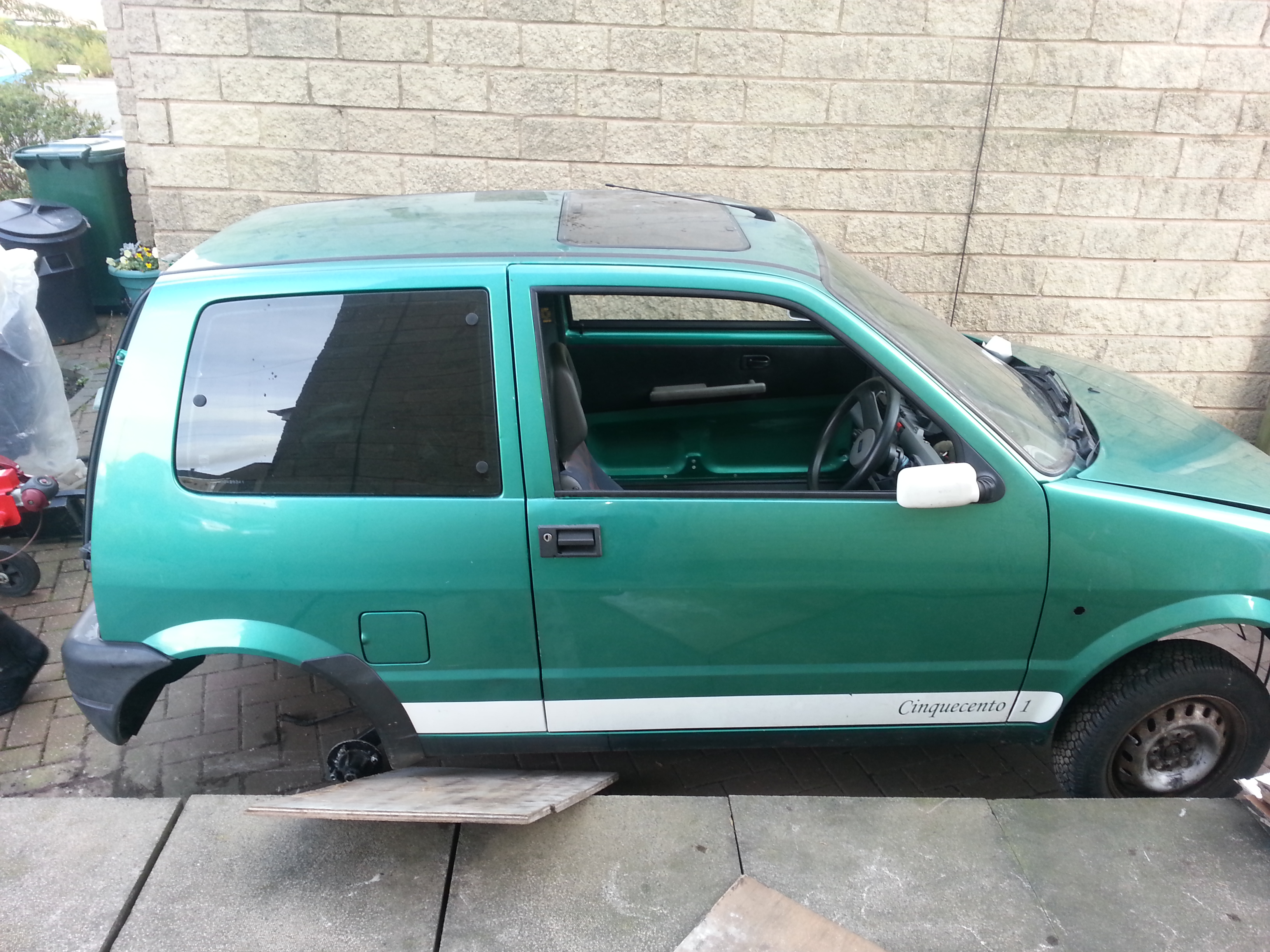

The day i got the cinq sx with its crap racing stripes :p
looking rather good for its age 1995 no rust no dents no deep scuffs
i previously owned a mk1 punto 60s but ive always wanted a cinq so after i purchased cinq i striped the punto down to bear chassis including engine and gearbox :D loom and so on ive been collecting parts for the 1.2 conversion for a while p75 cams full engine rebuild re skim using a big cnc machine from college :) cinq gearbox and mounts ect

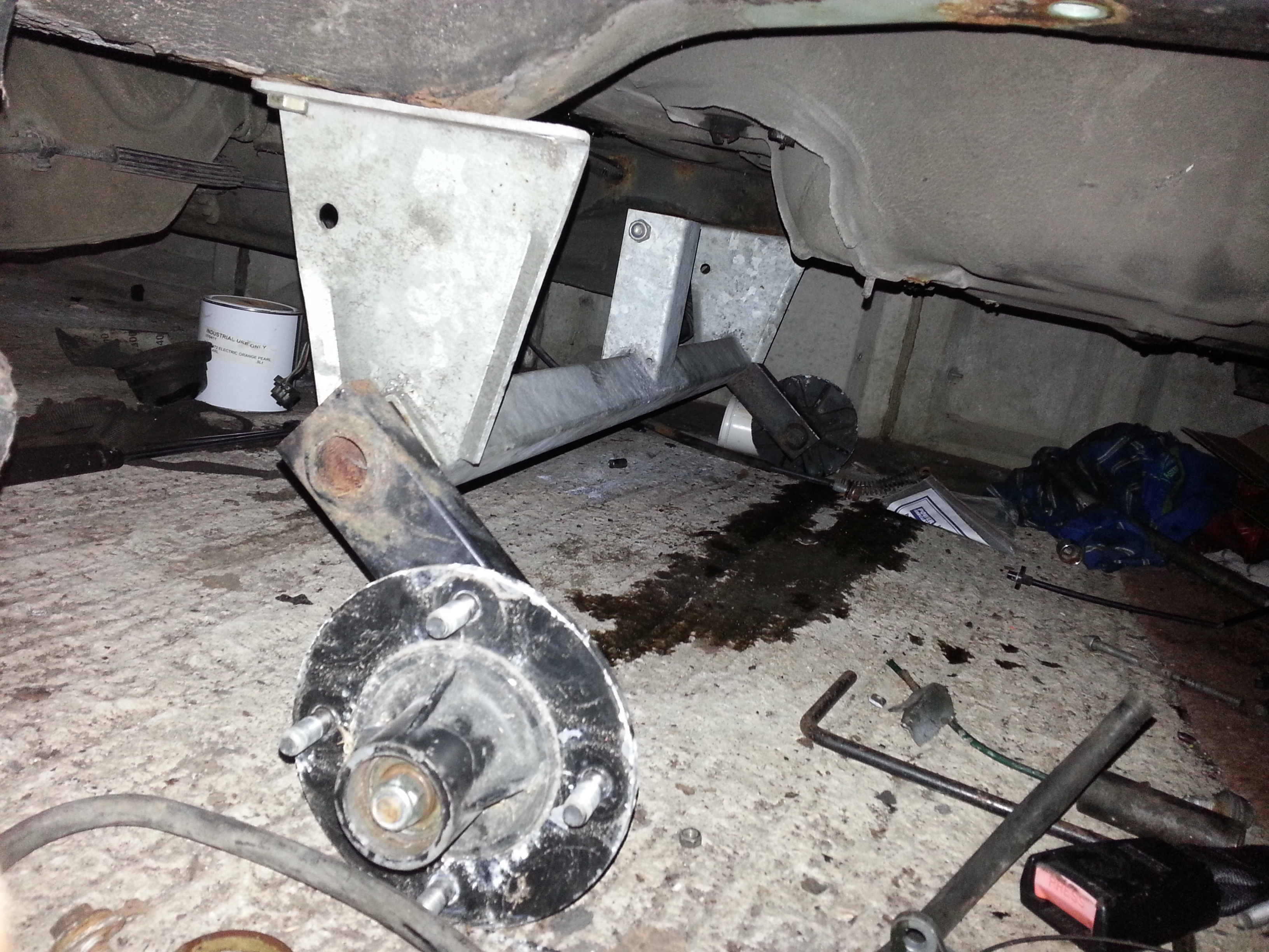

Right got a small amount of stuff done today back end is on wheels as I'm going to turn it around on weekend with some mates when I say its on wheel what I really mean its on a small trailer axle yep a small trailer axle bolts straight on lol just to rot at then its just coming of :D
right probably not going to use rs4 diff half shafts hubs the plan is to use all front end sporting half shafts hubs and use the rs4 subframe with a 11 inch chop ibn center effectively same with as the standard sporting oh and this subframe is lighter than the standard one aluminium more or less everything except the main subframe oh and loads of alignment points (concentric bolt heads and washers with key ways in them) this frame is immensely strong and the sale of the diff and half shafts will pay for my engine management and other goodies:)
