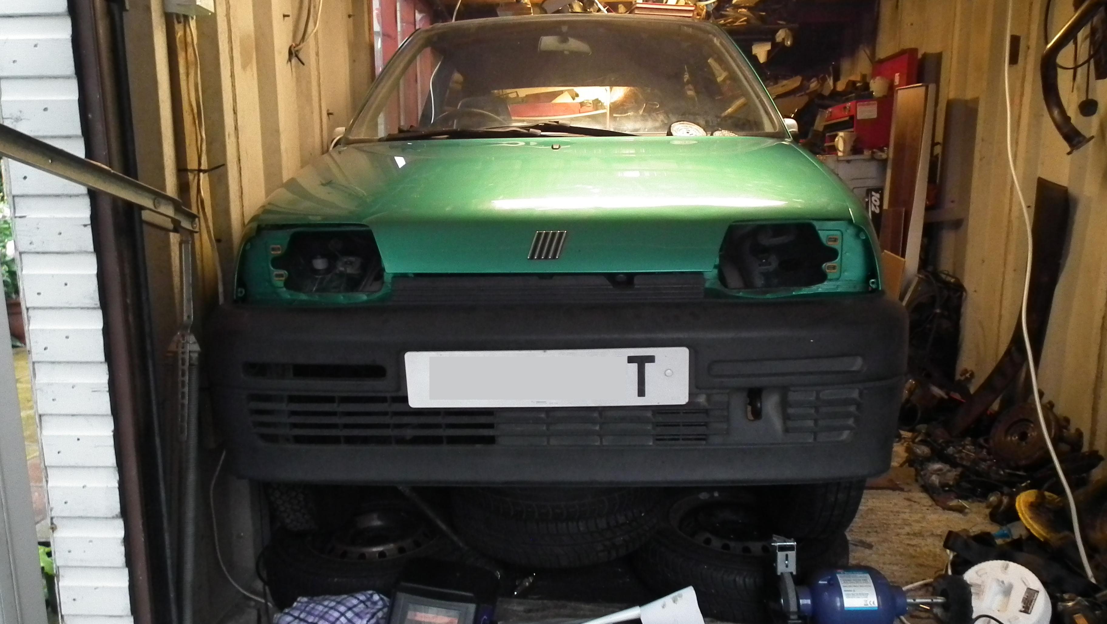

Cinquecento my green cinq project.
The day i got the cinq sx with its crap racing stripes :p
looking rather good for its age 1995 no rust no dents no deep scuffs
i previously owned a mk1 punto 60s but ive always wanted a cinq so after i purchased cinq i striped the punto down to bear chassis including engine and gearbox :D loom and so on ive been collecting parts for the 1.2 conversion for a while p75 cams full engine rebuild re skim using a big cnc machine from college :) cinq gearbox and mounts ect

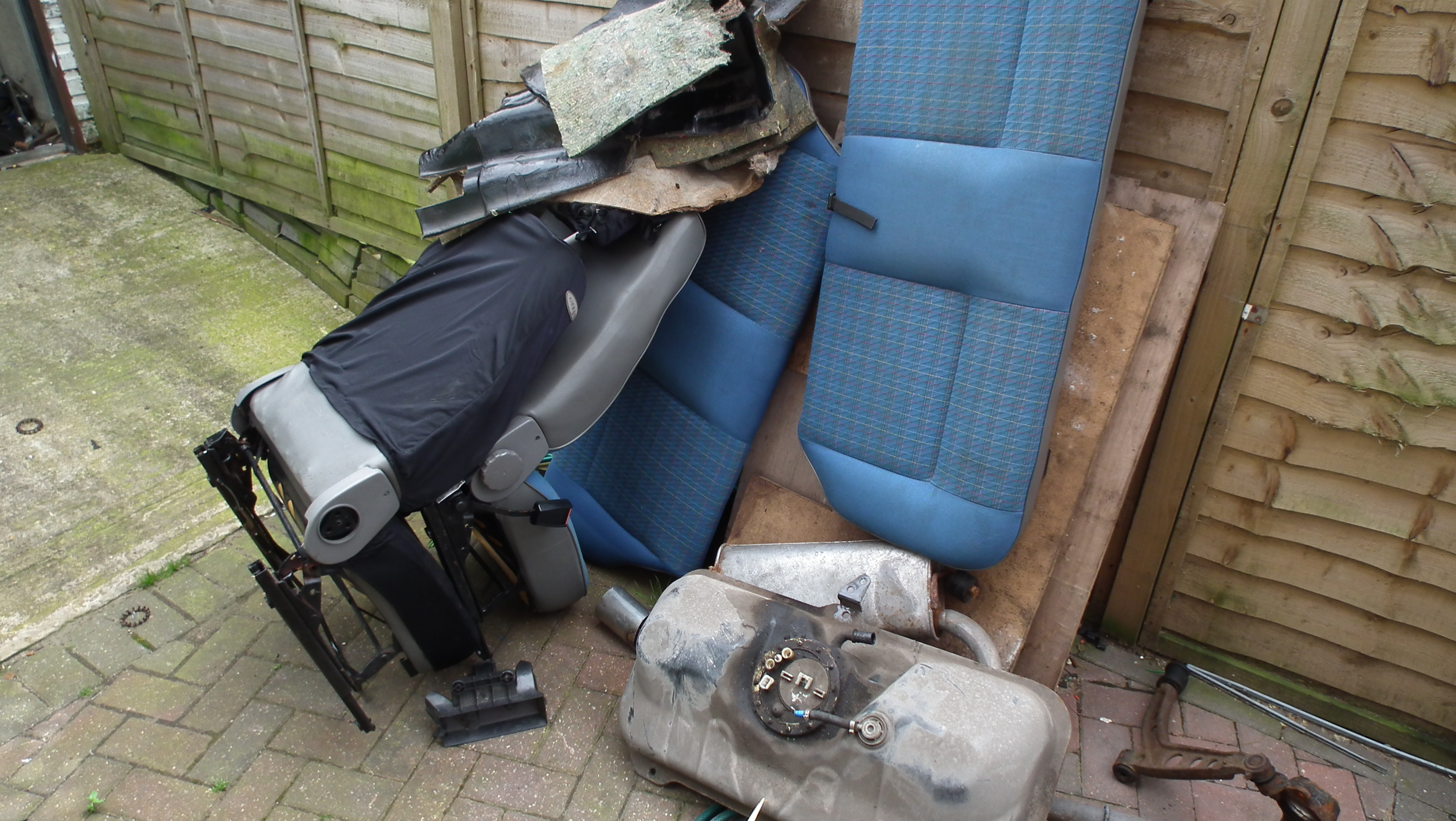

mini up date not been lazing about :p fuel tank is out and been getting back up to scratch with tig 200 pounds for pure argon :O and going to order 7m of cds may make out of chromoly (t45) later on oh and taking petrol tank out side and one half snagged on trailer and it swang into the car a small scratch :(

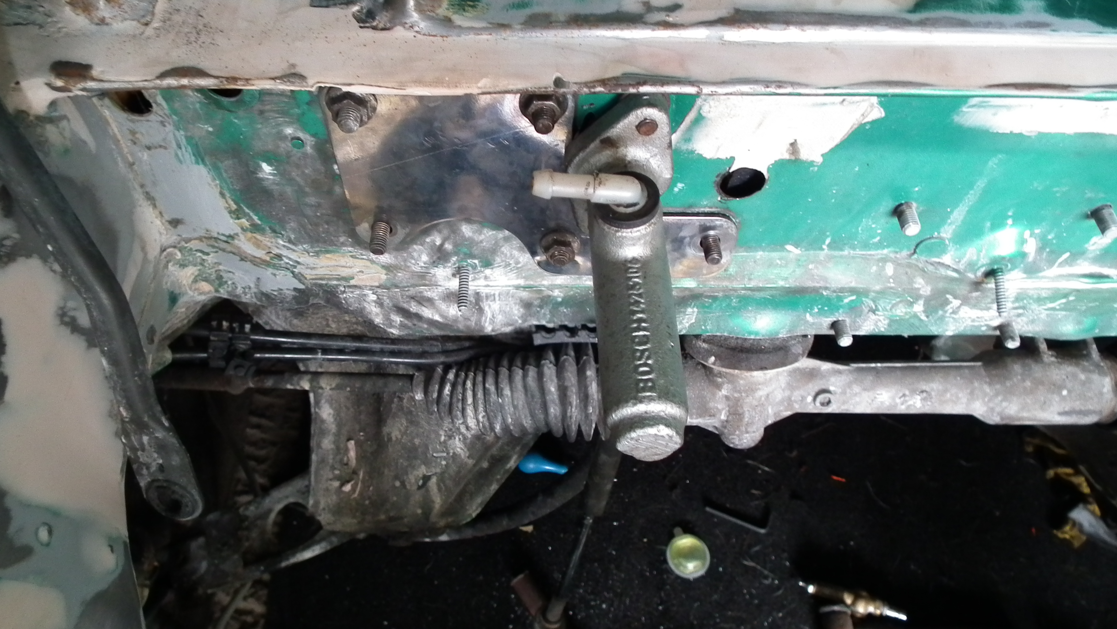

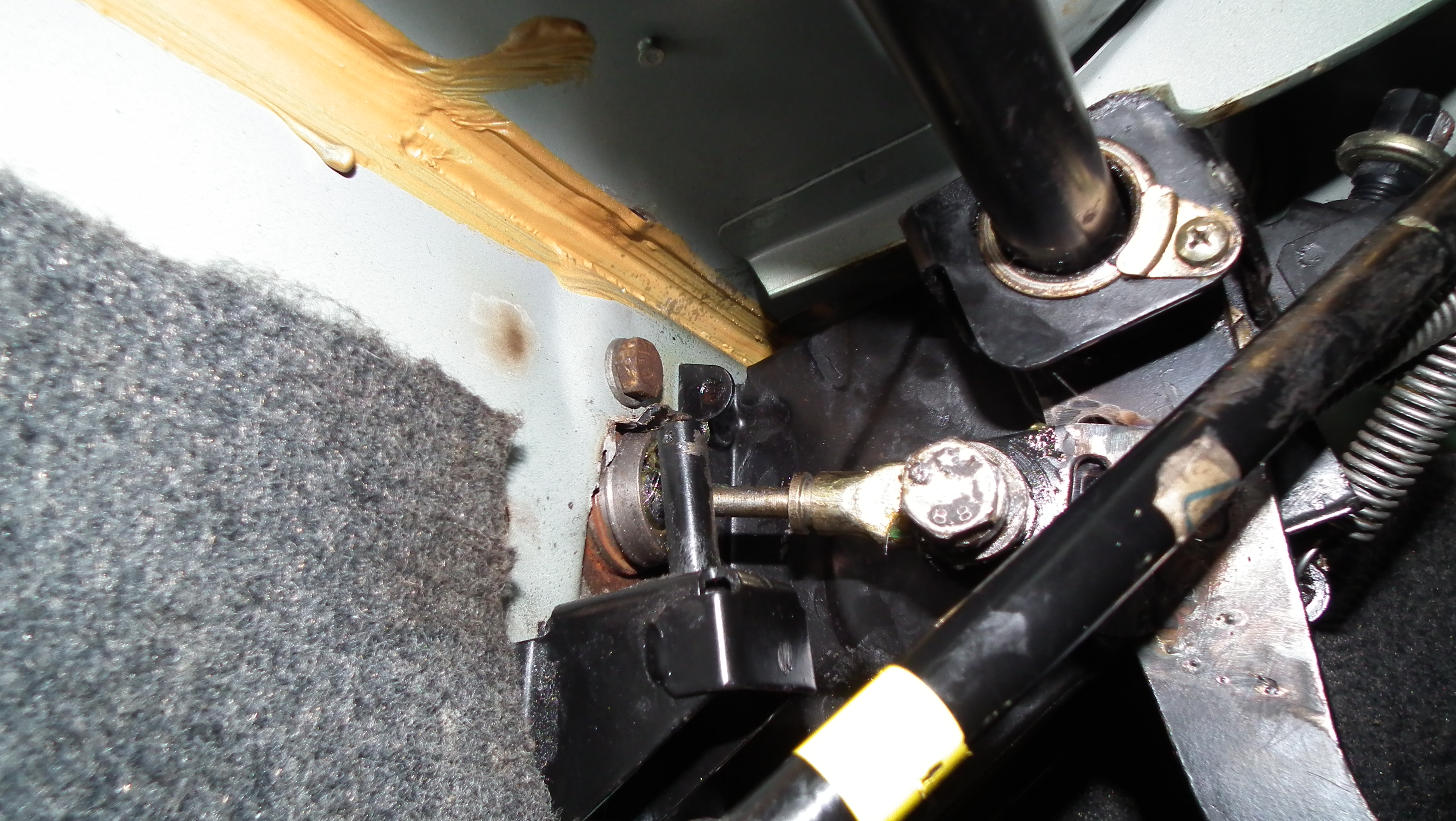

it sounds easy and it is fairly straightforward on the bulkhead side of things but when it comes to converting the gearbox it's a whole different story because there is no mount for the slave cylinder on the cinqs standard upper selector casting and its not as easy as swaping the selector from the punto on to the cinqs box well it is but the selector spindle it's totally different it can be done but the work involved makes no sense plus with cable not a lot to go wrong (y)

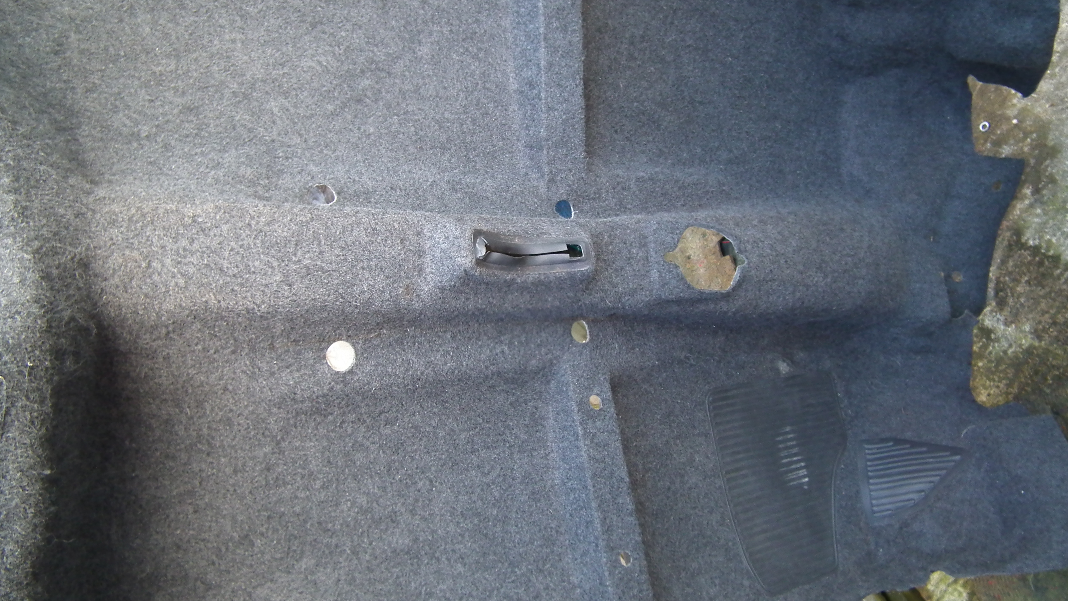

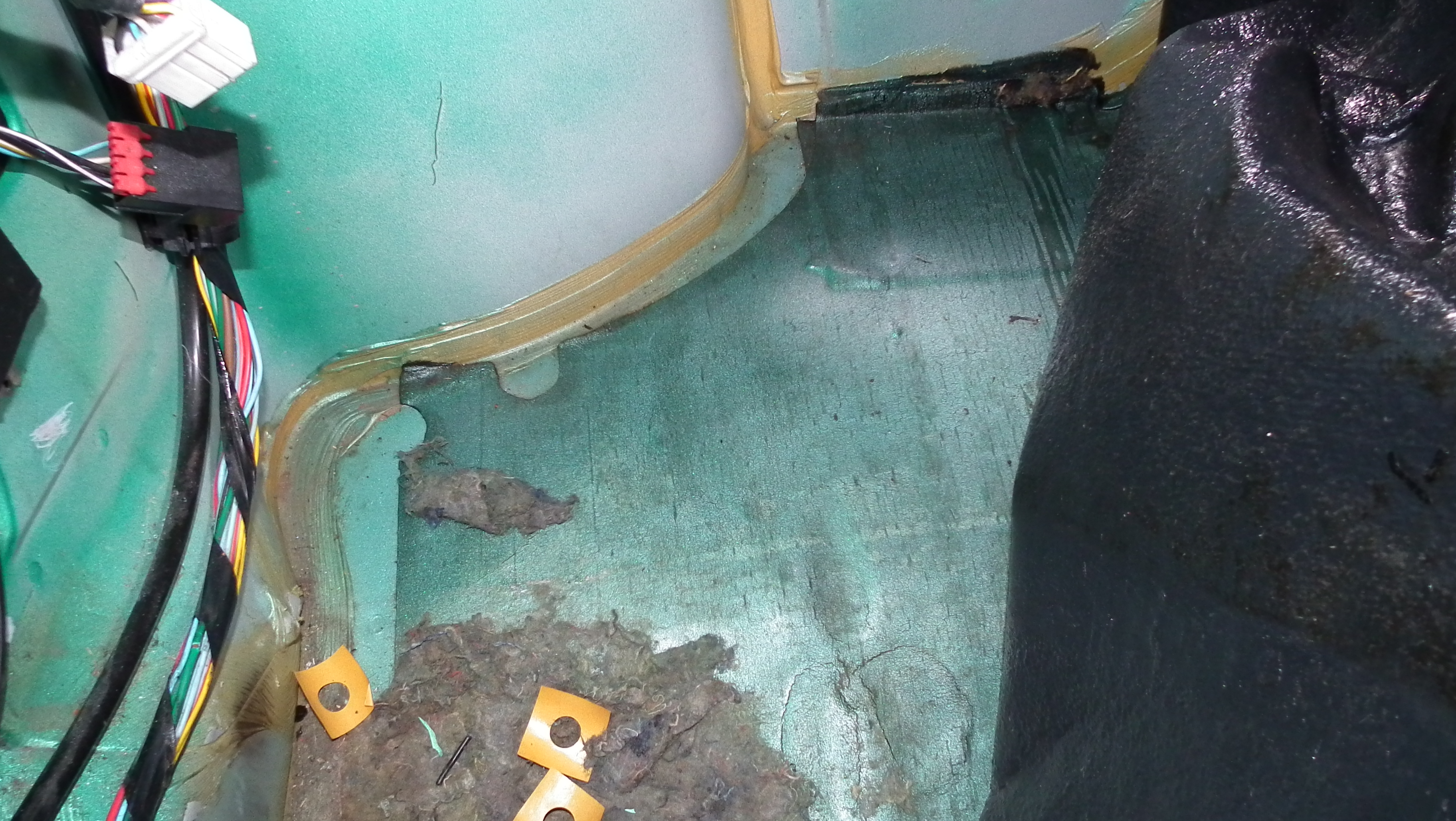

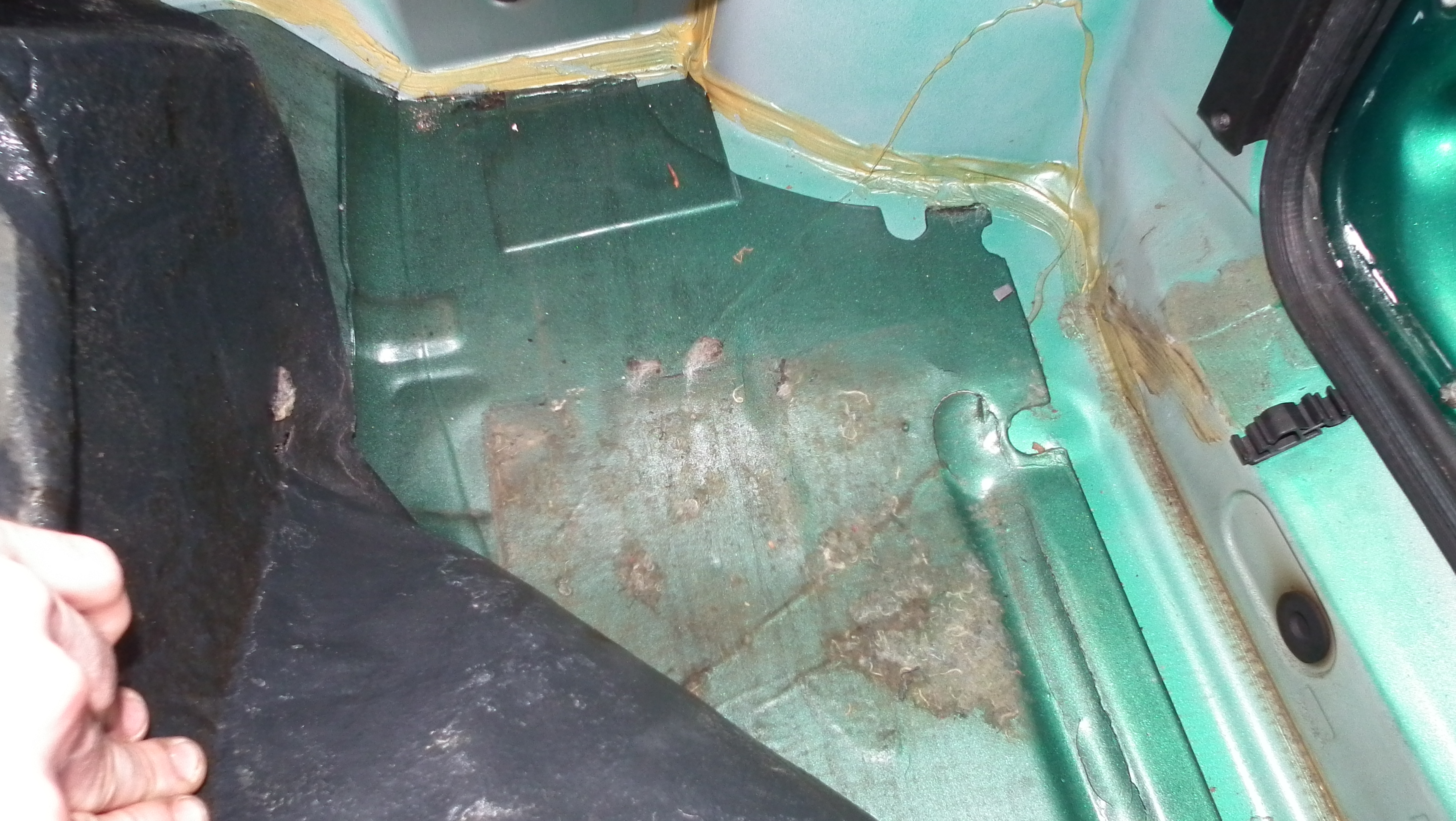

i found rust !!!

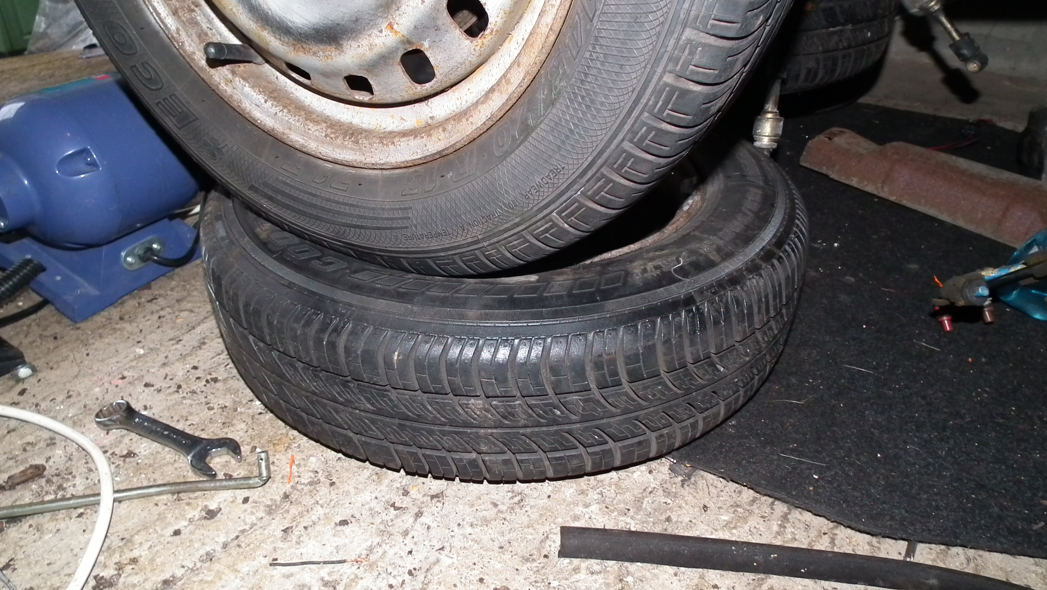

and ran out of axle stands for the front :p

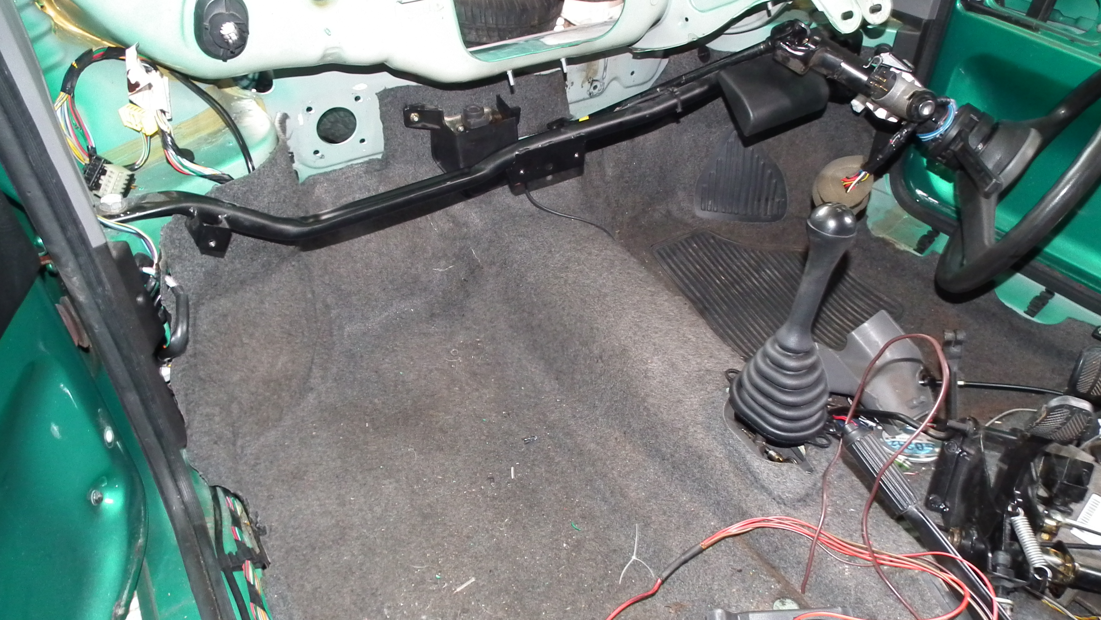

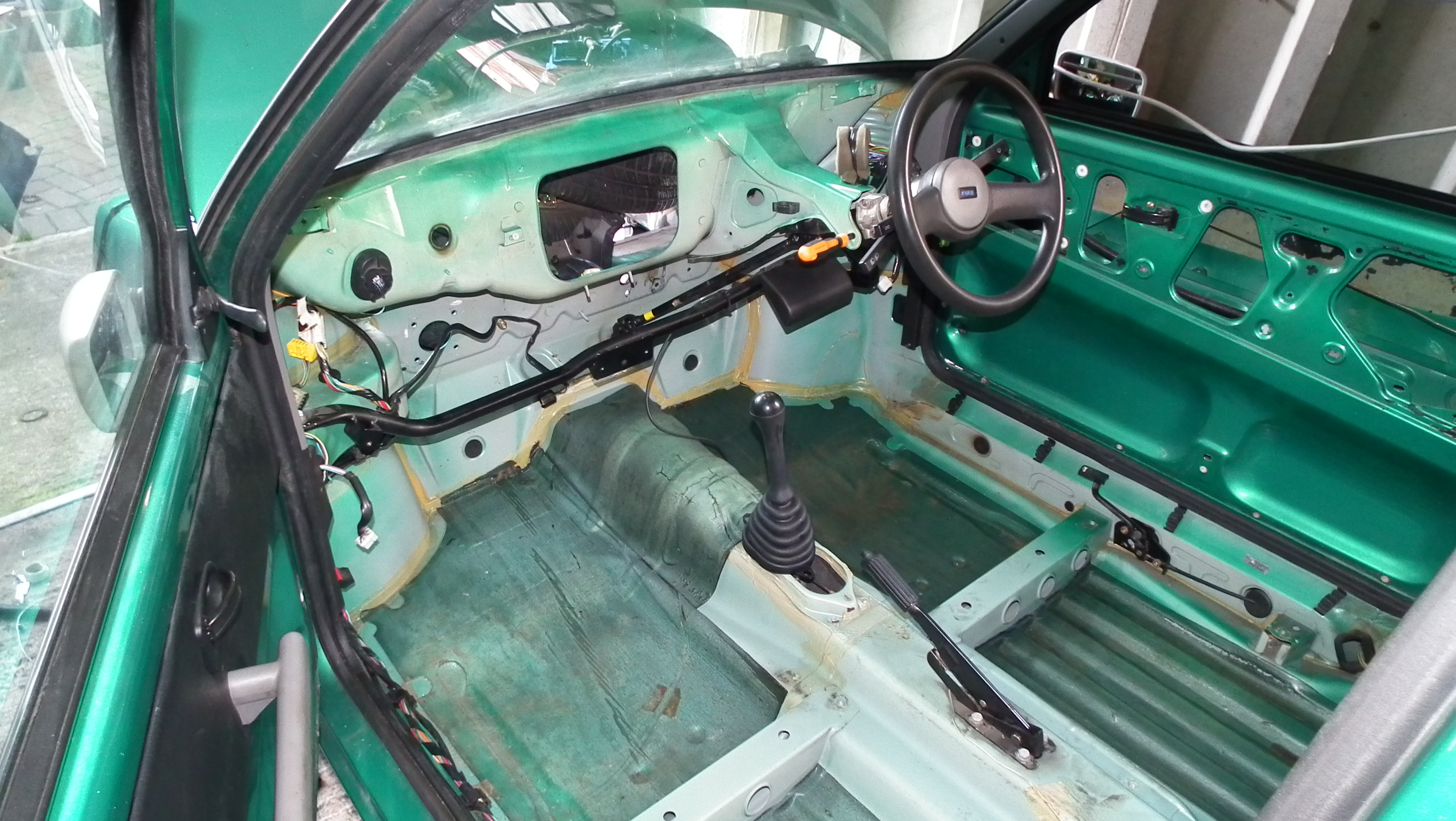

dash is all in bolted up
