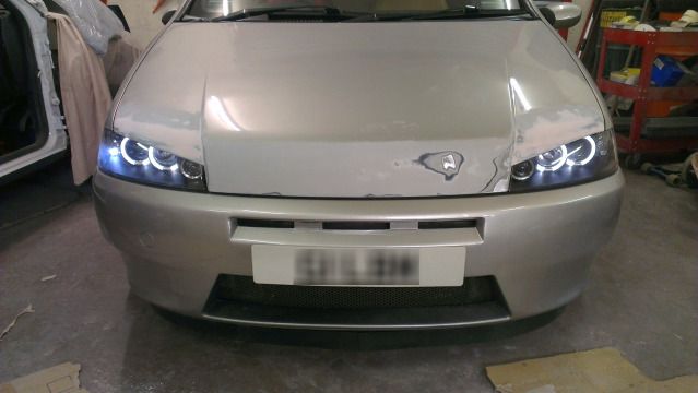

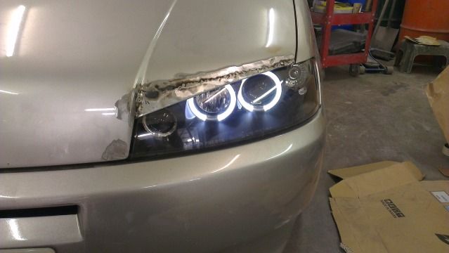

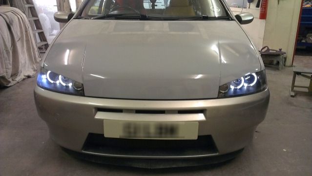

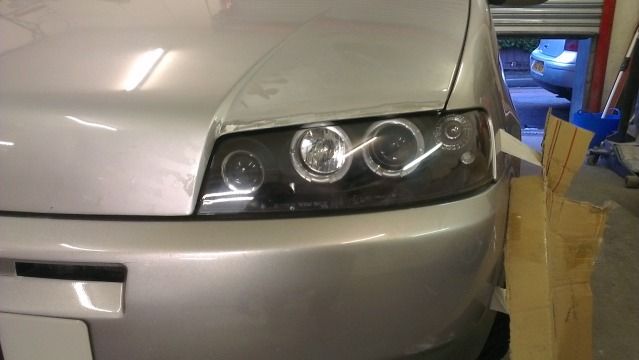

Well some idiot decide to bump into the front of my car. Damaging the bonnet and front bumper. While fixing my bonnet I decide while I was at it to bad boy my bonnet. Lowered the headlight line by 2cm. Yo give it a angry look. Sheet metal was cut and bent to shape with the outer edge rolled to achieve a neat finish. Both pieces were welded into place. Then 2hours of filling and sanding. That's me just home now. What a day. Pictures to follow

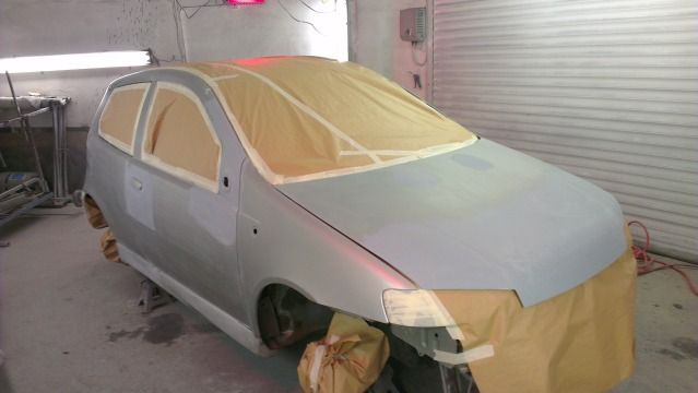

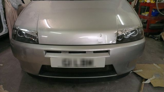

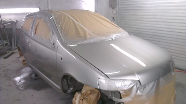

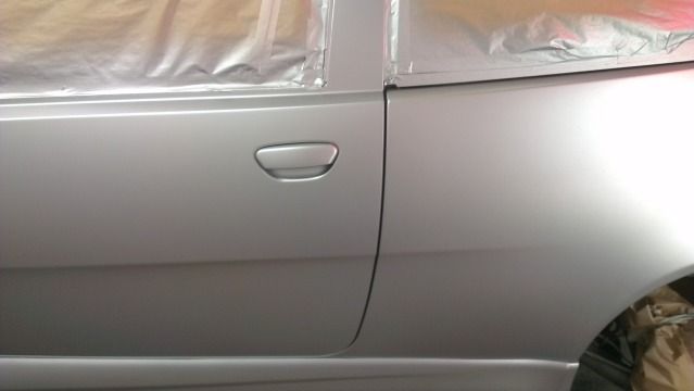

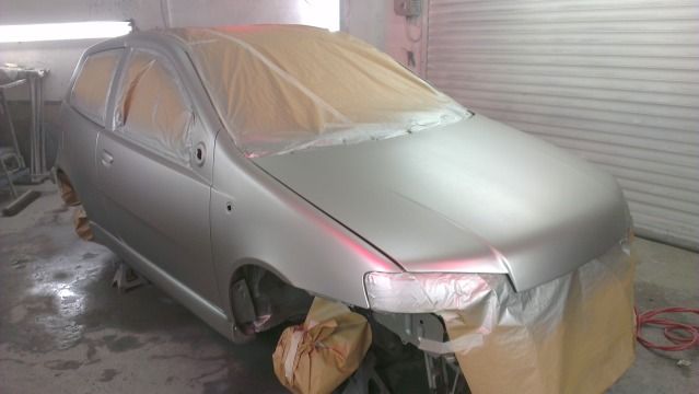

Bonnet is now fixed. Bad boy bonnet complete. In primer at the moment will be painted tomorrow. Painting the whole outside of the car same colour. Fresh the car up a bit. While I was at it I have smoothed the locks of my door also.
