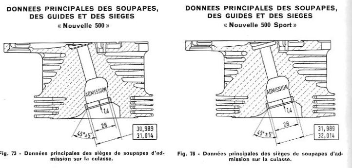

its really strange that its the inlet one which went, as its the exhaust seats which look over cut to me.
Here's some dimensions from a manual I have.
Clearly your exhaust seats are wider than the required dimensions.
The inlet seat simply dropped out probably because of high temperature; it was easy to tap back into place but seems firm enough that it would probably have stayed there. If I had better access I might have been able to repair well enough by the roadside to hobble home; there is nothing actually wrong with the inlets.

Valves have a very high hardness. It is almost always the valve seats that will recede. Those exhaust valve seats look like they should be replaced with hardened ones.
