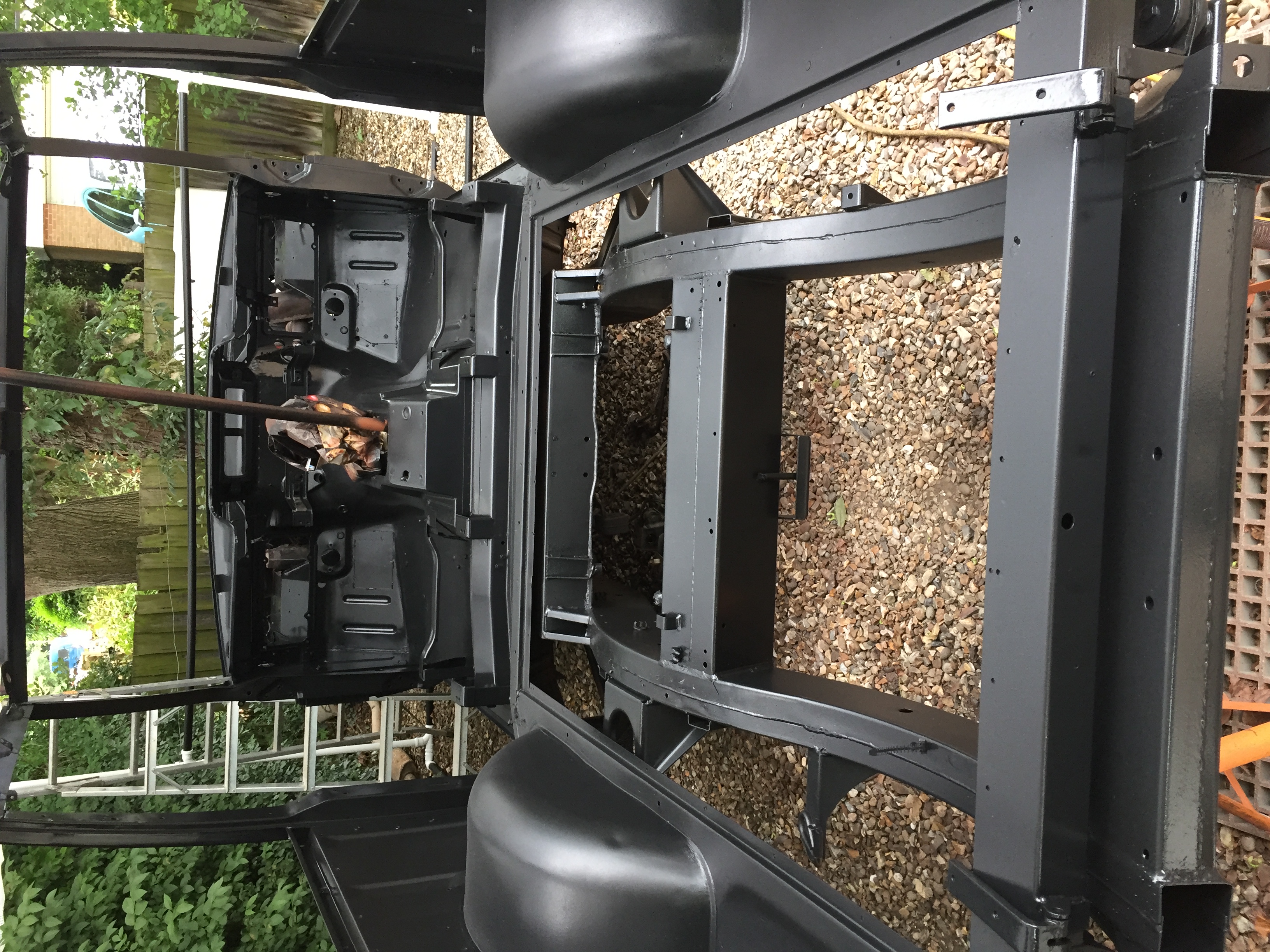

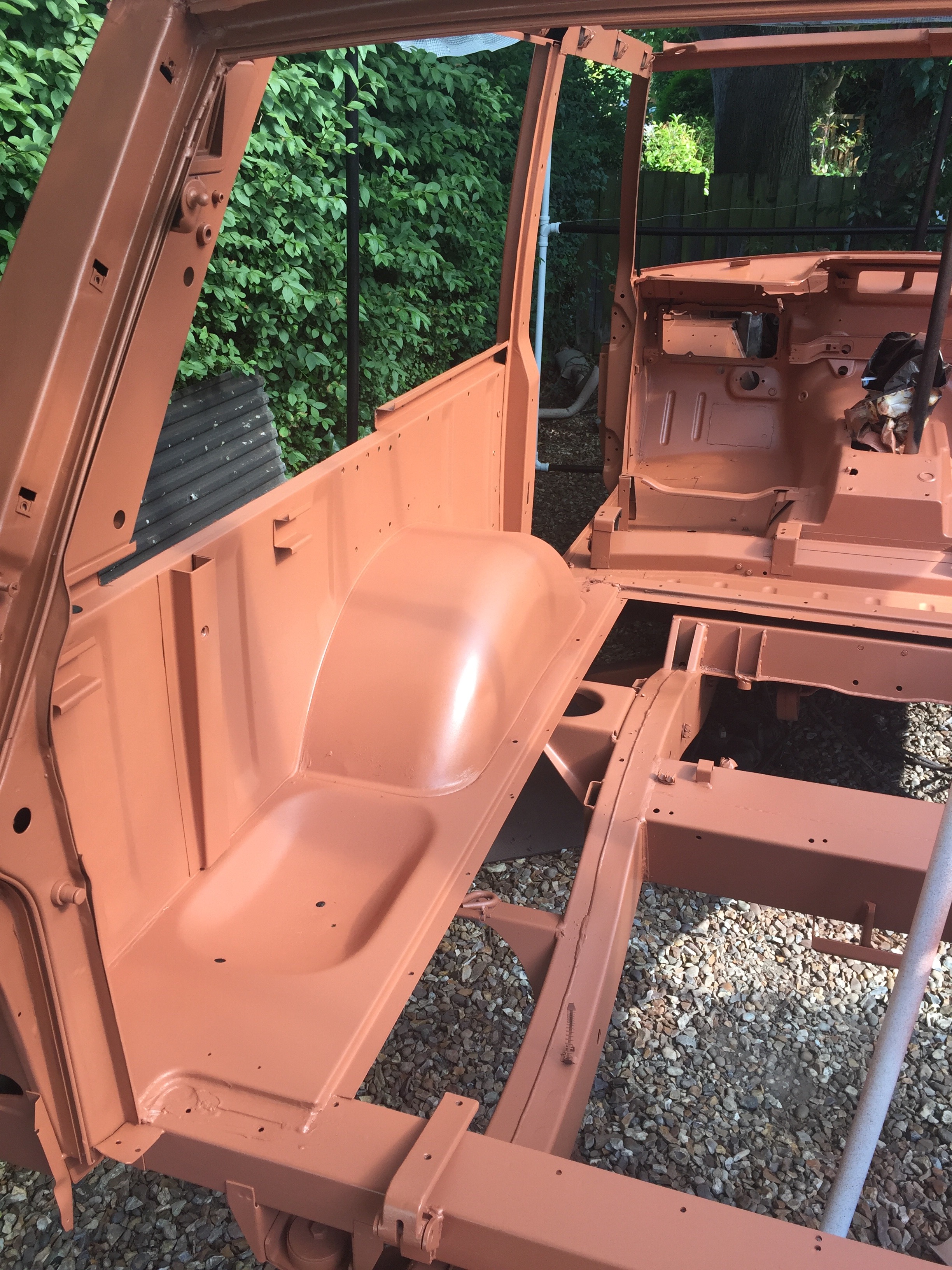

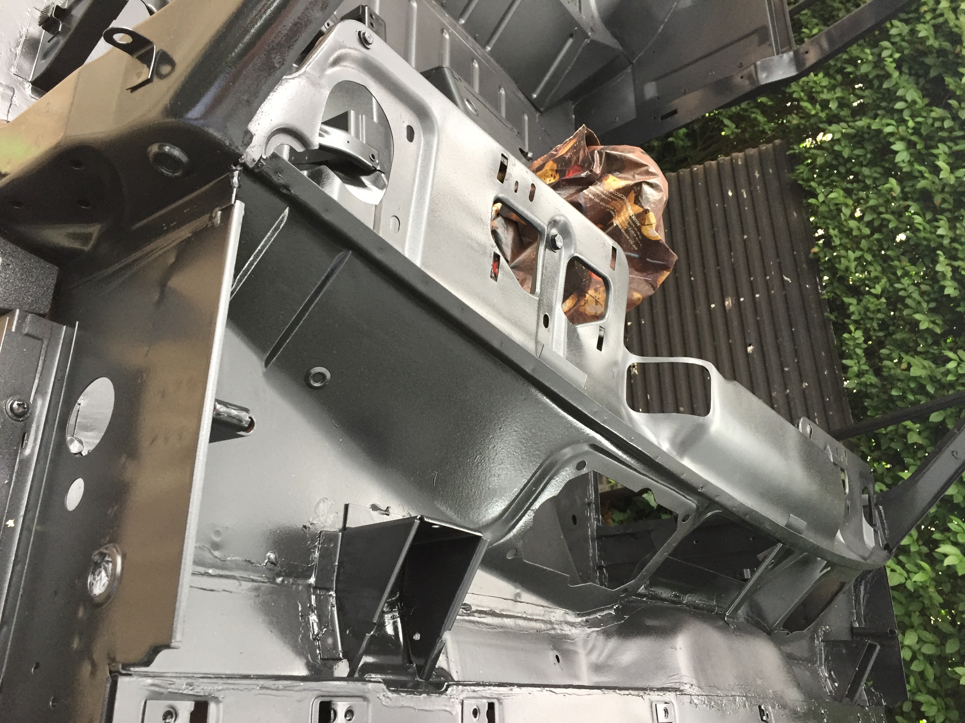

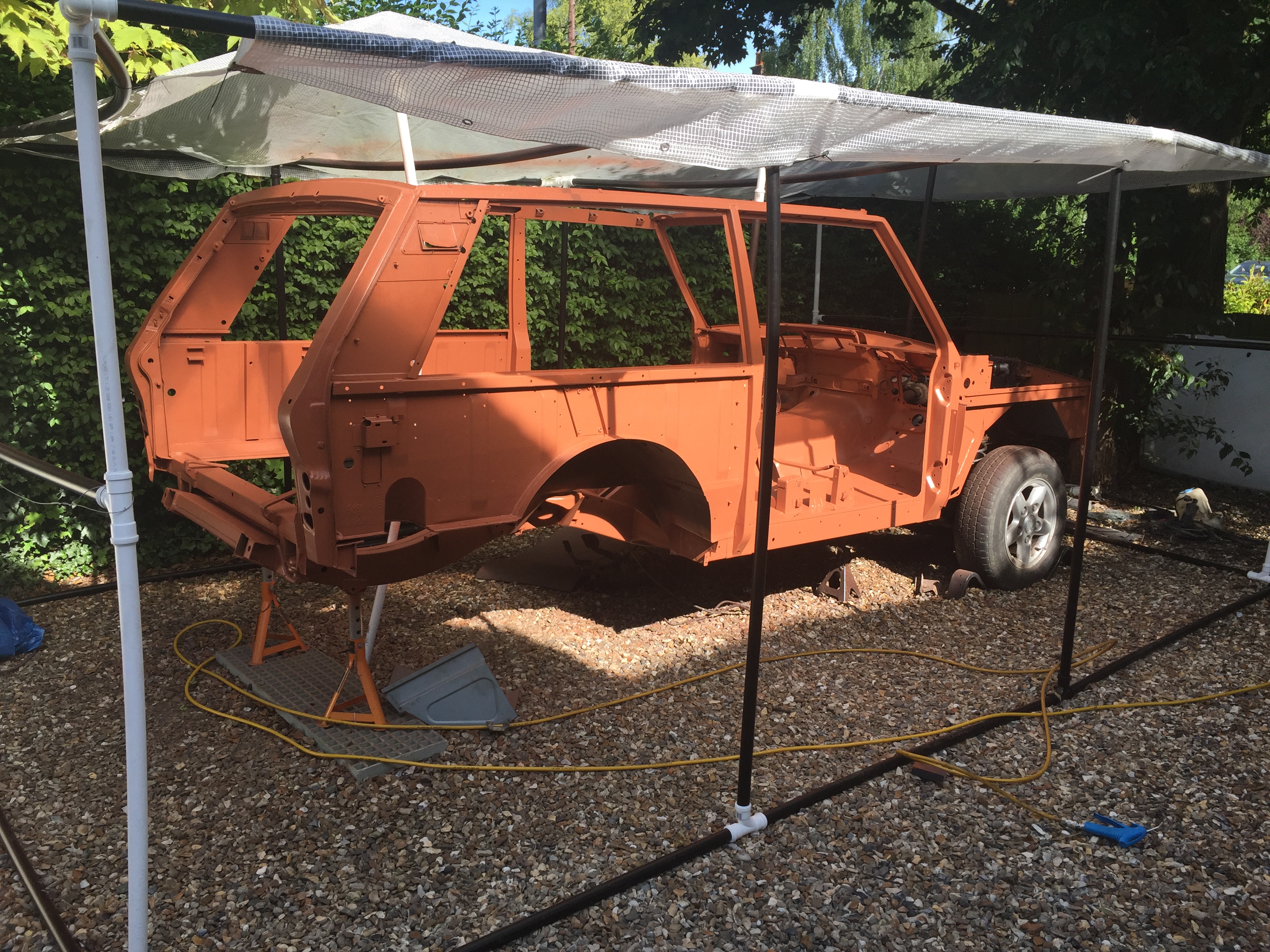

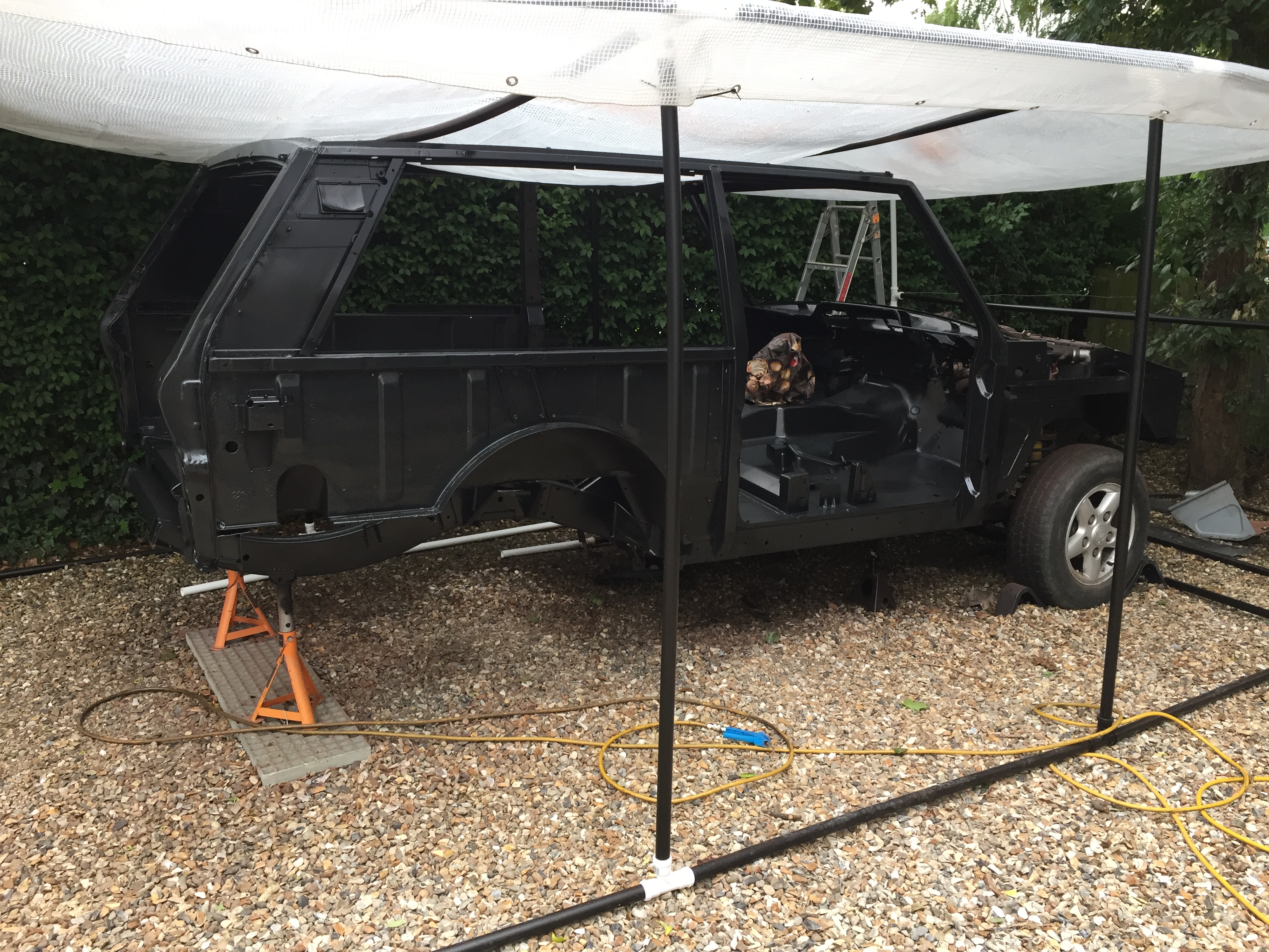

I'm making good progress on the two door range rover classic, but I'm still a few months a way from getting it on the road. Hopefully it will be done by the end of September.
Cheers, Steve
That looks excellent Steve. I hadn't realised just how much you could dismantle one of those...t looks like fun and would be very helpful if welding repairs were needed. You are faster than me with your restorations but I hpe you start rom better foundations.:eek:!

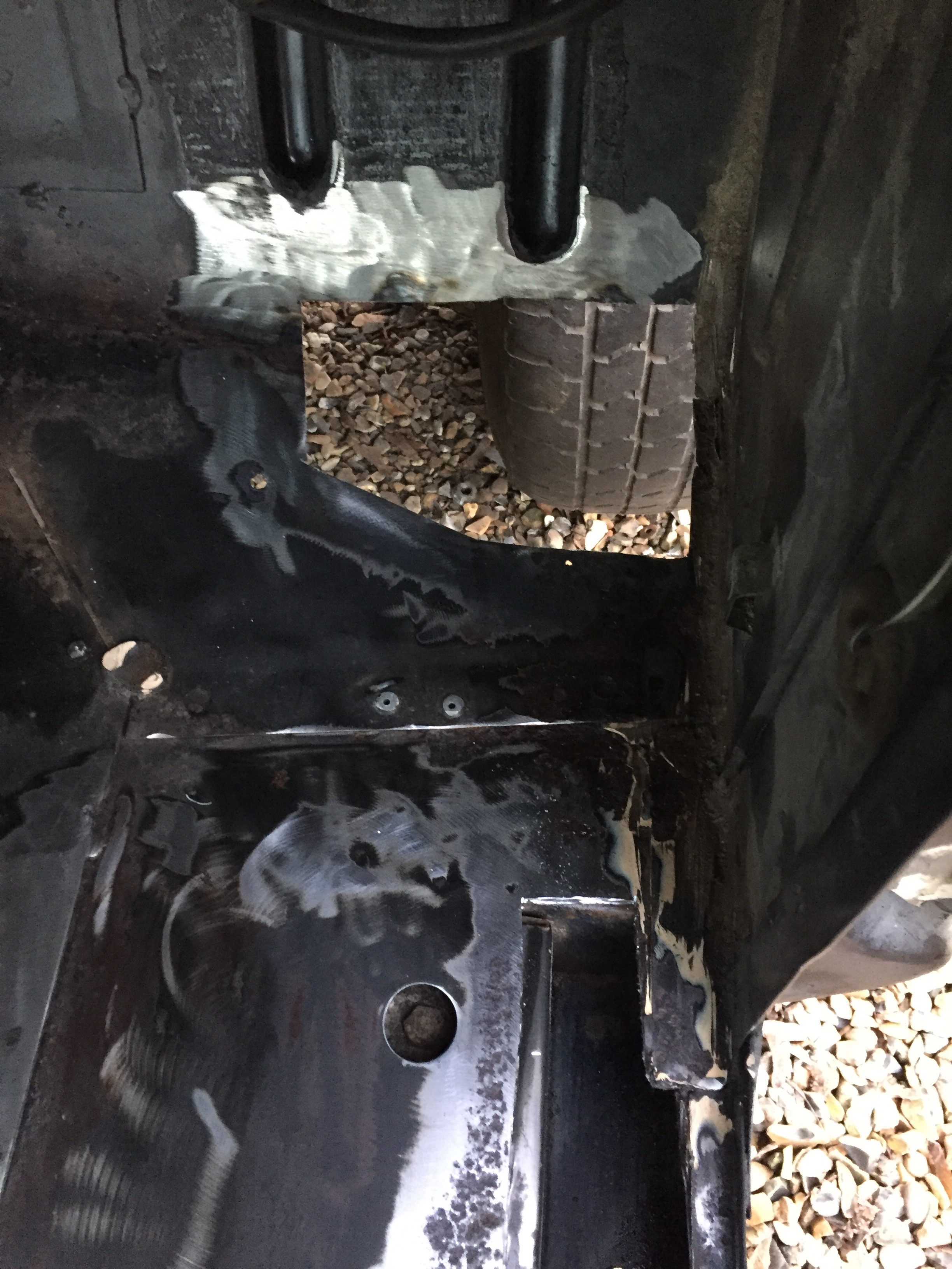

Yes, fortunately coming from Grenada in Spain, it was light on the rust front. Rear seatbelt mounts on rear arches, rear window frame on LHS, minor patch to front inner wing and finally RHS footwell..
akz4oSfnODSVqI7p1
and as you say the steel frame on ladder chassis with outer panels does make for easy dismantling and good access though. Also hides a lot of sins on U.K. based RR's ;) I just have the fun of LHD to RHD conversion to finish. :eek:
The awkward rear window frame section is the last piece to weld in. You can see the section cut out in this pic....
5EkutEGXMSDPhVdb2
So compared to yours, very light on welding.
