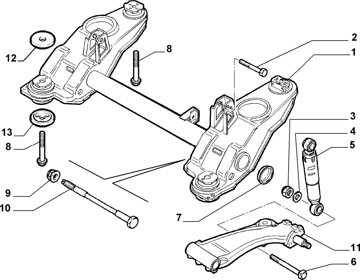

For anyone trying to source the Support Washer, that sits above the front mounting bush of the rear subframe.
ePer part #12 46465198 'Plane Washer'.
It is difficult to source a replacement, but for info, it's simply a flat steel (original is plated) washer OD 78mm, ID 12.5mm, Thickness 3mm
