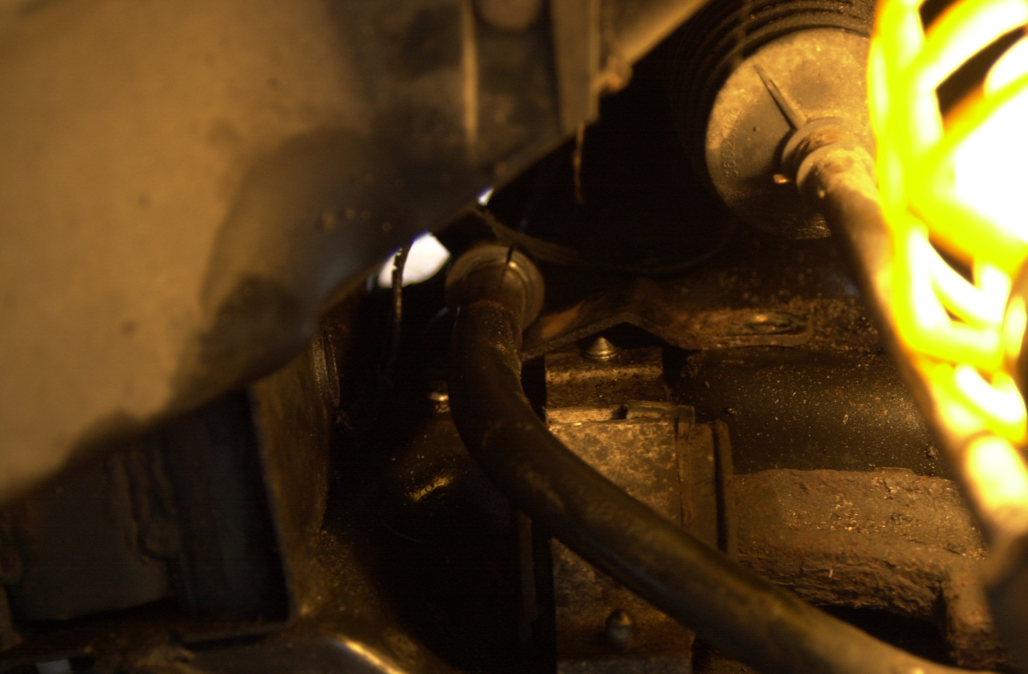

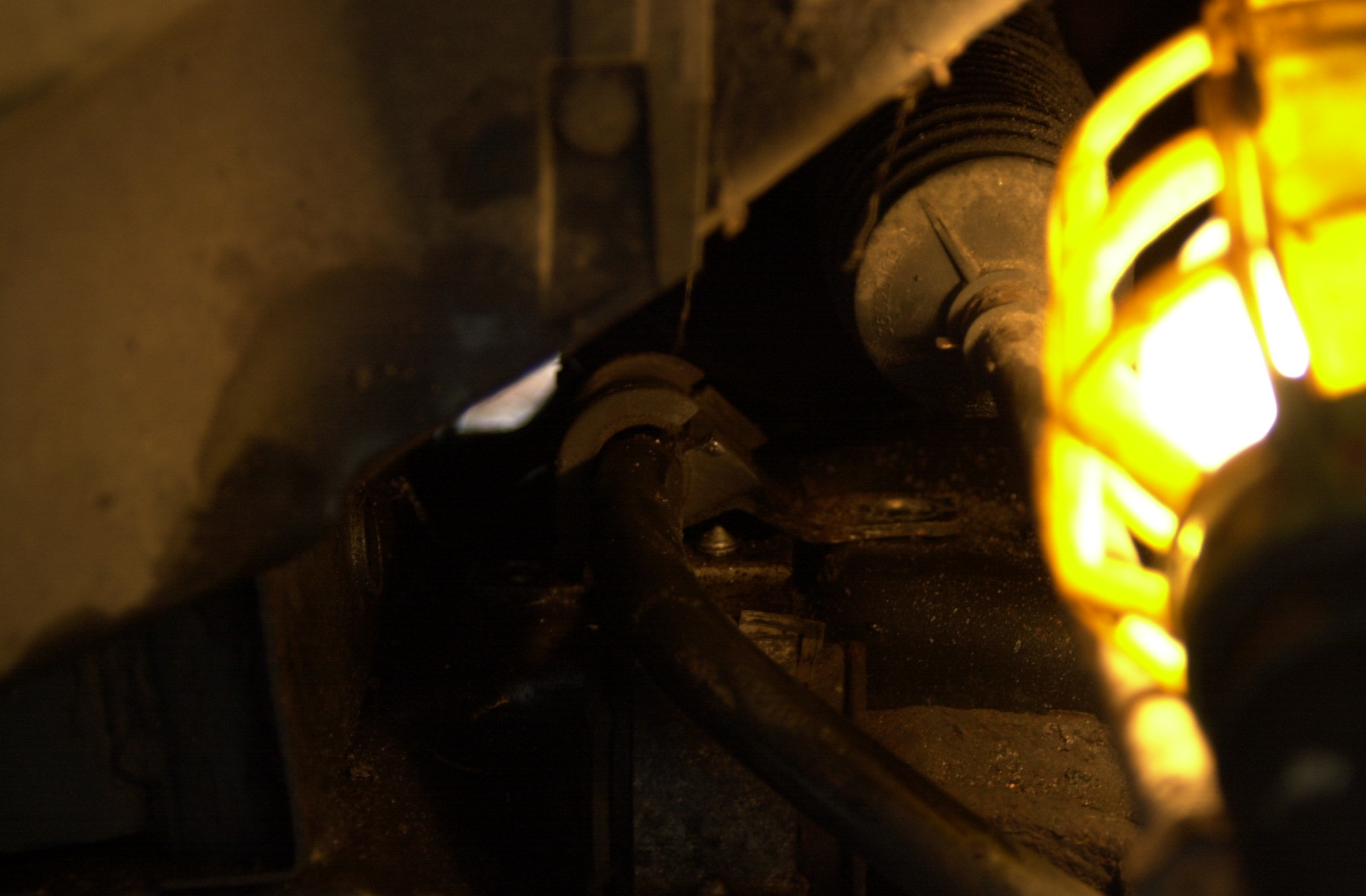

first pic shows the offside arb location behind the steering arms they are bolted to the lower subframe with 2 x 13mm bolts undo these about halfway
where the top bracket meets the bottom bracket put a screwdriver in between and tap the join, the 2 brackets will seperate, do this front and back of the bracket
you then remove the bolts fully and remove the top bracket

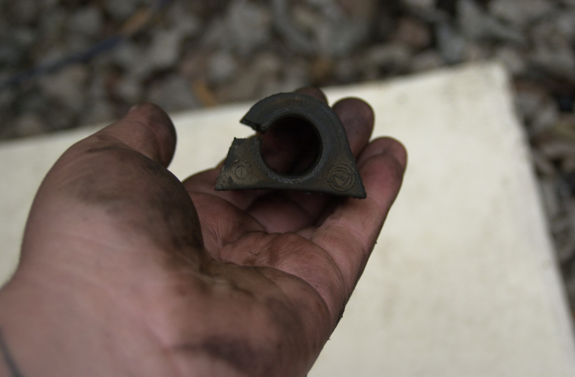

heres a pic of the old arb
it looks powerful weak compared to the superflex bush

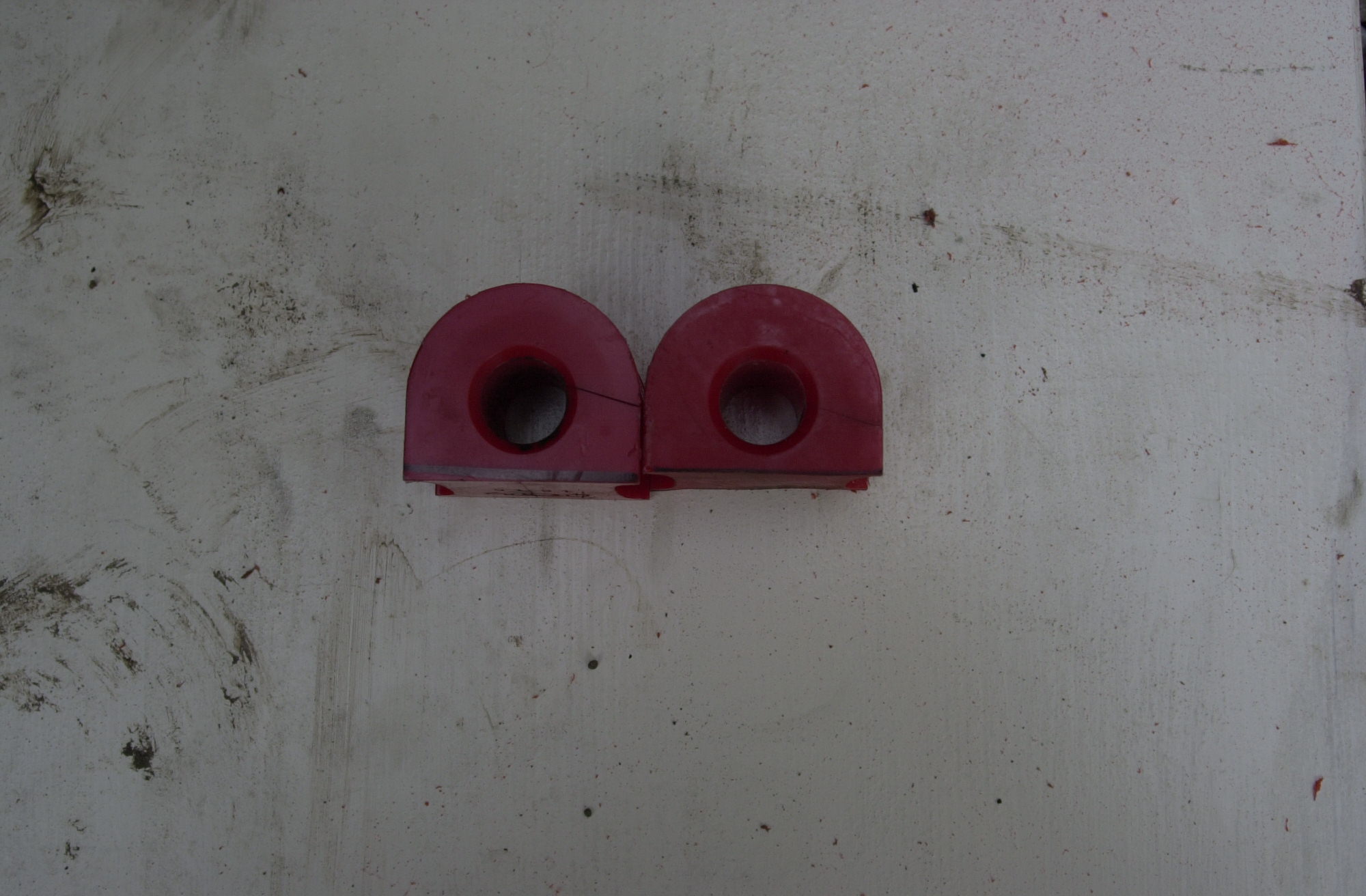

another pic of the new versus old
and one of the bush removed

i took a few mill off the base with a linisher and a mill or 2 off the arch inside not the flange
i kept offering it into the arb clamp till it feels nice a snug i didnt want to take much off it as i wanted the clamp to really hold them tight once bolted down
once seated ok i cleaned off the top arb bracket with the linisher now it will grip the bush very well

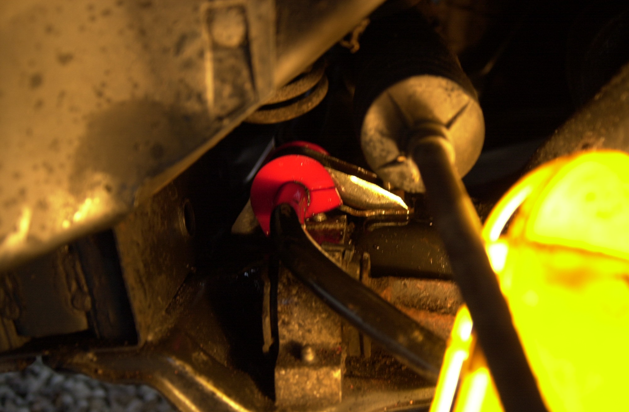

heres what they look like fitted
hope this has or will help someone if so im happy
