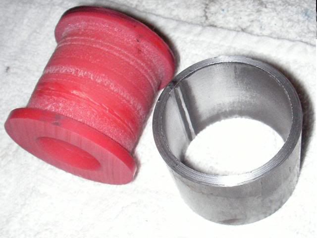

...would love to see pics of the bush/bracket making process (y)...
Will do. I've made one bush, and started on the clamp/bracket for it.
It'll be a while, it's way down my list priority-wise I'm afraid :rolleyes:
I'll post a pic later (I'm at work, and Photobucket is blocked...spoil-sports(n))

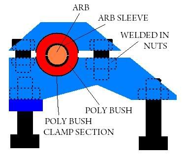

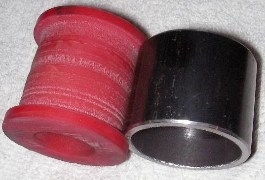

As I'm sleeving the bar where the bushes go, the hole in the bush will be larger.
Also, I'm going to grind down the ends of the bar slightly if there's enough 'meat' to do it safely, then the bushes should hopefully slip over.
Does the poly' get more elastic when heated, e.g. put in boiling water for a while?
If I can't get them over, I'll just slit them, it shouldn't matter really as long as the slit is located horizontally to front or back.
Bush and clamp section (tube will be split in half and welded to brackets made from rectangular box-section)
The basic idea, I'll probably have to alter it a little once I've got it all off and measured it up but you get the idea hopefully...

yes m8 the warmer they get the more pliable they become, i noticed this when the linisher i used heated up the poly it became a bit softer,
put them in an old kettle and boil some water up they should be a lot easier to fit over the arb end (y)
those bushes look sweet by the way, loads better design and will last a lifetime (y)
