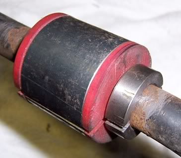

I'm confused about this taking "15 minutes". I bought the poly bushes suggested and got some guys to help me out at work. Having taken a couple of mm off the bottom, a couple of mm of the sides and top, they are still nowhere near fitting the brackets. The guys were on the job for about 2 hours with the fly cutter, mill, and linisher! Maybe they are just being perfectionists but it didn't look as though the bracket could be forced shut to me. Also, I'm interested to see that you took off the flanges from the top bracket.
Cheers
Hi multijtd. When you say that you sanded the brackets, do you mean that you also took off the locating flanges?

go here m8 : http://www.superflex.co.uk/results.php?maker=18&man_name=Fiat&searchmodel=96&Search=Go
the part number is: SPF1816/18 quantity x 2
think it works out to £21.33 inclusive
just complete the order form with details and payment etc and they mail u back telling u there on there way to u

BTW, I couldn't find them on the Super Flex website, either with the above link or by clicking on the Saab sub-link - but got them off eBay for about the same price.
