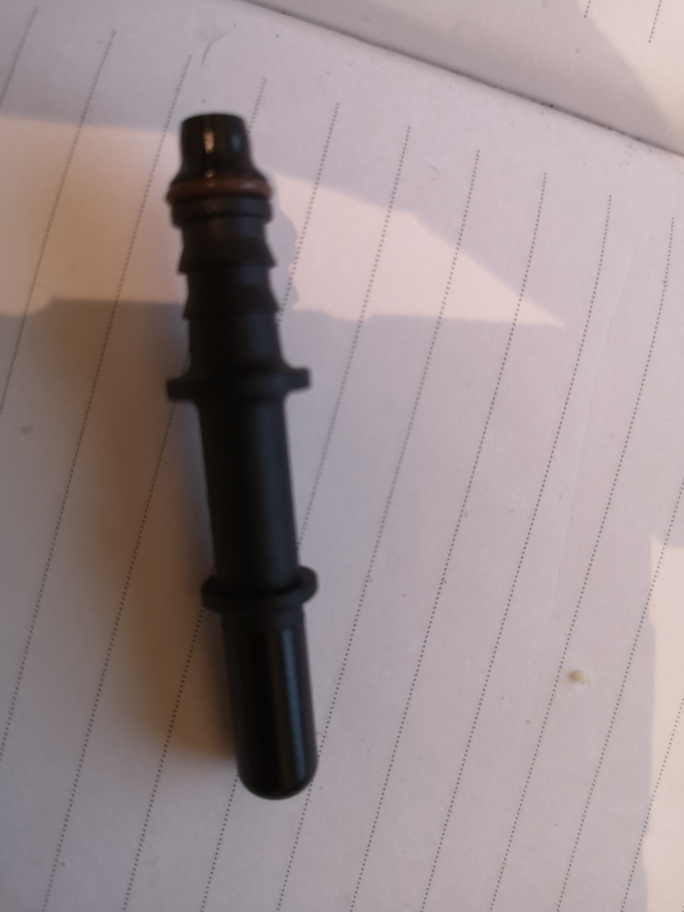

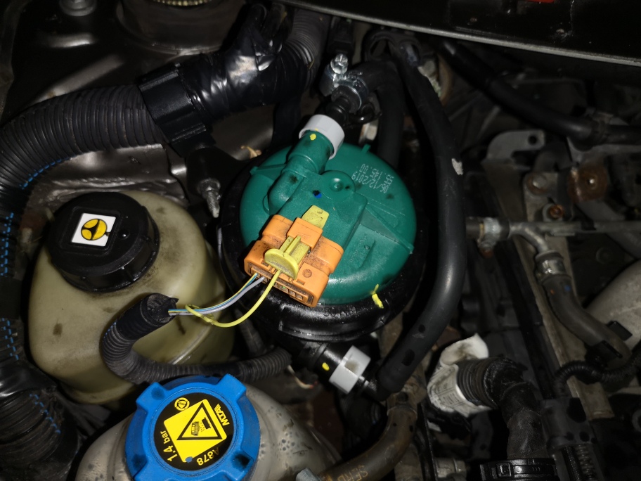

Well you have made significant progress huge well done.Just refitted new fuel filter, housing and the new connector and a piece of fuel hose to replace the hose upto where it becomes metal . Tried starting and it was starting, then cutting out. the EML came on and illuminates with the ENGINE CONTROL CONTACT GARAGE message.. Tried starting on and off for 30 mins or so... now its starting everytime ... I cant get it to stall or cut out. Not sure i trust the issue is resolved but its been running now and ive moved it around my drive and it seems to be behaving except for the EML on. Have to clear this and retry ??? So some progress but time will tell if this was the issue .

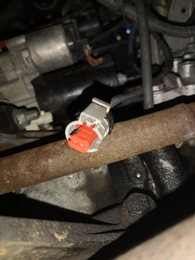

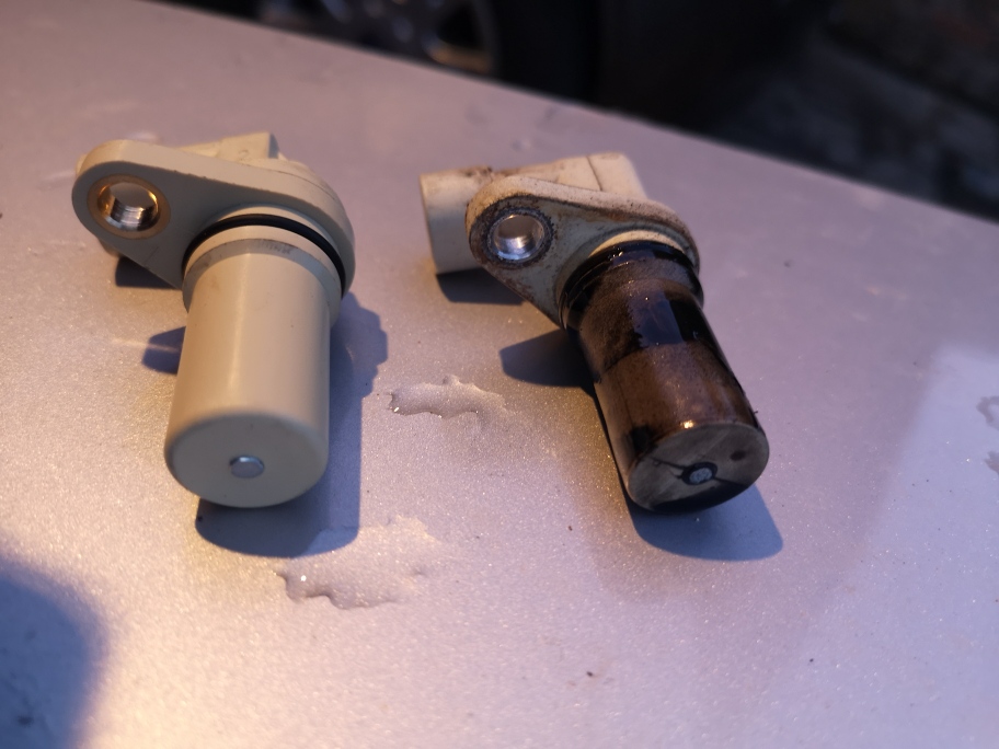

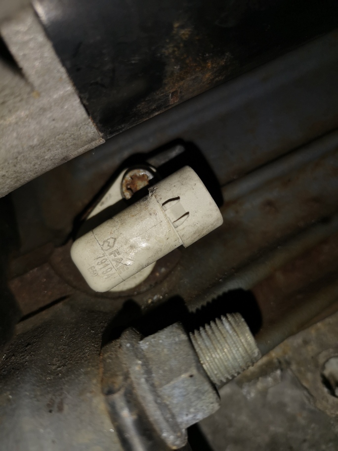

Changed Crankshaft Sensor today. Mine is the newer type see photos . Wasnt too difficult once i sorted out access for the T40 Hex screwdriver. Just unscrewed and removed. and inserted new sensor . Took all of 15mins . Started first time, and so far no warning lights. It was cold and wet here today so didnt want to risk taking it out for a drive but initial indication is positive. It wasnt starting first time with old sensor in place, was seeing glowplug and EML light before, now no lights. Will try it out and confirm in the morning. Thanks TXUCHIN for the photos. See photos of setup on my car. The new sensor is slightly different , and the metal tip seems to be a little more proud of the plastic surface . Wonder if this is wear?In my engine it is possible to replace the crankshaft sensor from below, without the need for elevator.
