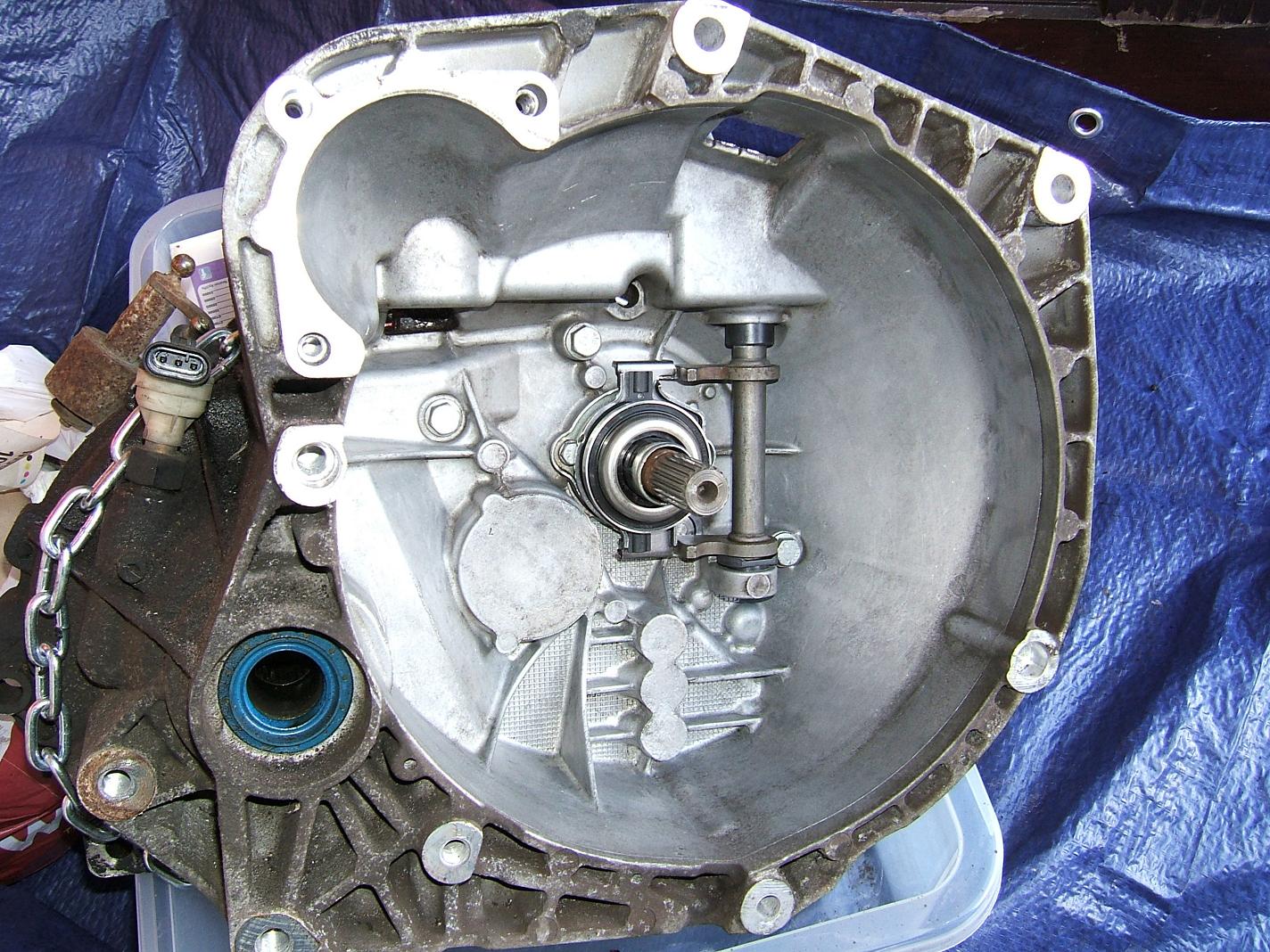

Cleaned out the inside of the bellhousing: I spent a few hours Today cleaning the crud out of the bellhousing insides. White spirit, J-clothes, Wilkos "cheerio germs" wipes, kitchen roll and cut up pound shop scouring pads/sponges to get into all the nooks and crannies. Now nice and shiny (see pics).

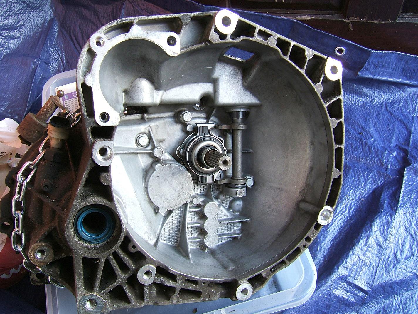

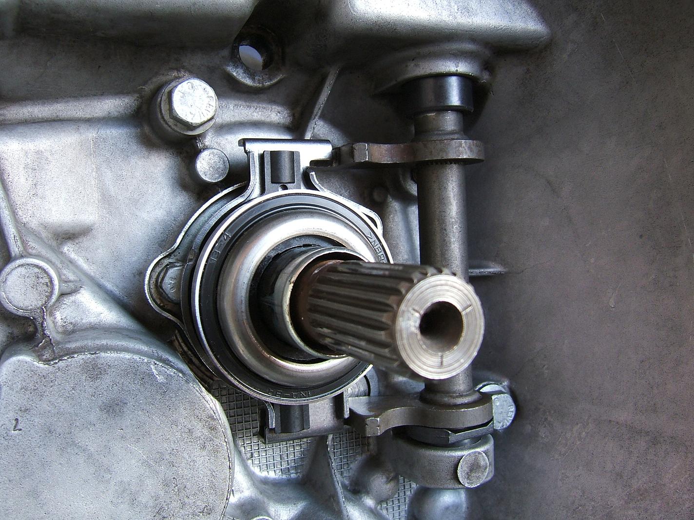

Test fitted the clutch fork and release bearing assembly: After cleaning the bellhousing I couldn't resist installing the clutch fork components - bearings/bushes, clutch fork, clutch lever and release bearing - to test it all working. I moved the clutch lever back and forth and the release bearing was moved nicely up and down the gearbox input shaft by the clutch fork (see pic).

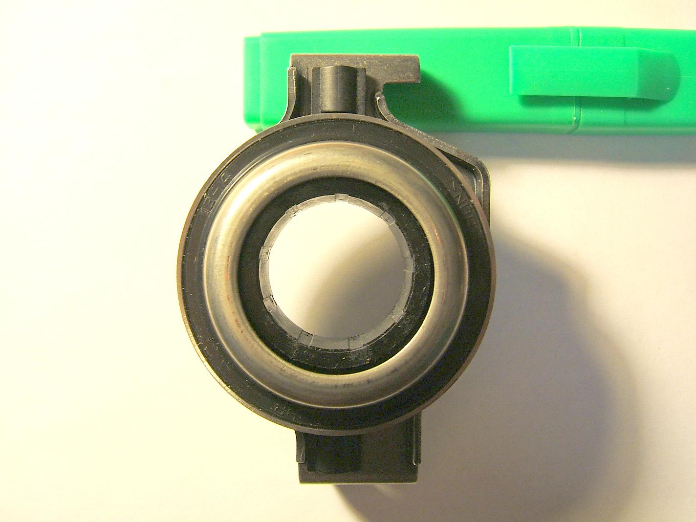

One observation: the inside hole in the LUK release bearing is not concentric with the inner or outer metal rings of the release bearing. Is this deliberate or a manufacturing error? The centre of the hole/plastic ring is 1-2mm North of the centre of the bearing inner or outer metal ring (see pic).

Clutch fork: The new clutch fork has arrived. I tried test fitting the clutch fork assembly, and the fork fits snug and tight in the fork bearings/bushes. I could have started putting everything back together Yesterday, however...

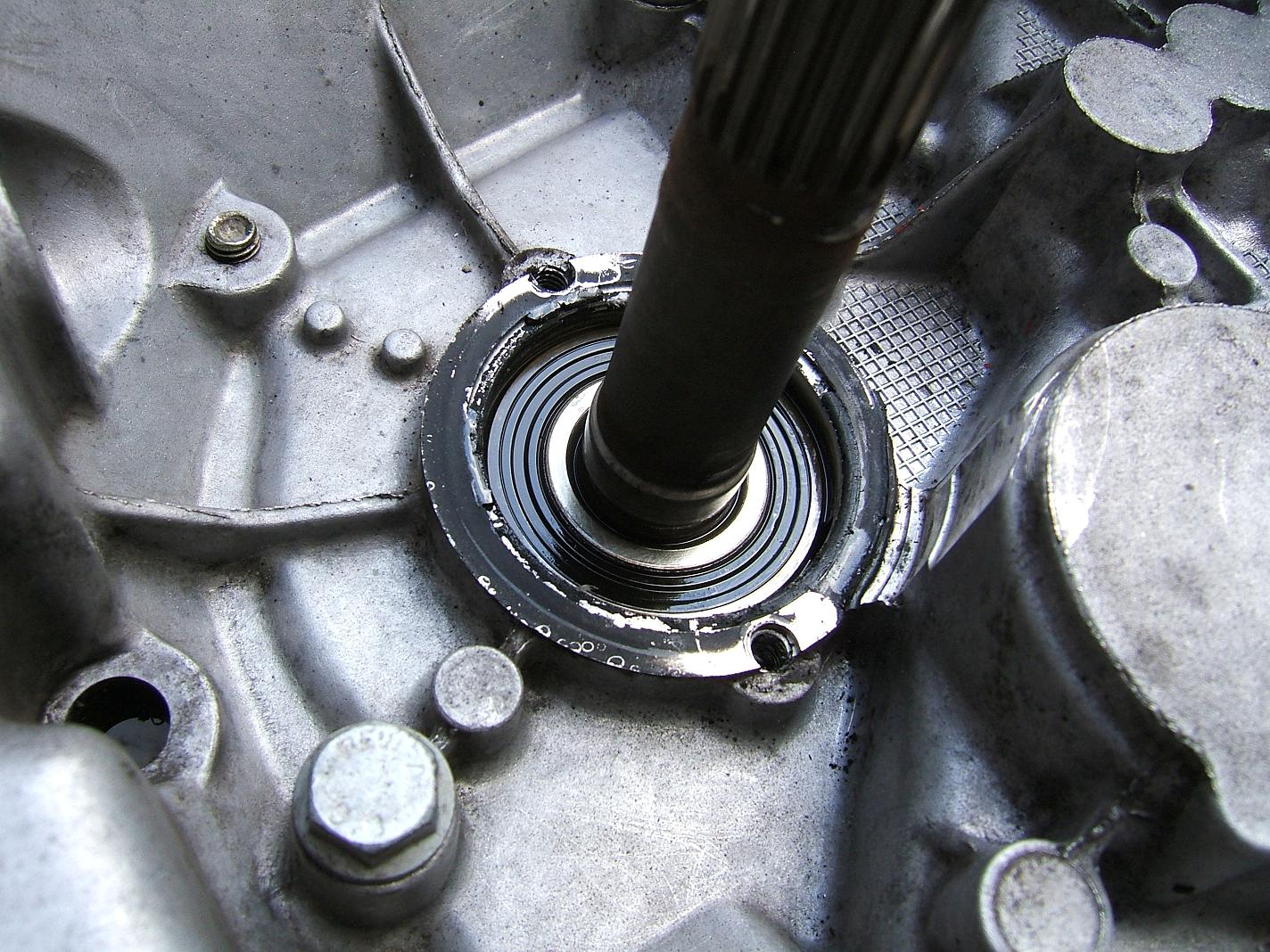

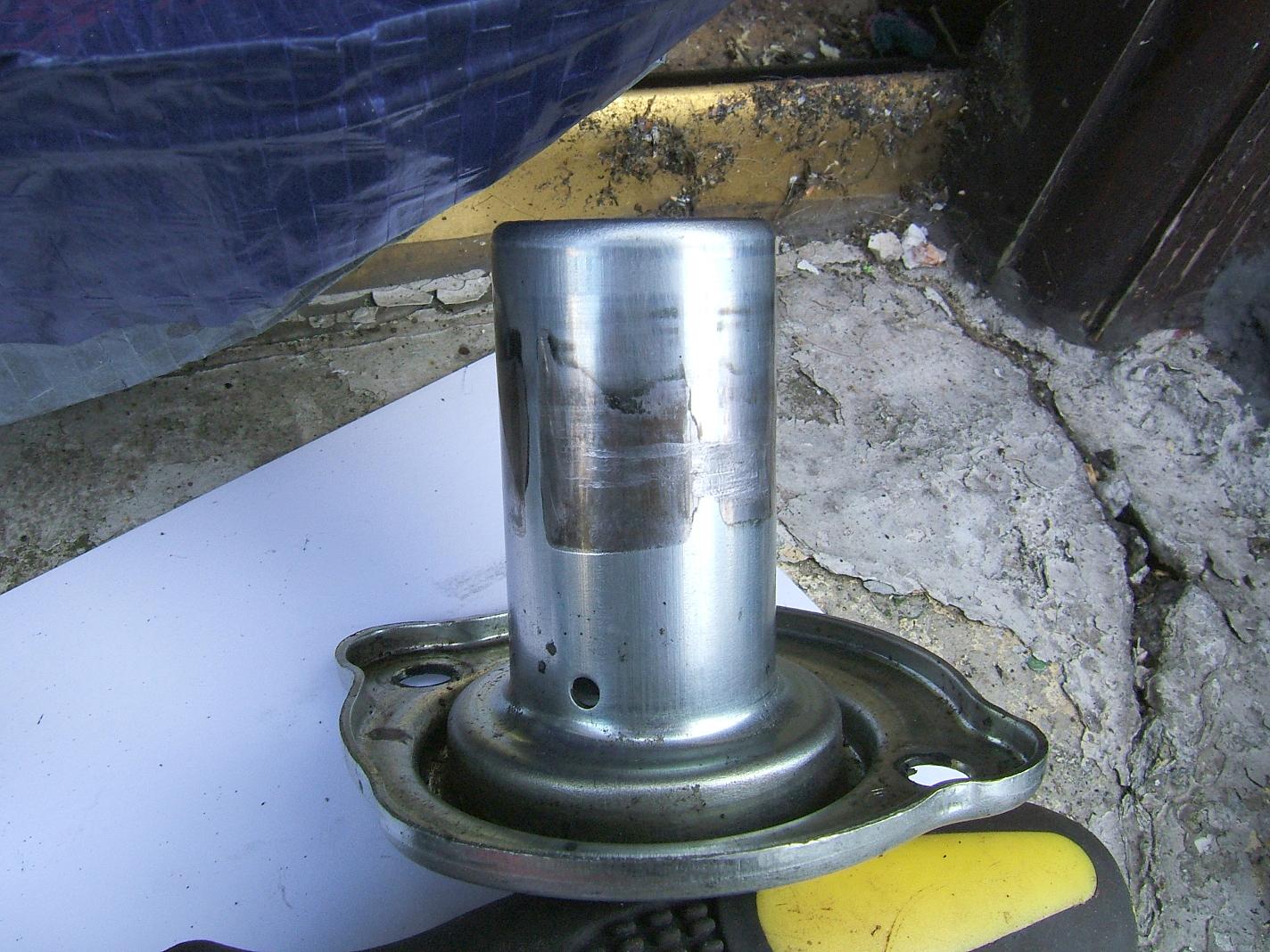

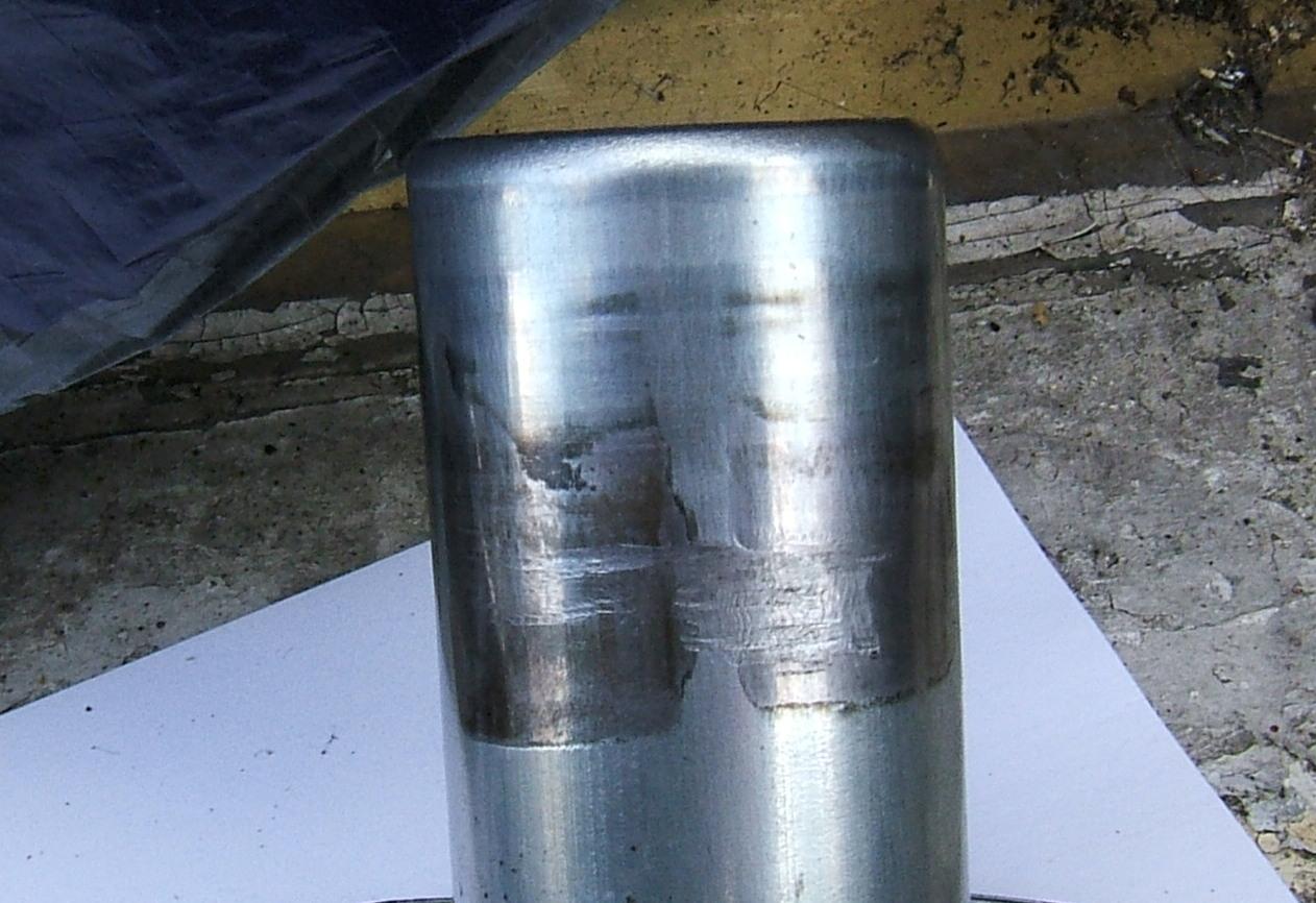

Gearbox input shaft sleeve: ...when I removed the gearbox input shaft sleeve from the bellhousing, I noticed that it is quite worn, with a distinct hollow worn into the sleeve at one point (see pics). I tried sliding the release bearing up and down the sleeve and it sticks when it hits the hollow. As a replacement is only £12 from Fiat, I decided to replace it. But it means another 2 days lost while I wait for delivery. I am surprised, and a bit irritated, that nothing has been mentioned in the threads I've been following about wear to the input shaft sleeve, and the possible need to replace it. Well now it has been mentioned. But to be fair I should say that there has been some very good advice offered on this Forum without which I would not have attempted this job.

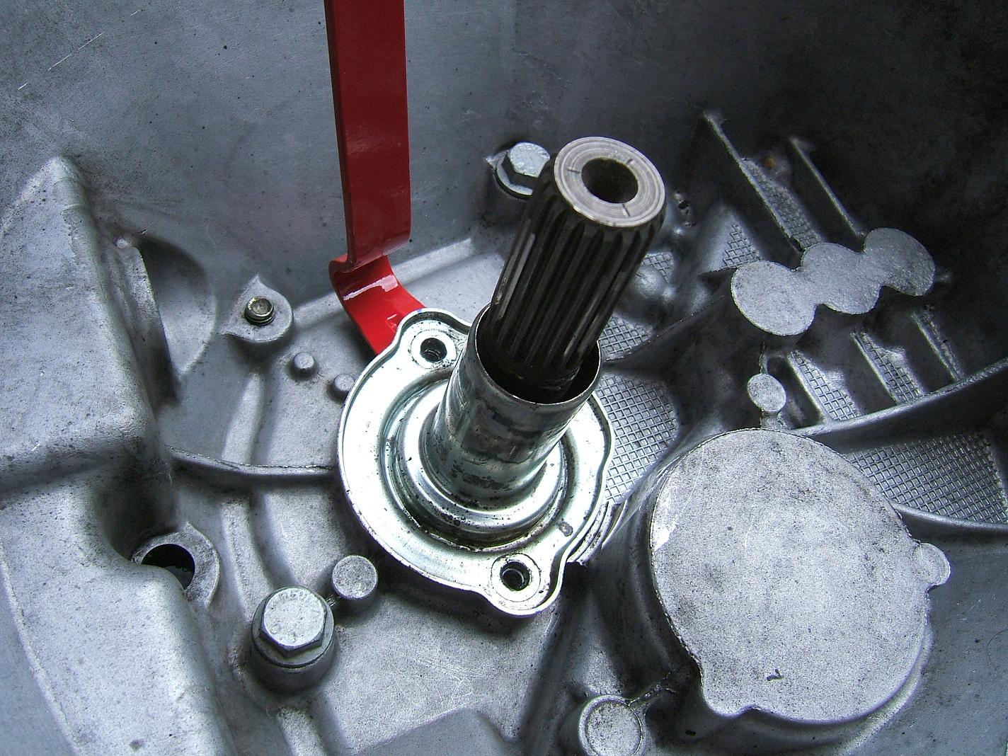

FYI: The sleeve is attached to the bellhousing with 2 x 10mm bolts. Mine was also stuck down with black RTV requiring some gentle prizing to detach the sleeve from the bellhousing. To remove the gasket from the holder I placed a large flat screwdriver behind the seal and whacked the handle of the screwdriver on the floor to force out the gasket (see pics). I then cleaned the old RTV off the sleeve and bellhousing ready for installation of the new sleeve and gasket. I also need to source a socket to install the new gasket.

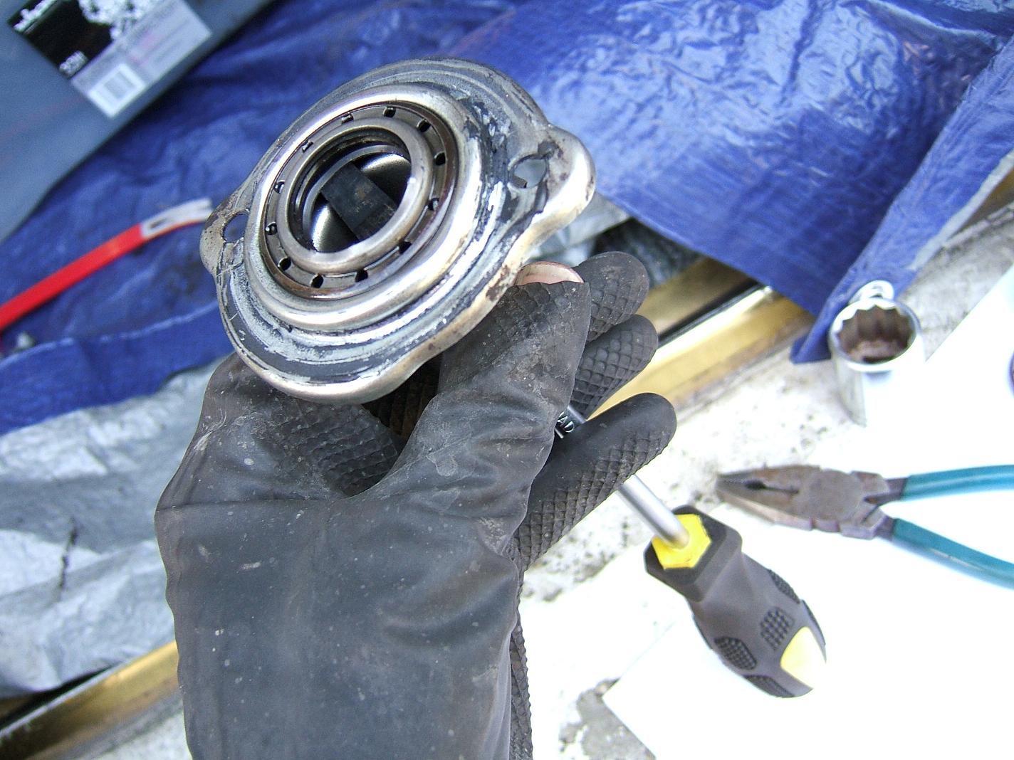

Release bearing: I mentioned in a previous post that the plastic hole in my LUK release bearing (the hole that the sleeve fits through) is not concentric with the outer metal rings of the bearing. I found out why Today - while I was playing around with the clutch fork assembly I noticed that the bearing moved sideways relative to the plastic centre ring - it's a self-centering bearing!

If you turn the input shaft with the bearing on show...does the bearing outer shell spin in the housing? This is the problem I had
Just checked... No it's just the inner shell (nearest the input shaft) that turns with the input shaft, the outer (nearest the housing) stays static.

Installed new gearbox input shaft sleeve/input shaft oil seal holder: Applied black RTV to the base of the oil seal holder, and thread lock to the 2 x 10mm bolts. Smoothed the outer surface of the sleeve with a plastic scouring pad. Applied a little gearbox oil to the seal, slid the sleeve onto the gearbox input shaft, and bolted it on to the bellhousing (10-12Nm). Cleaned off excess RTV and thread lock.
