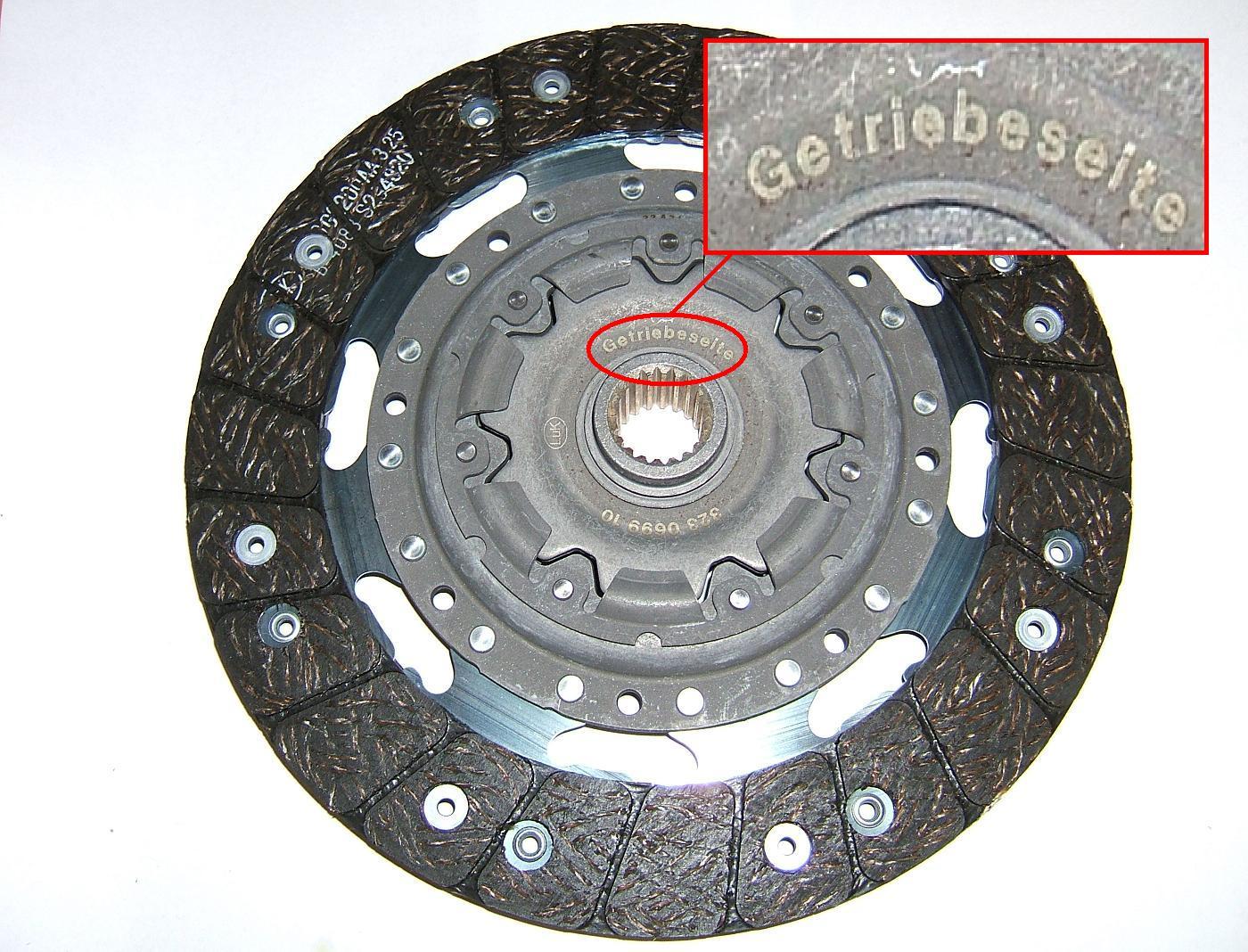

FYI 2: Clutch plate pic. Note: "Getriebeseite" is german for "gearbox side".

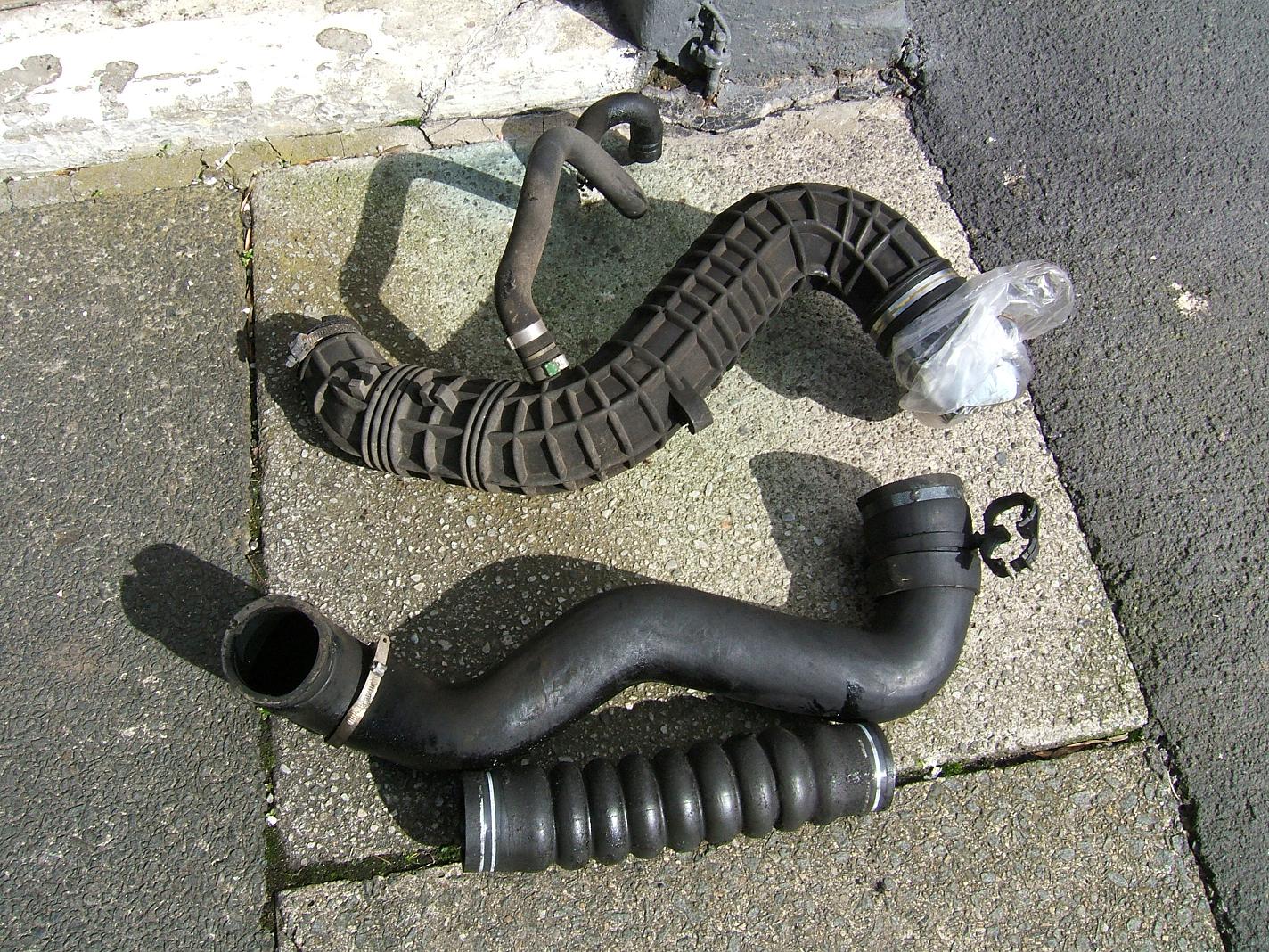

Removed intercooler hoses

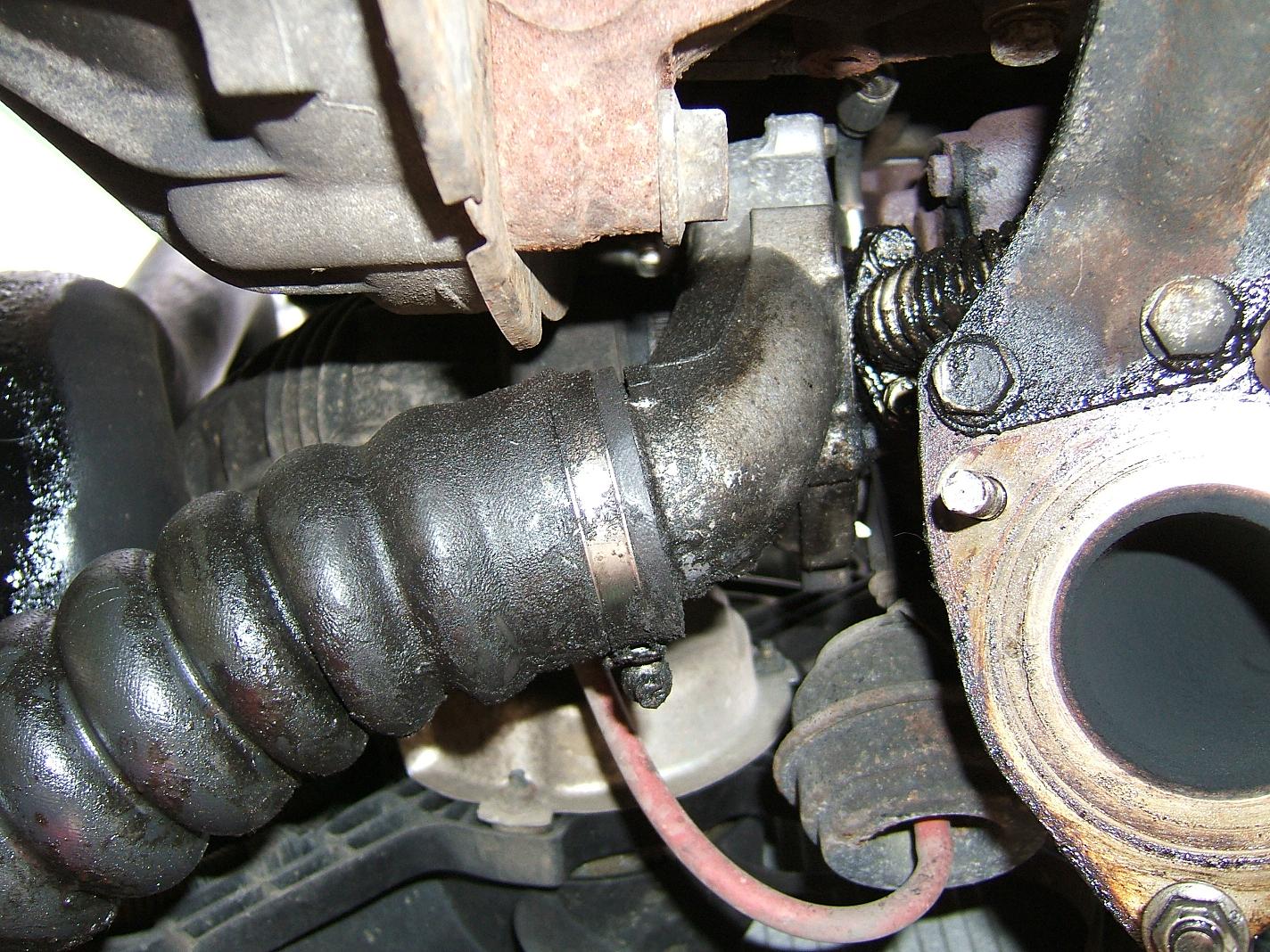

I first completely removed the two intercooler hoses. The bottom hose was covered in black gunk (See pic). A hose clip to remove at the ends of each hose (See pic). 10 minutes work.
Removed air hose

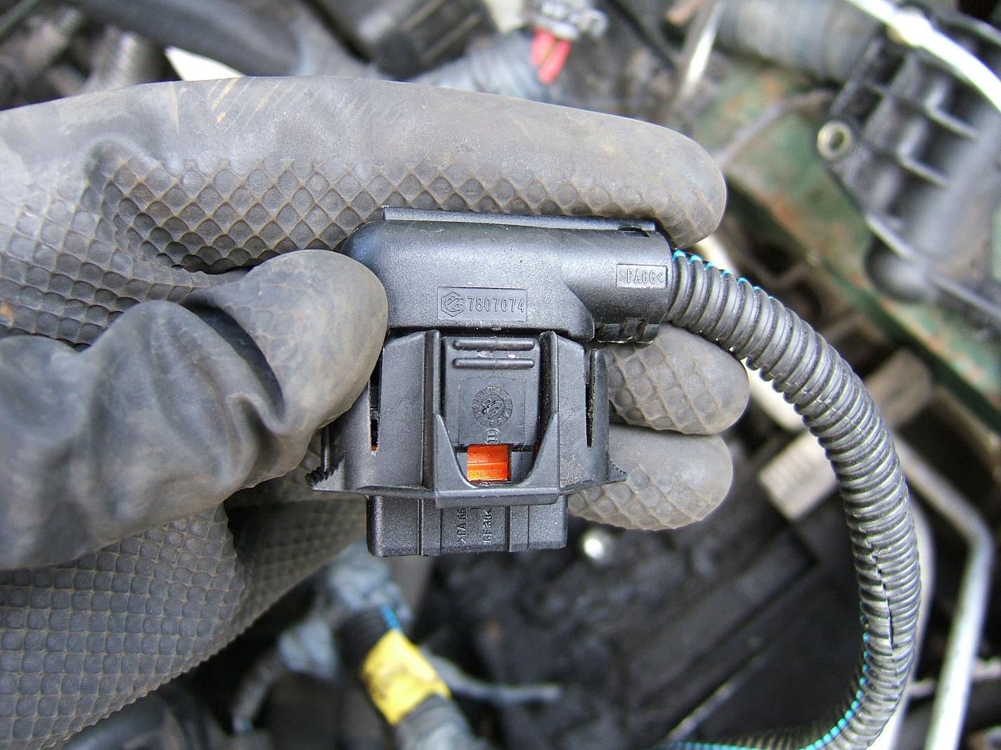

I then removed the air hose, after disconnecting the MAF sensor connector. I scratched my head trying to work out how to disconnect the MAF connector from the hose. Solution: Push in a latch on the back side of the connector (See pic). One jubilee clip to disconnect the large hose from the engine, one smaller hose off the large hose to disconnect at the top of the engine (See pic), and remove the hose from the engine bay.

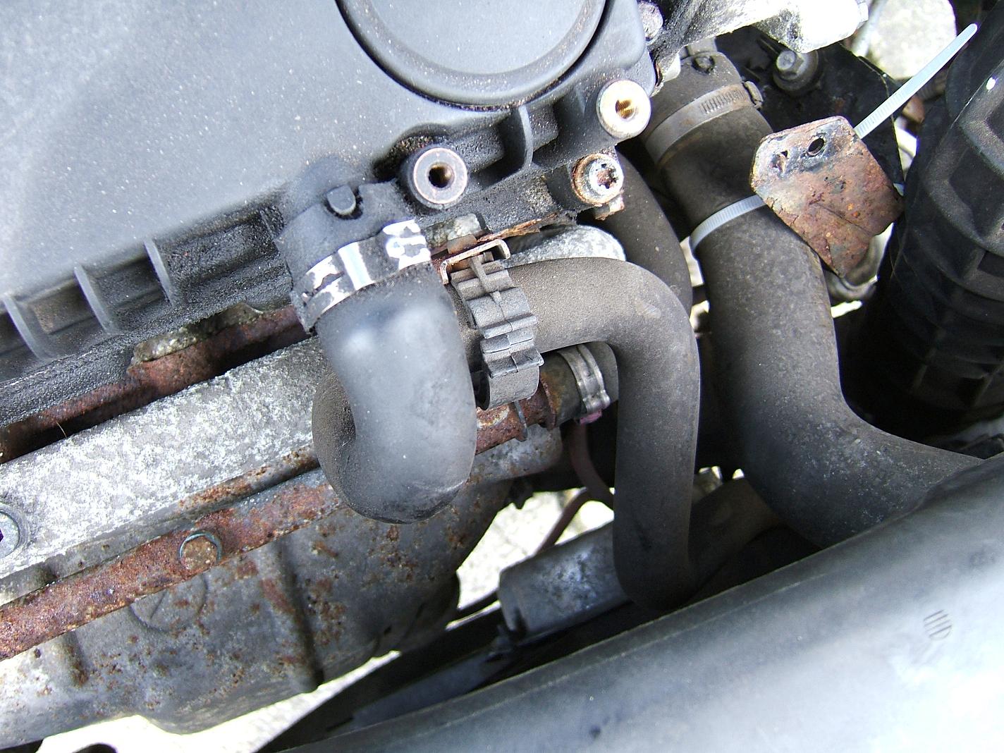

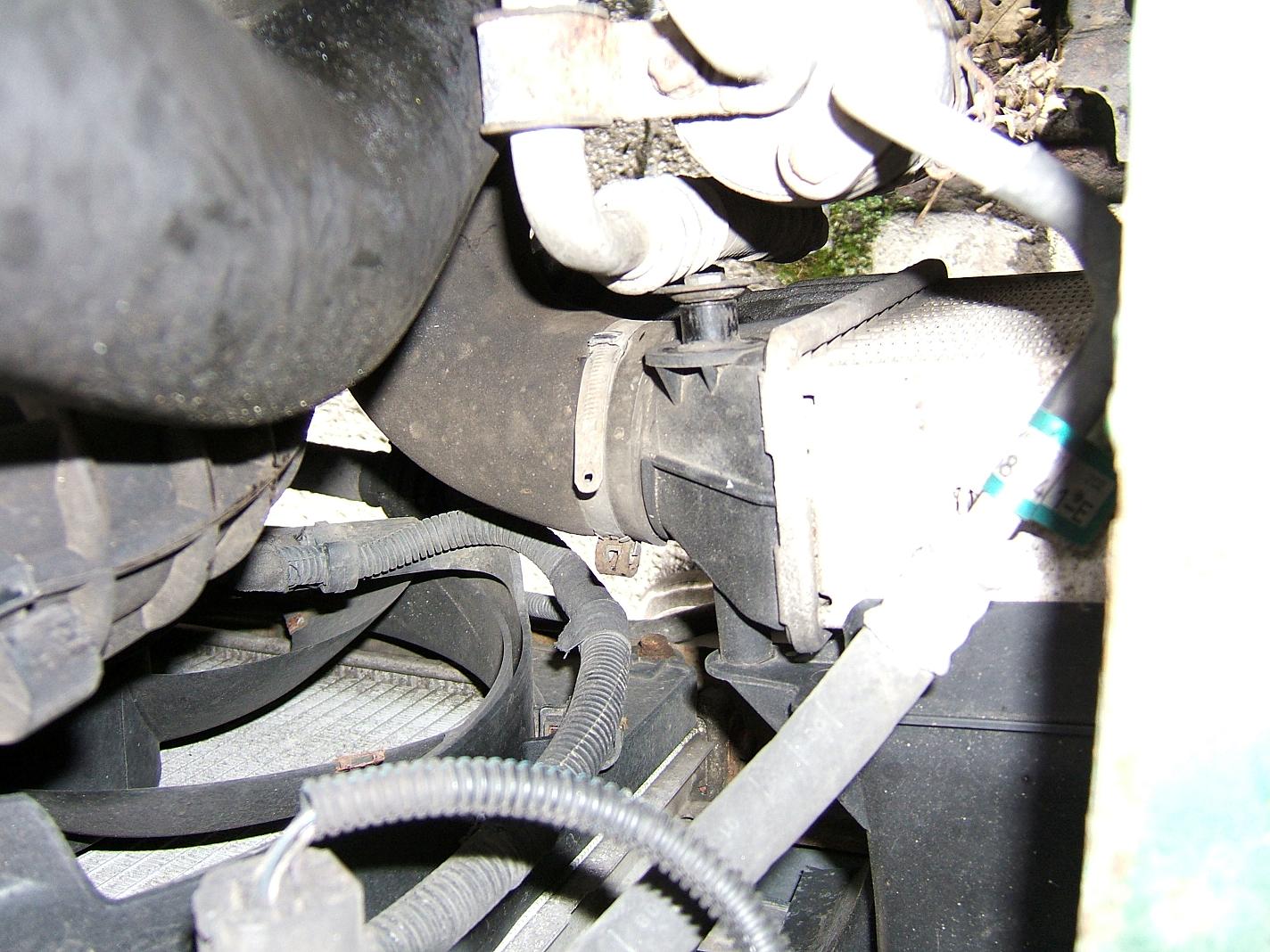

If you are wondering whether it's worthwhile removing these 3 hoses (See pic), I would say just do it. It's a doddle, only a few minutes work, and improves access and clearance for bellhousing removal (See pic).

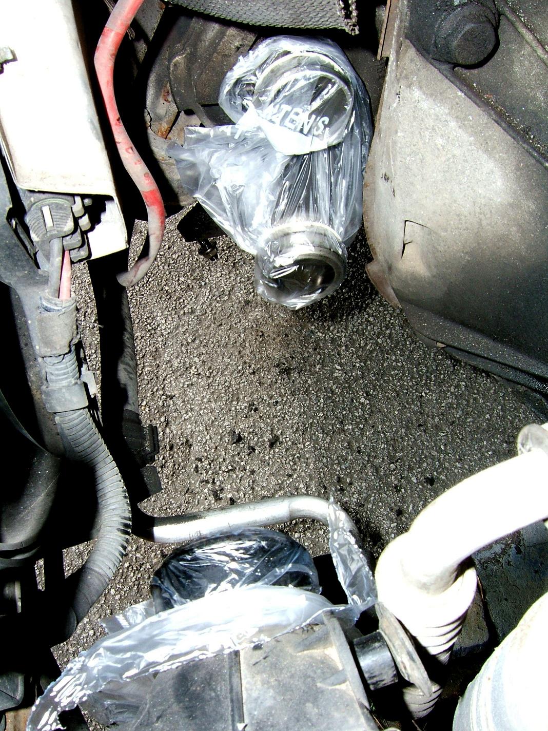

Tip: I bought 50 small sandwich bags and some rubber bands to protect inlets, outlets etc (See pic), and to bag up small, removed parts (bags then labelled with a marker pen).

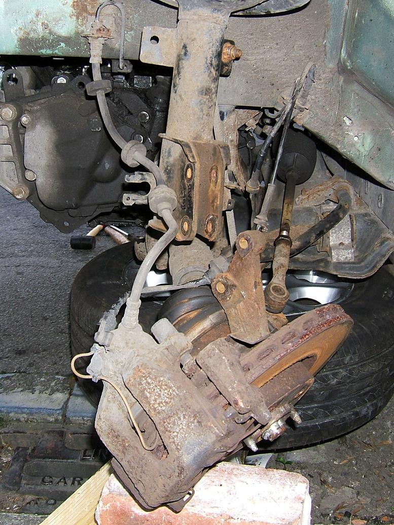

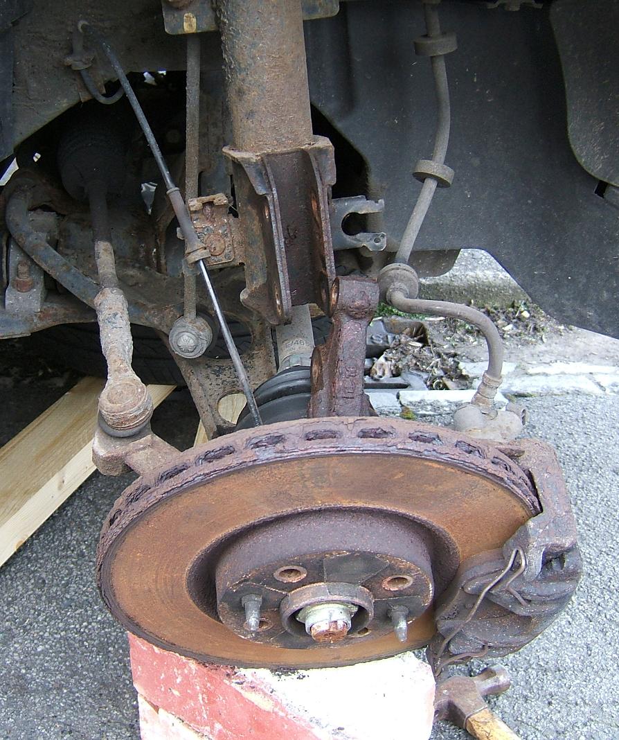

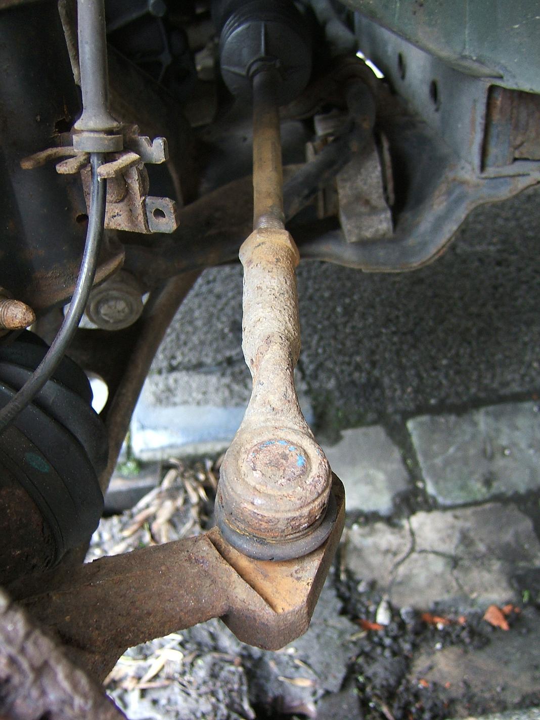

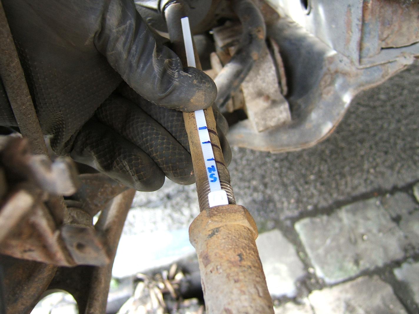

Detached NS track rod end (See pic)
In a previous post, I described a mistake I made trying to disconnect the track rod end ball joint from the NS hub. Tried again Today using the technique described in the Youtube video I posted earlier, where you lever the track rod end ball joint/pin against the hub. Didn't work because I couldn't find much to lever against. I resorted to sawing through the pin just above the stuck nut. (I put a new, hardened steel blade in my junior hacksaw. It only managed to saw though half the pin. When I checked the blade all the teeth had disappeared! So I completed the job with my 10 year old hacksaw blade. "Eeeh lad they don't make them hacksaw blades like they did in my day...".
Once I'd released the track rod end from the hub, I marked the position of the track rod end on the track rod with a cable tie and marker pen (See pic), then loosened the track rod end lock nut, removed the track rod end and lock nut, and cleaned up the track rod screw thread and lock nut with a wire brush attachment on my portable drill. To clean things up further I spun the lock nut back and forth on the screw thread with some WD40 (See pic). Reassembled everything to put the road wheel back on later. OS track rod end still to do.

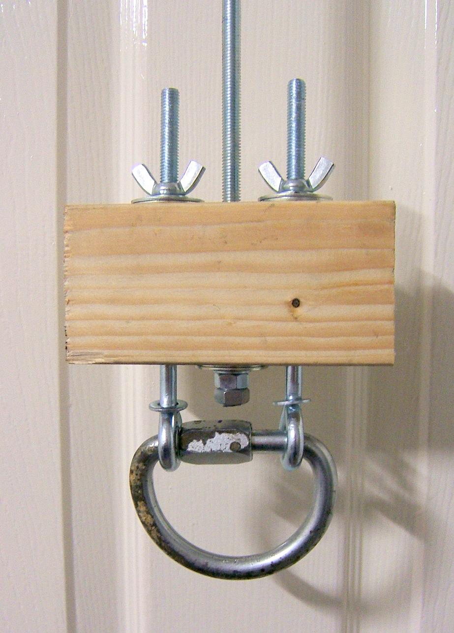

Problem 2: How to connect the vertical M8 lowering/lifting rod to the chain: Well I scratched my head for a lonnnnnngggg time. You see I have only very basic metalworking tools: a junior hacksaw, and a portable drill which on a good day will drill through a block of mature cheddar. However, I do have quite a few woodworking tools.
First thought was to attach an M8 eye bolt to the end of the rod with some nuts, maybe superglue everything together. But this arrangement felt intuitively weak/naff. Well to cut a long story short, I came up with the device/block below (See pic). Some of it's features: a) It solves the problem of how to attach the vertical rod to the bellhousing grab/chain, b) Under load the wooden block is under compression so hopefully it should be quite strong, c) It swivels, d) It's as small as I could make it, to allow maximum freedom of movement in the confined operating space, e) Once the lowering/lifting rod is at it's lowest/highest point, the eye bolts in the block can be lowered/raised a further 4cm, or independently to lower/lift at an angle, f) It's relatively cheap to make:
2 x 15cm M8 eye bolts (£2-50)
Wings nuts, nuts and washers (£2 Pick & Mix bag of bits from Wilkos)
Piece of wood 4 x 6 x 12.5cm (£pennies)
'D' shackle (£0 - already had one, sorry )
Total cost (to me): £3 ish
Finished and assembled the rest of the hoist in/over the engine bay. Looks OK but how will it handle a 37kg bellhousing?

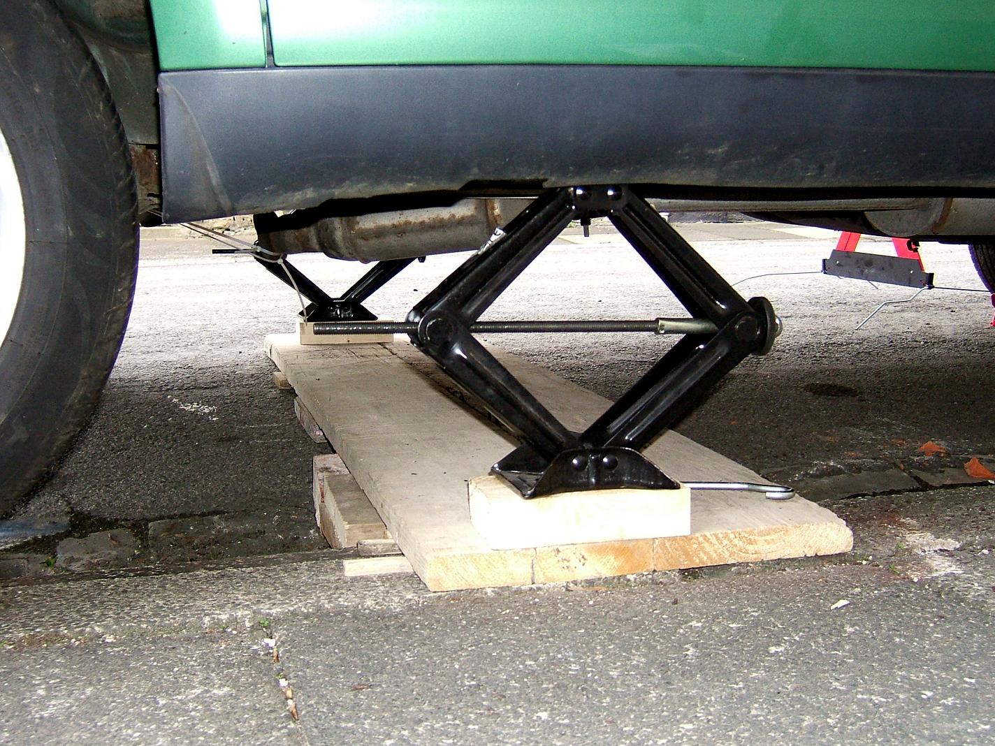

Jacking up
Couldn't start till late on Today, so plan was just to get car safely raised with the scaffolding boards, chocks and 2 Fiat jacks. Don't worry, I intend to install axle stands, wheels, etc. under the car as well for safety. I nailed and screwed the boards to the chocks to make things more secure.
I found out something interesting when jacking up the car with the Fiat jacks. Note that the base of each jack is now at the same level, sitting on a horizontal platform. Initially I placed the jacks under the front jacking points as prescribed, with the points of the scissor facing OS and NS across the car. I was careful to raise both sides of the car gradually, a little at a time. When I got so far, because the base and top of the jack is articulated, the OS jack I was raising began to tilt sideways on it's base towards the NS, and as the jack tilted, the car began to shift to the NS. Fortunately, because both jacks were at a similar height it didn't take much manual force to stop the car sliding while I quickly lowered the OS jack. Wow, I thought, it's not safe to use these jacks in the standard way under the jacking points.
So, I lowered the car back onto it's wheels, turned the jacks through 90 degrees (parallel to the sides of the car) so that the points of the scissor now faced the front and rear of the car, and placed each jack's top platform (very carefully) under the longitudinal beams at the sills about 4cm from the front jacking points. To test the stability of this arrangement I tried shoving the car from side-to-side and front-to-back. I also took the advice of a forum-er in a previous post and bounced up and down a bit inside the car. The car wobbled a bit as you'd expect, but stayed up (See pics below).

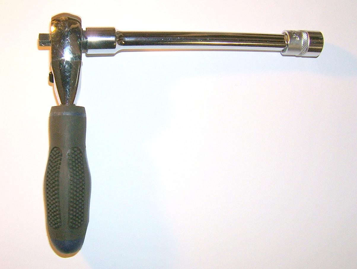

Starter motor, top rear bolt
Because I'm a masochist I decided to have a go at the starter motor top rear (13mm) bolt. The bolt appears to be way over-torqued, so a short stubby 13mm spanner, as some people have suggested, didn't budge the bolt head, or a normal length spanner, because there's no clearance at the back of the engine to move the spanner.
I couldn't reach the bolt head, from under the car, with a 1/2" wrench and 4.5" extension as access is tight. What would've worked is a 3/8" drive socket and extension (extension length around 6" (15cm). Maybe get one tomoz.
Instead I deviced my own extension from a round-headed, 6" (15cm) bolt, with the round end of the bolt sawed off to leave a square 'nut' underneath attached to the bolt threaded section. I fitted the square 'nut' into the drive side of a small 13mm socket over the 13mm bolt head. Onto the other end of my DIY entension, to enable it to be turned, I superglued two 13mm nuts. After a suitable glue-setting period, when I applied force with a wrench, the superglue gave way and my 13mm nuts turned instead of the 13mm starter motor nut. (Please note when I say "my 13mm nuts" - my own nuts are larger than 13mm last time I checked). So much for not-so-super superglue. Then I had a brainwave and began braying the end of my DIY entension/bolt with a hammer to round off the end and fix the 13mm drive nut in place at the end of the bolt. This worked a treat, or so I thought: as I turned the now captive drive nut (stiffly) with a stubby wrench I sensed what genuinely felt like the starter motor nut beginning to turn - until my DIY extension/bolt snapped into two pieces! (n) Wow that starter motor nut is really tight. 20Nm? - I think not!
So tomorrow I'm going to purchase a 6" (15cm) 3/8" entension to get at the starter motor bolt. I don't think I could get enough force/leverage on the bolt using a stubby 13mm spanner.

- Safely supported car on axle stands and Fiat car jacks.

Safely supported car on axle stands and Fiat car jacks: I spent a long time getting the car as safe as possible with the load eventually borne by 2 x 3T axle stands near to the front jacking points under the longitudinal beams parallel to the sill beams, backed up by the 2 Fiat jacks under the longitudinal beams at the sills. Bounced the car up and down, side to side, and back and forth to test. More solid than just the jacks alone. A little disconcerting though hearing the supporting wood and rear tyres creak as I slowly jacked things up. The rear tyres are chocked front and rear, with the NS rear front chock backed up by another chock - a piece of wood nailed to a crack in the pavement edge. I'll do the same for the OS rear tomorrow. Don't want to nail into the road tarmac, the council wouldn't like that, but I'll fashion something...
Notes for Novices Section 2 Jack up the car and support on axle stands so the front sub-frame is 400mm above the floor:
I think when I measured this with a tape measure I have the subframe 450mm above the deck, so should be no problem there I hope.

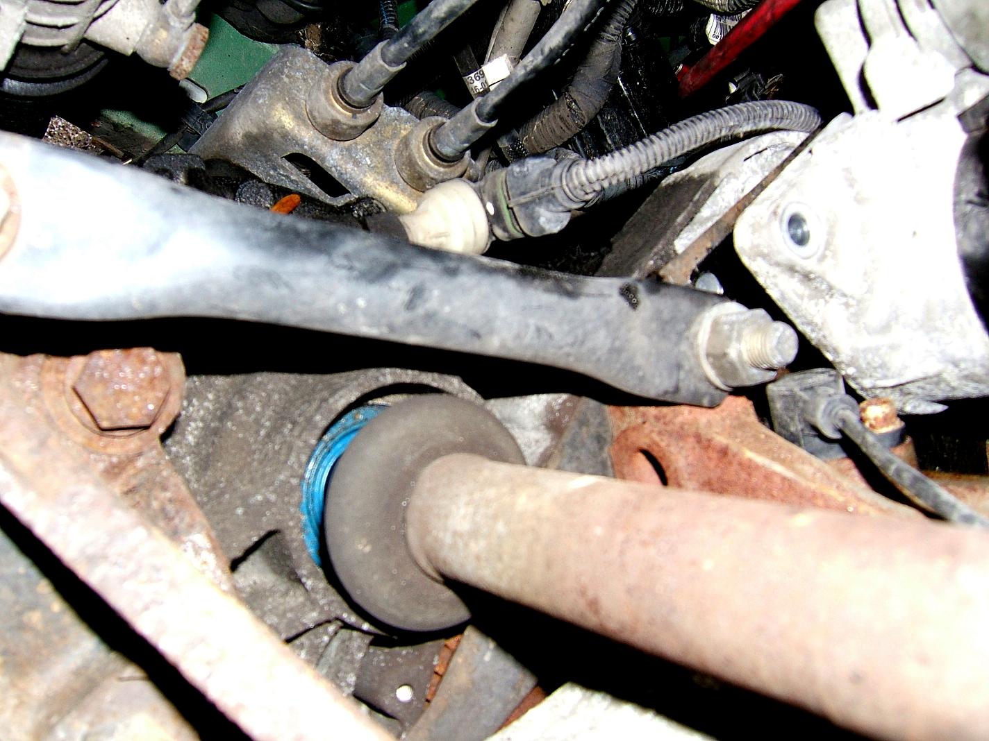

Removed all 3 starter motor bolts: A big stumbling block this until you have the solution, or 3 solutions, one for each bolt.
Top bolt nearest the front of the car: Working from above the engine... I used the device I described in an earlier post to sort this bolt.
Top rear bolt: Working from under the car... 3/8" drive 13mm socket, on the end of a 6" 3/8" drive extension (Laser 1145 Extension Bars 3/8" Drive 2pc, 6" (145mm) and 3" (70mm), £5 local partstealer), and my stubby combination 3/8" and 1/4" drive wrench (£3 Homebase, bargain!) (See pics). This arrangement works perfectly with this bolt, with the wrench fitting nicely just to the left of the oil dipstick tube. I managed to undo this bolt with the rear mount still attached and with one (right) hand. Very tight at first then easy to turn.
Bottom bolt: Working from under the car... 3/8" drive 13mm socket on the end of my stubby wrench. No extension required. Easy.

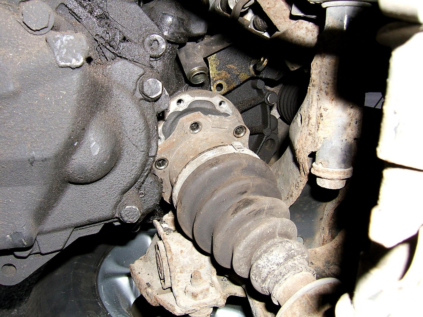

Disconnected and withdrew NS driveshaft from gearbox/differential:
Notes for Novices Section 26 Disconnect NS drive shaft:
I had already tackled the 6 NS driveshaft bolts in an earlier post in this thread (See above).
Notes for Novices Section 27 Break the NS suspension: As stated in thread Clutch Replacement - Additional Notes, there is no need to undo the drop link or tie rod/track rod end. I just undid the 2 hub to strut bolts. When you withdraw the hub from the strut the NS driveshaft pulls away from the gearbox. Sorted. The hub to strut nuts were quite tight - I used a 4 ft breaker bar on the end of my wrench. I then whacked the end of the bolts with a mallet and hammer to drive the them out of the strut. Tip: Support the hub BEFORE you try to remove the bolts as this takes the load off the bolts (See pics).

Same as NS above - just undo the 2 hub to strut bolts.
Notes for Novices Section 29 Withdraw the whole OS driveshaft
...: Once the hub is disconnected from the strut, a pull on the hub pulls the OS outer and inner drive shafts out. When I checked the OS inner driveshaft bearing from under the car, it had moved 2" (5cm) towards the OS. Hoping that this is enough to clear the OS inner driveshaft from the gearbox/differential/bellhousing. Will find out tomorrow (See pics).
A few observations...

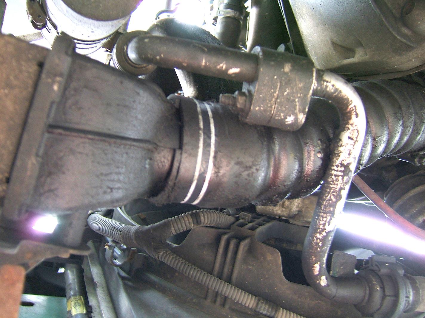

Just looking at the pics I took, I didn't realise that the OS gearbox driveshaft seal is on the outside of the clutch/gearbox bellhousing so presumably the seal can be replaced without detaching/removing the bellhousing? So it's not urgent to replace the seal during the clutch replacement procedure (if it looks OK)? (See pic).
Two problems I had expected and feared, described by other forum-ers: 1) Trouble withdrawing the hub from the strut and 2) Trouble withdrawing the OS driveshaft, requiring a puller - fortunately didn't materialize. The suspension breaking/driveshaft removal went without a hitch: Once the 2 hub-strut bolts were removed, the hubs virtually dropped from the struts, and no force was required to pull out the NS or OS driveshafts. Relief.

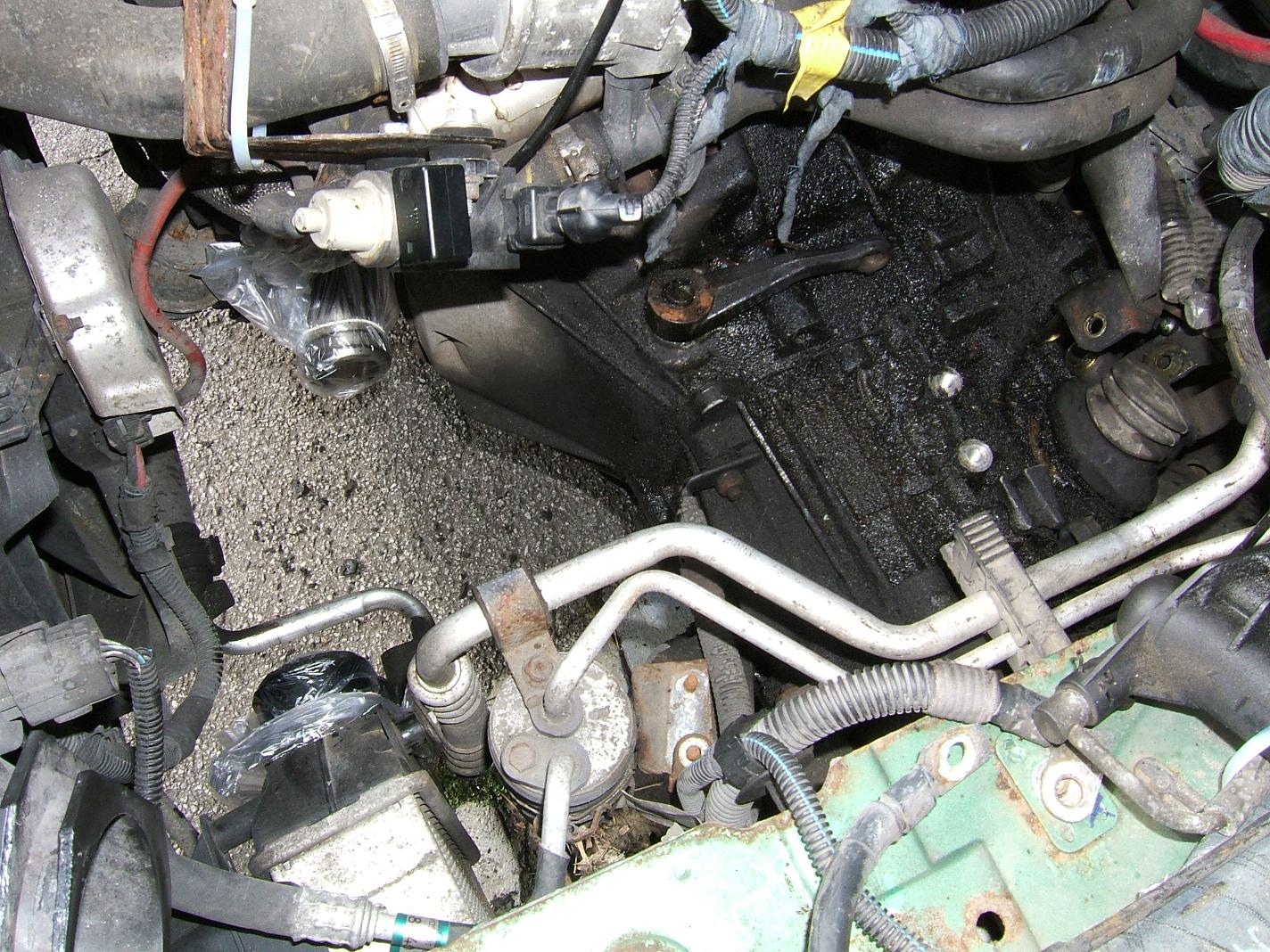

Latest update for the last three days...
- The long stud
- Removing the gearbox
- Surveying the damage
Note: I didn't take many pics because the batteries ran out on my camera.

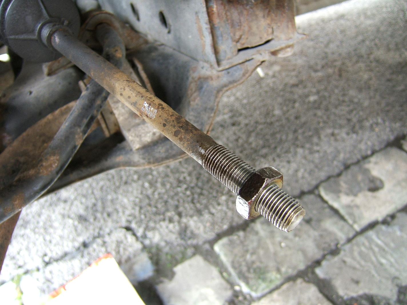

The long stud
Notes for Novices Section 23 Remove the long stud:
On the first of the three days, I came unstuck as I couldn't remove the long top stud.The nut came off the stud no problem, but the second nut, required to remove the stud and taken from the lower stud, became stuck on it's stud - the lower nut AND stud came out of the bellhousing together as I undid the nut. The nut was stuck fast due to thread lock and the nut was the locking type with a spring-metal collar around the top. I tried gripping the unthreaded part of the stud with molegrips to no avail. A neighbour - who lent me his Transit jack to support the engine, thanks A. - suggested heating the nut and stud red hot -err how?, plastering with WD40 and trying again. Got them hot on the only thing available to me - my camping stove, and used WD40 and Plusgas but still no joy. Sh*t I thought, now I'll have to lower the front subframe. So the day ended badly...
Day 2:
The next day first thing I tried again. Much better grip on the stud this time, but maybe the penetrating oil had done it's job overnight, and the nut began to turn... Hooray! Cleaned up the stud thread with a wire brush.
Now for the top stud. Top stud nut screwed on first, then the lower stud nut. Spanner on the second nut and the top stud came out easily. I think the spring collar on the second nut helped to lock it into place on the stud.
Note: Notes for Novices Section 20 says that the upper and lower stud are 18mm and 19mm respectively - mine were BOTH 19mm.
So off we go...
Notes for Novices Section 21 Remove the rear mounting, paragraph iv: Note: As Additional Notes states, there is no need to touch the long bolt in the centre of the mount. The mount came off easy peasy. Also very obvious once rear mount is removed how much easier it is to see and access the starter motor.
Notes for Novices Section 22 Release OS inner driveshaft bearing: Already done this.
Notes for Novices Section 23 Remove the long stud: Already done.
Notes for Novices Section 24 Remove the starter motor bolts: Already done this. As Additional Notes states: leave the starter motor bolts until the rear mount is off.
Notes for Novices Section 25 Drain the gearbox oil: Already done.
Notes for Novices Section 26 Disconnect NS drive shaft: Already done this.
Notes for Novices Section 27 Break the NS suspension: Not necessary in my opinion, but... I had already undone the track rod end earlier which maybe gave me more hub movement to move the NS driveshaft right out of the way at gearbox removal. Also wondered whether the drop link was holding up the anti-roll bar thus preventing the NS front subframe from dropping, so I undid the top drop link joint (very very tight to undo, gave the junior hacksaw a day off !)
Notes for Novices Section 28 Break the OS suspension: Didn't do it.
Notes for Novices Section 29 Withdraw the whole OS driveshaft...: Once Section 22 is done, all but 1/2" (12mm) of OS inner driveshaft came out of the OS gearbox driveshaft seal, so thought that was OK.
Notes for Novices Section 30 Support engine on hydraulic jack and disconnect the earth: Did both. Borrowed my neighbour's Transit scissor jack with block of wood under gearbox end of sump. Levelled the road camber underneath engine with more wood and chocks.
Notes for Novices Section 30 (remove the front gearbox support): Bolts and mount came out easily once started. Also as stated in Additional Notes I didn't undo the mount central bolt but instead the 3 x 13mm bolts which fix the mount to the chassis.
Notes for Novices Section 31 Loosen bolts and separate the clutch bell-housing from the engine: No problem. Very tight then easy once started. Nearly rounded Notes for Novices Section 20 Bolt (a), 13mm, NS because couldn't get my socket and wrench on it properly - sh***************t. Nearly came unstuck.
Once all the bolts were loosened to about 1" (25mm) (I found that most bolts were unscrewed completely at 25mm) used my little prybar to pry open the bellhousing, but it was hardly required as the bellhousing was quite easy to detach. Left the flywheel access plate on.
Notes for Novices Section 32 Lower front subframe: Top stud removed earlier (hooray!) so no need to drop subframe or... see below...
Notes for Novices Section 33 Lower clutch bellhousing...: So I assembled my DIY lifting/shifting device in/on top of the engine bay, wrapped a 1m chain round the gearbox and secured it with a snazzy carabiner (pics later), then attached the hoist to the carabiner, and began lowering... I was following Additional Notes so to get the gearbox out you have to rotate it - looking through the NS wheelarch - ANTICLOCKWISE to lift the gearbox over the front subframe. Nearly made it, very tight, but found that I couldn't get the gearbox over the left bolt and nut of the NS wishbone bush. Also note that the gearbox lever balls get uncomfortably close at the top to brake pipes, so watch out. So I undid the 3 NS subframe bolts (N4N Section 32, diagram: NS 18, 20a, 20b) about 1/2" (12/13mm). This allowed the subframe to drop about 1cm which gave enough clearance to lift the gearbox over the subframe. (Sorry if I sound repetitive, but I think stating things clearly is more important than not being repetitive).
The rest of the gearbox lowering process was just fiddling around with my hoist to avoid various pipes in the engine bay. I added another carabiner to the hoist when the gearbox was lower down to get the box right down to the ground. I was very happy with the hoist. It became more solid once it had a load on it (not that it was flimsy beforehand). It includes a big - but cheap - support beam which I thought I would have to rope back to prevent it sliding back and forth, but no rope was required. The support beam can be moved front-to-back and side-to-side, it stays put once it's moved into position, and the hoist - a 1m M8 rod with a nut and washers on the rod above the support beam, and a block and shackle at the bottom of the rod - provides the up-down motion.
Once on the ground I was able to pick up the gearbox using the bottom carabiner as a grab handle.
