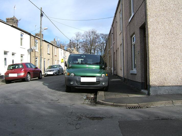

Next, I was in the process of jacking the car up higher, I think Notes for Novices suggested 40cm of clearance to get the clutch out, the car's been sitting 30cm up on a single NS axle stand under a thick metal beam near the jacking point all week no problem. I thought I would get the OS front sitting on another axle stand then jack up the NS a further 10cm to get the required clearance. Well I did the first bit and then started jacking up the NS, when the whole bl**dy car lurched forward to the NS and toppled off the stands and jack and onto the NS hub/brake disk. Made a nice dent in the paving stone. Luckily I wasn't underneath at the time, but it was a shock. I had to sit down quietly for a bit to calm down.

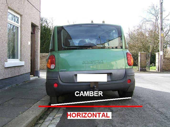

You may recall me saying that the car is on a normal street with quite a camber, with the NS/gutter being about 15cm/20cm lower than the road under the offside wheels. The NS front wheel/hub which was parked parallel to and in the gutter is now 15cm onto the pavement. Incidently the front brake disks look past their sell-by date - need replacing anyway - so I'm not worried about any damage resulting from the above.

Difficult to say without seeing photos and bearing in mind it must be safe no matter what you do. Have you shifted the car over so that the 2 NS wheels are on the pavement? That will reduce the effect of the strong camber and still give you maximum clearance if you have the gearbox over the 'gutter'. Make sure you have both rear wheels very well chocked behind and in front. That will help stop the car moving around. Don't just rely on the handbrake.
If the road camber is strong, don't use the axle stands. Their footprint won't be sufficient to stop the car moving sideways (as you've found). Can you beg or borrow a pair of wheel ramps? Cap those with some old bits of scaffold plank and beach the sills on those. It will be much more stable.
Safest way is obviously level ground
But as widemouthfrog has said try to solidly support the cills on something
If you have spare wheels kicking about (not just tyres) they create a good solid base coupled with scaffold board
Only front NS wheel on pavement (when the car lurched forward), could get help to get the rear wheel on as well maybe... Problem is I only have the weekends to work on car, I am at the quiet end of the street, but local cops are quick to act on illegally-parked cars. Car will be parked until next w/e at least.

Yep sorry about that. Used the wrong method to upload pics. Try again...
Not much downslope but with both front wheels off and front end jacked up, there's only the OS rear wheel in contact with the ground to stop the car moving forward or back.
With this arrangement on uneven ground I don't see how you can guarantee the car won't move, and with me underneath that would probably be curtains...
Just getting the axle stands -and jacks- level is a problem.
Clutch replacement procedure doesn't seem safe to me unless you do it on level ground...
What say you?
Bricks under n/s rear tyre
Boards under car o/s to n/s
Road to pavement
Shim underneath boards where axle stands are going
Axle stands at front
Fiat jack under sump with block of wood on it
Use trolley jack to aid gearbox removal
Using trolley jack first to get car up high enough
Try that and see how secure it feels

I've contacted local scaffolding firm to price some scaffolding boards -very reasonable... to make jacked up car safe. Unfortunately the boards are only 22.5 (9in) wide. My 3T Halfords axle stands have a 25cm footprint so need a 30cm board/plank to be stable. Staple 2 boards together maybe?
Going to get some help to get NS back wheel onto pavement (USA translation: sidewalk) as well as NS front wheel to reduce the effect of road camber. Thanks previous responder for this advice.
