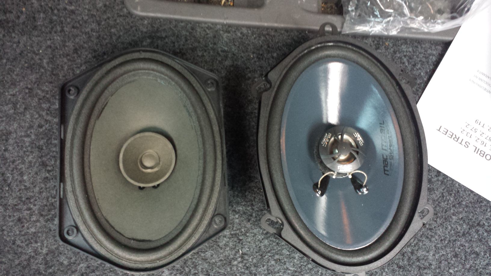

and some 5x7 rear speakers.

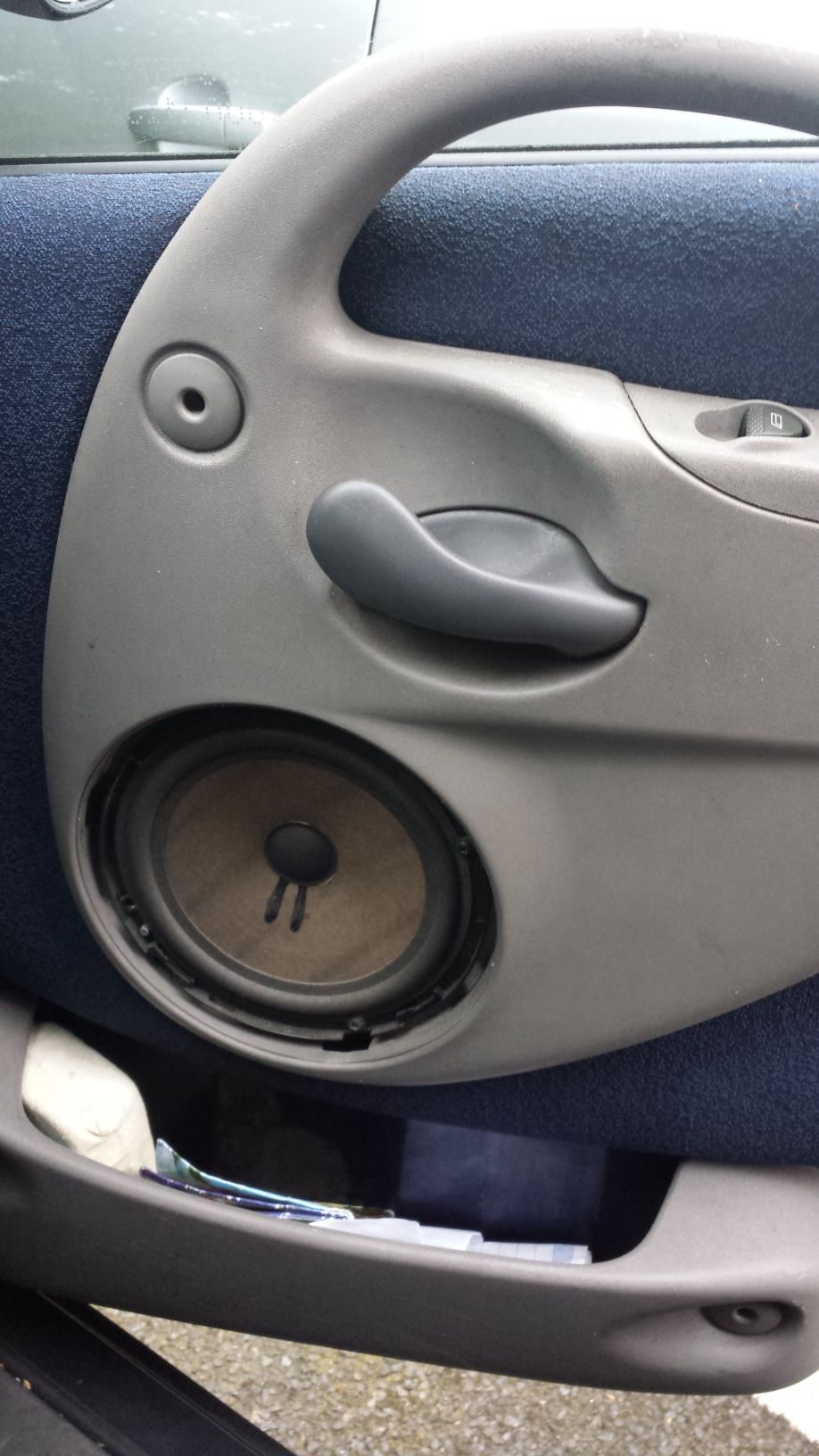

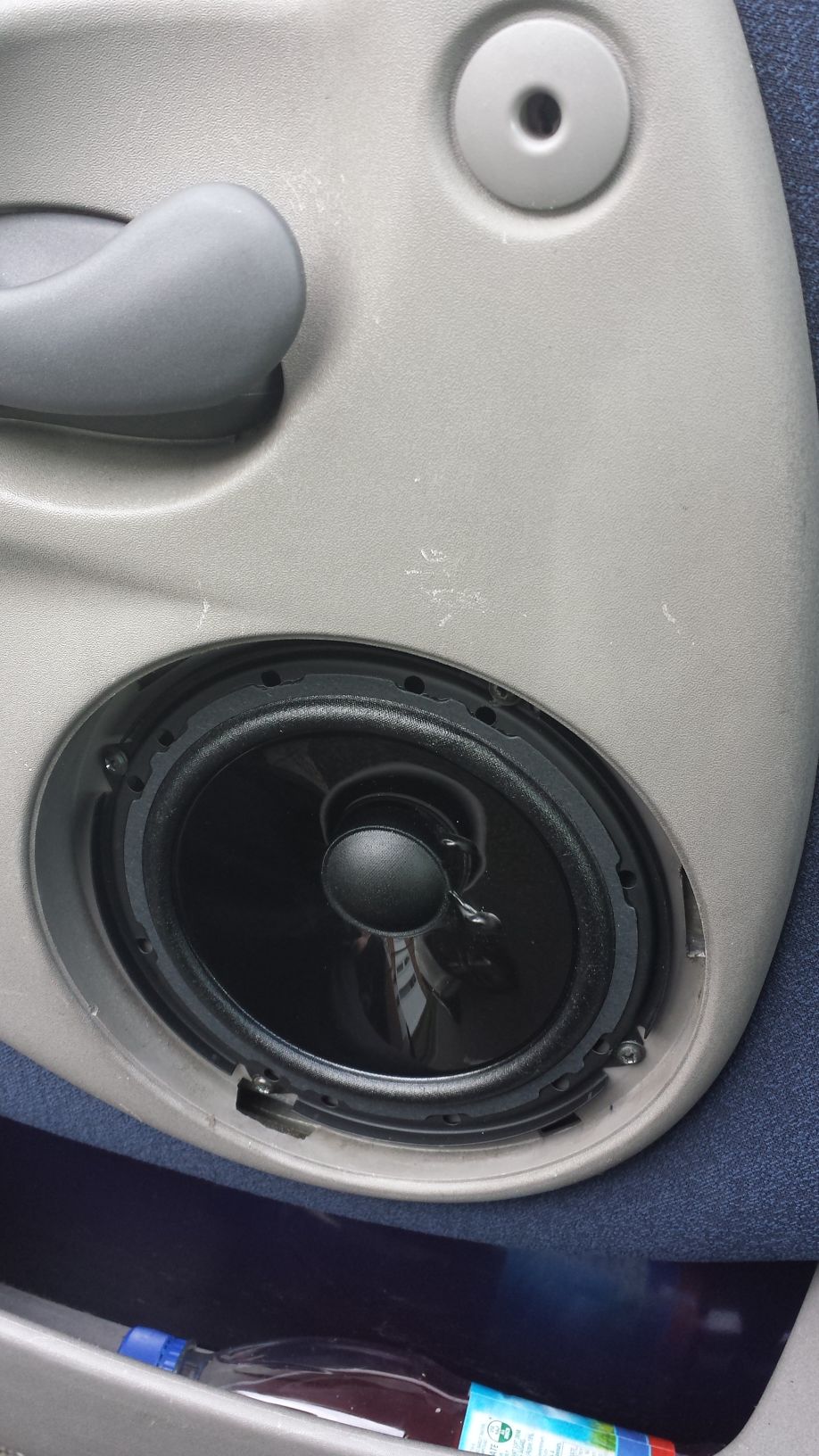

The Fronts were easy enough to fit. I simply removed the speaker grill with a wide flat screwdriver. Prised straight off. Then it was an easy four screws to remove the OEM speaker. I then fitted the spade connectors to the speaker, connected it and installed it using the existing 4 screws.

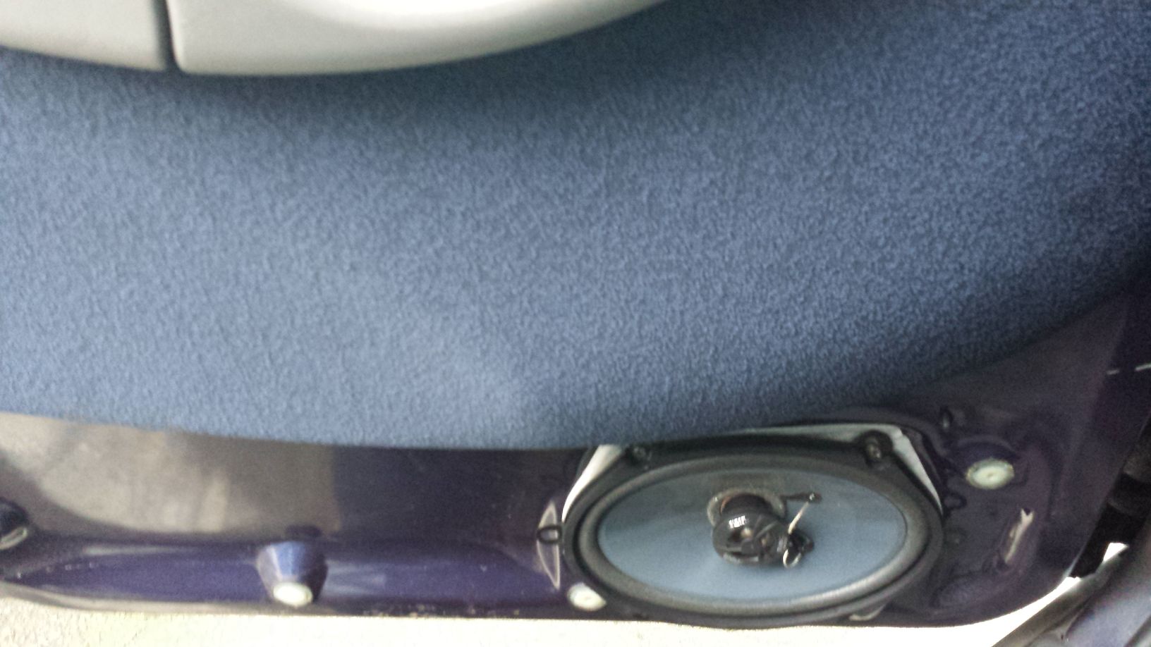

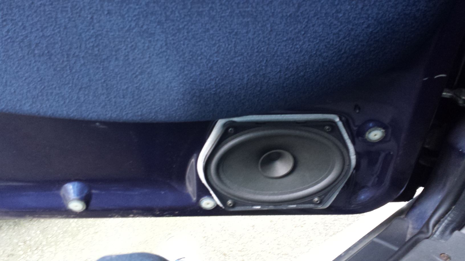

The rears were a little more tricky. Pop out the two screw covers. Then unscrew the 4 screws to remove the lower door pocket. Then remove the speakers by removing another 4 screws. Attached spades to new speakers and fit using the connector and existing screws.
