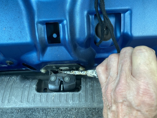

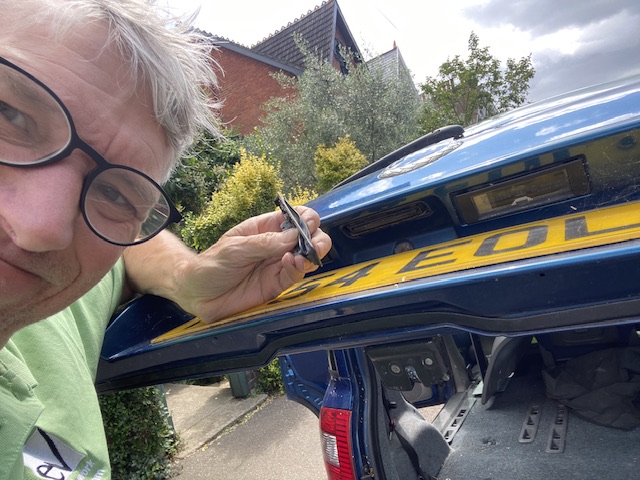

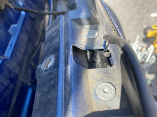

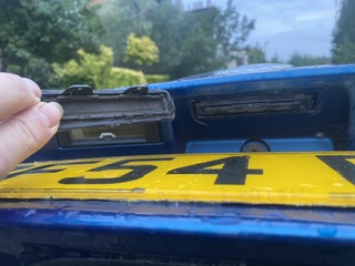

I have had problems opening the boot on my 05/54 Multipla too. I could not find anything in FF until I googled it and this old string came up. Our lovely cars are growing older gracefully since and developing these problems more so hopefully this string is useful for others!
The Multipla was needed to help a friend move in to a flat and needed that boot working after weeks of proselytising! With no seats it (middle front folded flat and front left removed - fails the MOT if all are not in properly btw) it can accommodate a 4x8 5mm plywood sheet!
It was so difficult opening in the end that I think I actually broke my left index finger! It has swollen up rather a lot! I used a claw hammer in the end and that just dug into the mechanism and permanently f'd it up

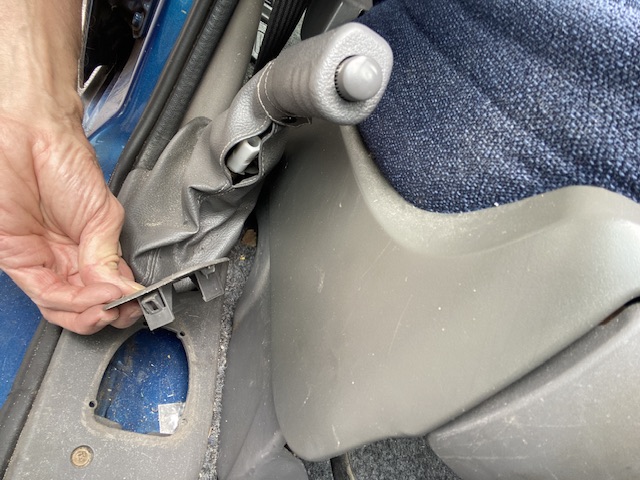

Following your posts and dreading a part search and/or £65 relay, I dismantled the trim, found that lever (too tight for my small finger so a large flat screwdriver did the trick). Looking at the metalwork and the 'broken' external catch there seemed no way to get the catch from inside and there was an electrical lead which led to it, disappearing behind the metalwork. If that was broken internally I was done for!
I have no pull mechanism from the handbrake as some variants had. A removable plastic cover plate covers the hole where it would have been.
As the boot was up I could access the catch easier and see that it was significantly pushed in! I levered it out and reset the plastic catch (with a rubber seal, quite fiddly) in the housing. Still within the bodywork of the external catch was a (pressure sensitive?) plate which was quite insecure so I doubted it would be reassemblable. However on refitting the 'repaired' catch it seemed to hold.
I closed the boot and tried to open it and it worked!!! No dissembling, cleaning or regreasing at all. Hurrah! Maybe that plate activates the electrical relay and needs to be properly aligned. Somehow I had earlier skewed it, definitely when I used a claw hammer and it 'popped'.
I have left the trim off now just in case I need to flick the lever from within.
Good luck all with similar issues! Try this first!

Hi, all!

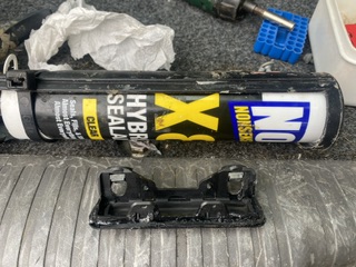

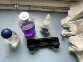

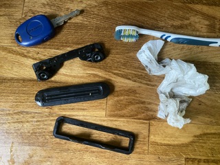

Update - my 'repair' failed so I dismantled bottom rear exterior panel (4 internal posi screws and 3 exterior torque bolts near reg plate) and then two smaller torque bolts removed to the rectangular microswitch assembly I prised out ths unit which had obviously sheared along one long edge. I cleaned the units up, the washer had perished and was irreplaceable so I tried waterproof silicone (messy and fiddly). After two attempts supergluing I eventually held it together with two very fine cable ties running through two sets of convenient through holes! After reassembly (fine cableties not a problem) it all works fine and hopefully will last!
