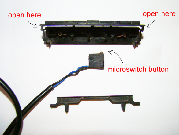

Thanks to Spudd for brilliant explanation, did it and further "developed" as well, as after dismantling decided to try DIY reanimation and it worked , my boot can open again.
What have I done:
1. Completely opened housing of the microswitxh (being careful not to brake plastic holdings on sides - heating with house hair dryer did the job).
As non proff mechanic wit noo proffesional tools I used two swiss knifes and "voila" - opened
2. Cleaned (brushing with small brush) entire housing from inside including outer side of actuall switch.
Where the problem was, - button on the switch itself was blocked by mud that was created by dust and moisture - and it simply could not move.
As non native English speaker, thought that "picture whatever for 1000 words so here is the atachment with pic of switch in parts before reasembling. Marked with arrows those plastic holders you have to be carefull about
Not to mention that saving is at rate of 200 Euro here in Croatia
