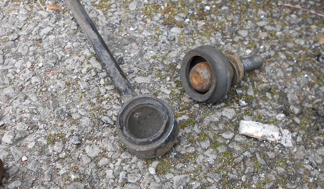

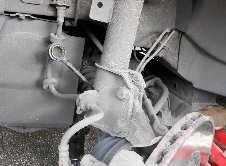

Doing my Brakes today (Pads were down to about 2mm, so perfect timing!), took the left Wheel off, and was greeted by this sight . . .
attachment.php
Might explain the noise on full Right-Lock which I assumed was a CV Joint.
Top Socket has broken away at some point, did hit a particularly deep Pothole a few days ago.
attachment.php
Luckily my local Motorist's Discount Centre had a pair of Links in stock, £10 each.

Seeing that reminds me that one of my neighbours who's a mechanic told me the way to remove droplinks is to pop the balljoints apart like that. Normally when you try to undo the bolts on the droplink the ball joint spins round and nothing happens. If you pop apart the ball joint then you can get a mole grip on the ball and the nut will be easy to undo.
The 'ball' fittings have flats on them, on the 'Ball' side of the ARB, for a 17mm Spanner.
You need a fairly thin Open-Ended for it, <5mm.
Also, the end of the threaded section has an Allen Hex in it, so you can hold it with a 5mm Allen Key.
Not all makes of drop links have the flats you mention. As for the Allen socket, the usual outcome with a corroded link is that end of the thread either splits open or the hex rounds out. Cue lots of swearing.....
