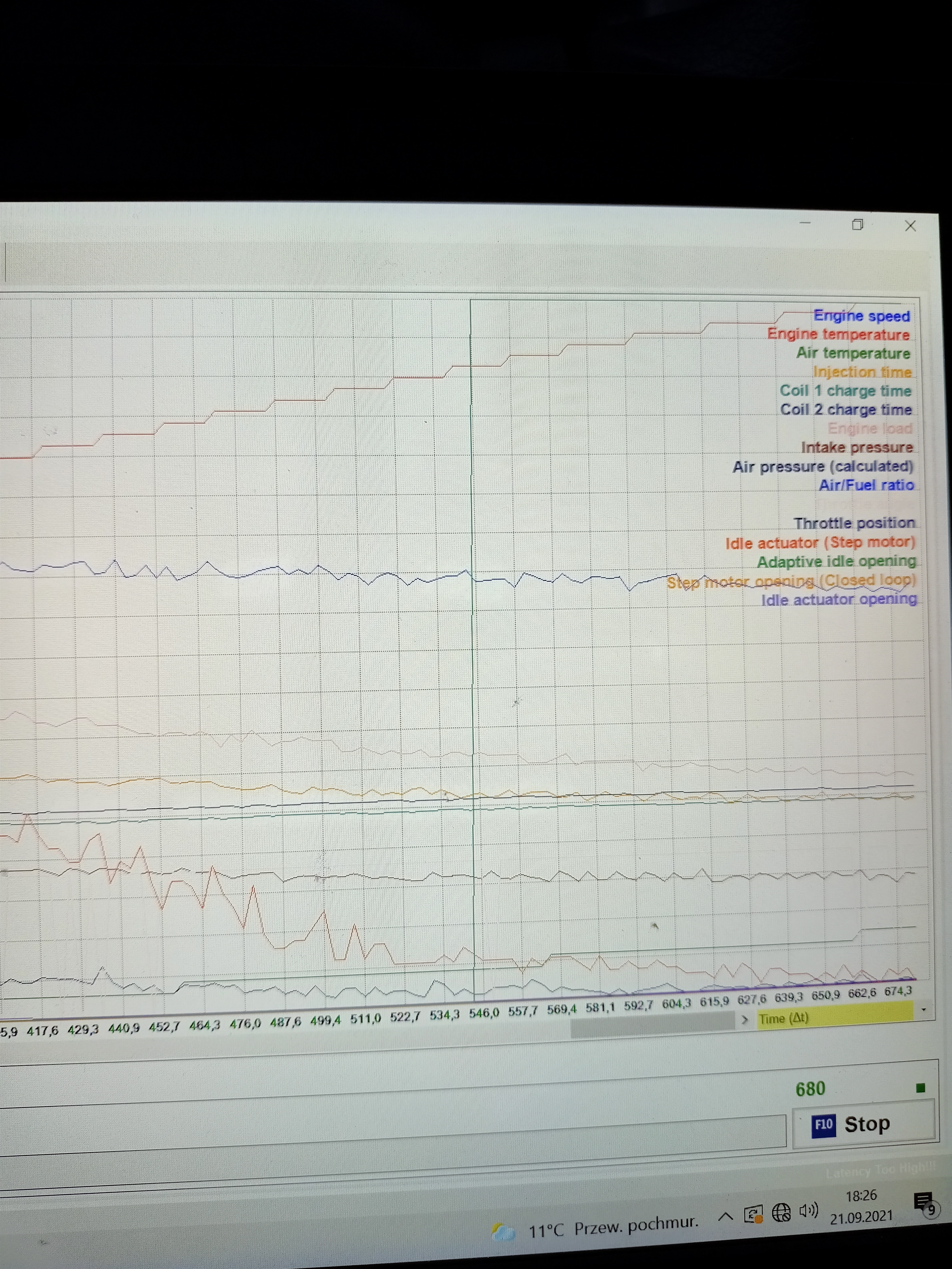

Adaptive Idle Opening Value Shot to Value 65535 so i think to infinity.
What does can mean? Can you see to all parameters in time?
This is full Self adaptation with wheel.
Please tell me where to look for issue.
In .zip full table .csv

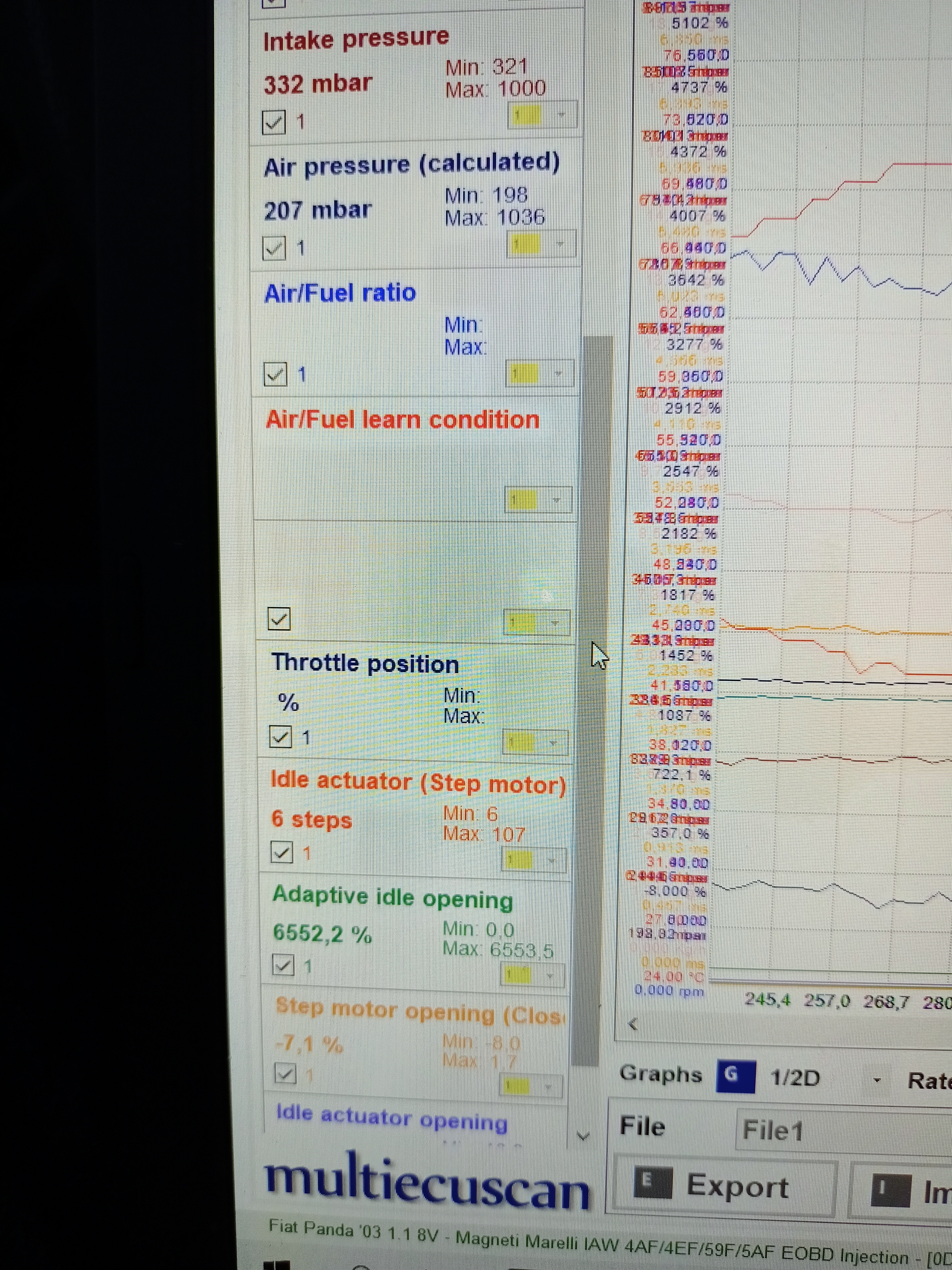

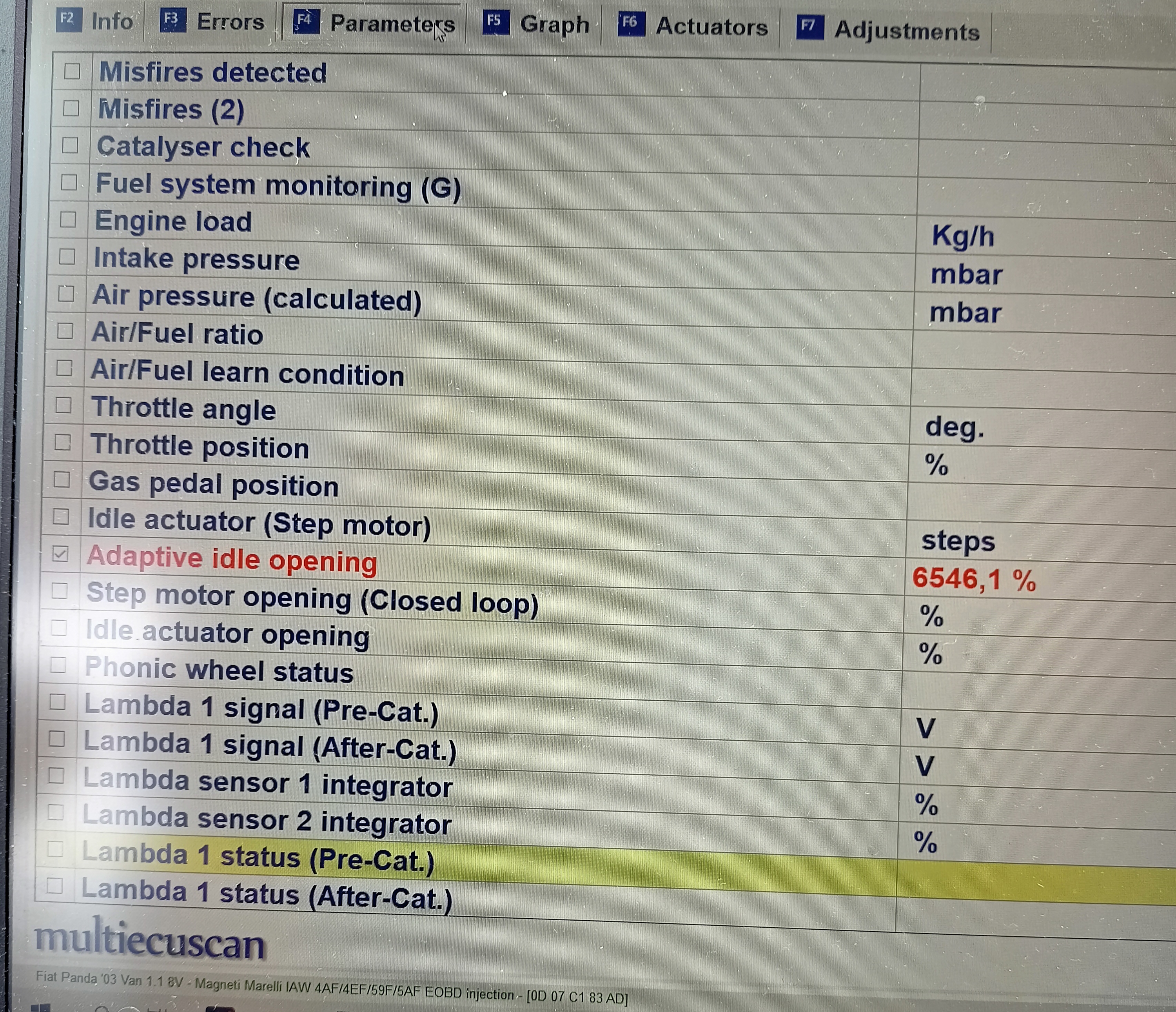

Anyone can help me why this value is so freaky?
Panda 1.1 8V 2005 (169) i think adaptive idle is responsible for the engine quake in the low RPM range
I'll go with g8rpi in that do you really have an issue or are just looking at MES data?
MES is not perfect and like any tool has to be treated carefully, with respect and understood.
Why you have that high 6000+% reading I don't know but this reading alone would suggest a possible software issue or a sensor that is sending data out of range for/to which MES was coded to expect.
