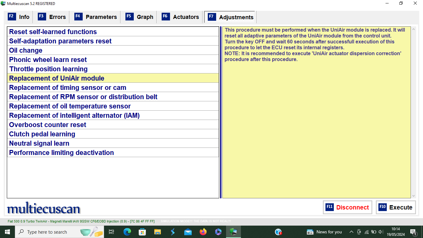

I am going to change out the Uniair unit in my 500 twin air 105 and can see there is advice in MultiECUscan as per below image .
OK so I can do the reset as in the image but it also recommends doing "Uniair actuator dispersion correction" . Anyone know what this is and can it be done from MultiECUscan too ( maybe it has a different title ? ) thanks in advance

Thanks for the tag. That procedure only seems to feature on the Euro 5 cars - and I think not all of those cars have the facility either. I remember trying it on a 2011 Euro 5 and found the correction wasn't enabled in the ECU. So I wonder if it was an early thing that they later decided wasn't needed.
(All the 105s were Euro 6 I believe...)

Not sure what you mean about "writeup of replacement". Are you referring to the replacement of the Uniair unit? As for MES I was referring to the only 0.9 Uni Air 500 listing where the 'UniAir actuator dispersion correction' is listed in MES. Are you using/choosing a different vehicle?
Thanks for the dialogue back on this Guys , very quick and helpful
I have now looked in the other version of the engine available for the 500 0.9 Turbo Twin Air ( IAW 8GSF CF5 ) in simulation mode in MultiECUscan and can see it . So hopefully not required for my engine ( IAW 8GSW CF6 ) .
