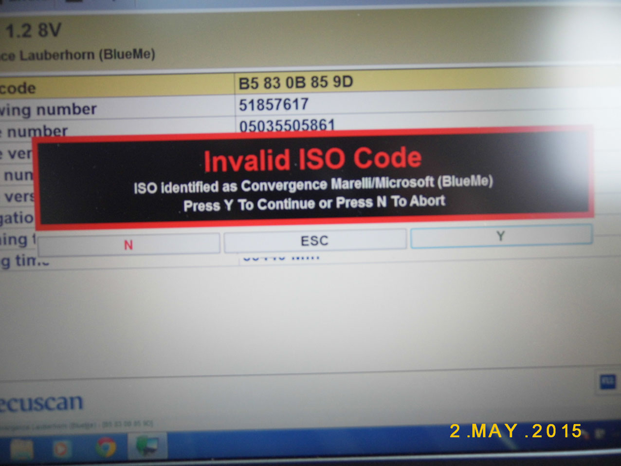

A couple of error messages that I got. Didn't stop me connecting to the right modules to reset what I wanted though.
Do you have a "modified" interface? Many of the cheap ones have a design error that connects a 120 ohm resistor across the CAN bus pins. This causes errors on some modules. The modification is to remove the resistor. You can check for the modification by measuring between pins 6 and 14 (CAN bus) of the OBD connector with a multimeter set to ohms. If it reads about 120 ohms you have a unit with the design fault. The resistor can be removed yourself if you are OK with a soldering iron. The location of the resistor depends on the interface you have.
