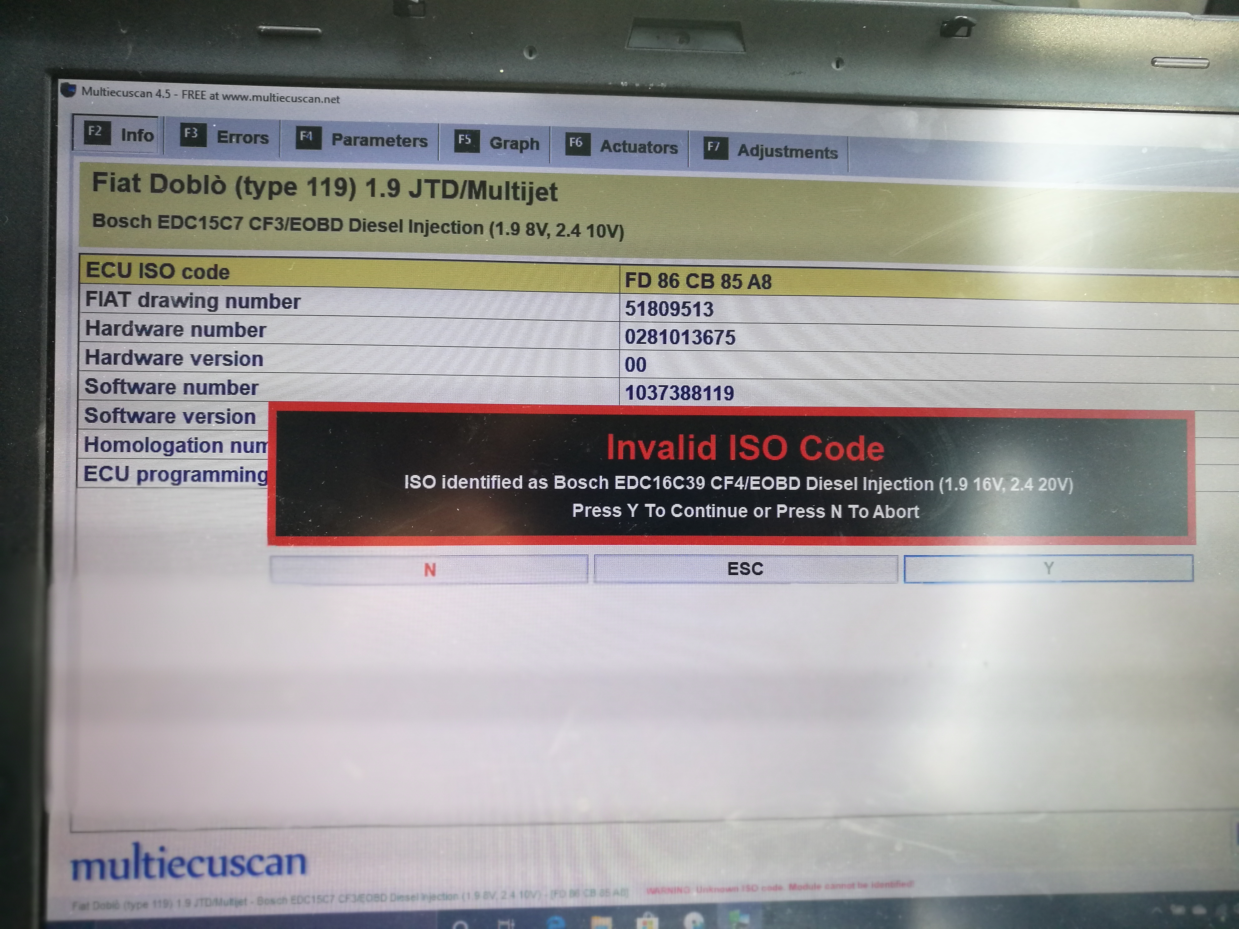

Hi I've tried searching for this with no outcome.
when I go to connect my Doblo 1.9 multijet 120 to mes it only let's me connect as 1 6 valve engine and will not connect as 8 valve. I'm pretty sure the Doblo is an 8valve but I've done some procedures as it was connected as a 16 valve successfully.
it's a 2008 Doblo, can anybody clarify if Fiat made a 16-valve engine on these and by the look of it I'm pretty sure it's an eight valve???

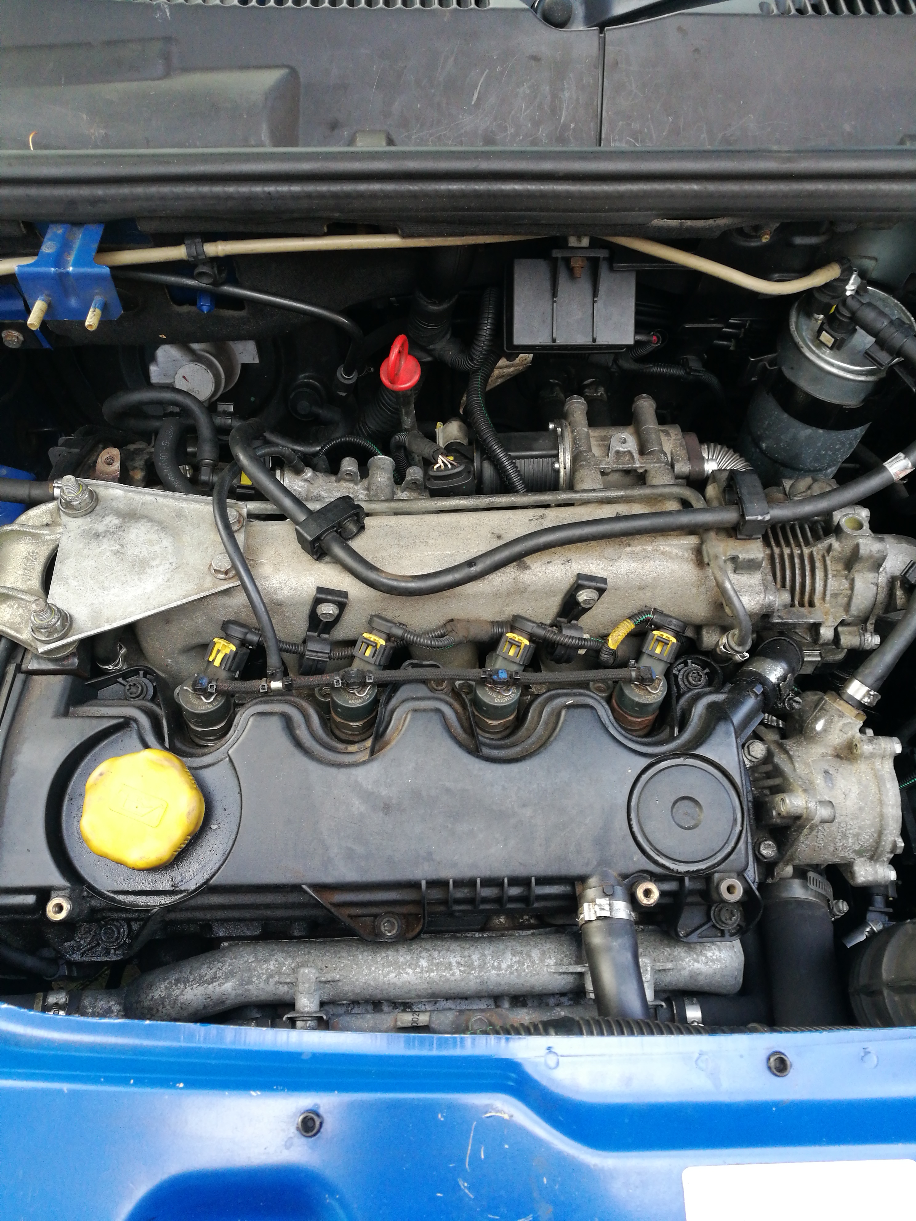

One thing I can add is that there is only a single cam sprocket. So whether a single overhead cam can have 16 valves or not I don't know
Ah well then, oil filler is front left and Mes reporting EDC16C39, but also reports together with that 16v. Attached pic is when I first put it in as 8v
Do you have a plastic cover for your engine?

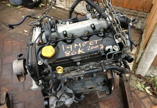

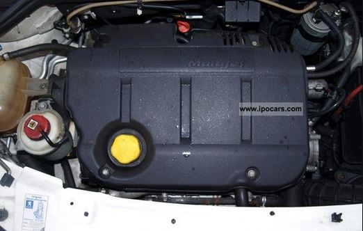

Searching through images on Google (some attached below) it looks like a 1.9 JTD/Multijet that's missing its top cover?
Similar to the 1.9 8v JTD engine pictured in this guide?
https://www.fiatforum.com/stilo-guides/263681-clean-egr-valve-1-9jtd-8v-engine.html
Not sure this really helps with your original question!
  • FIAT_GRANDE_PUNTO_DOBLO_1.9 MULTIJET_DIESEL_ENGINE_199A5000_130BHP_Gumtree.jpg

So as the MES is reporting EDC16C39 16 valve I'll take it that is not a problem.
If anyone else has had this or has anything else to add regarding 8v 16v on the 1.9 multijet please comment.
