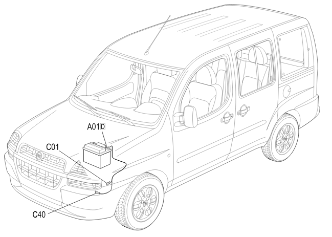

That's the list of all earth points, but can't find a diagram which shows all of them on the van:
C001 BATTERY EARTH
C002 BATTERY EARTH ON ENGINE
C003 BATTERY EARTH ON BODYSHELL
C010 LEFT FRONT EARTH
C011 RIGHT FRONT EARTH
C012 ABS FRONT EARTH
C015 DASHBOARD EARTH, DRIVER''S SIDE
C030 LEFT REAR EARTH
C040 ENGINE EARTH
C050 AIR BAG EARTH
C053 SIDE BAG + HEAD BAG EARTH
C054 PRETENSIONER EARTH
C060 INJECTION ECU EARTH
C062 METHANE INJECTION CONTROL UNIT EARTH
