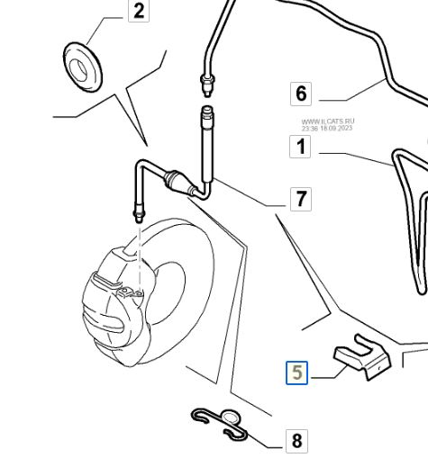

Brakes failed whilst going downhill, which was fun! Started pumping the brake and noticed a spray (break fluid) coming from the out of the wheel arch!!
The failure was where the front hard line joins the flexible hose (see flexible hose missing in image). Going to replace both sides but have noticed that the bracket holding the union to the chassis is seriously rusty and I can't find in any technical manual (ePER etc.) what this part is. Does anyone know the fiat part number or how I can source this? I have found the 994922 clip, which is part of it but not the actual chassis bracket.
VIN: ZFA16900001765863
Reg; YT60 MPX
Also the wheel speed/abs sensor bracket, just behind in the picture, is is as bad or worse condition. Again, what should I replace this with? The car is 14 years old now and I love the little thing, so I'm not complaining, but would like to get it back together.
Any advice appreciated.
