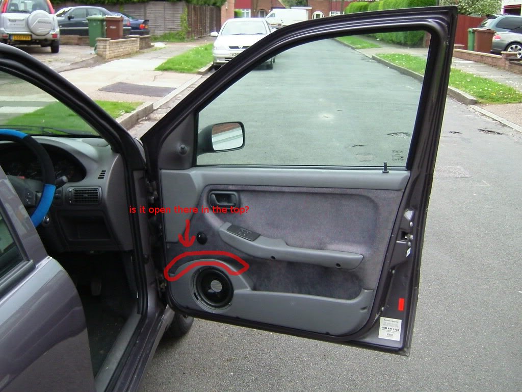

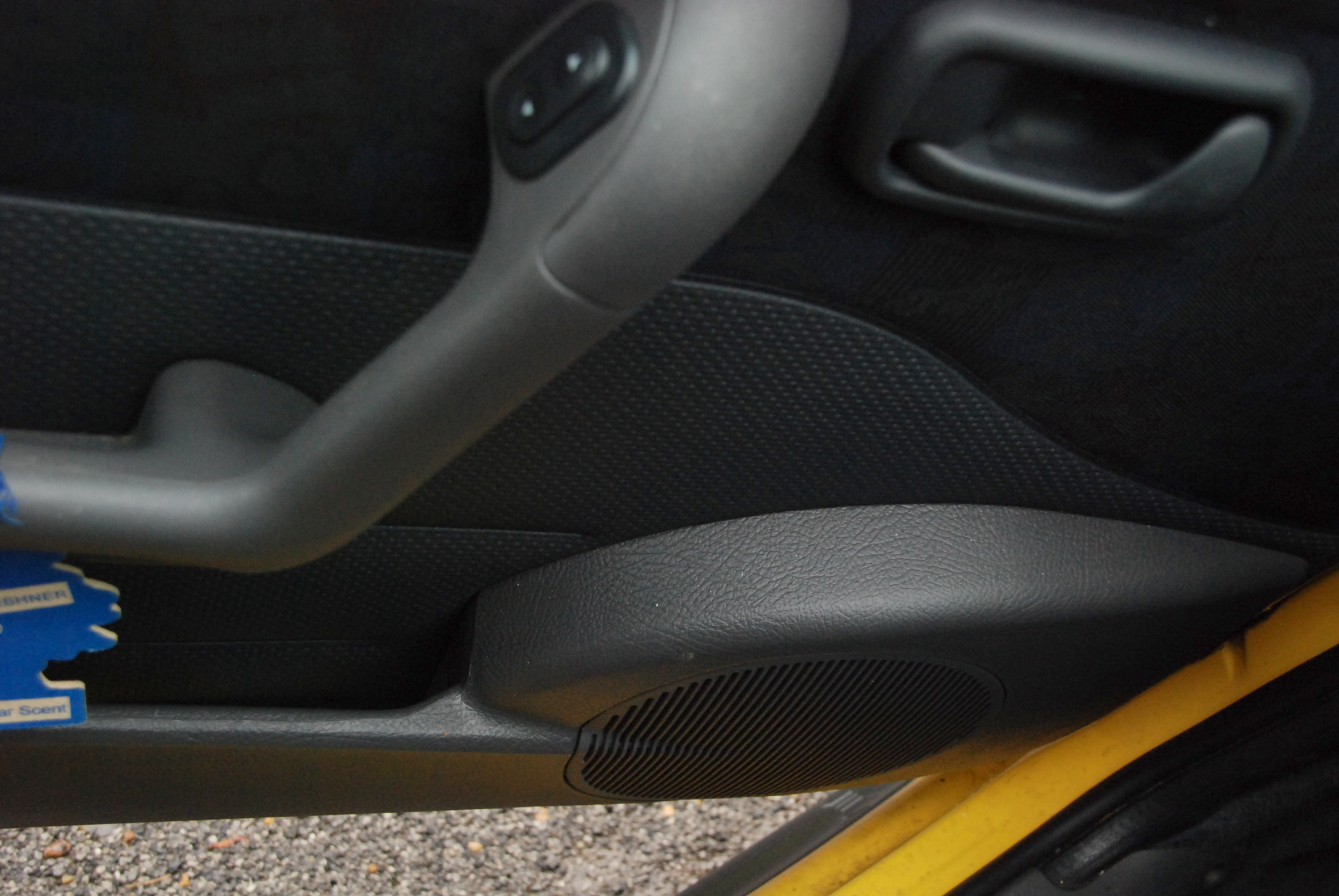

i dont really care about scrows as i can fit them somehow. the problem is with the shape of the back of this part, is it all flat or is it curved? for example:

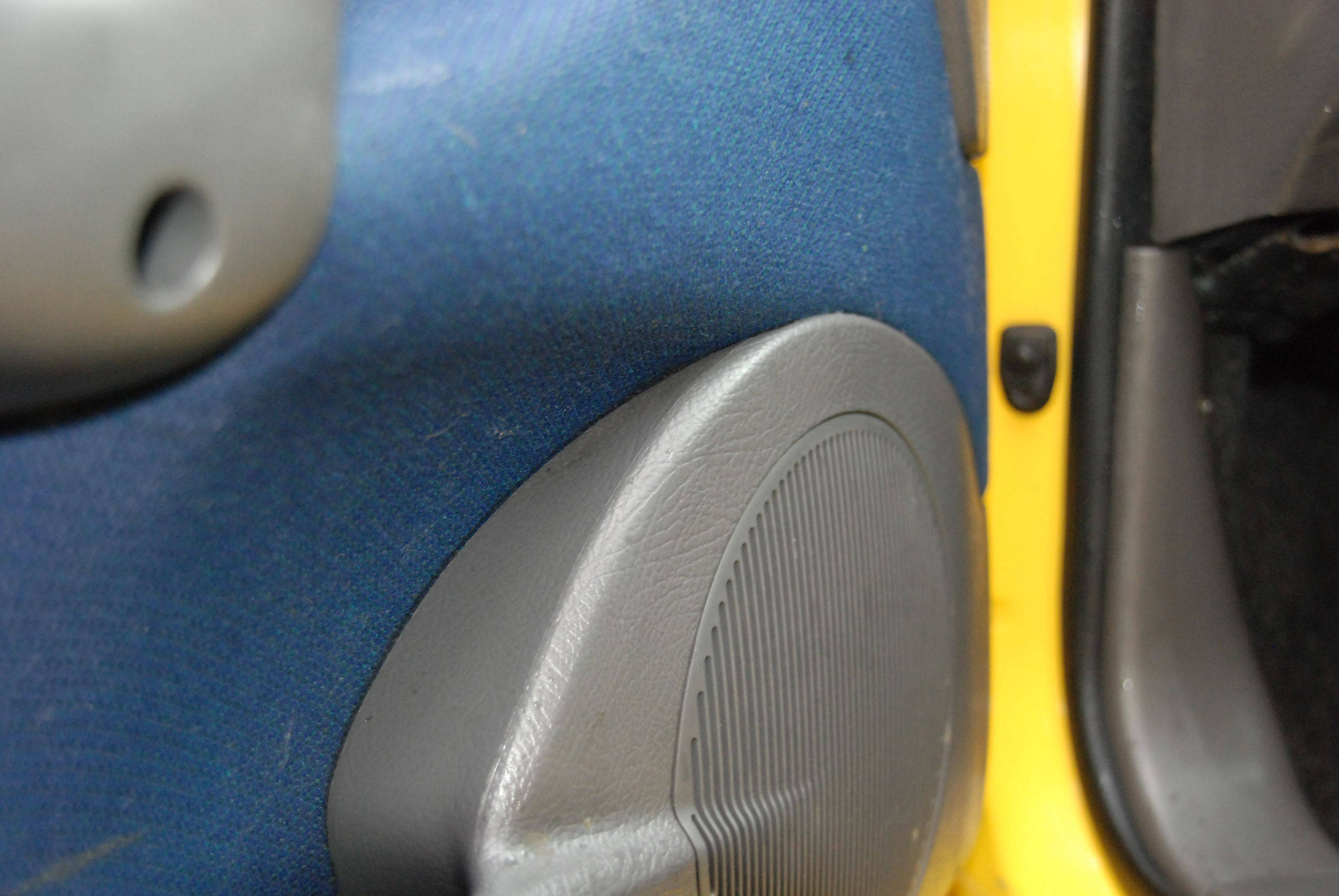

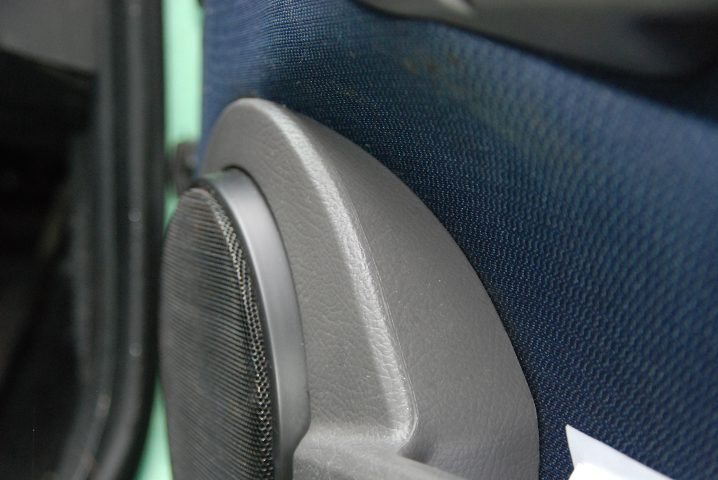

It's curved....pics from a 5 door ELX
Behind that curve it is empty and butts up to the card. So you would need the whole door card (n)
I take it you have an sx 5 door?....3 door (sporting) speaker pods are flatter, but if it is for a 5 door they would be no good either as they are much longer.
Cabrio ones are too long also, being 3 door and also curve.

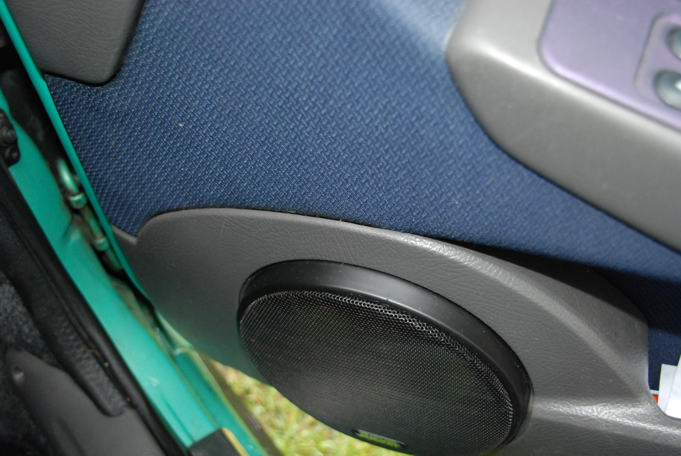

So I know these pics will be no use to you really, but for anyone else wondering about fitment...
pic taken from sporting 3 door
from cabrio
