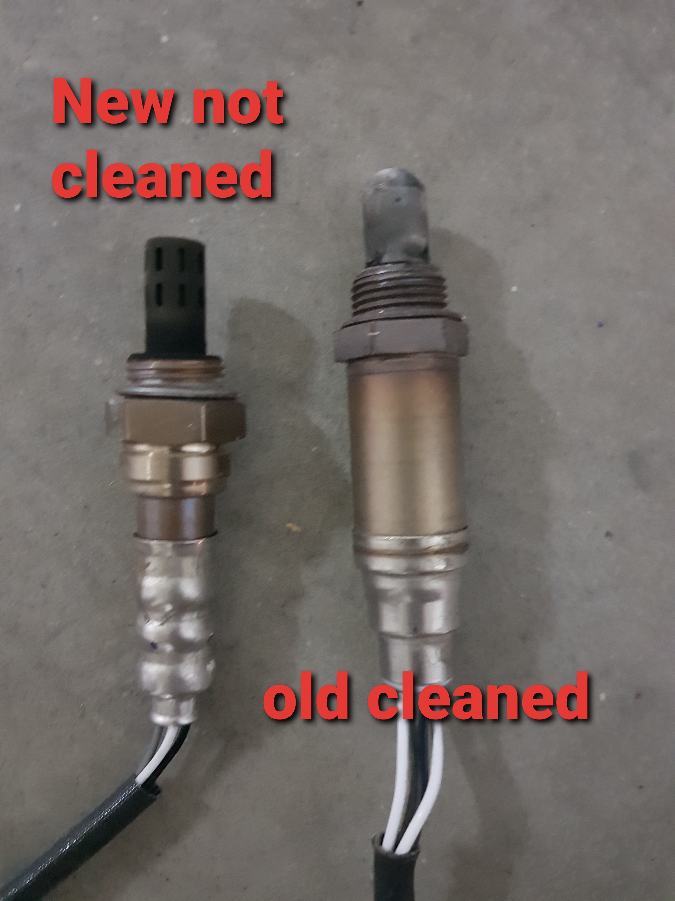

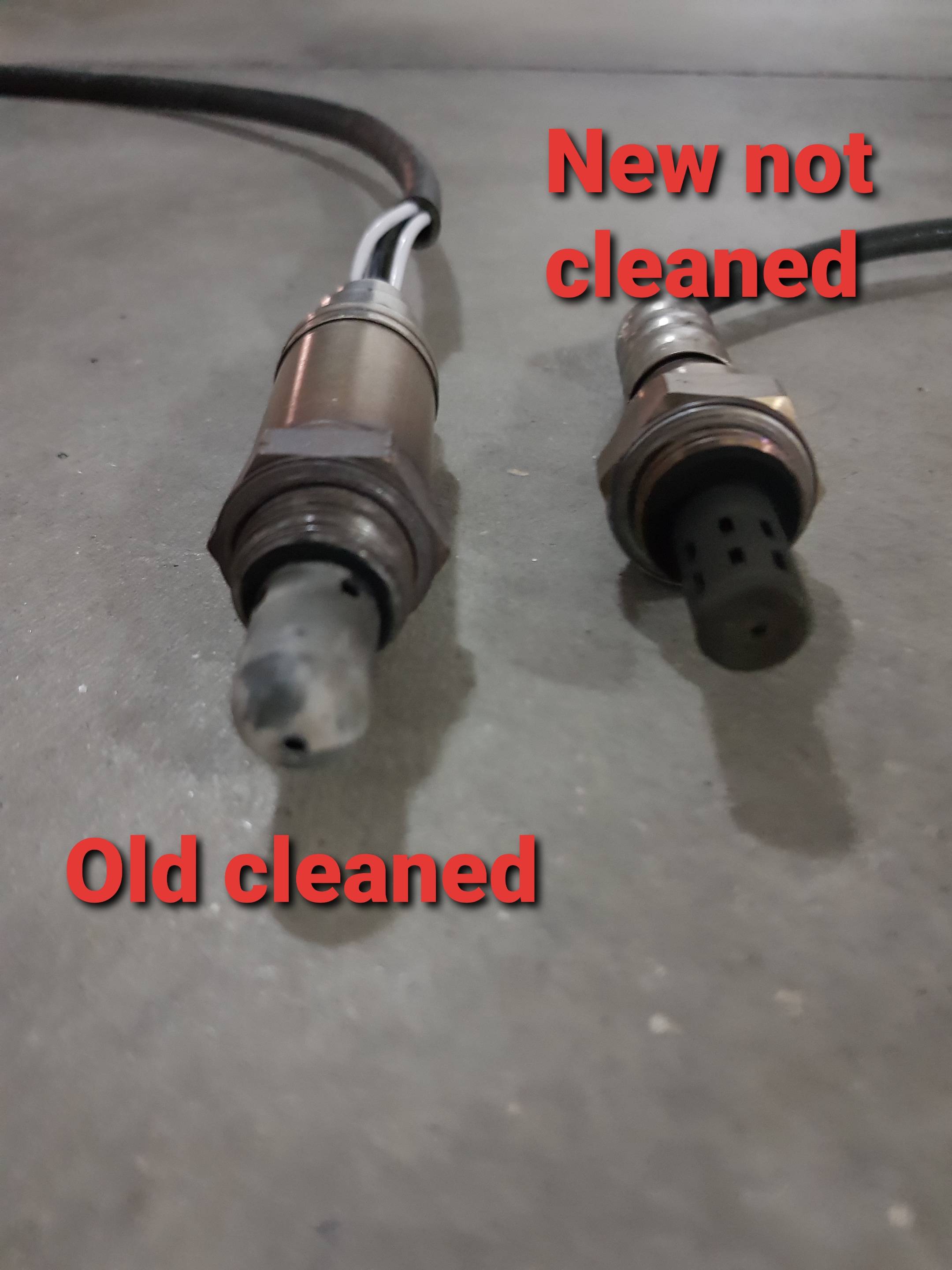

Old lambda installed after cleaning. Se the comparison, old cleaned is Bosch, new dirty is Maxgear
Now Lambda correction value reaches 1% when revving with air filter installed, which is good and much better than before, in theory. At least we know that lambda sensor is making a difference. However, gases from exhaust smell much more like petrol, this worries me a bit

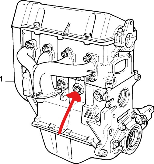

More tests done.

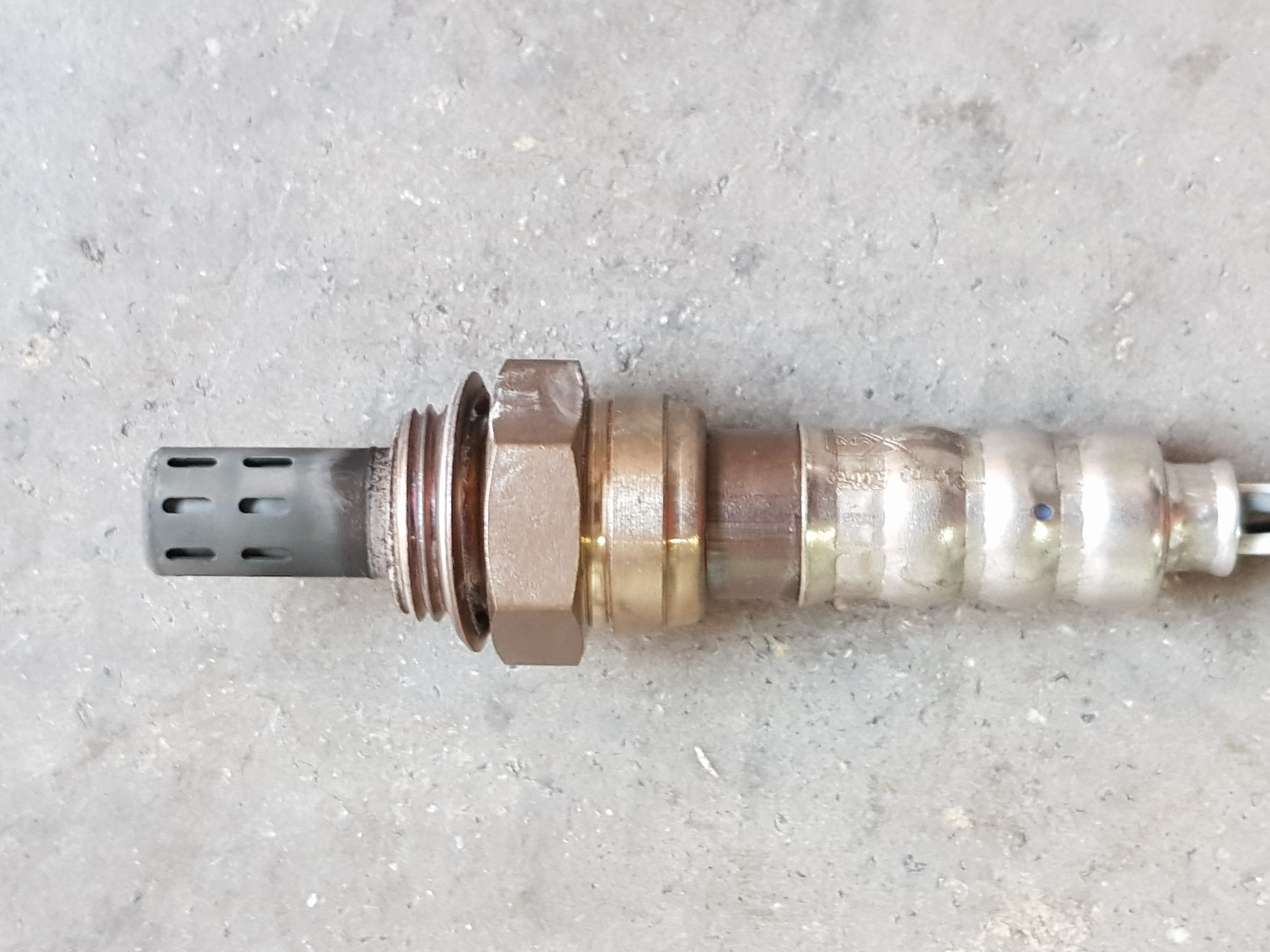

The newer lambda removed has these numbers, which are the model and I would say the date when manufactured. And now looks like this after cleaning it as well
I am so happy it is looking better for you ((-:
Thanks for picture of numbers on maxgear sensor they look nothing like a ntk/ngk sensor so it could confirm a cheap poorly made sensor.

Yeap, when comparing both visually and the weight the diference is big, that's the reason Bosch costs almost the double. Leason learned

Thanks for highlighting the postive side. In addition I have discovered IAWScan2 and learned a lot about MES and parameters. I have taken the decision to give him (yes, him) another chance. I'll buy that cheap cat I've located in internet, made by Bosal, and come back to the MOT.
If passes, the intention is to exchange the exhaust manifold and the coolant cap in the block at the same time.

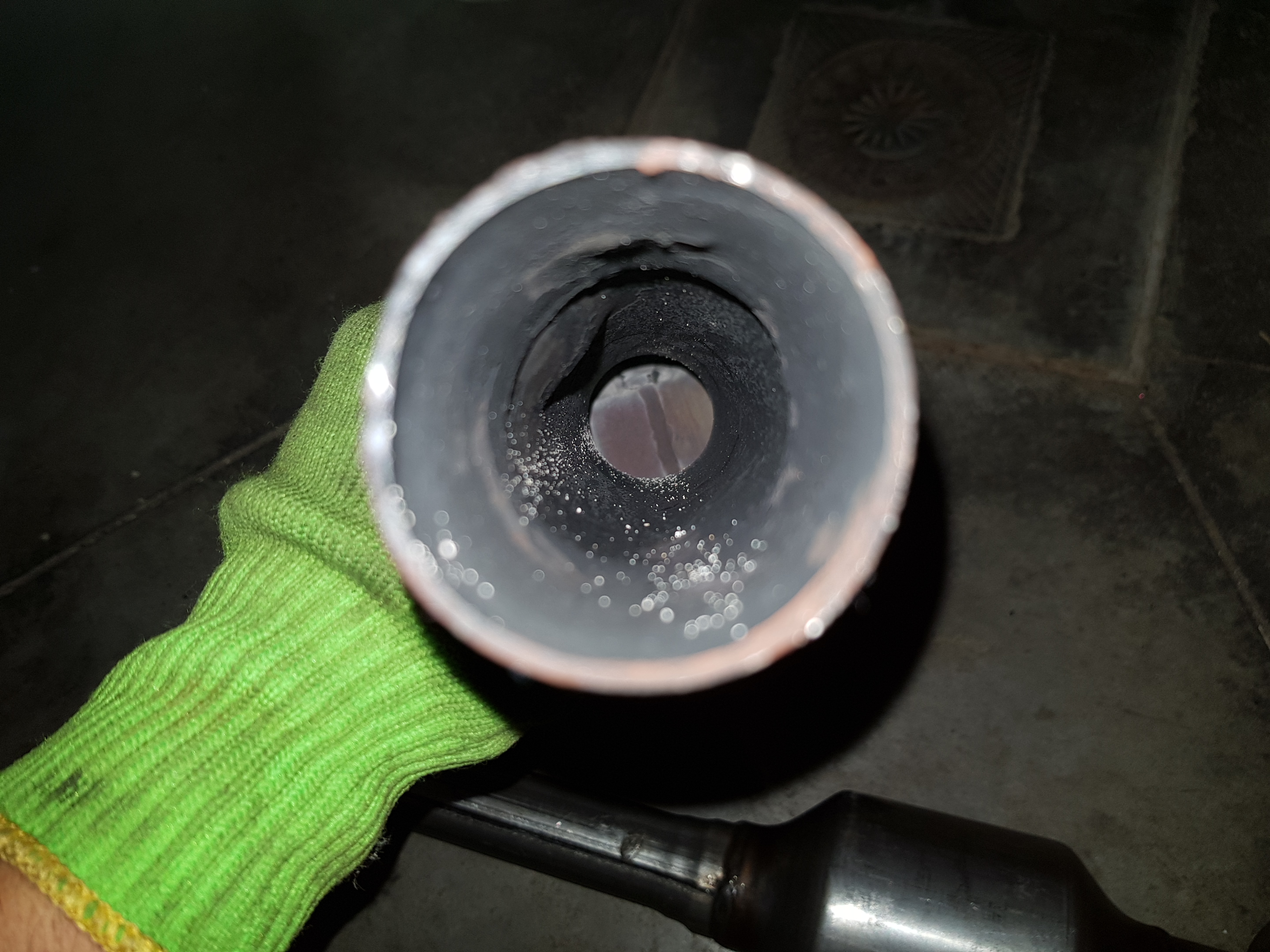

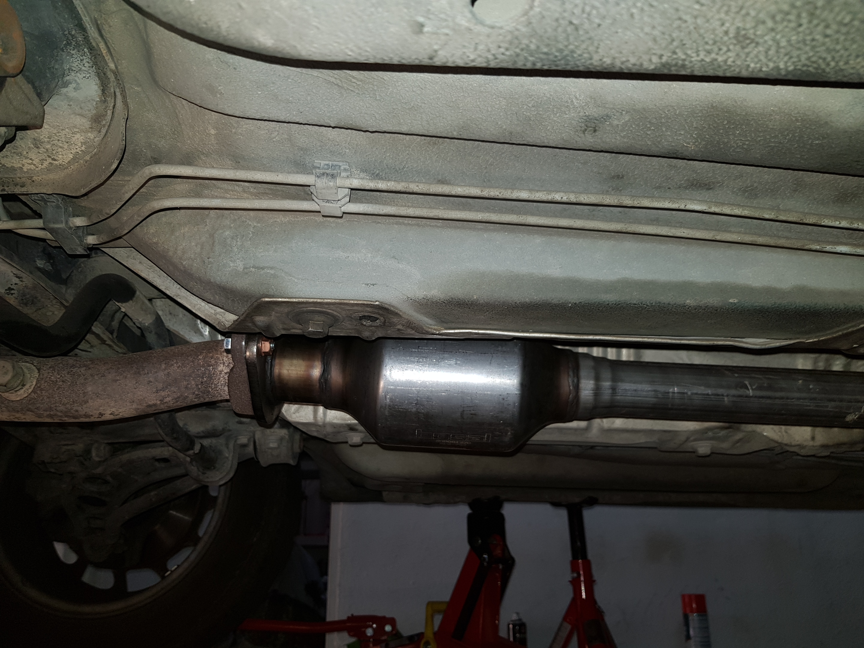

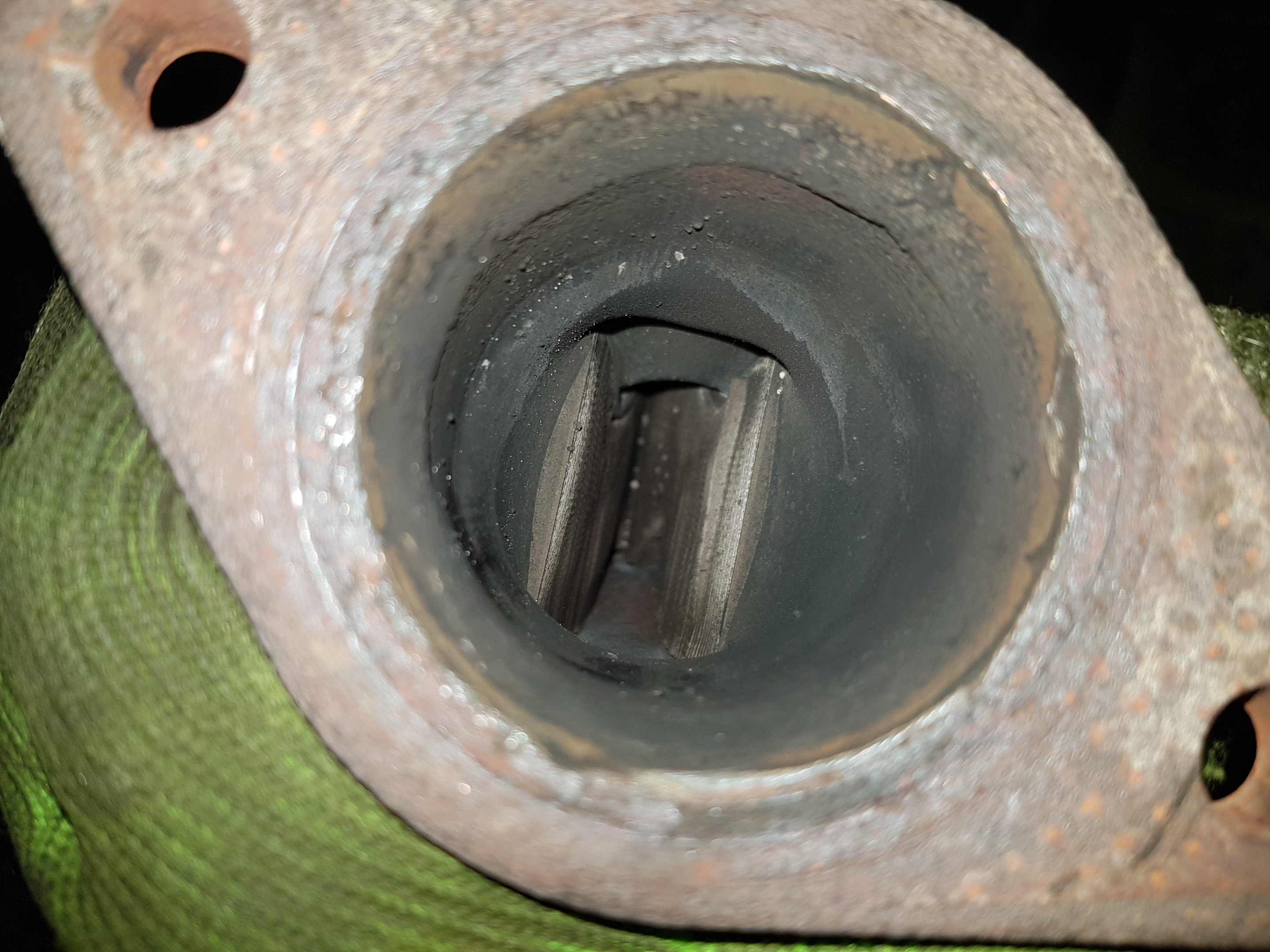

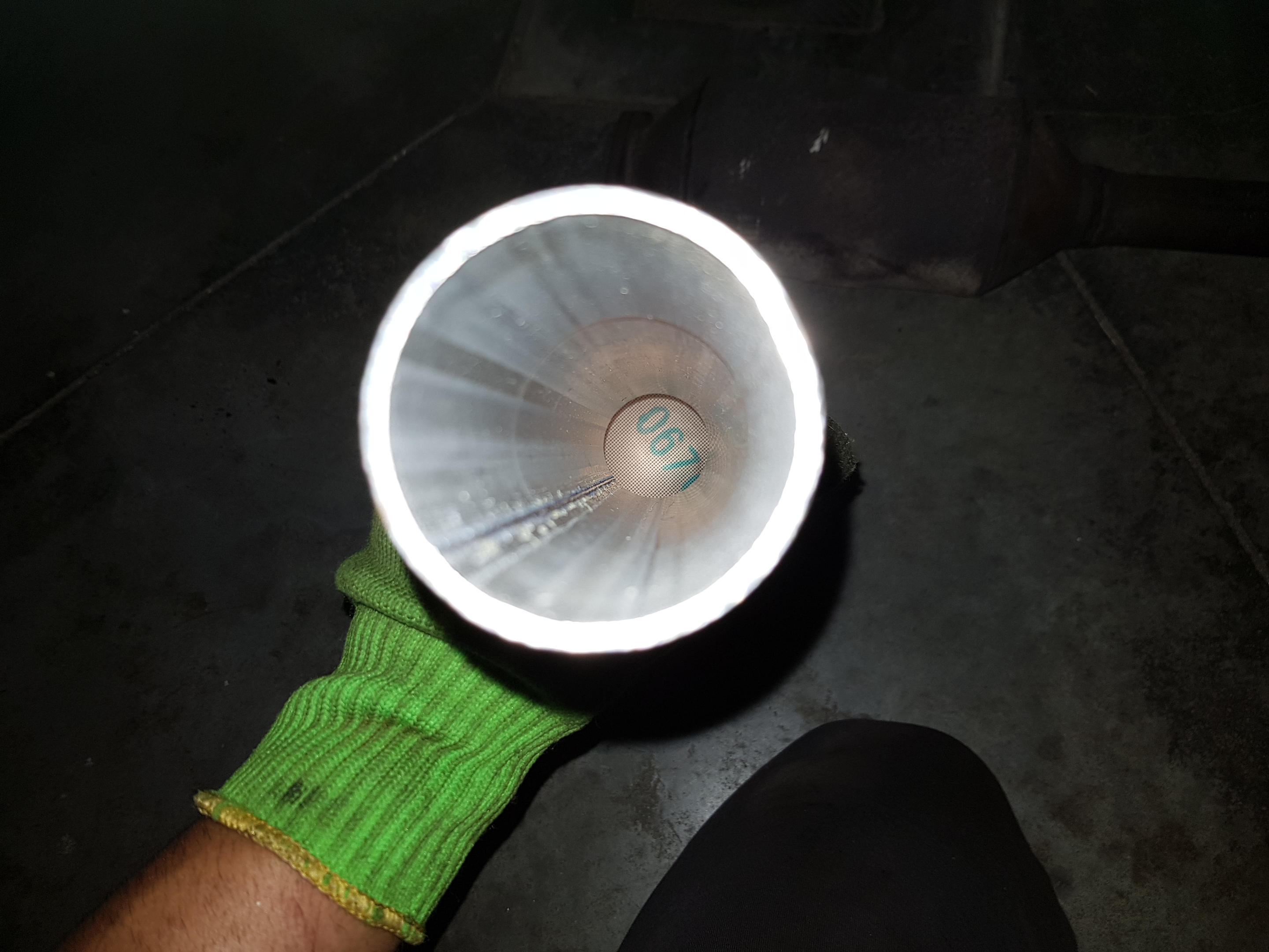

As expected, I received the new cat on Friday and installed it today, hopefully well done... Tomorrow I'll go to the MOT, let's see... but looks good because gases smell much better
Some pictures, they always help

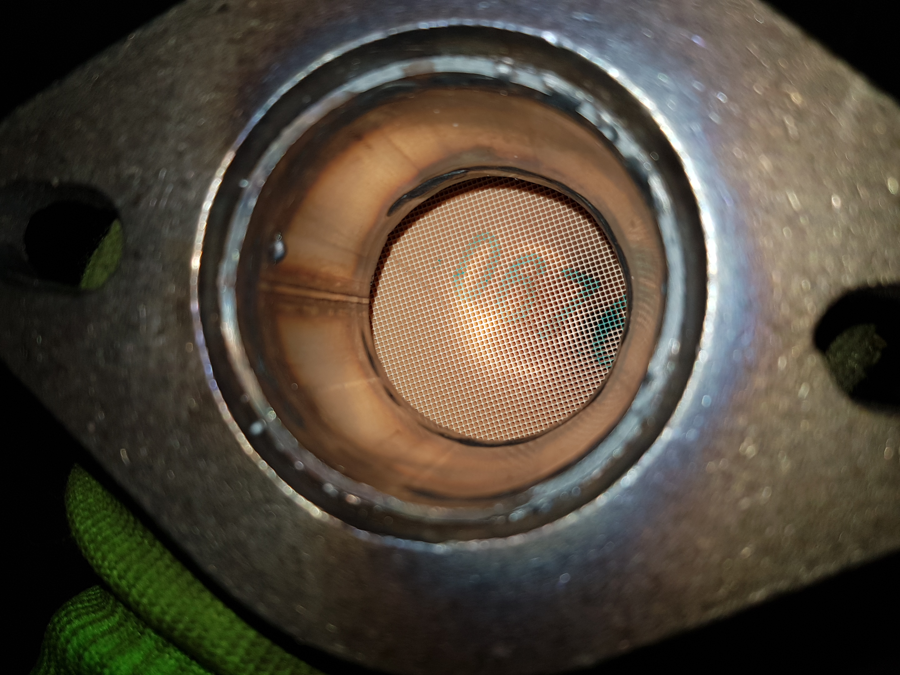

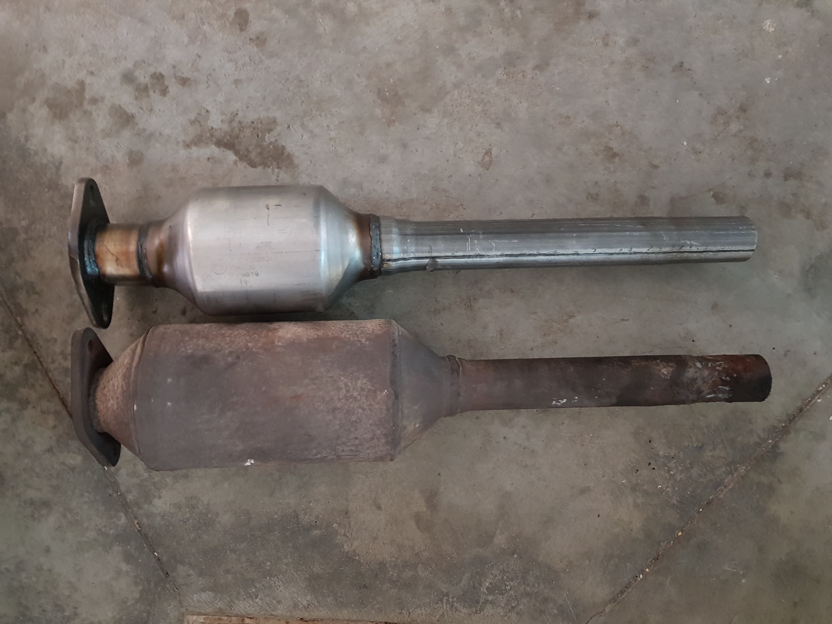

And comparison interior old vs new
Hello,
Thanks for update pictures.
New part looking good
Fingers crossed for you for tomorrow(-:
Old cat looks like it is breaking up .
Don't get rid of the old catalytic converter just yet.
Best wishes
Jack
