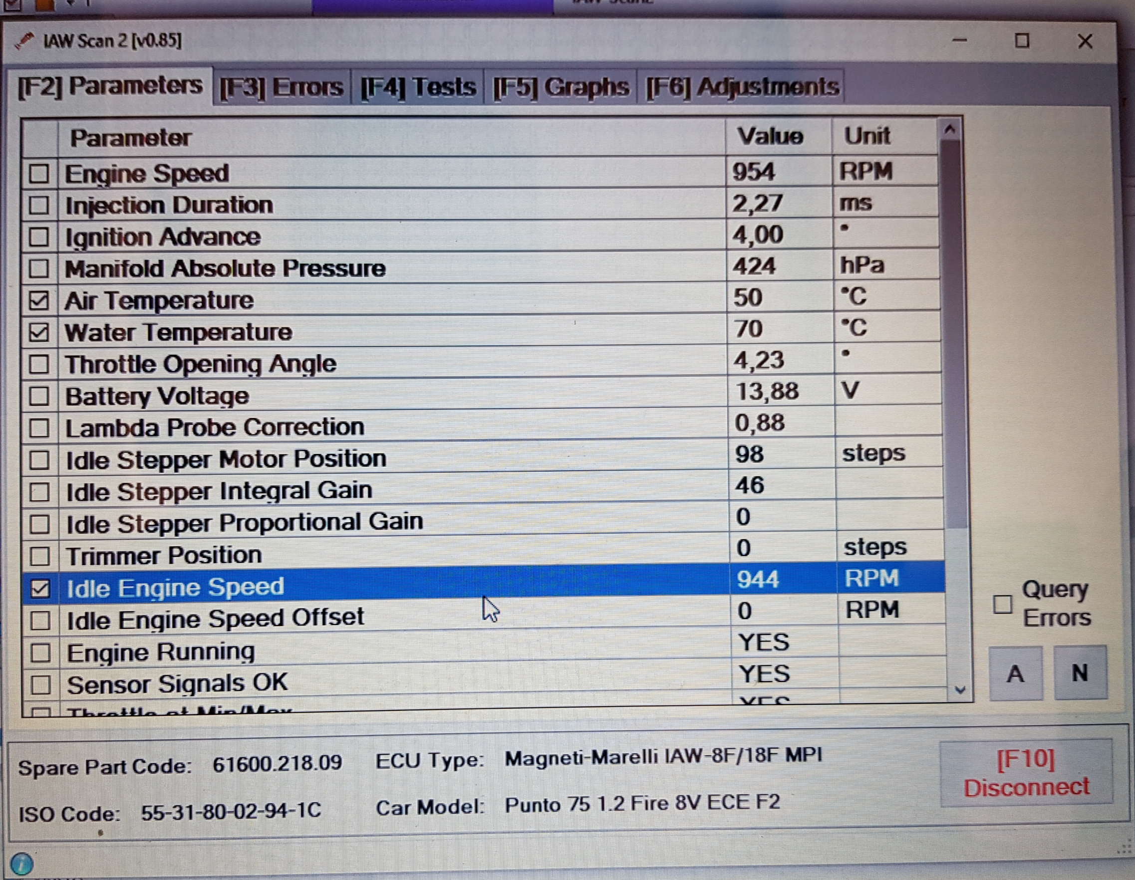

In addition, I've reset the idle motor with IAWScan2. That works much better, but still nor perfect. At cold start starts at 1100 rpm aprox, and dicreases slowly in the same rythm as coolant temperature increases. When warm idle is fiz at 944 rpm, so perfect. When fan starts changes to 960 aprox, and back to 944 when fan stops. This is perfect. The theory says it has to be 900 rpm +-50. However, from time to time when shifting gears it makes a small stop at 2100 rpm more less, to drop later to 950. Fair to say that now it always drops to idle, but, as I said before, randomly it doesn't drops linear.
Workshop manual indicates cut-off strategy is based on: engine speed, coolant temperature and air temperature. All three sensors are new.
By the way, I've notice as well when accelerating from 1000 rpm, at 2100 it makes a irregular revving, disappearing when passed that revs. It reminds me when I had a problem with coils. I've checked them with IAWScan2 and no error logged. Maybe just starting being faulty? Can the coils be the reason of high idle when shifting?
A picture of IAWScan2

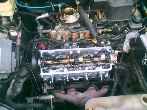

Today I have checked all again. Baterry is charging with an external charger, maybe not related but I cannot lose anything. I've noticed that air filter box was not adjusting completely, so I've applied some Teflon (picture attached, not my car) to the seal in the throttle body. I've tightened the lambda sensor just it case, it has moved no more than 10° (visual measure). Tomorrow I'll test it, battery is still charging. Let's see if there is any improvement. If not, this is my plan b https://products.liqui-moly.com/additives/injection-cleaner.html
