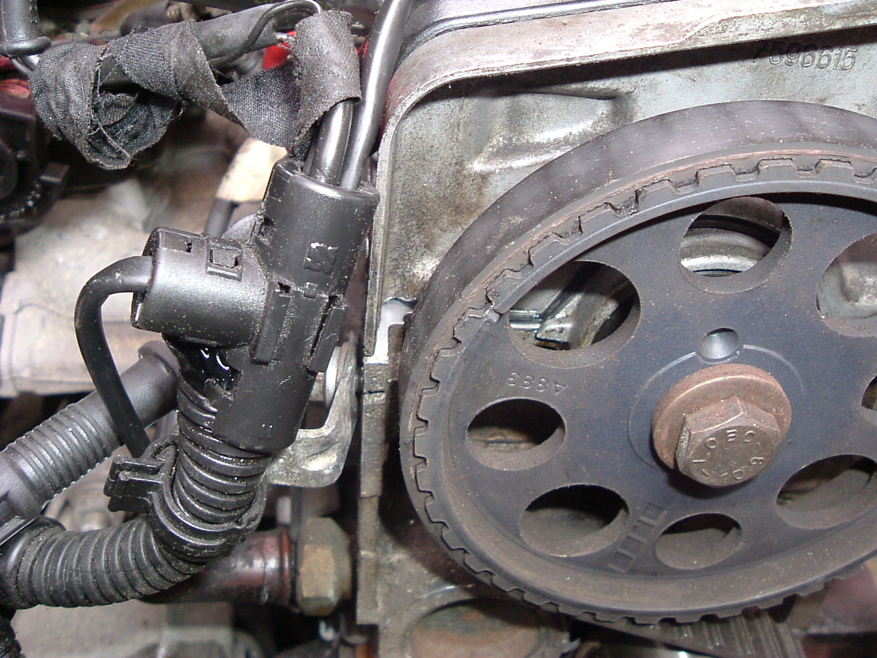

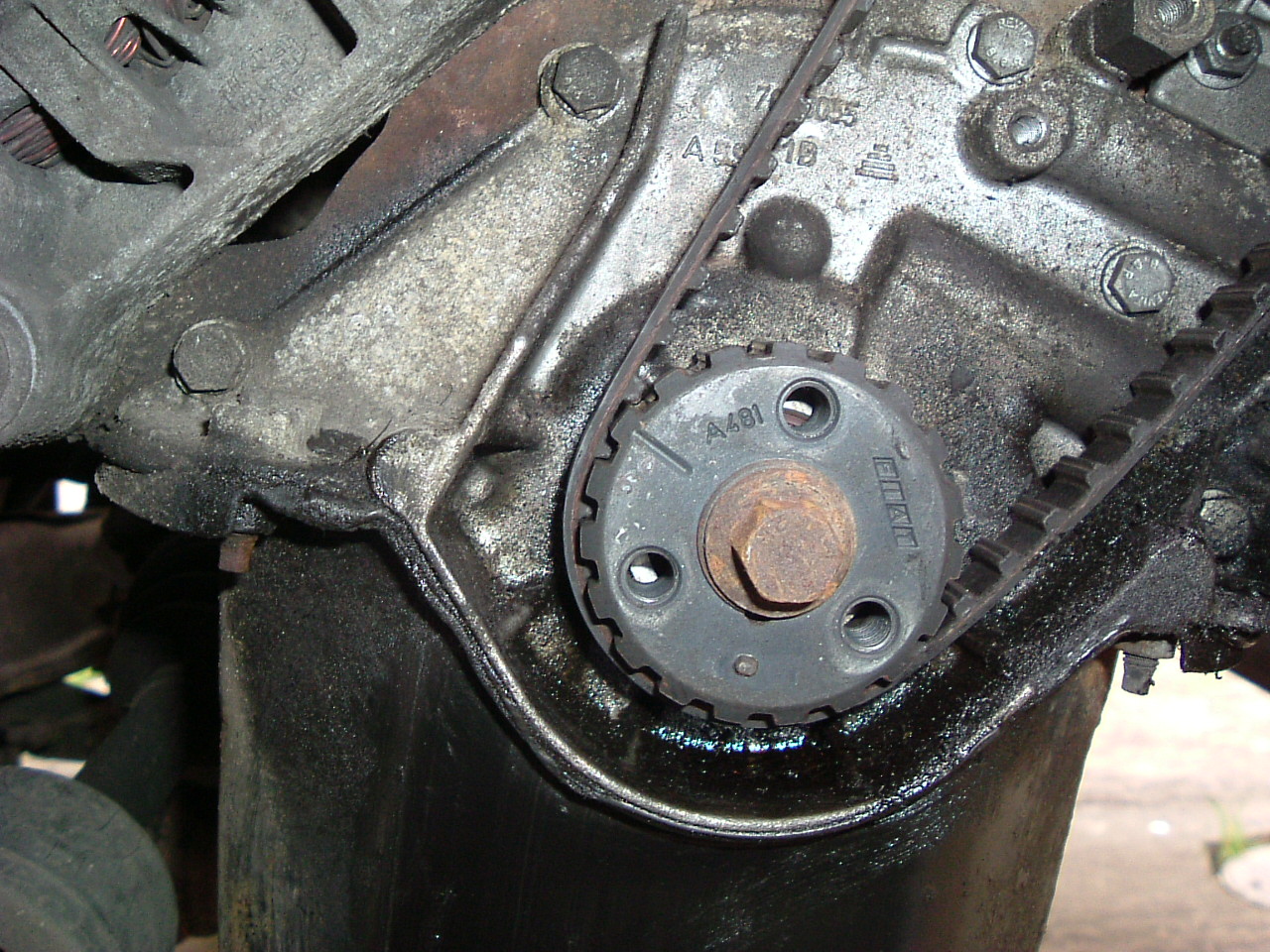

I got piston no.1 on to compression stroke, carried on turning crank until bottom mark lined up, went to top pulley and this is where the mark is!!
Does this look like its jumped?
If so, I just release the tensioner and turn back the cam till it lines up with the mark?
The belt was slackish, manual says should just only be able to turn through 90degrees for tension?
We've had the car about a year. Invoice indicates belt was done about 25,000 miles previous, I'm guessing tensioner not changed.
So if cam pulley is rotated backwards - anticlockwise, with belt off, things should be timed back up?
Is it ok to work off the Haynes "90 degree" turn tensioning theory?
Yes but you shouldn't have to force it to make it turn 90deg, with finger and thumb it should be as difficult to turn as say unscrewing a bottle top...
If it's too tight you will get a 'whizzing' noise as you rev it (most noticeable in the car when changing gear), and maybe a rubbing sound at idle. I've also found the belt will sit nearer the cylinder head on the camshaft pulley. After a few turns the belt should sit near the centre of the pulley if it is tensioned correctly.
So the flywheel marks are through a hole in the bellhousing and I need a torch and a mirror to see them??
