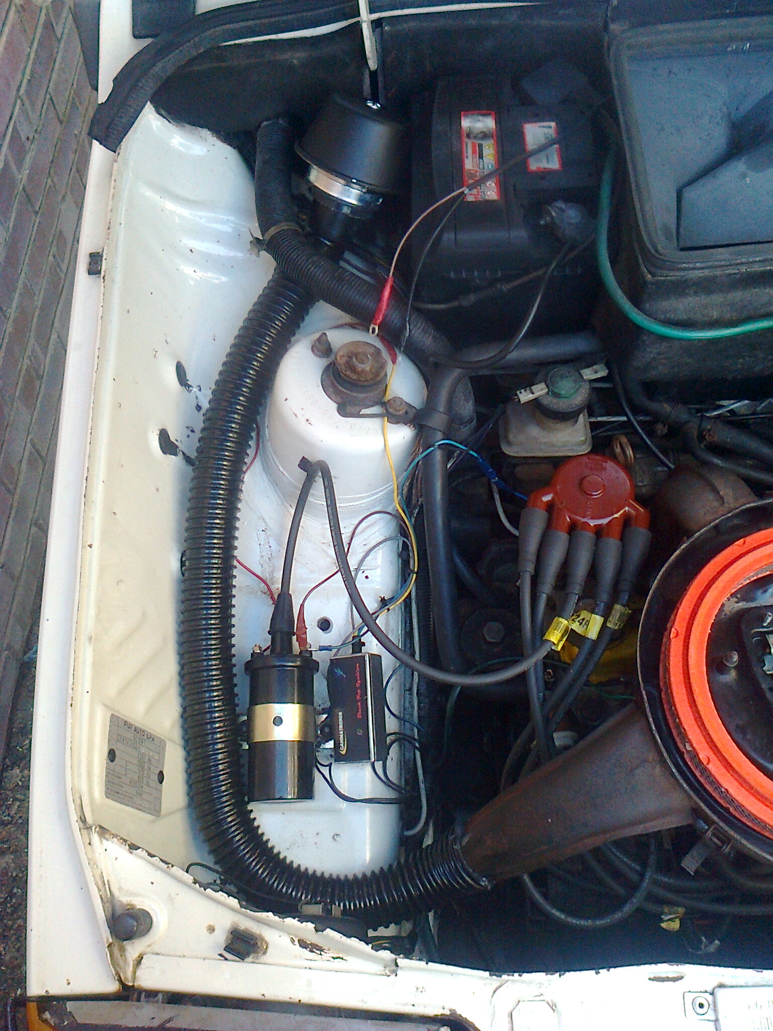

So this is the snorkel although it doesn't go to the roof I think this will be enough...
It has another filter at the top which I might remove if the engine has trouble breathing. But it might help stop dust getting into the main filter in the airbox.

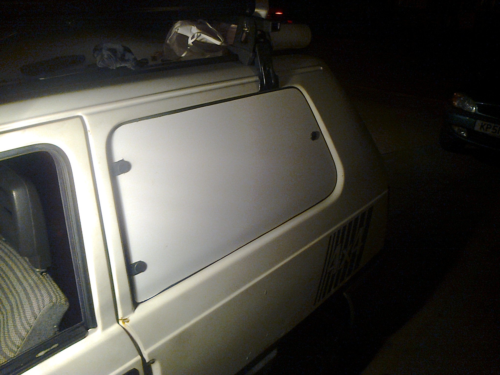

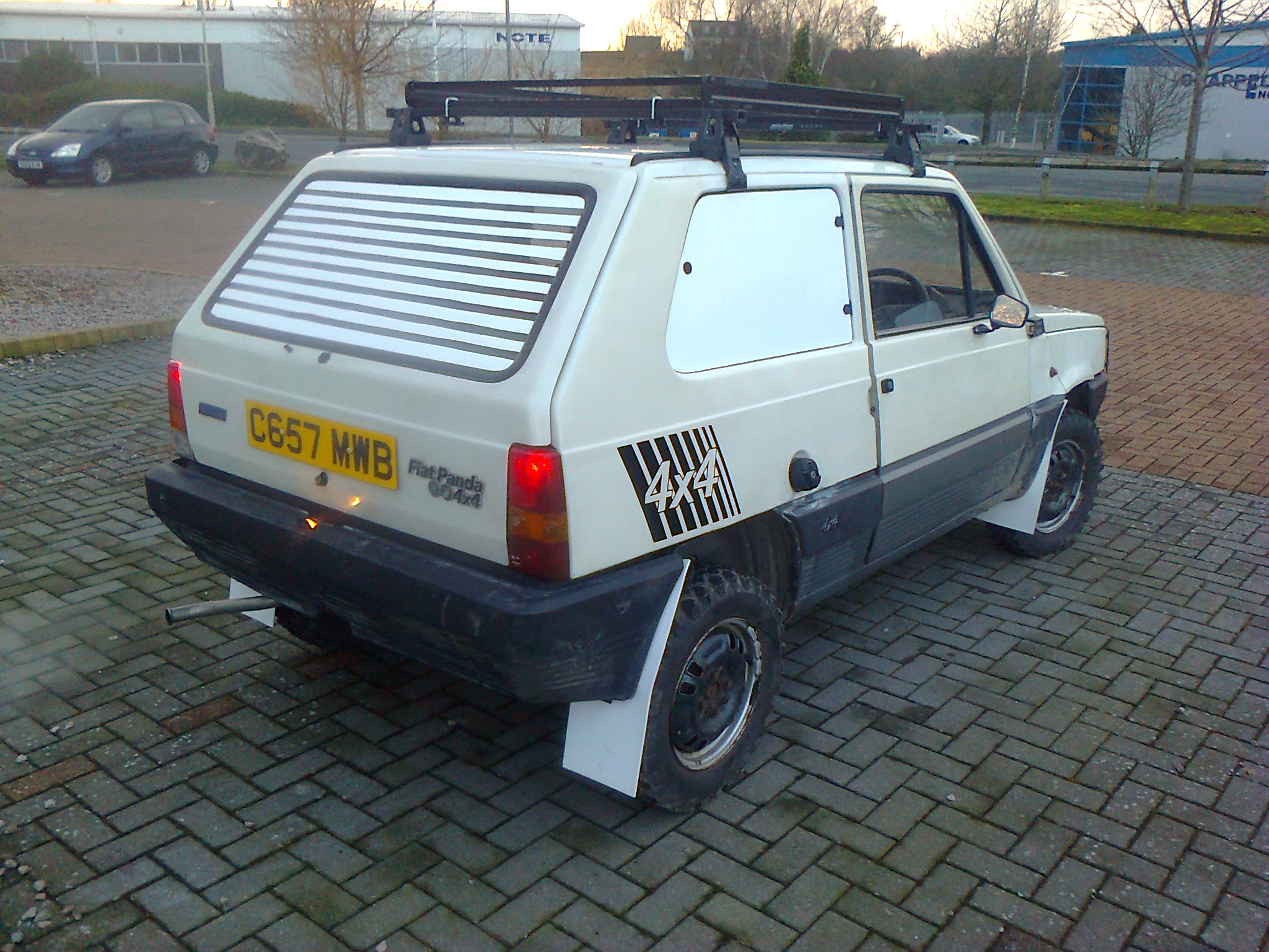

Last thing was to fit the window stickers for the Paris Dakar look that seems popular on this raid lol...
The back window needs to have some holes cut into it but I haven't worked out the design yet. I am thinking nice simple "slats" (lancia stratos look? haha) or a Panda face haha. Either way some sort of way of seeing out the back is important! So hard to reverse off the drive like this.... :eek:
tbh, i would just take the stock filter out of the housing if you are gonna run one at end of the snorkel. Take a spare filter for the snorkel and an airbox filter incase something goes horribly wrong with snorkel pipe.
Good point :eek: Can switch between the 2 (snorkel filter for sandy bit (i.e. morocco) and normal filter aall the way there and back :D
But either way definitely don't need both!
I like how the engine intake noise is nice and loud in the car now though. Sounds quite raw! :devil: The snorkel pipe seems to act like a megaphone up to the driver haha

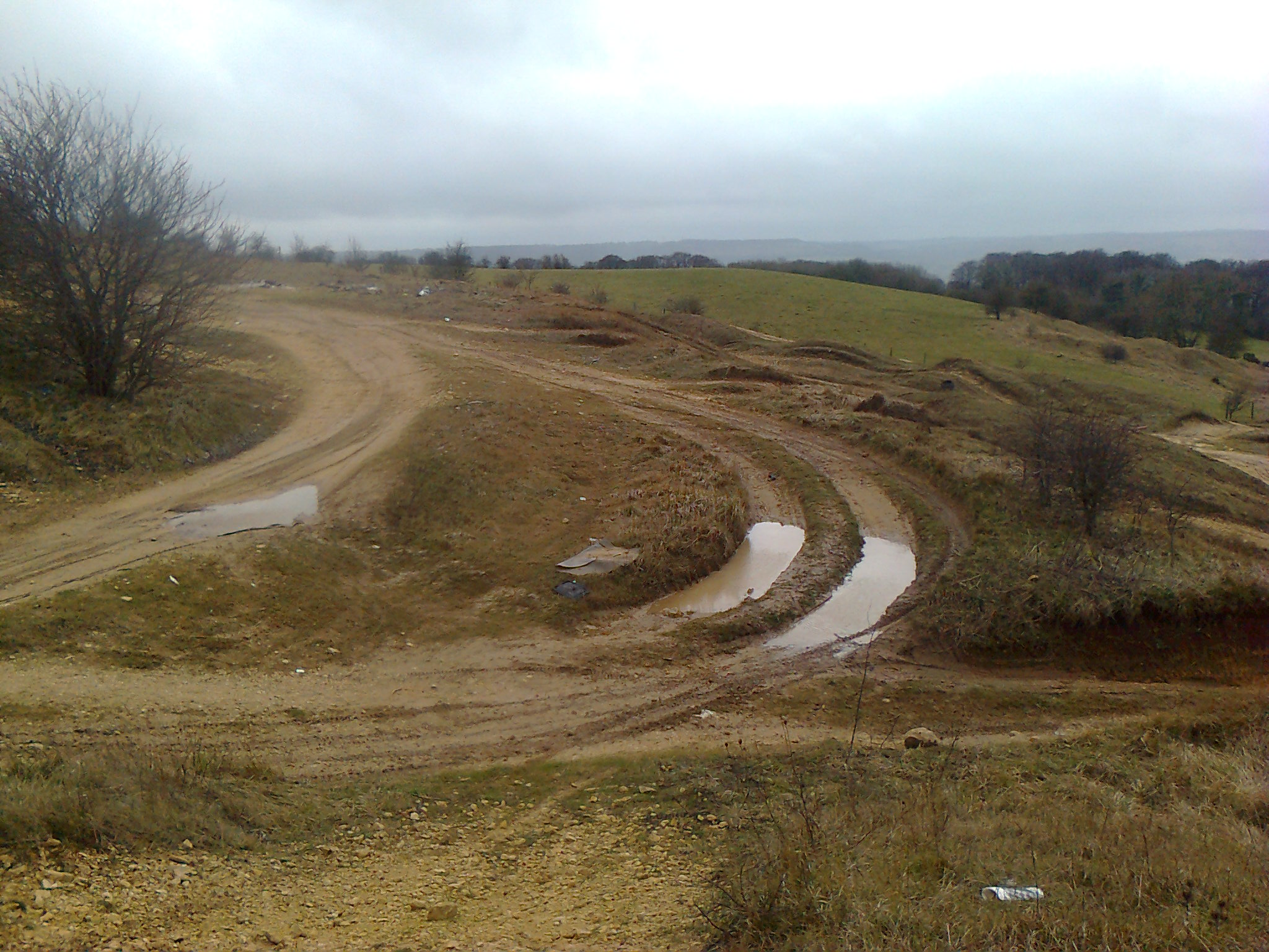

At the moment no plans to sticker up the car more than it is but if there is time maybe do some small detailing. Today we are going to go find some rough ground to test it on with all the weight inside :)
We have had success today with a test run off road near Cheltenham. My friend found this place and I can guarantee I will be coming back here!...Need to repay Andy for his efforts up north and this looks like a fairly challenging way of doing so :p
These bits are reasonably easy but there are some insanely steep bits thats for sure!!...
Here we go...
We bottomed out here :eek: but the sump guard didn't fall off so that counts for success I think :devil:
