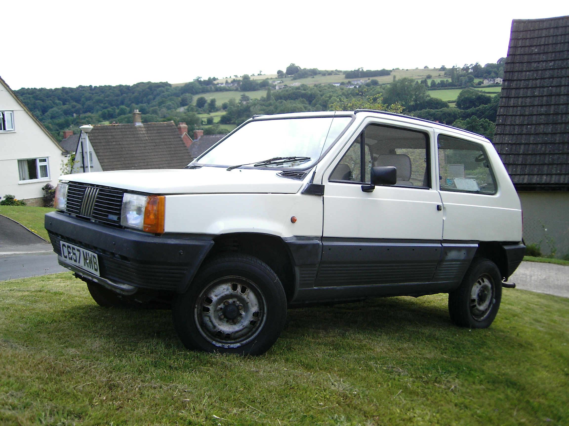

Here is Qing Qing, a rescued panda that came close to death
I completed the majority in less than a year and here she is now:

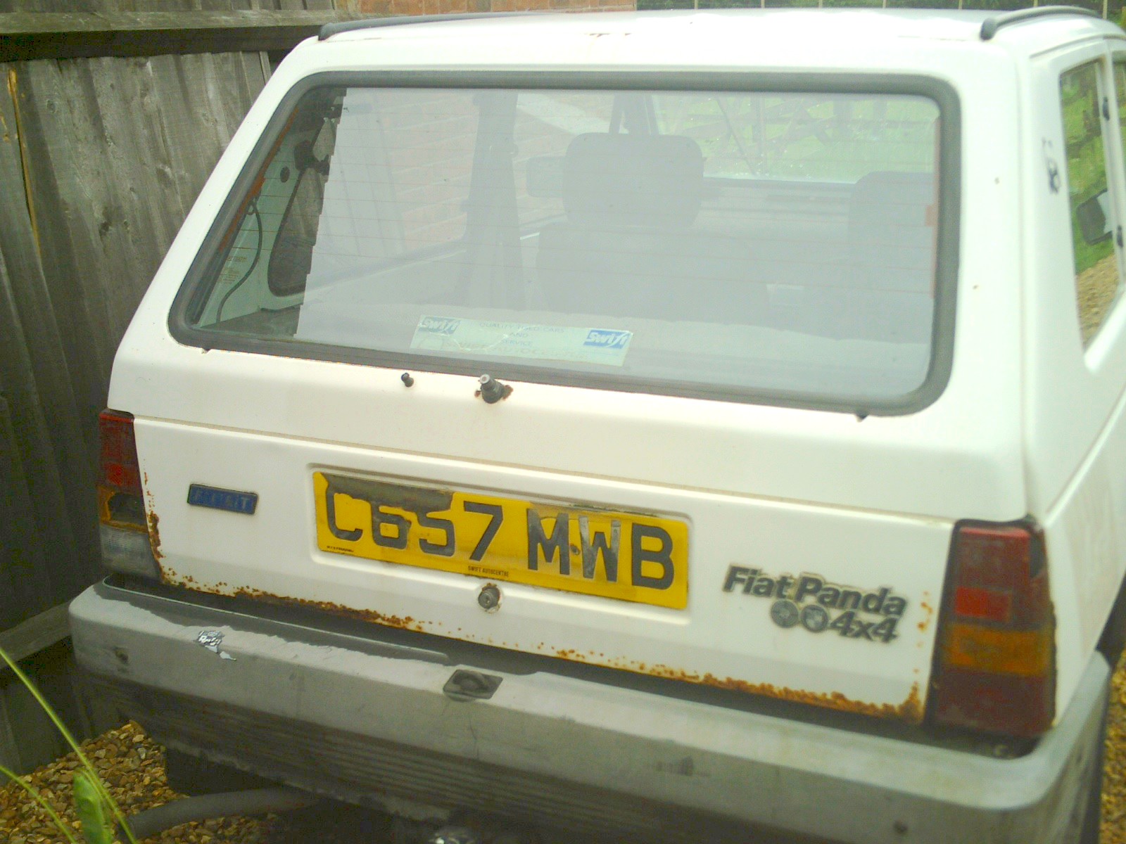

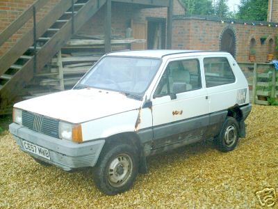

Before she was a bit worse!

This one needed some welding really, fibreglass has the benefit of sealing the damaged metal but it cant take any loads or flexing. For example the rust around the boot rubbers needed some welding as when you slammed the tailgate, it was just pushing the catch in. It had gone from one end to the other. :eek: Now its as solid as a rock :D Even put fibreglass over the welds to seal them better, with a load of waxoil behind too. Good for many years to come I am sure.
The rear quarter panels had some fibreglass repairs too, I was quite happy with the finish. Using a orbital sander really got the panel nice and flat and is like a mirror in places :D.
Only bodywork was repaired with fibreglass though, some rust around the front suspension I got the local garage in swansea to do. They did a very good job too, and only cost £80. I hope I can find somewhere like that here in gloucestershire :eek:
Thanks for the praise, its going to be a difficult choice whether to sell or not. I'll enjoy it for the moment though anyway, its all lovely and crisp with so many new parts :D

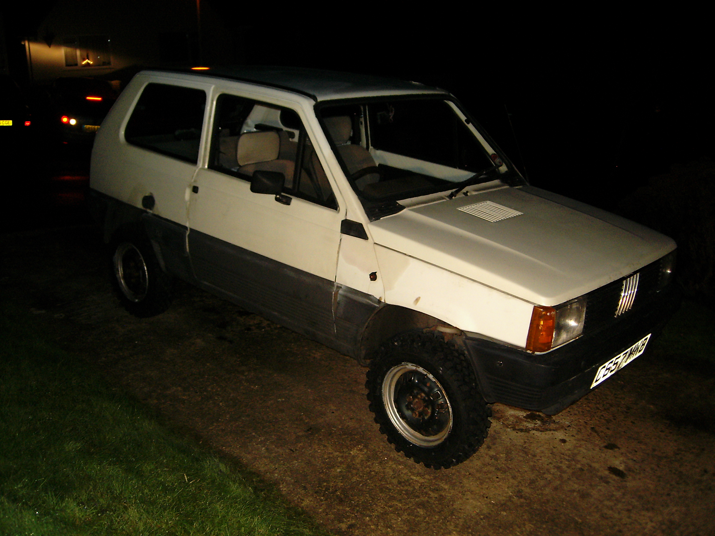

Bring on the snow!! :devil: Just fitted a new clutch and mended the gear linkages...damn crappy ball joints were shot!! The fix might actually be better than fiats attempt anyway!!:eek:
Oh yeah and.... no chance I'm getting stuck with these bad ass tyres :slayer:
