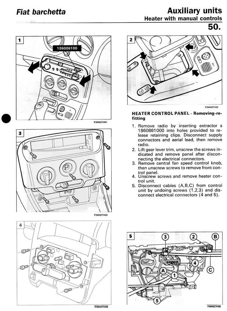

Small problem with my B: I*m partly missing the light in the vent knobs in the center console and want to change the bulb(s).
How do you do? Can anyone help:
I did it earlier in my Panda which was a piece of cake: just pull off the knob and change the bulb.
In my B I can pull off the knob but can't see the bulb.
Kind regards mberg
Hi,
I've never done it but I suspect you need to remove the panel.
It's detailed in the service manual on auxiliary units on page 26 of the PDF below.
I've pasted the relevant section below, I hope it helps
