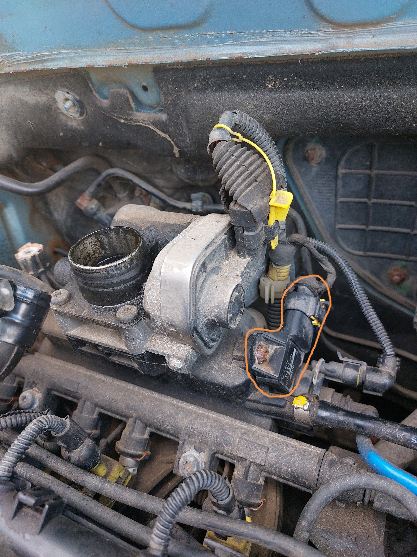

has a MAP screwed into the inlet manifold flyby wire it's on the left side and cable operated throttle bodies on the right side. As standing in front of the car

Standing in front, right side of carb inlet.Definitely fly by. Backfire sorry.
Blue pipe in your photo is connected to evap solenoid , electrical connection for solenoid directly above blue pipe.
Evap solenoid push fit into manifold with some kind of clip
Test by disconnecting blue pipe and disconnecting electrical plug. Start engine if evap valve sucking air it's stuck open/ failed.
Is pipe not fuel delivery then? So what your saying is , if no fuel delivery there is no sucking ?
The BLUE pipe is not fuel .
The Blue pipe connects to the evap control canister at back of car.
The evap solenoid is part of the evaporative emmisions control system.
The evap solenoid should be closed/not passing air into manifold when it is not energised , hence suggestions to test
Sound , I'll let you know , tomorrow , thanks!
Electrical plug for evap solenoid valve is closet plug to the blue pipe
