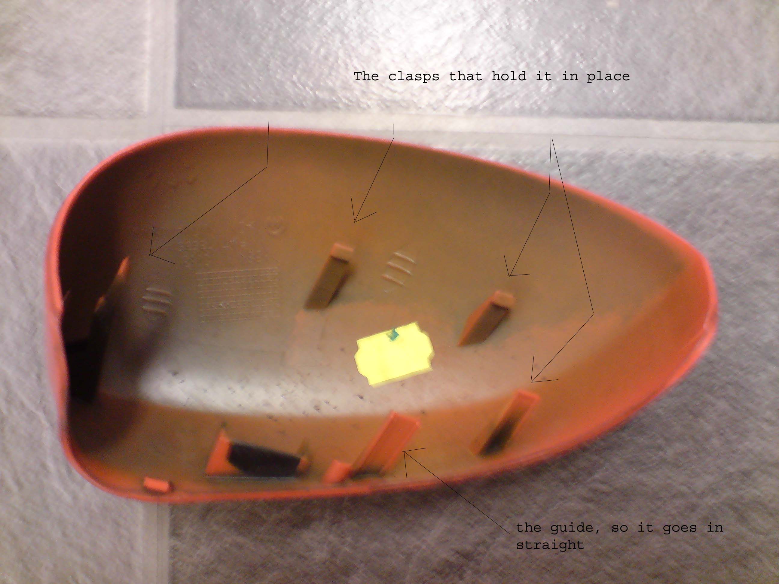

Removing the mirror caps.
Grab the cap (nearest the car) the larger part and pull towards you...
Simple as that.
There are four parts inside the mirror cap that hold it to the main mirror.

Hey mate, you dont need to remove the actual mirror the cap is held on by 4 'lugs' so no need to remove the mirror for any screws. Im alright for the caps just had new ones put on thanks.
PS the caps can be abit tight, so take your time when removing them.
