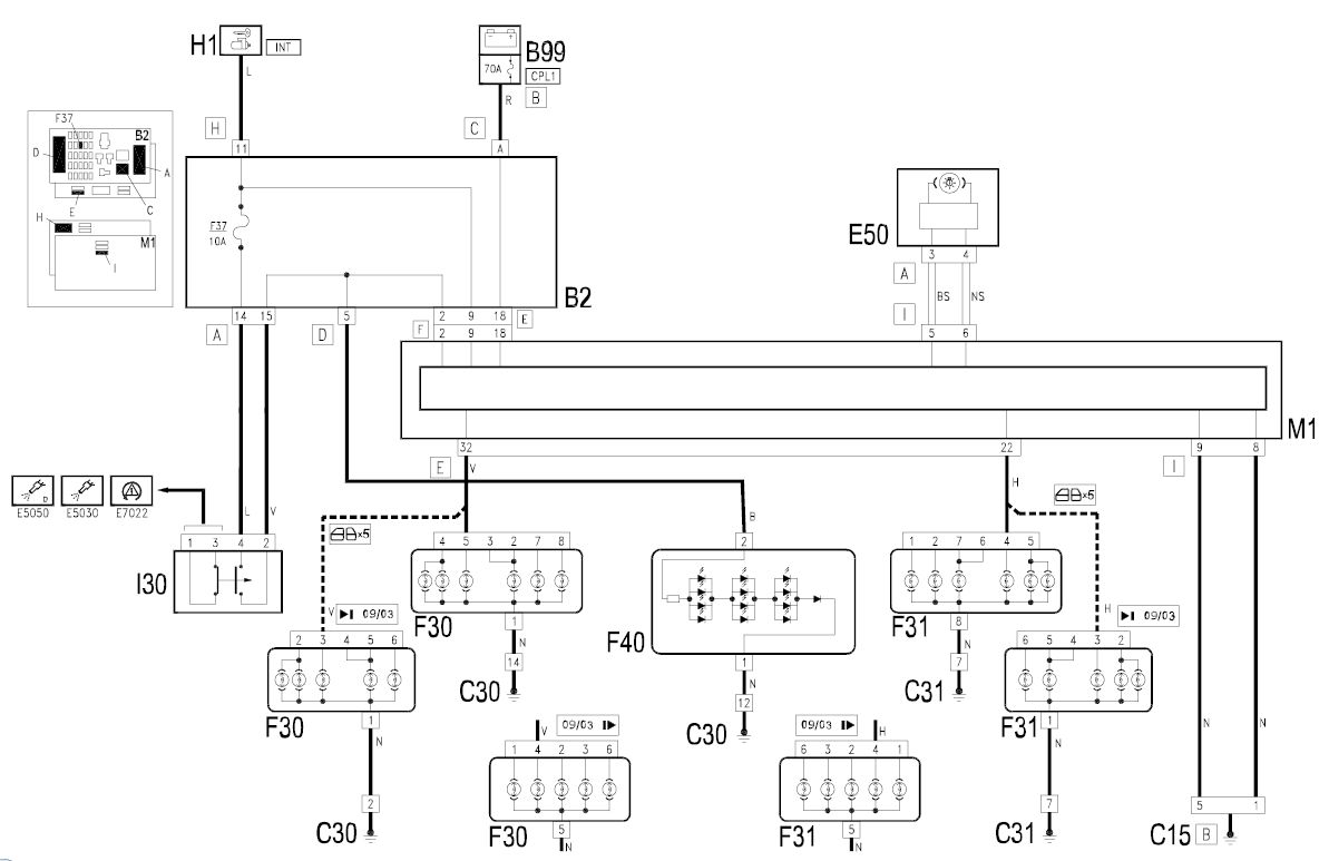

Anyone considered the brake switch itself? as IIRC, the two halogen lamps and the CHMSL (third brake lamp) are controlled separately???
All on the same circuit I though. :confused:
Can't remember whether it's the normal or high level lights that come on first, but if you stand behind the car and get someone to press the brake pedal, you'll see that there's a delay between the two.
One is switched on immediately directly from the brake light switch which also sends a signal to the Body Computer to switch the other on a fraction of a second later.
High mounted one illuminates fractionally earlier in comprison to the main two, but thats because its LED and has a far faster responce time.
I've LED trailer lights, and they're wired into tail lamp feed, and they illuminate at same speed / time as high mout lamp, so I'd assume high mount is on the same feed as the other two stop lamps :confused:
Just checked with the wiring diagram. The brake switch (I30) switches 12v +ve from fuse F37 directly to the high level brake light (F40) and a signal to the Body Computer (M10) which, in turn, switches the normal brake lights (F30 & F31) on.
A second set of contacts in the brake light switch sends a signal to the engine management ECU for engine management, ABS and cruise control functions.
