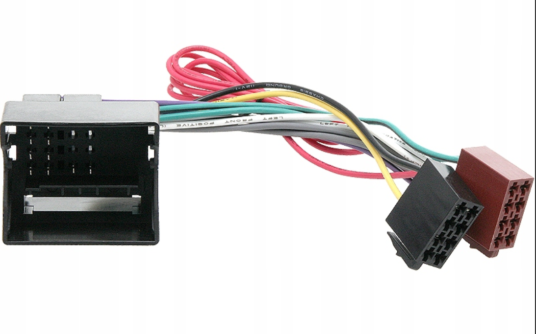

You have two possibilities: play with the cables or buy a suitable FIAT - ISO adapter on ebay or equivalent. Or a local shop. While buying, check that it will fit your 20 years old Stilo. Things could have changed in the last 20 years, newer FIATs can have other looms / connectors. I was buying one for my 2011/2012 Ducato a couple of years ago, it looked like this one:
the fuse is fine, I've tried it on other cars, everything works, but when I try it on my car, it won't work. If I try it on my Fiat, it won't work. I have that cable, but it still won't, I don't know why.
