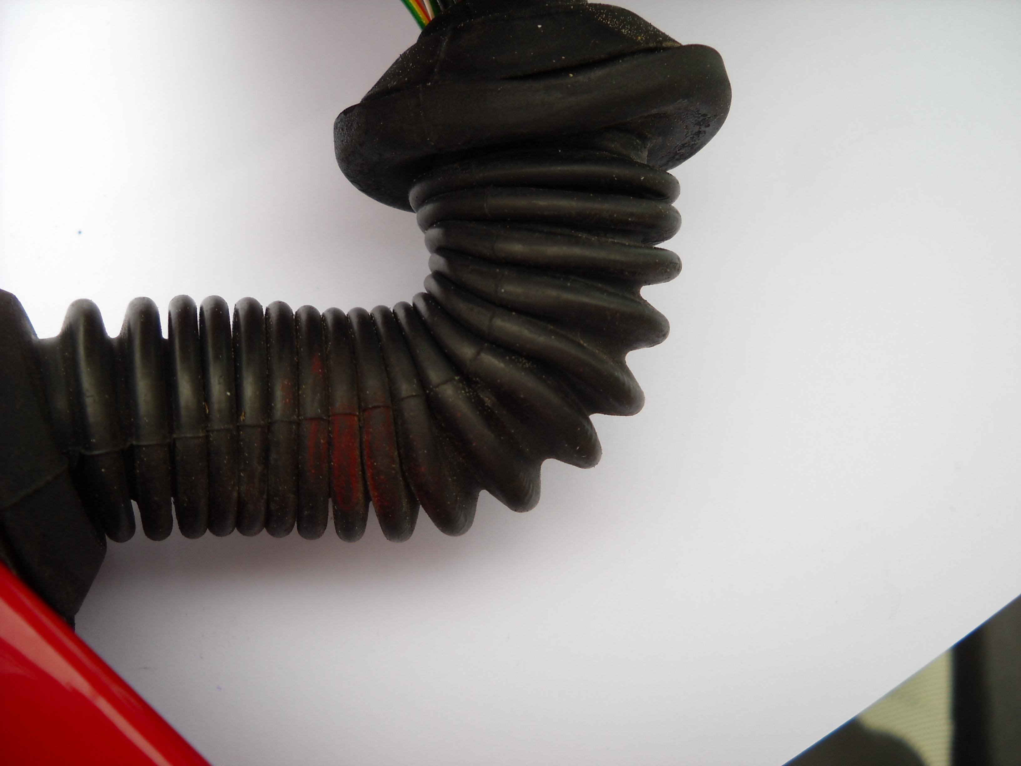

First pictures at the end of this post.
We've seen similar images of the wiring before, but look carefully at the grommet. It's completely intact and free of splits or breaks - there's simply no way you can know what's going on inside from an external inspection (I put a piece of white card behind it to get a better photo).

My current advice to any 500 owner with an electrial problem is to peel back the grommet (you only need peel back the end that's attached to the tailgate, since that's where the breaks happen) and inspect these cables before doing anything else. Actually I'd go further and advise all 500 owners to do this check regularly, even if the car is otherwise well. A small dab of silicone grease or a quick spray of rubber lubricant on the grommet will make it easier to remove & replace the end. DO NOT USE WD40 - it will likely attack both wiring & grommet & make a bad situation worse.
If yours looks like mine, I'd suggest you don't attempt to drive, or even start the car. Just unclip the battery quick-release terminal, & call a mobile auto sparky if you can't or don't want to fix it yourself.

There's some very light gauge cables in there (including the broken one) which surely can only be used for carrying control signals.

First pictures.

My current advice to any 500 owner with an electrial problem is to peel back the grommet (you only need peel back the end that's attached to the tailgate, since that's where the breaks happen) and inspect these cables before doing anything else. If yours looks like mine, I'd suggest you don't attempt to drive, or even start the car. Just unclip the battery quick-release terminal, & call a mobile auto sparky if you can't or don't want to fix it yourself.
