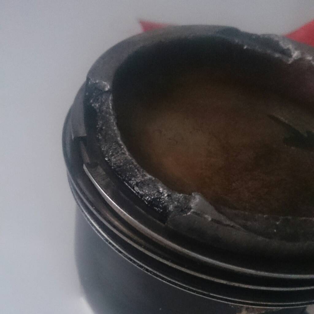

I do hope you fix the car for 300GBP, if possible it would be nice if you could make some pictures, so we could learn some more.
VVT = risk of collisions.
FIXED timing 8V = safe
Its not that simple at all. The valves won't hit the engine only if the piston has a certain shape that would make it avoid hitting the valves even if they fully opened at top dead center.
In anyway, none of the bravo's engine have variable valve timing in any form except for the multi-air engines which are pretty rare, and the OP here has a T-jet engine which is 16v, fixed timing.
So 1.4 16v T-JET engine is a non interference (safe)?
and 1.4 16v NA- is an interference (not safe)? :confused:
Again, its only about how the pistons are shaped. It doesn't matter if its a turbocharged engine or if it has VVT. But since both 1.4 engines share the same block, I think they could be the same. Judging by the picture it looks like it MIGHT be a non-interference engine. Is this the t-jet in the picture?
I don't think you can blame the car for this one... but i do understand the feeling, having just spent 450€ on clutch parts for my bravo, and then another 3 days underneath it ( should have been half the time .. but had problems with throwout bearing).... and on top of that i still have the worst cold start in history.
So here's the piston that was damaged, also the manifold has a blue dot on it where it's been heated to in excess of 1000 degrees in all £1300
That looks like cylinder temperatures where to high. some alcohol/water injection might have helped (but just as well more fuel would have helped keeping the temperature lower).
The temperatures are to high, the tolerances to tight (space between the ends of the rings), the rings expand eventually cracking the top of the piston. as in the photo.
