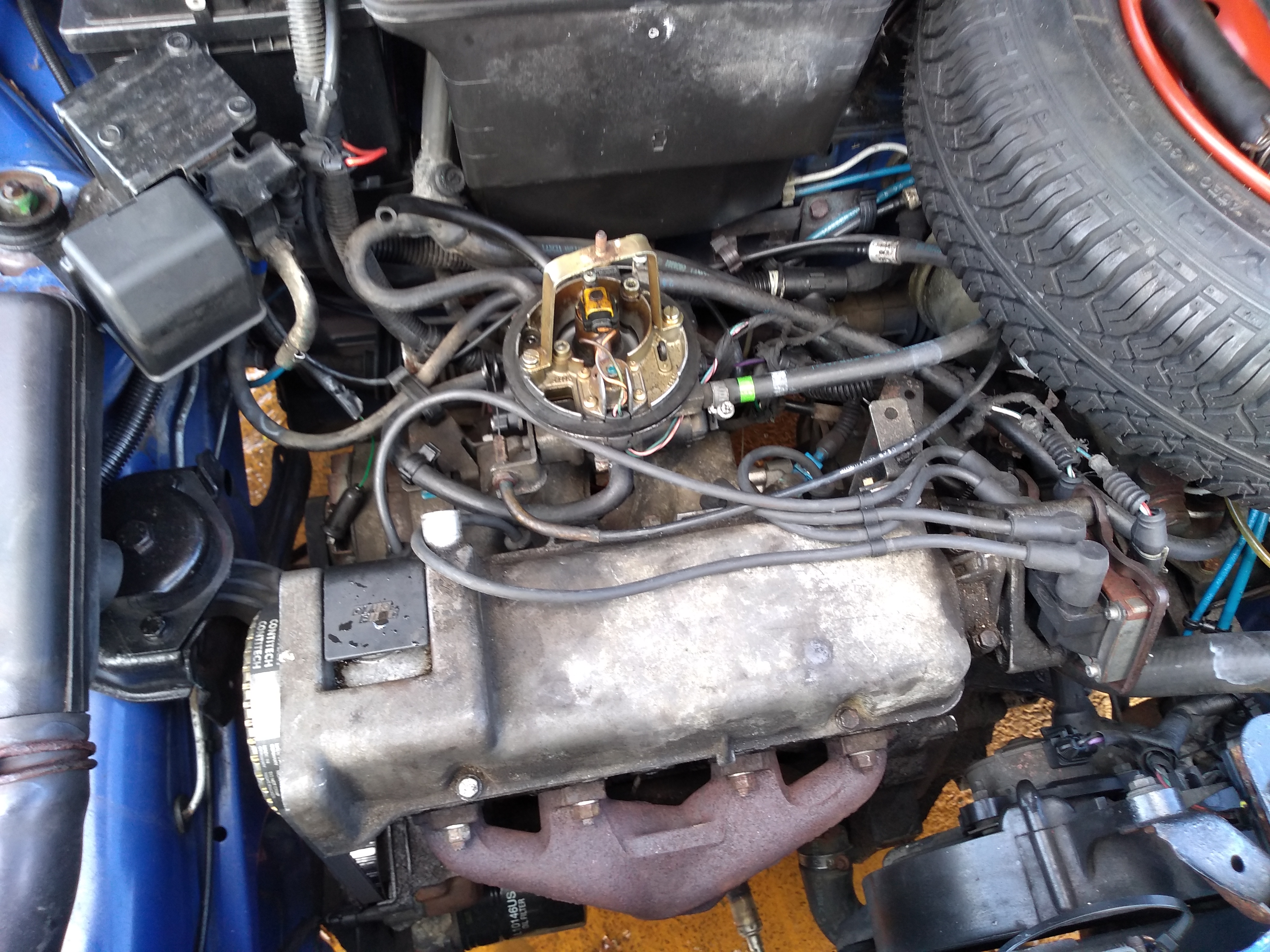

can you post up or send me a picture (or a few) of your engine, without the air box on
also of the ECU?
Hi John, thx for your prompt response, plugs had normal signs of usage and I only changed them as advised as a first step from someone else, Nella still at garage but fortunately got a decent shot beforehand, as I had noticed temp sensor spade plug was broken, now fixed, also bracket that airbox fixes too was prized upwards, causing poor seal between gasket and airbox, now sitting correctly, thinking I may pick her up tmz and fit new coil pack and see where I go from there. Will double check with auto electrician about fuel pump, as he had removed inspection plate not sure how far he went either just checking electrical signals or removed to check filter, will report back as soon as ?

ok that temp sensor has nothing to do with the ECU on this engine.. its purely for the temp gauge on the dash.
(ecu takes temp readings from 2 sensors. one is on the right side of the intake manifold for coolant temp, the other is built into the throttle body as an intake air temp sensor)
should not be a temp issue if it does it hot or cold..
