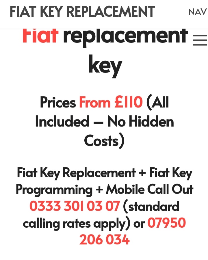

Code card not needed, it's a complete waste of time
The code can be read directly from the body computer, via the obd port in a matter of seconds
Remote fob are £160 to £250+ plus call out
None remote £75 to £180 plus call out
This company does it for £110, no nothing about them, south West only
Search for
Fiat 500, all keys lost
Yes I know it's a panda but the 500 will find more
