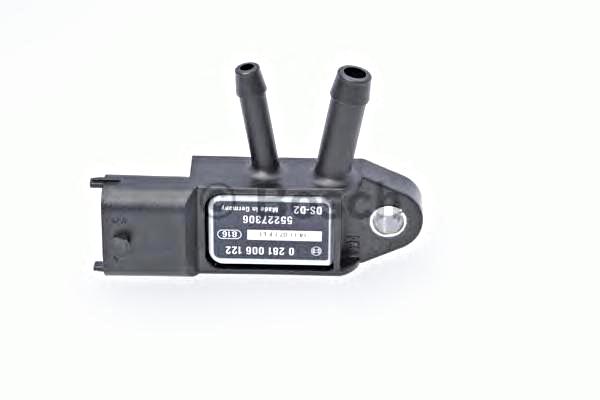

Have a fiat qubo Diesel 1.3 multijet can anyone give me a diagram of the location of the DPFE sensor as I keep getting an error code p0401 have already replaced the egr valve the mass air flow sensor and the map sensor it has been suggested that this sensor might be causing this error

Do you mean the dpf pressure sensor ? If so it's on the bulkhead on the near side 3 wires 5v feed , ground and signal think the signal is the centre pin from memory , idle you should see 0.5 v of dpf is clear 0.7 = getting blocked 1.2 and above indicates blocked filter don't forget the common problem with the pipes aswell
Can't locate DPF sensor on bulkhead can not see anything with 2 flexible pipes attached to it
This is what it's supposed to look like
