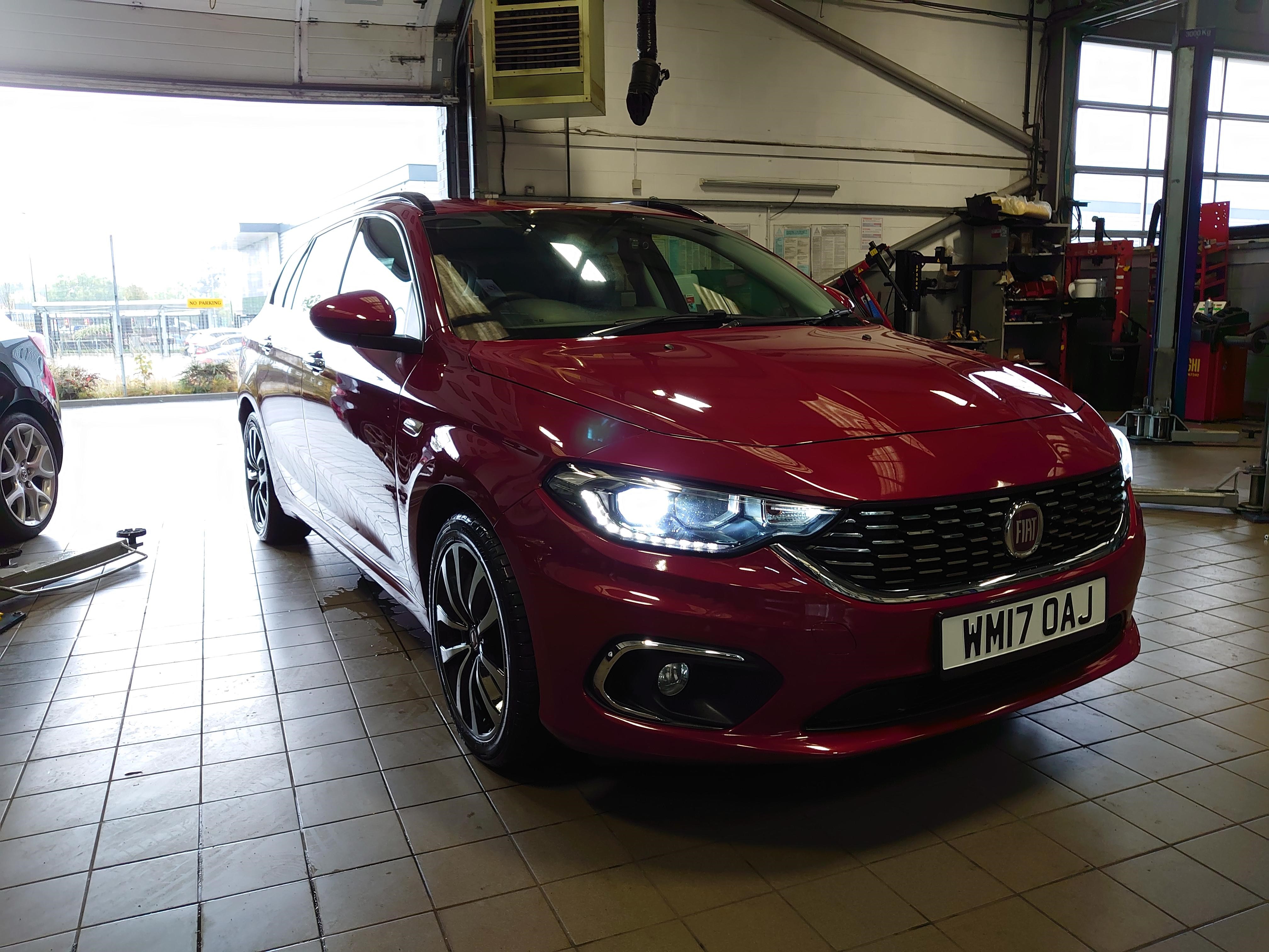

The main beam headlights are very poor is it possible to upgrade them. Thanks.
pic attached
