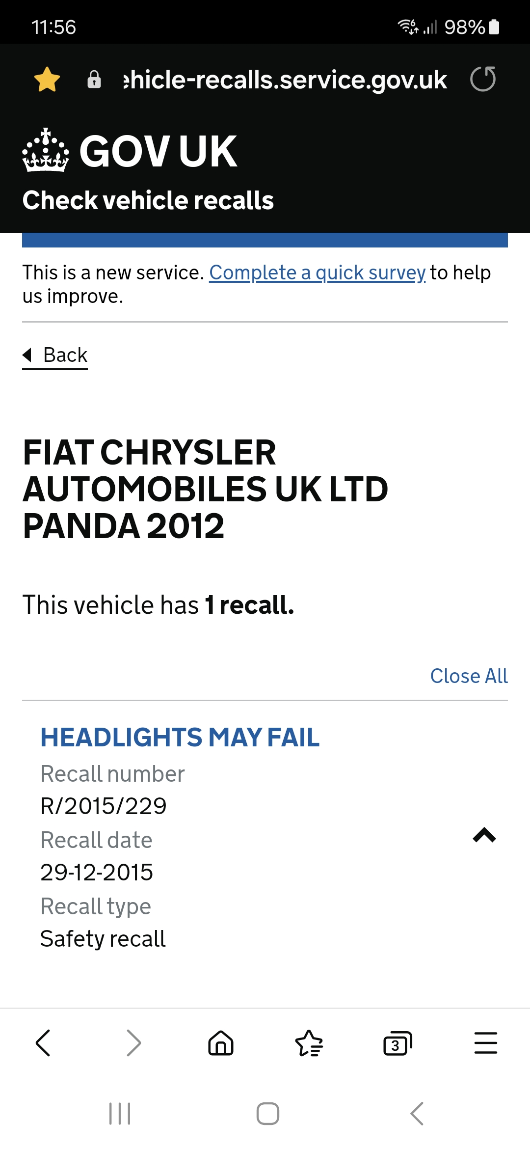

I have the same fault on mine this is what fiat came back with despite they saying it didn't have a recall, on the government site, it asks for the vehicle Reg no and that says no recall, but if you just select model of car and the year then you get the recall notice I have just posted.
Unfortunately, due to vehicle's age, Windsors will not be able to perform recall on the vehicle.
As we have identified the dealership which will be able to perform recall on your vehicle is Oldham Motorparks and we recommend contacting them directly.
As mentioned in the previous email, performing the recall will be free of charge. However, if the fault is not resolved after the recall, a diagnostic fee of £144, including VAT, will apply.
