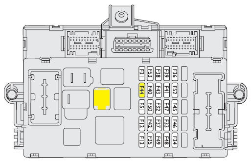

Hi anyone know which fuse is for the cigar lighter on jtd mw and is it the same one for the socket in the boot as thats stopped working too.
Fuse 44 and Relay T12 control both the Ciggie lighter and the boot power outlet.
