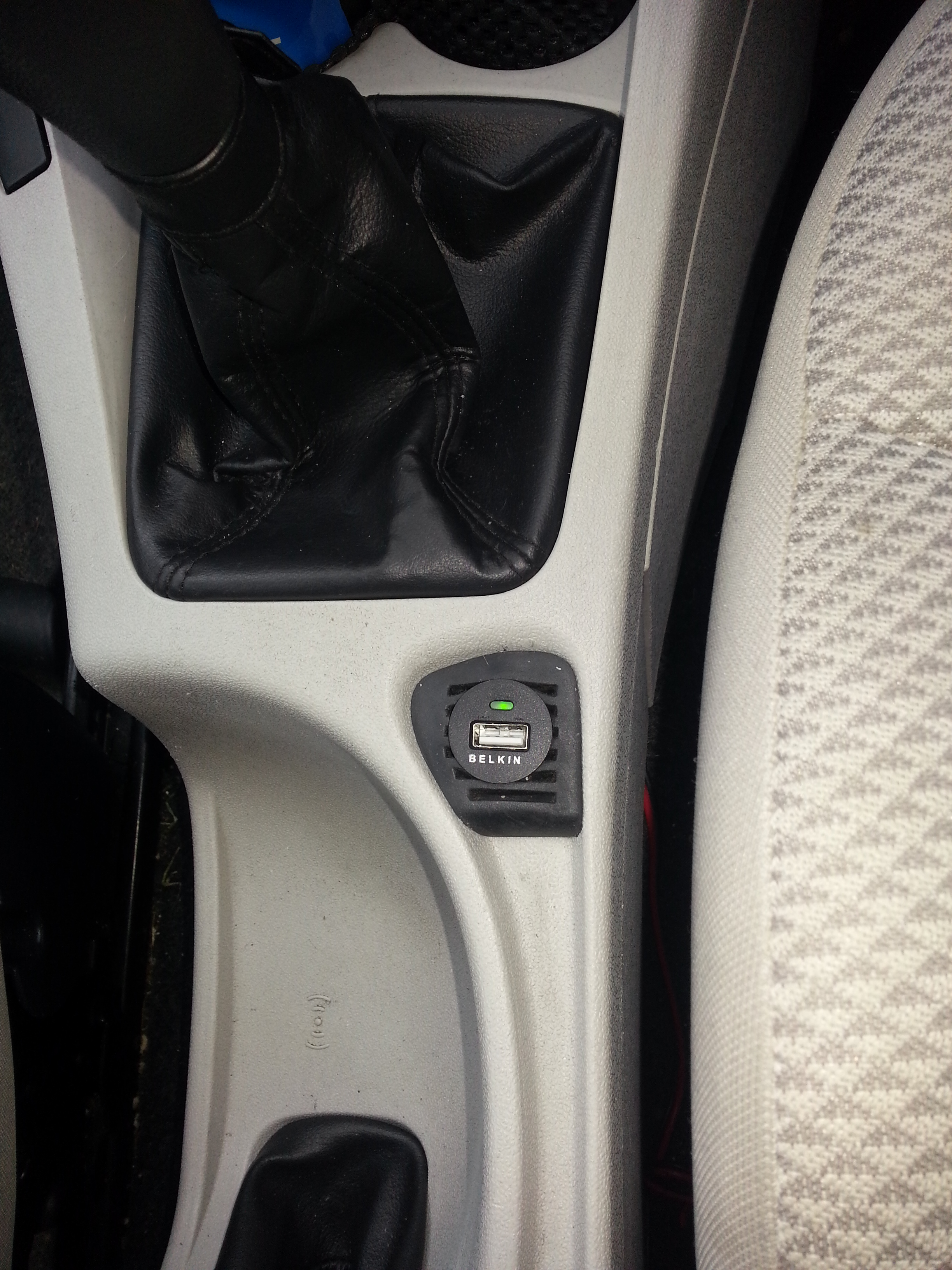

Update on my USB , ITs Working WOOT, just need to get some paint to try and match the plastic trim colour, extremely light grey, pity its not black lol.
To stop it pulling out, i basically made a similar template to yours, except i did 2 large ones and 2 small ones, 1 lge & 1 small glued together instead of 3 like you did, then for the other large and small pieces i reversed it as it is coming up from behind. Into the Belkin usb i cut a couple of groves either side in line with the bottom of the bottom piece of mdf and cable tied it tight, works a treat.
Cheers for the Tips Davren , Much appreciated.
New improved USB Charger housing. Solid as a rock, doesnt move at all when unpluging the charging lead.
I don't think it warrants a guide.
It's just a BELKIN cigarette lighter to USB adaptor fitted in a bit of wood with a 20mm hole and shaped to fit the space where the coin holder was, and painted black. Powered from the original cigarette lighter power supply wire and earthed on the handbrake lever mounting bolt.
Get a genuine BELKIN adaptor, the first one I bought was a fake and started smoking as soon as I connected it.

I fitted a belkin usb yoke after reading this.... good job, didnt wanna be buying/shaping/painting mdf etc to replace the coin holder tho so i gave it a good wash then bored a hole in it just, does the job grand.... Will post pic soon. Done it without taking console out, if u pull up the leather from the gear stick u can push the rubber up from behind and wire it in from handbrake gaitor. Since then however i wanted to fix my cig lighter as it was loose in the hole (but wudnt come out) and it didnt work, so ive taken the console out, but im waiting on replacement bulbs that lights the cig lighter ring... Then ill do a guide when im reassembling. Ull never get the cig lighter out without taking console out... It was tough enough even with console out!
